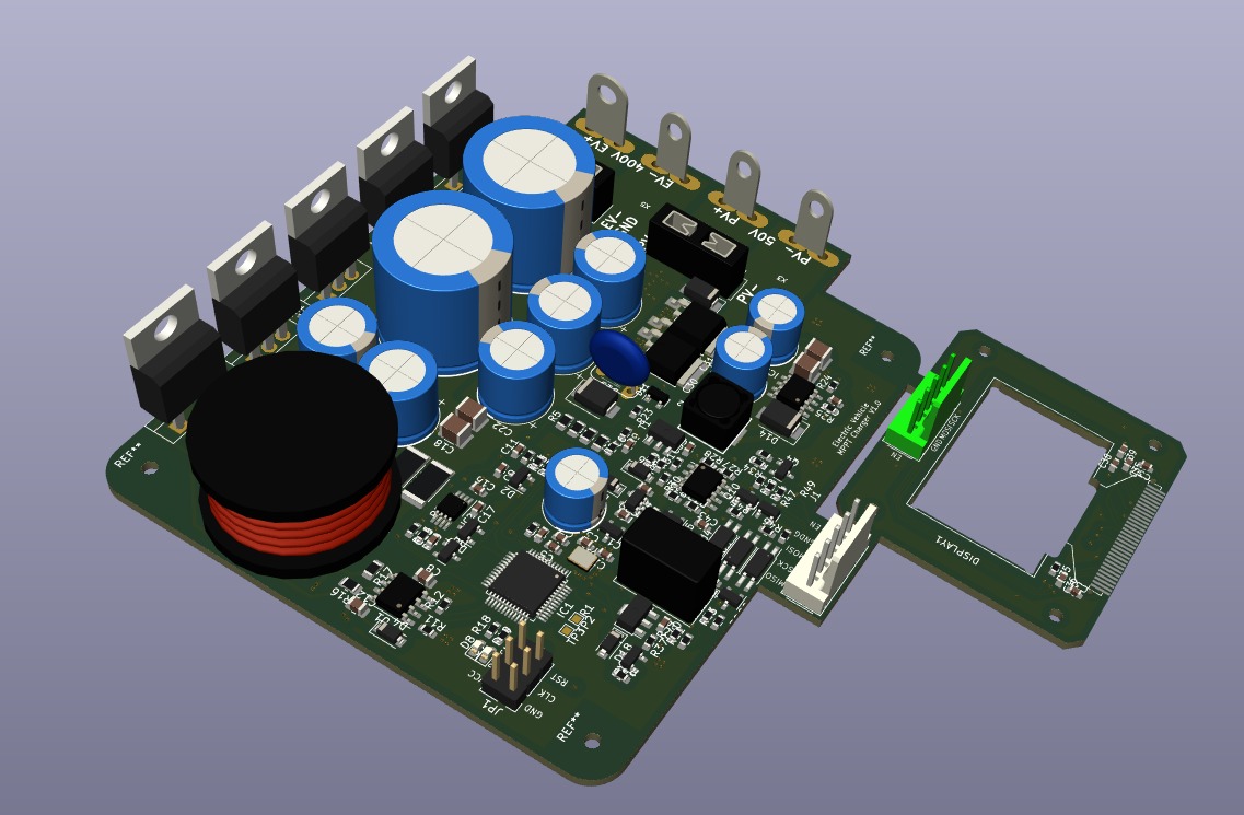

So here is a picture of the MPPT Electronic I designed since I didnt find a suitable Electronic on the market:
Charging the 12V battery is certainly way simpler but also not really effective since it gets full relatively quickly from 200W PV mounted onto the roof.

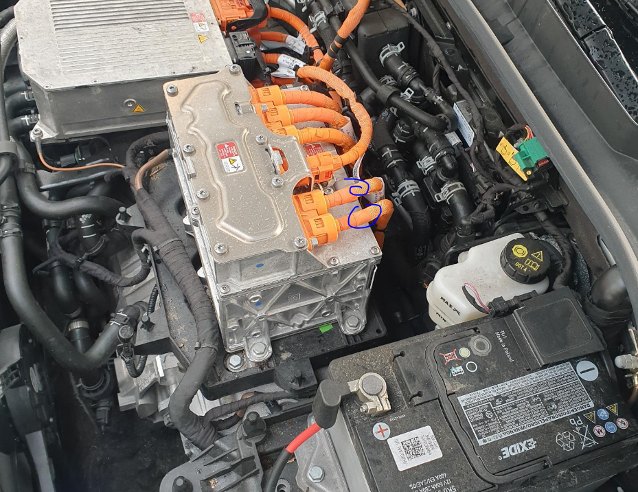

So my plan was to simply tap into the main battery terminals directly next to the car's ESC.
I am planning to tap into the terminals here:

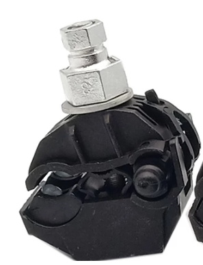

failry effortless with what's called a "isolation piercing connector" like that one:
The connector is basically eating carefully through the isolation and is desigend for high voltage, high power outdoor applications. Those connectors are typically designed to tap 230V AC transmission lines from the main line (copper or Aluminium). They can be connected "under power".

The MPPT will power cycle using an analogue hysteresis, e.g. swtiching the MPPT operation if voltage on the low side is greater 28V and goes off if lower than 20V. This way it doesn't go crazy in environments of rapidly changing irradince, e.g. when driving under trees or entering a tunnel ;-)

CoachX wrote: Mon Jan 02, 2023 11:15 am failry effortless with what's called a "isolation piercing connector" like that one:
You might need to think this over. HV cables in OEM vehicles are usually screened, so coaxial cables. You would pierce through screen and conductor, likely shorting them out on DC+ and DC- and thus shorting DC+ to DC- and to chassis.

johu wrote: Mon Jan 02, 2023 12:03 pm You might need to think this over. HV cables in OEM vehicles are usually screened, so coaxial cables. You would pierce through screen and conductor, likely shorting them out on DC+ and DC- and thus shorting DC+ to DC- and to chassis.
OK, you are right. They really seem to be shielded. Any idea where to reach the battery instead?

You will need to mess with the cables somewhat, probably cutting them in half and adding an enclosure in between. But what you can do is pick which cable to cut.
I would go for the PTC heater or A/C compressor cable. It's relatively thin and easy to work with, and nevertheless 200W is almost nothing to it. Usually there are no extra switches to control that cable so it will be always energized with the rest of the HV system. But check first that this is the case.

Sounds good, would you have a picture of where to access those cables on the PTC or Compressor? You drive an EGolf?
So far I have ordered only two prototypes of this MPPT, it's still in the making but I could potentially spare one yes if you want to help a little on the RnD :-) I wrote some basic MPPT PO algorithm in C with an STM32G07. I hope getting away with a 60kHz switching frequency, will use relatively large inductors since this CPU has not HTIM.

I have to agree with johu. do not pierce the insolation as the battery module measures the insolation resistance every 60 sec and if out of spec shuts down the battery.

Do not try piercing HV cable insulation. At best, bridging the shielding with HV+ or HV- will cause the vehicle to shut down. Or if the BMS doesn't catch it quickly enough, a battery fire. Even if you avoid those scenarios, you've connected your chassis to one side of the battery, leaving it in a very dangerous state. I'm ignoring longer term issues like moisture ingress on the assumption that the car will catch fire long before that becomes an issue. To connect into the HV bus, either cut the cables properly, crimp new connectors, and fit within a suitably IP rated and mechanically robust enclosure. Note that the new connectors will be carrying significant current, and poor crimps will result in malfunctions at best, more likely fire.
