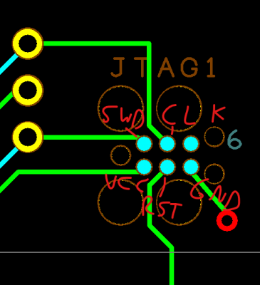

Just one little glitch, the Tag Connect is mirrored (I'd have to plug it in 180° rotated) so using the pin header for now.

Ahhhh!!!! So close!
I did have to manually make that footprint so I'm not exactly surprised.
Are the mounting holes reversed in relation to the pads? If so, that's a pretty easy fix, I can just reroute the traces.

Yes, the alignment holes are swapped. If the "one" hole swaps place with the "2 holes" it would be perfect. The holes are a good fit, otherwise.

I'm just now having some time to take a look at this.
I've looked at the design, the datasheets, and the fabricated boards, and the pinout looks completely correct to me.
https://www.tag-connect.com/wp-content/ ... -CTX_1.pdf contains the pinout of the 6-pin TAG connector.
1 VCC
2 SWDIO / TMS
3 nRESET
4 SWCLK / TCK
5 GND (also connected to GNDDetect)
6 SWO / TDO
Now if you take a look at the TC2030-IDC datasheet https://www.tag-connect.com/wp-content/ ... -Rev-B.pdf it shows the pin numberings. Bottom left is pin 1 (VCC) and top right is pin 6 (SWO, unused IIRC).
Comparing this to the boards as built, you can see connections that look to me to be correct.
Well damn. Looked at the PCB files and it looks like I put GND at pin 6 instead of pin 5. I will fix that and send updated Gerbers for the next runs.
SWO is ignored, correct?

Yes SWO is ignored.
This is how it's layed out on V3 mainboard:

Excellent. I've just emailed you some Gerbers with the corrected pinout (it was just GND misplaced).

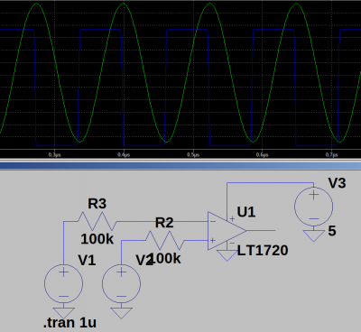

Would you be up for an LDU update? I figured out a replacement circuit for the discrete current sensor oscillator, see attachment.
The comparator of choice would be TLV3201AIDBVR in a tiny SOT-23-5 package with low propagation delay. V1 and V2 represent the two ends of the 8 MHz crystal of the STM32.
All other changes like on SDU.

Absolutely! That looks great, it was the only real concern with doing the LDU. LCSC has 16,000 in stock, nice.
I'll probably have a first draft by Saturday or so (it's exam week for me); will begin with that exciter circuit and send to you for review as I'm not exactly experienced with HF design.

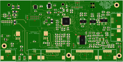

So I've placed and routed everything; had to slightly move a ton of RC networks to make good space for that trace, but all looks good now.
I've gone through BOM and updated everything, generated Gerbers and CPL as well.
Running through JLC, the inductor appears to be short of stock, so changed to a different part which is apparently identical.
Okay, good thing I looked at the visualization and BOM again. The schematic specifies NCV8401, an integrated low-side driver/MOSFET package. JLC doesn't have those. They have NCV8403 which is a drop-in, but that's out of stock. ST has the 'Omnifet' line but those are equally unavailable for assembly.
Hmm... What should be done? Looks like Damien used to hand/oven solder those parts. Johannes, what would you prefer? Should I leave the footprint there for your use or figure out a new FET and driver solution?
-Isaac
Bonus pic of the board as JLC imagines it.
