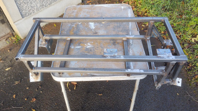

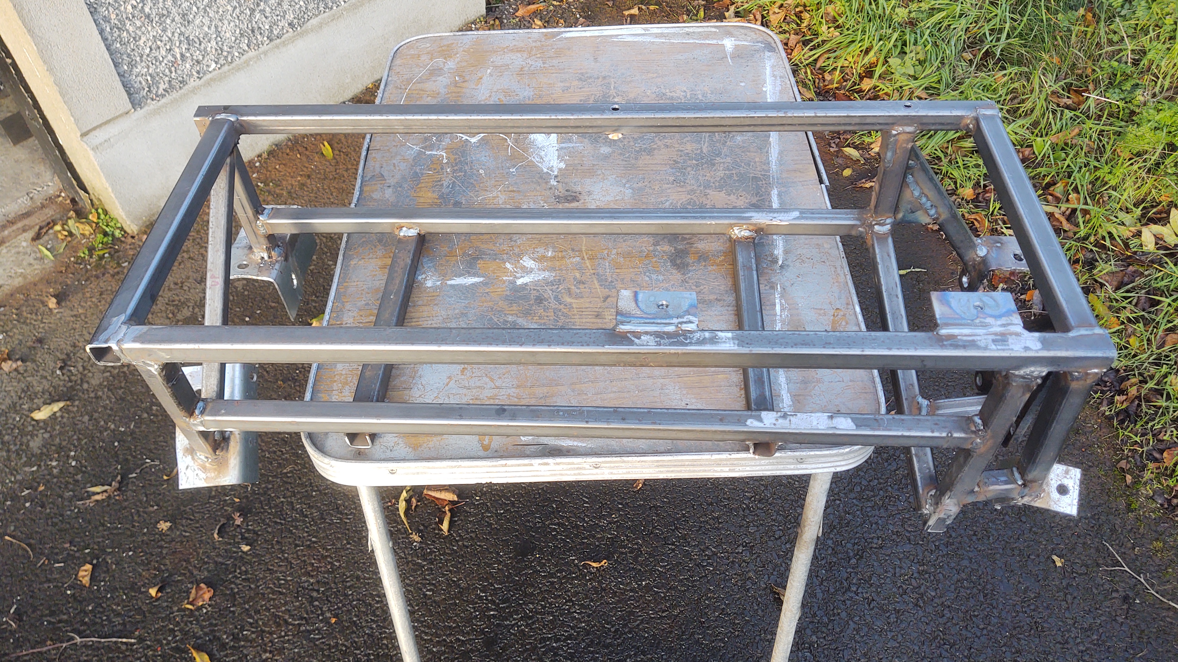

I've built up a frame to hold the electronics and maybe some batteries (if there's room) under the bonnet.

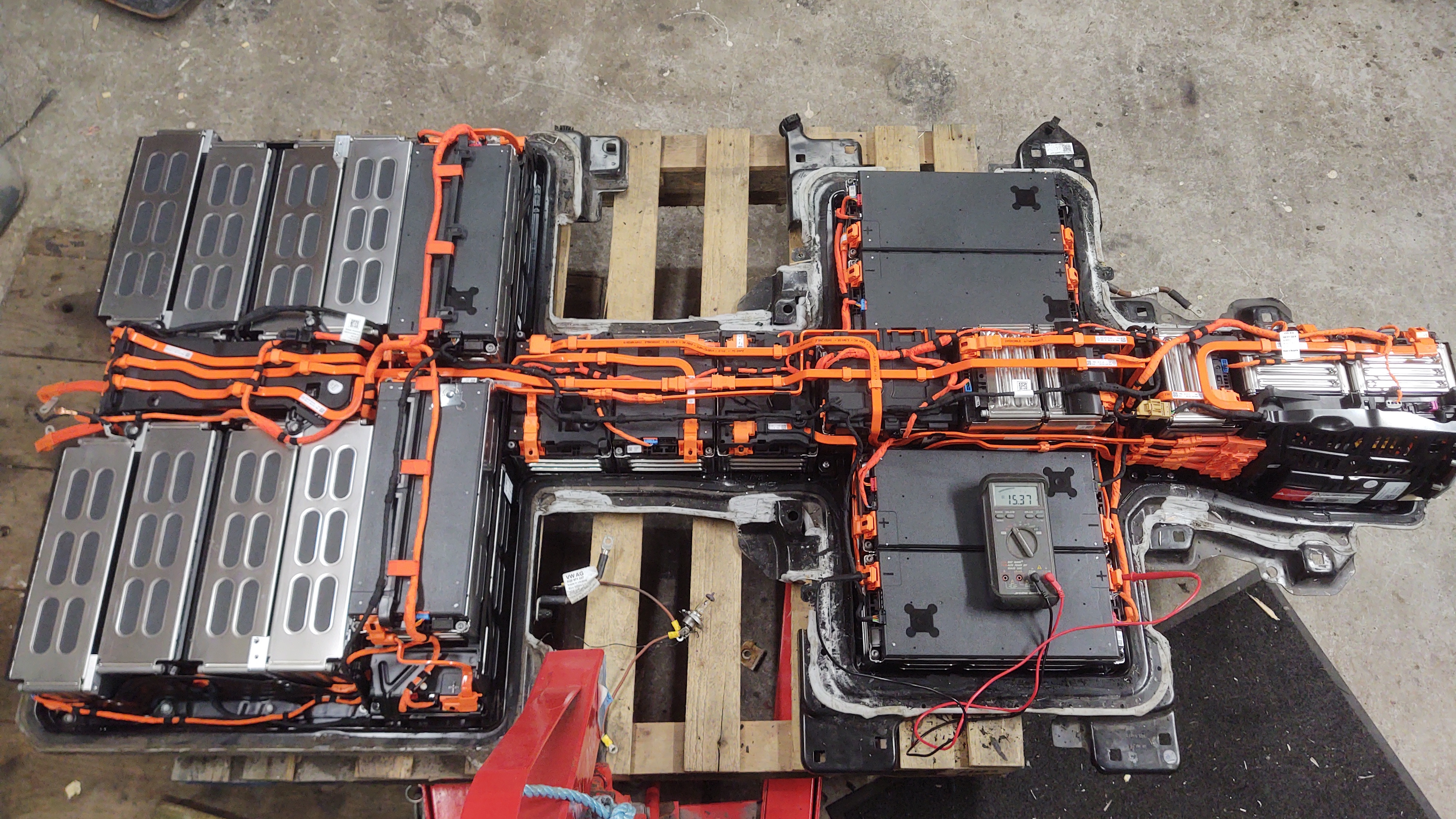

This arrived 10 days ago.
You may know if you've been following this build I've been dithering for months over how to resolve the charging/BMS/DC to DC conundrum.
I kept myself busy welding and grinding but had come to the point where I needed to make the decision so plumped for purchasing another two 4S modules and have a go at making the Nissan Leaf BMS and Charger work. ;)
Only thing is the two modules came with a few friends. :eek:
Buying two modules was more than 1/4 the price of a full pack so made no sense.
This pack is the same age as my first one so the modules should be close enough mileage wise to be OK.
Having the two packs also means I have more options for packaging the modules, I can use more 4S or more 2S, whichever fits better.
I haven't decided whether to sell the extra modules or hang on to them for future projects but will worry about that later. ;)

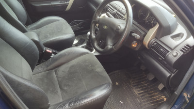

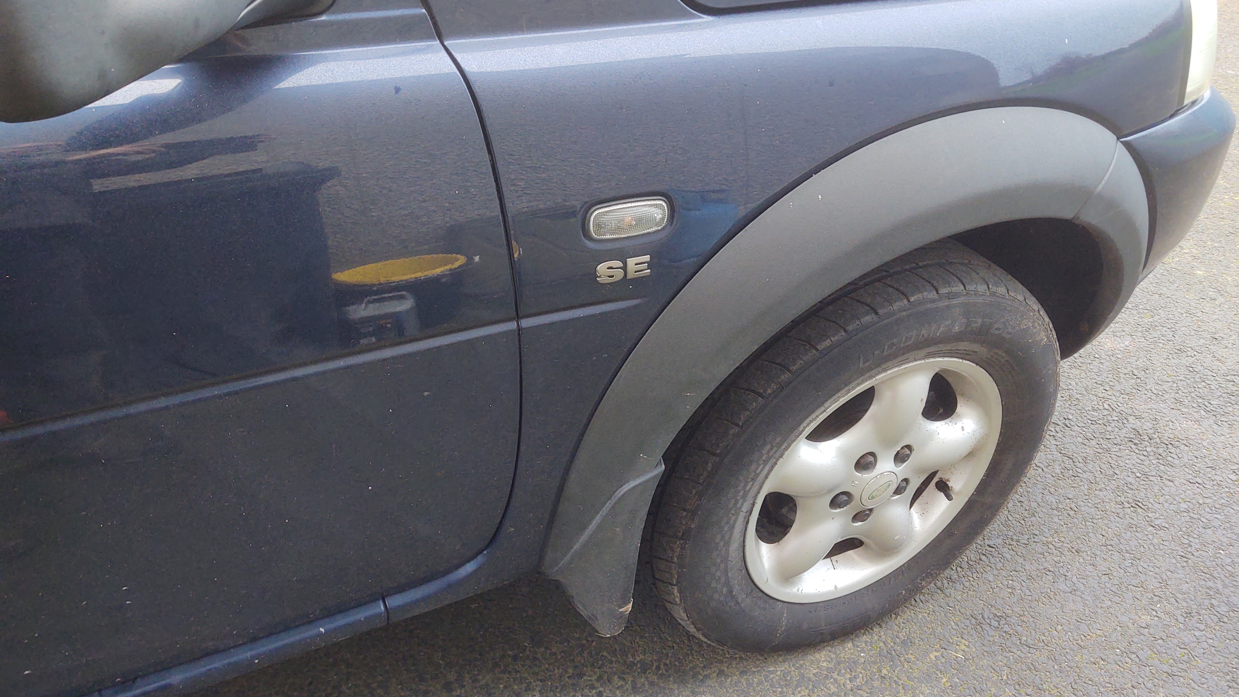

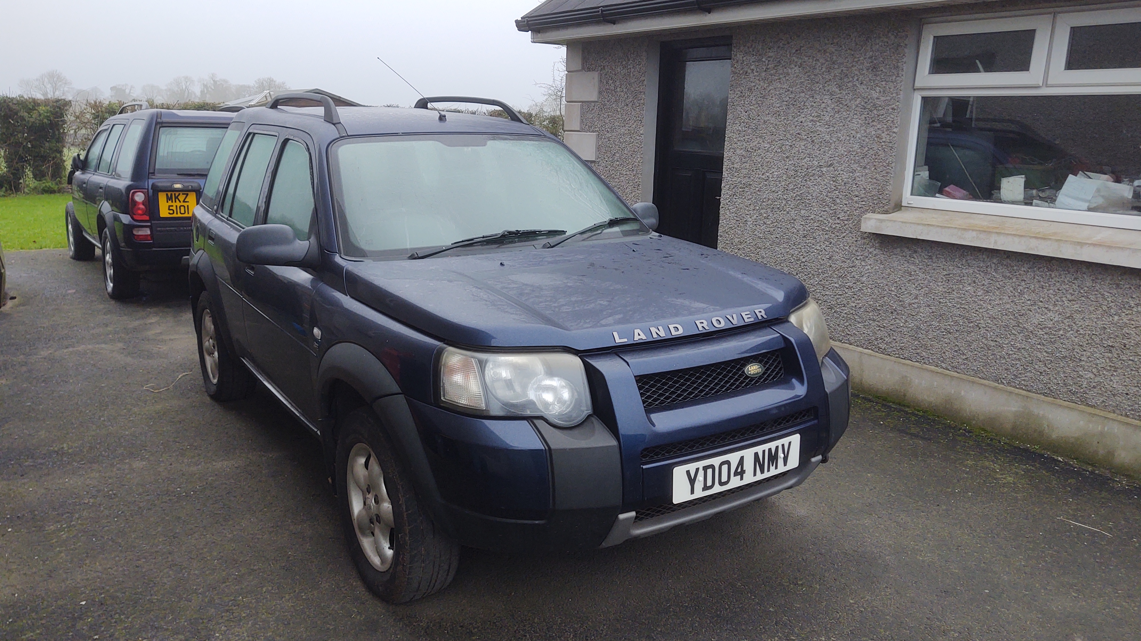

The other big update is this
It's a 2004 Freelander SE with all the usual SE options. :P
It was being sold as spares repairs because of a few minor issues but is running and driving so I'm hopeful this will be the one. ;)
I need a bigger hammer!

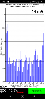

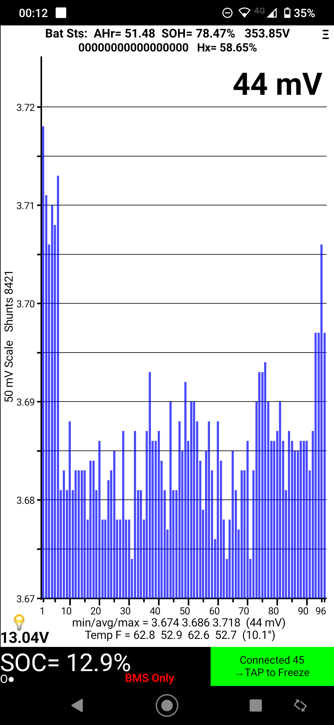

So have you got the Nissan Leaf BMS working with e-golf cells? Balancing and voltage reporting? Is there a way to monitor voltages with Leaf BMS?
Alibro
Posts: 857
Location: Northern Ireland
Has thanked: 270 times
Been thanked: 150 times
Re: Freelander EV With Gen1 Leaf electrics and EVBMW VCU
Post by Alibro »
m.art.y wrote: Fri May 27, 2022 10:02 am So have you got the Nissan Leaf BMS working with e-golf cells? Balancing and voltage reporting? Is there a way to monitor voltages with Leaf BMS?
Yes mate. It was really simple in the end.
I took the BMS CAN wires to an OBDII socket, plugged in a Bluetooth adapter and used LeafSpy.

That's really cool! Do you know how Leaf balancing works? Is it all the time or only when charging? Can you choose which voltage to charge to?
Alibro
Posts: 857
Post by Alibro »
To be honest no, I don't know. it seems to be balancing the entire time it has 12V but the current is so low it is very very slow. I've taken the pack apart again as I want to get it installed in the car so can't do any more testing for a while.

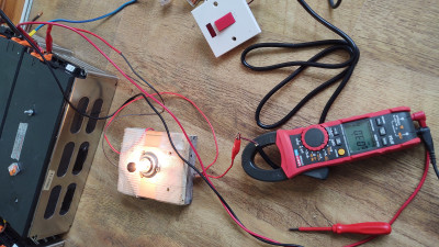

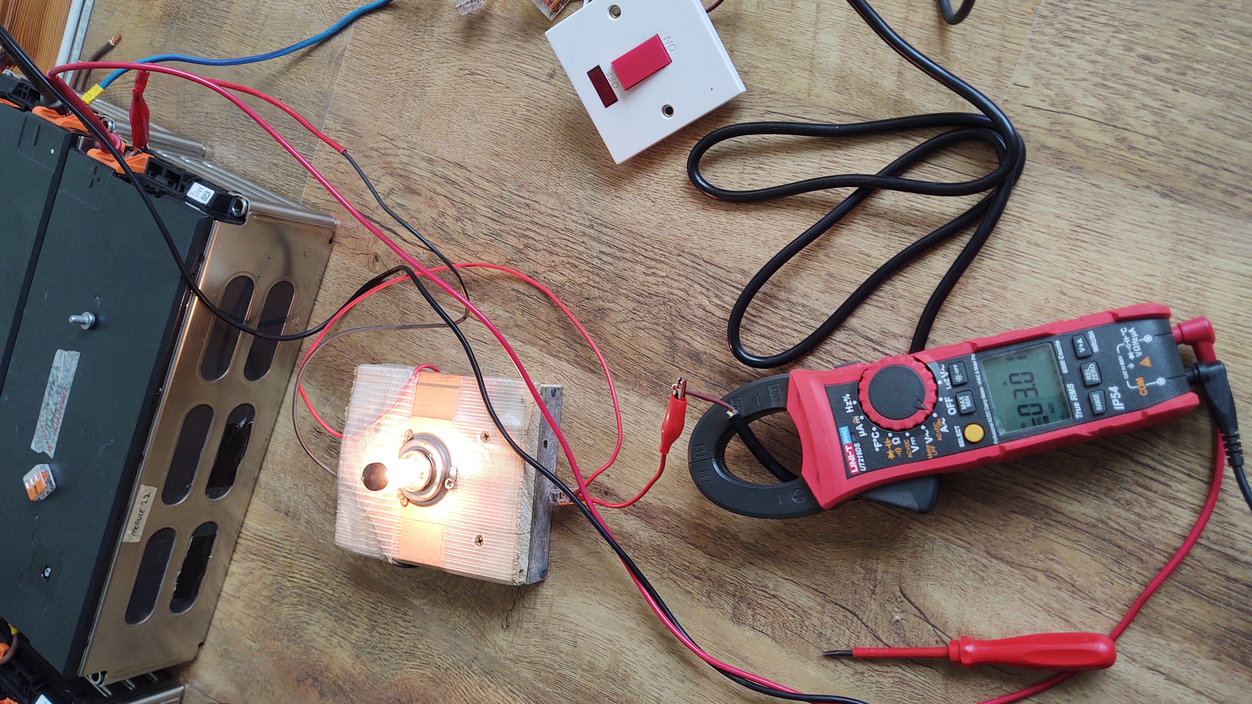

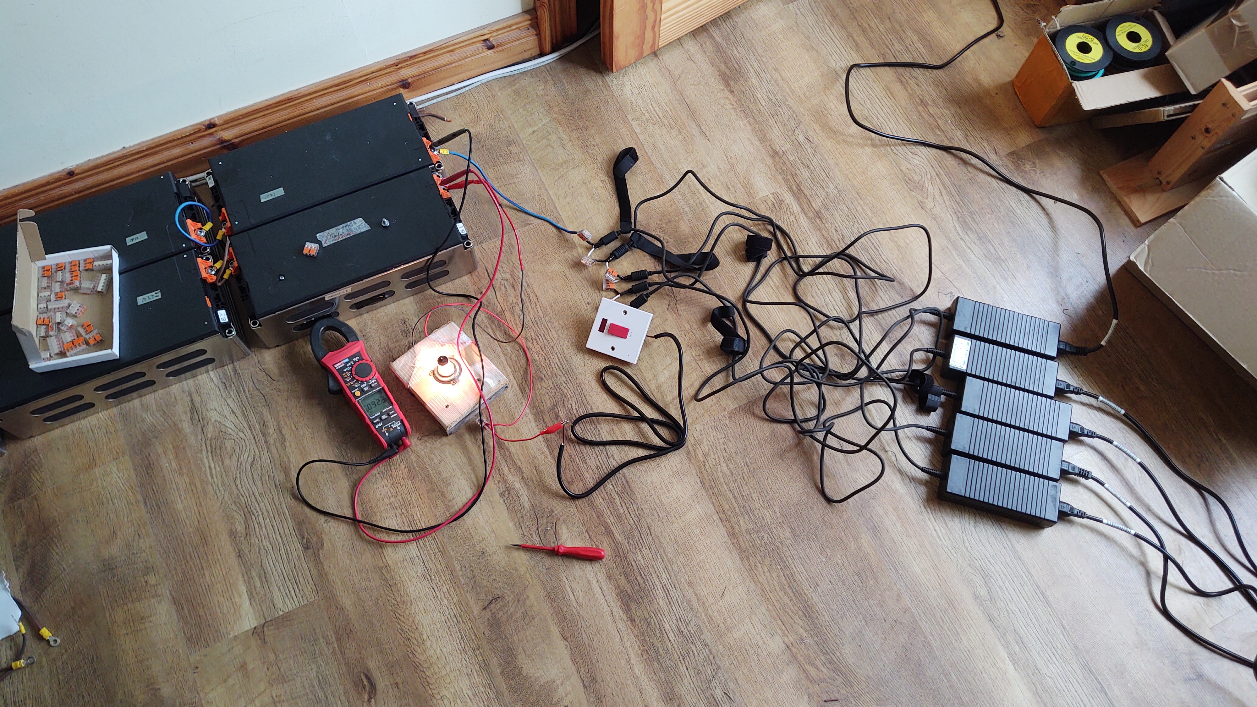

So it turns out multiple laptop chargers wired in series can be used to charge HV. :D
As a test I connected 6 x 4S modules to give 92V. I then connected 5 x 19.8V chargers in series to give 99V and after turning on the psu's connected them together.
This didn't go well as the chargers instantly shut down and refused to come back on until I disconnected them from the batteries.
I then connected a 12V 60W lamp in series and tried again and the result is below.
I'm seeing 3A and 92.3V at the batteries and 98V at the psu side of the lamp.
These are 6.9A psu's so are well within their comfort zone and the voltage is slowly rising at the batteries.
It's all a bit dodgy looking but as a proof of concept it works. :)

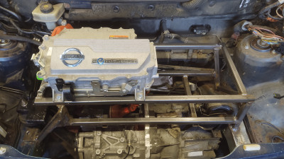

This is a sneak preview for Openinverter.Org as I haven't made it made public. I plan to use it as part of a longer video next week.
This was the first time I was able to drive the car using full power.
It is front wheel drive only here.
Everything was installed temporarily so I was holding back to make sure nothing bad happened, this was less than half throttle in 2nd gear.
Also I was using mostly just the hand brake as the vac pump is not installed yet.
Many thanks to Damien and Johannas for all their hard work that made getting this far possible.
