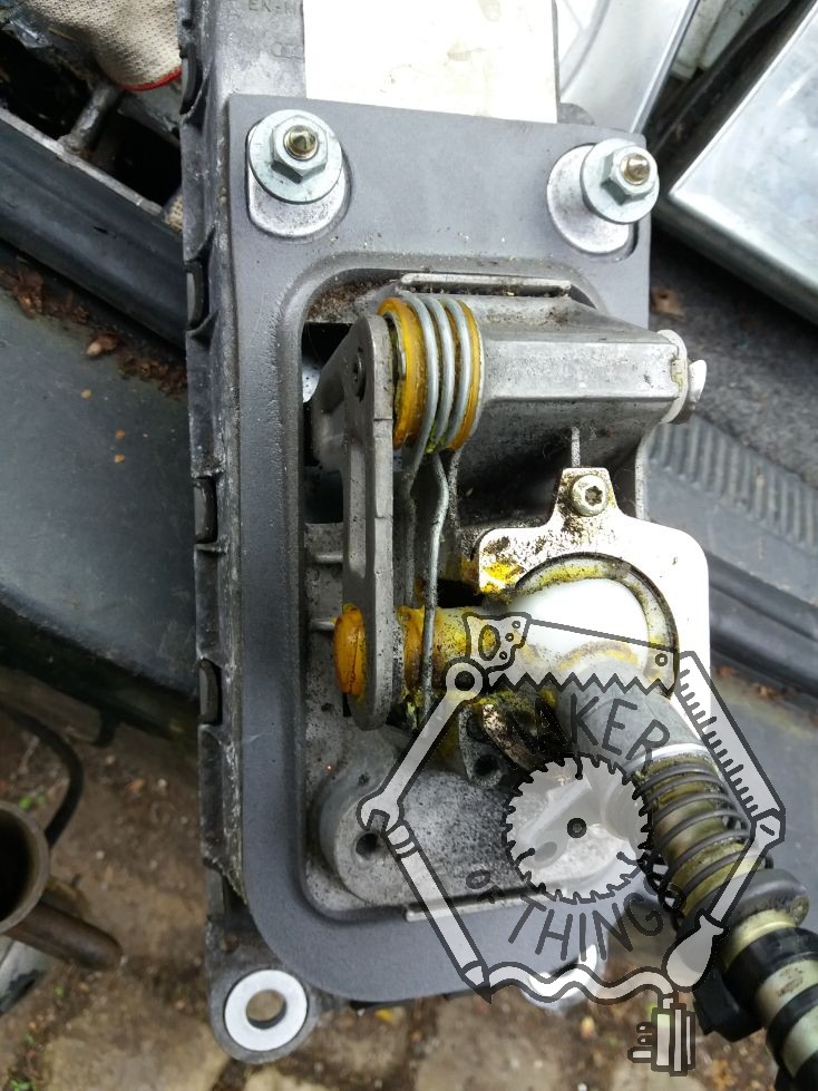

I also removed the gear stick mechanism while I was about it.
An easy job, the heat shields came out, held only by little discs of rust.
Then inside, with the gear stick boot unclipped and the ashtray removed, there was access to two 13mm AF nuts at the top.
Underneath the car again remove two 13mm AF bolts.
The mechanism then just falls off and the gearstick boot and be fed through the hole in the floor.
I will make a cover for the hole, and then the boot surround plastic can be used to make the switch panel for the forward/neutral/reverse switch. I reckon that was the easiest part of the whole conversion so far!

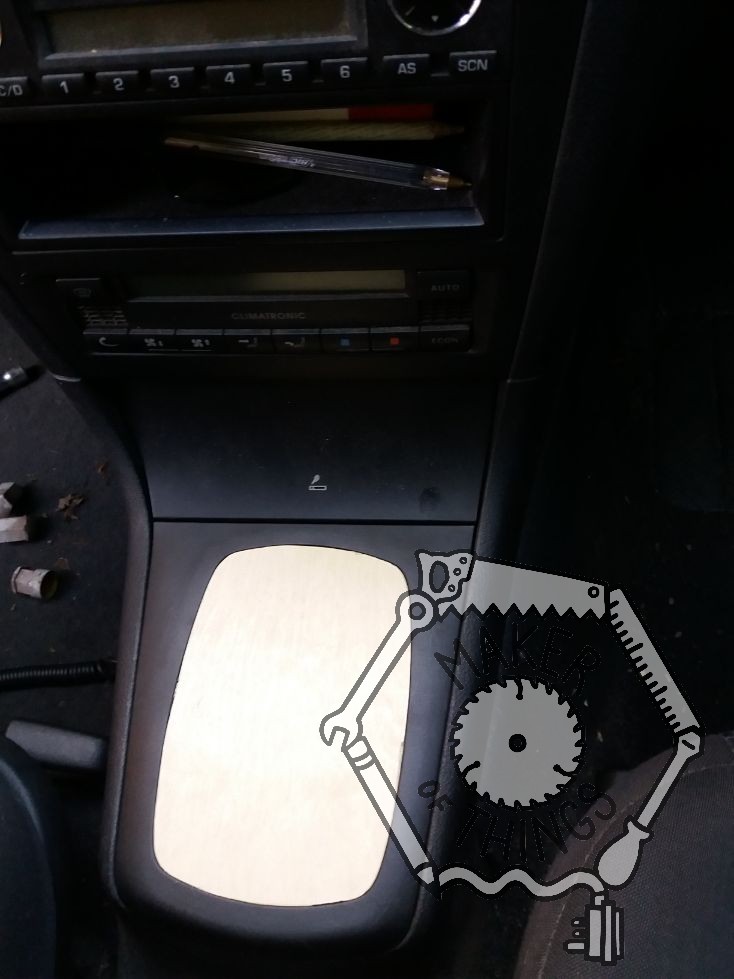

Today I did a bit of metal work to patch the hole left by the gearshift mechanism.
As I am one of those people who hoard everything that might become useful later on I was able to source the steel from an old washing machine I dismantled many years ago.
I measured and made up the patch, folded the sides for rigidity, and TIG welded the corners. After a successful test fit I drilled the holes for the bolts from underneath, and rivnuts for the bolts from above. The patch was then sprayed with cold galv paint and then stain black.
At this point my phone thought black and white images would give a more atmospheric effect! I was able to reuse the foam gasket from the old shifter body, so it is now nicely sealed. I then removed the plastic trim from the gearstick boot and used it to make a 6mm birch plywood infill piece. I included the tabs in cutting out the plywood so that it would clip in place and be flush to the surface. I can use this to mount the forward/reverse switch, and any other useful stuff. I am spraying the plywood black as it was never going to be a wood trim kinda car, even though I do have some burr cherry veneers in stock!
This is what it looks like in black, a bit more shiny and blacker then the plastics but it'll do.

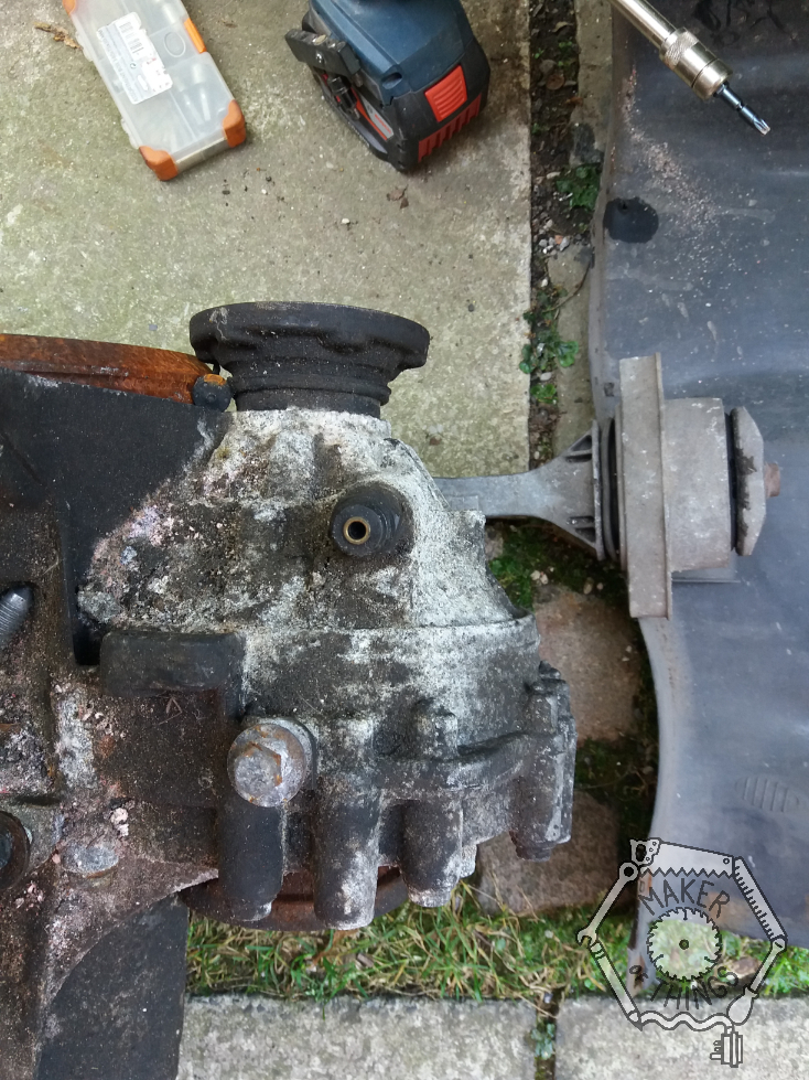

This is what Damien kindly sent to me, the Prius transaxle, Controller, driveshafts, and other useful stuff, and including a #SurpriseMakersParcel.
Not sure what the thing between the vacuum pump and the power steering pump is.
Here is the Prius transaxle and the Skoda transaxle exchanging tenancy contracts.

After a ten month pause, I have finally started to tackle the conversion again and decided to attempt a trial fit of the transaxle.
The pause has been partly poor mental health, winter weather, parents using my working space to store their mobility scooters, and needing to earn money with a few more regular part time jobs taking up most of the day times.
However, I know that I can't let this project lapse and also that there is help if I ask for it on the forum.
The first stage of this next part is to do a trial install of the Prius transaxle and see where it needs to fit. I can then work out temporary, and then permanent, mounting points for it.
The first stage was to check where the original transmission mounted and work out where the drive flanges would be. I refitted the transmission mount torque bar underneath the diff. This has a known position to bolt onto in the engine bay near the drive shaft flanges. So notes made of fore/aft and vertical positions of the flanges.
It was a complete waste of time though!
I craned the Prius transaxle into position and...
Well, I need more space. Here the transaxle is about 25mm from the inner wing, but touching the ABS pump! It still needed to move another 40-50mm to the nearside to line up with the driveshaft flange. That puts it inside the inner wing metal work! Oh poo! But then I had an idea! There is no petrol engine being attached tot he Prius transaxle so it doesn't need to be on the nearside of the engine bay.
I swapped the driveshafts over, and the transaxle can go more or less central! I did a test and it will go in there but I need to swap to the drive shafts that Damien sent in the package. The CV joints are different and the shafts are quite a bit shorter to allow for a wider diff flange spacing.
No photo of that bit as I had to put everything away again and go to work!
