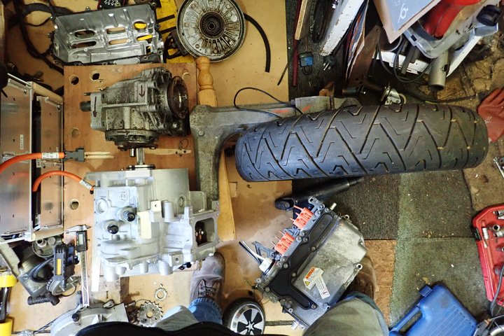

Anyone got any practical ideas about how to achieve a 2:1 reduction to reduce the motor rpm / multiply the torque before going into a final drive?
It's for a Outlander MGR, 60kw.

Yea I am doing a bike but I want to avoid a chain final drive if at all possible. This is for various reasons but mostly because chains are short lived which makes maintenance expensive and tedious. I gave up with chain driven bikes years ago because of it. The big plan is to use the electric bike for my primary transport and as I currently do about 20000 miles a year and have only ever got about 8000miles per chain + sprocket set it's a thing that soon adds up on the maintenance bills.
ZooKeeper wrote: Thu Jul 23, 2020 12:27 am Low Range transfer case planetary?
Sounds like a worthy consideration, as is the toyota prius transaxle planetry gearset, however I have no real idea what else they are fitted to for scavenging parts from.
I've kind of settled on the BMW K series swing arm and beval drive as they are available in a range of ratios and are reasonably plentiful on the 2nd hand market but I'll be needing a further reduction before this.
First idea simply connecting to the drive shaft. Max reduction from available ratios is 3.36:1 which gives a max wheel speed at max rpm of about 202mph using 9000rpm as a maximum for the outlander motor. This is clearly ridiculous. Only the lowest rpm from the motor is usable and the toque to the rear wheel is heavily compromised by the high gearing.
Second idea using two final drives in succession. lowest reduction is 2.82 X 2.82 = 7.95 and a max wheel speed of about 86 mph which is lower than I'd like it, not that I'm a speed freak but being able to hit 100mph would be good plus I'm guessing having the motor near max rpm in normal use will compromise available torque as the motor will be tapering off at this speed.
Third idea is using a reduction of 1.59 from an Audi TT transfer box. 1.59 X 3.36 = 5.34 and a max wheel speed of about 130mph, which again is still a bit high but closer to what I'm aiming for.
Ideally I want a max speed to be around 100mph for best acceleration and lower gearing but not so low the torque of the motor will be tapering off as it reaches max rpm during normal road use. This I think needs a ratio of about 6:1 which I can get using a reduction of 2:1 followed by the bevel drive of the swing arm of 3:0:1
Mind you it's mostly guess work at this stage so please chip in if I've made any really bad assumptions.

I have BMW i3 96Ah 12s battery modules. I found out after getting them that they are the same modules used in the BMW electric motorbike.
Still looking for a working and affordable BMS solution as the BMW protocol doesn't appear to have been cracked properly to allow balancing yet.

Mouse wrote: Fri Jul 24, 2020 11:09 am
the current bike has a VW 1900cc TDI engine and car gearbox in it
We need pics or something :shock:
Re: 2:1 reduction gear ideas?
Posted: Fri Jul 24, 2020 3:38 pm
by Mouse
jap wrote: Fri Jul 24, 2020 11:59 am [We need pics or something :shock:
You might need a stiff drink after seeing this ;)
I've done a talk about it at a hacker camp and recently done a walk around video if you're interested.
