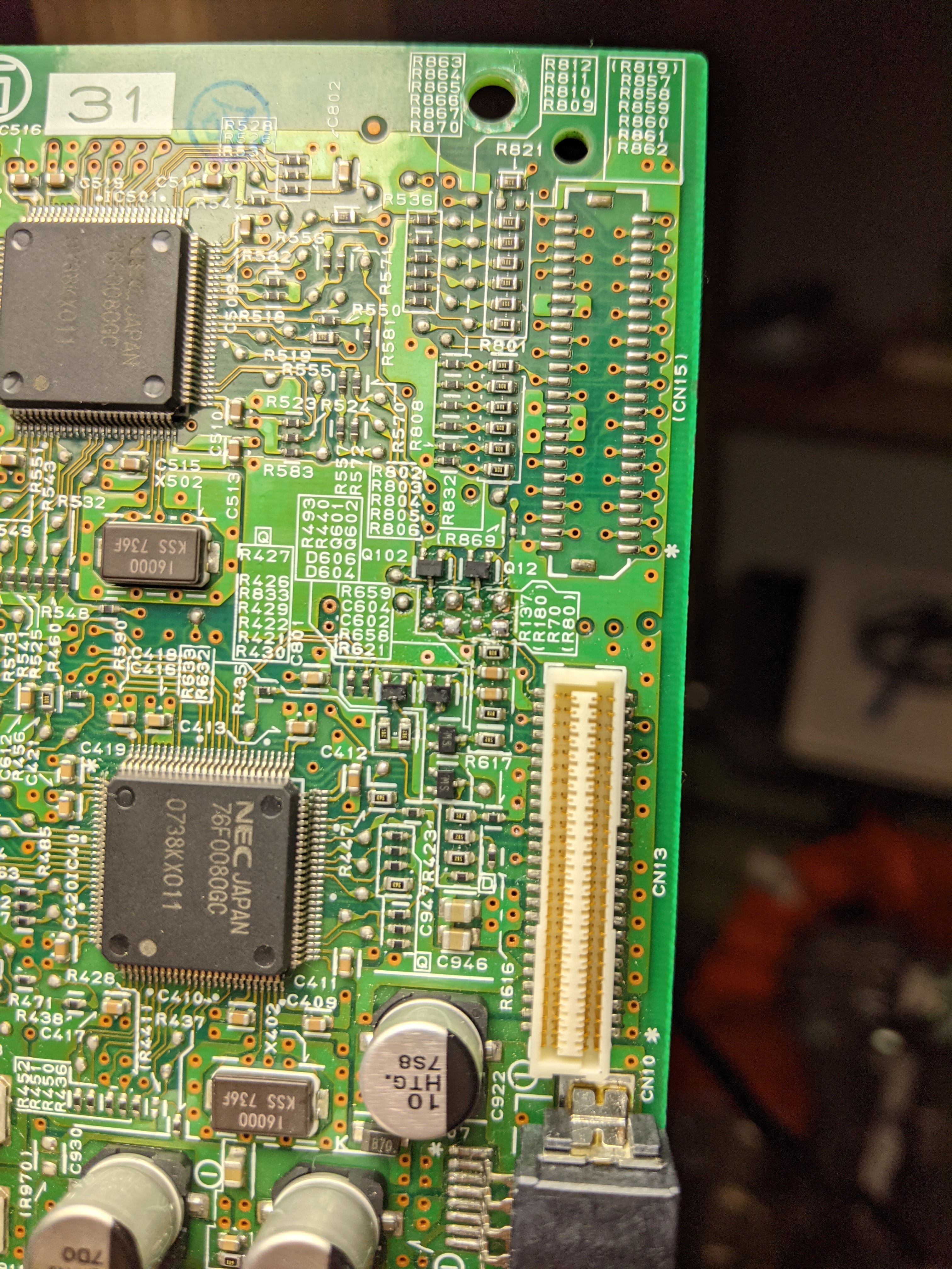

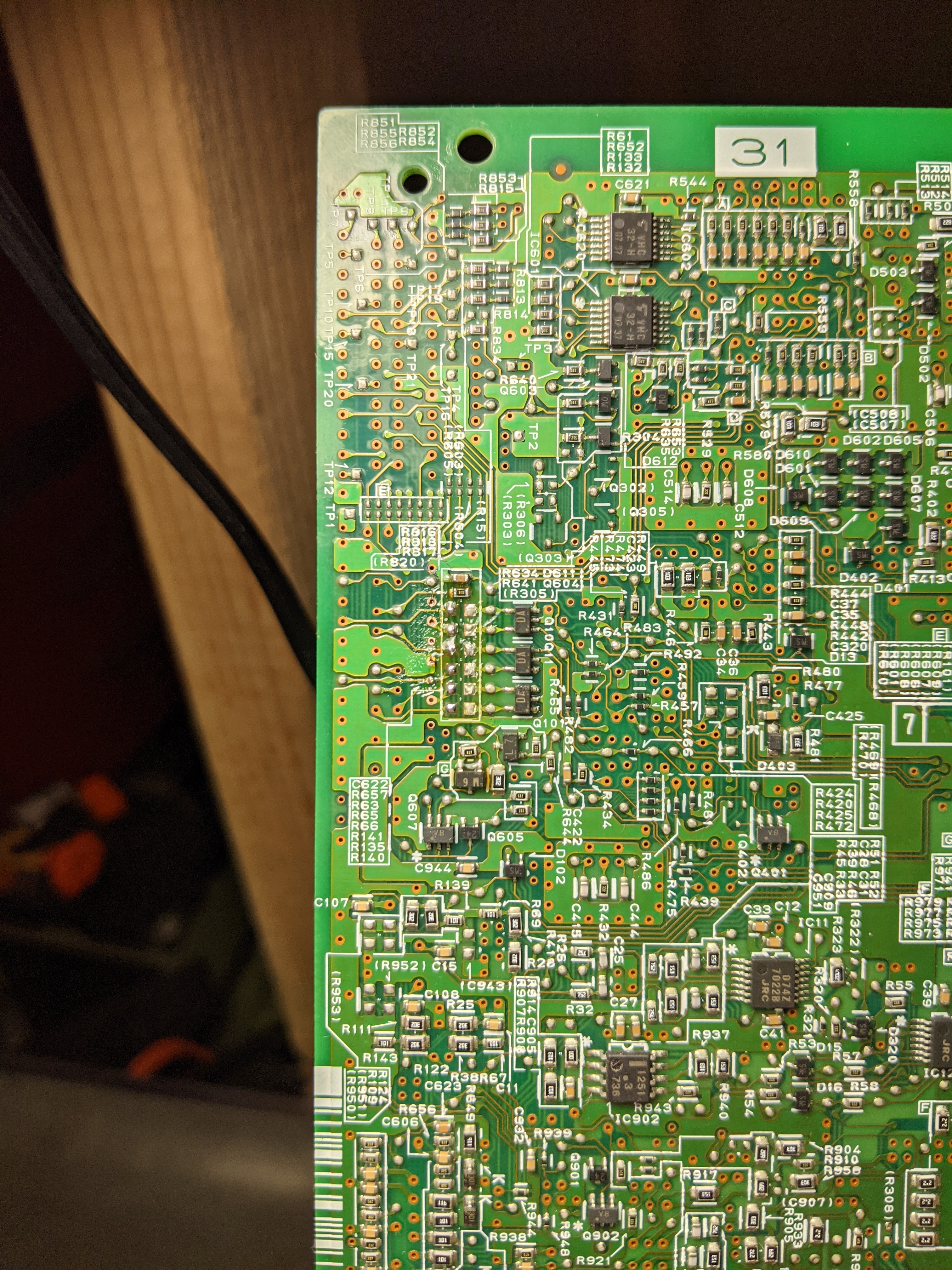

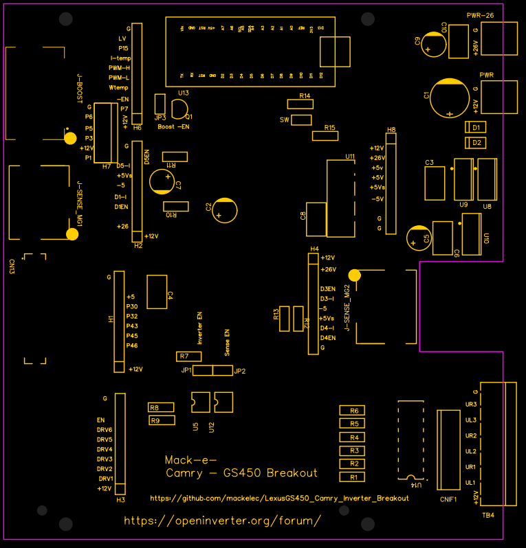

I'm ready to get a PCB made.
Everything is on this Github
If I have described something wrong or have missed something please let me know.
(The outline of the Toyota PCB and holes in on github as DXF)
Camry Hybrid Gen 1 Inverter Hacking

What's the status on this? I'm considering using my GS450H inverter with johannes brain, do you think I wouldn't be too far off if I'd base my board on your latest pinouts?mackoffgrid wrote: ↑Fri Nov 27, 2020 8:35 pm I have received my PCBs and was going to test it out this week but another job may have pushed that back.
- mackoffgrid
- Posts: 93
- Joined: Thu Jan 02, 2020 10:18 am
- Location: Brisbane Australia
- Has thanked: 4 times
Re: Camry Hybrid Gen 1 Inverter Hacking
I haven't tested the PCB yet - too many projects
The thing with the Camry Inverter is that not all the Fault and Temp lines have been identified. This is not a problem for my application.
If you use my gerbers it will cost $10 or so at JLC to try it out
The physical dimensions, holes and connector positions are fine.
