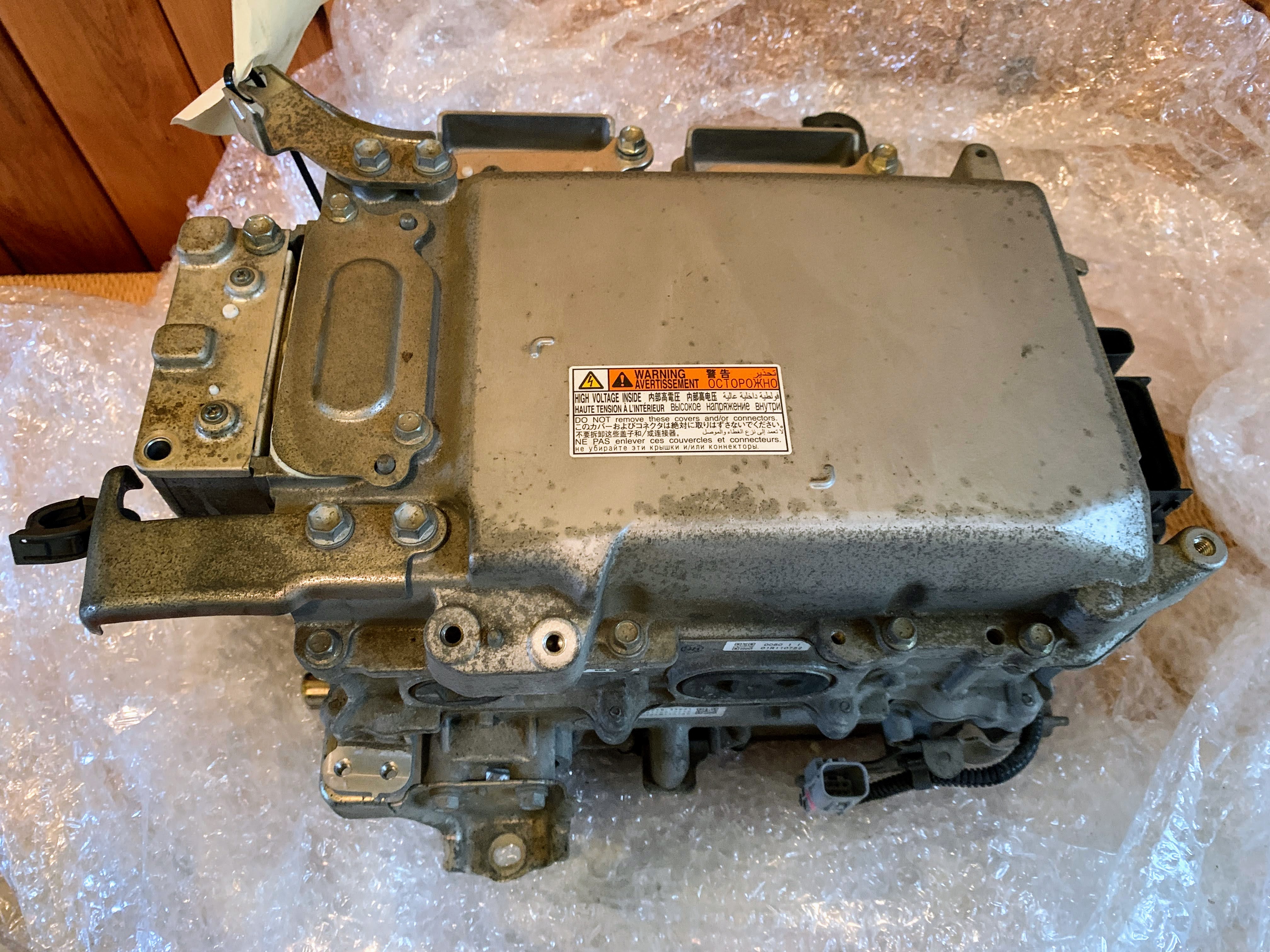

I've just bought myself a G9200-33171 inverter from a Toyota AVV50R Camry Hybrid (also used in the Lexus ES300h and Toyota Avalon Hybrid), as well as a G9200-52010 from a Prius C. I'll be taring these down in the coming weeks, and will be ordering at least one Auris/Yaris/Prius C control board. I'll eventually be testing these with Outlander PHEV rear motors.
The Camry inverter looks like:
View of unit. Am curious what the connector is towards the bottom. The cable runs around the corner and into the bottom of the unit through a grommet.
-33020 is from an 2007-2011 Camry -
-33171 is from 2012-2016 Camry, Avalon and Lexus ES300H
Neither are compatible.

Not compatible, or never tested?

I have a G9200-33172 from a Toyota AVV50R. Looks identical to yours.
