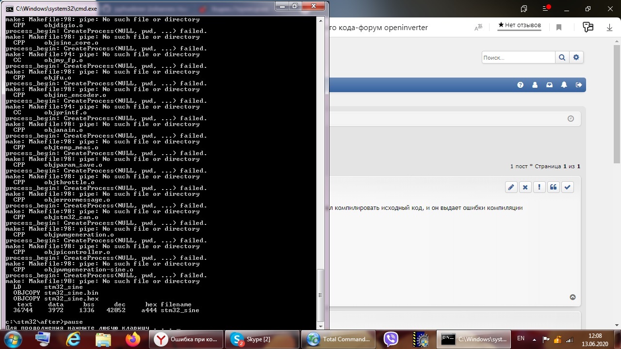

Hi JOHANNES! I compiled the libopencm3 library, then started compiling the source code, and it throws compilation errors

These are the errors

I put together a script for Windows.
You will need:
1) Python3 to compile libopencm3 library (and use Johannes version)
2) GCC 4.8 for Windows
3) ARM Embedded compiler
4) MinGW

You can write how to run the script?

yaroslav wrote: Mon Jun 15, 2020 6:55 am You can write how to run the script?
It is a Windows PowerShell
1) Open PowerShell console (Start -> search for powershell)
2) Navigate to directory -> cd C:\...\...\
2) Run script (normally with .\ just like linux) -> .\script.ps1

Issued these errors:
You cannot call a method on a null-valued expression.
At D:\test\source.ps1:24 char:23
+ foreach($item in $zip.items())
+ CategoryInfo : InvalidOperation: (:) [], RuntimeException
+ FullyQualifiedErrorId : InvokeMethodOnNull

Что я делаю не так?

It's a million times easier to just use a gitpod environment in your browser:
viewtopic.php?f=7&t=267#p3179
