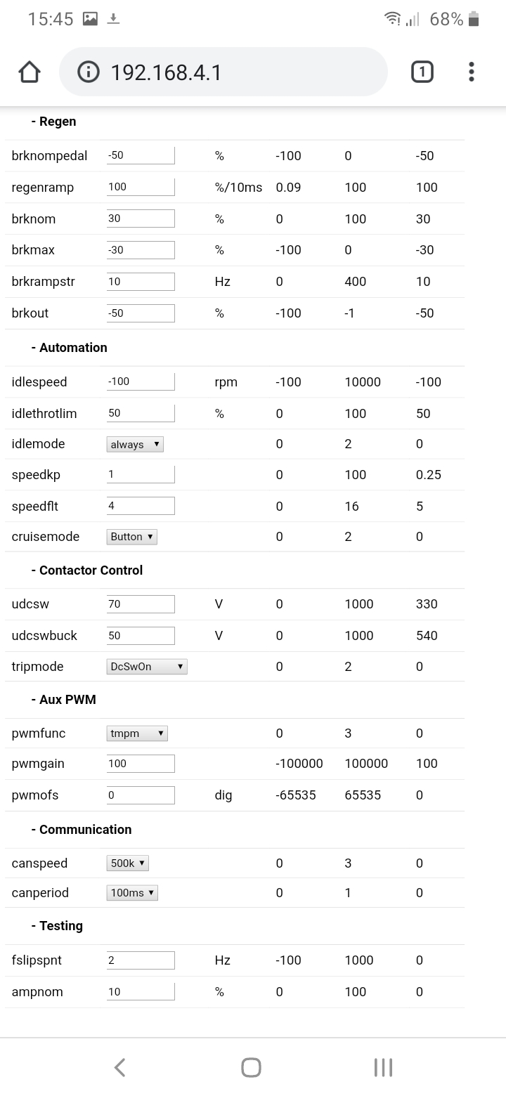

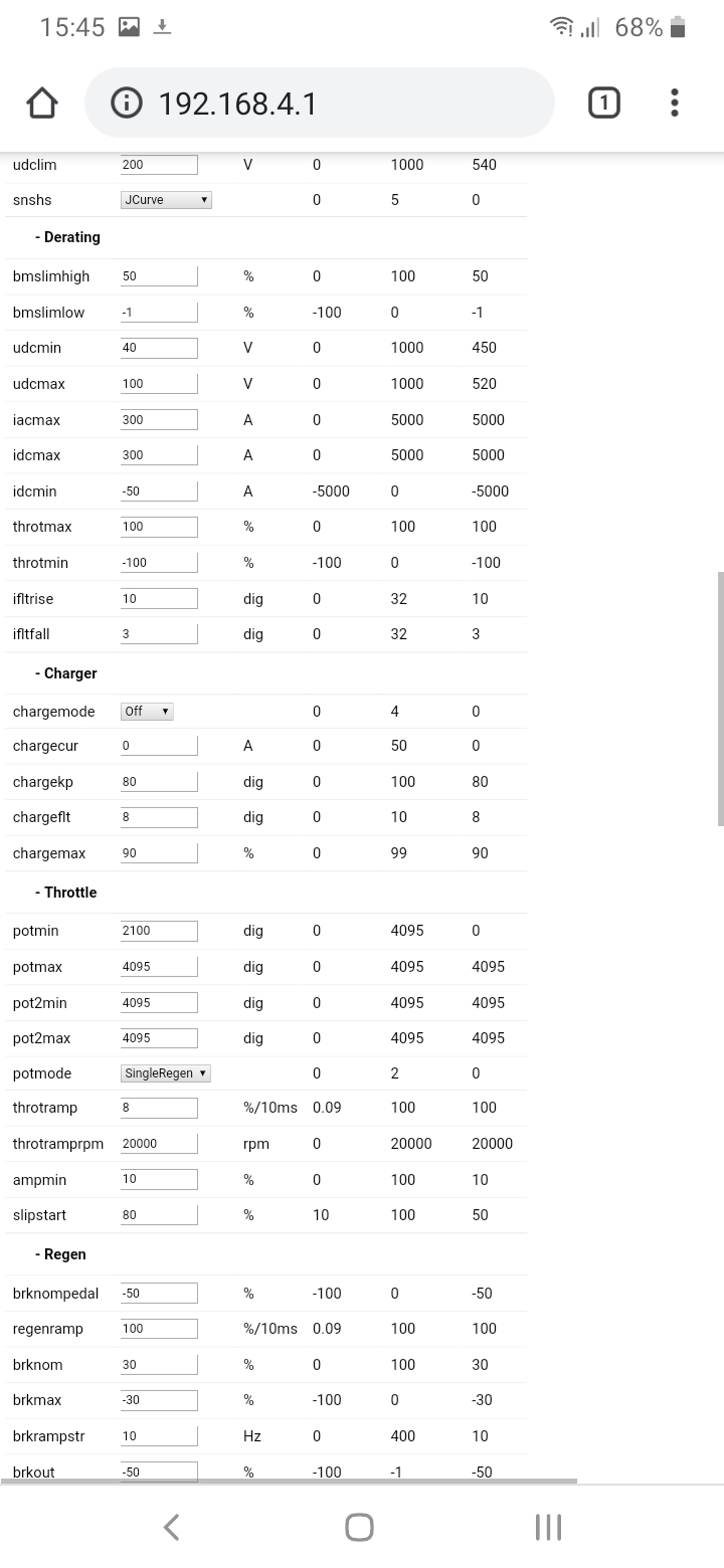

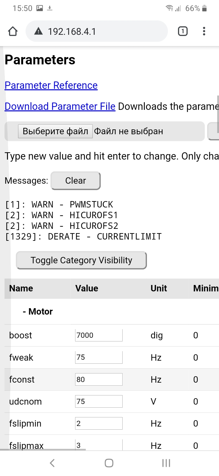

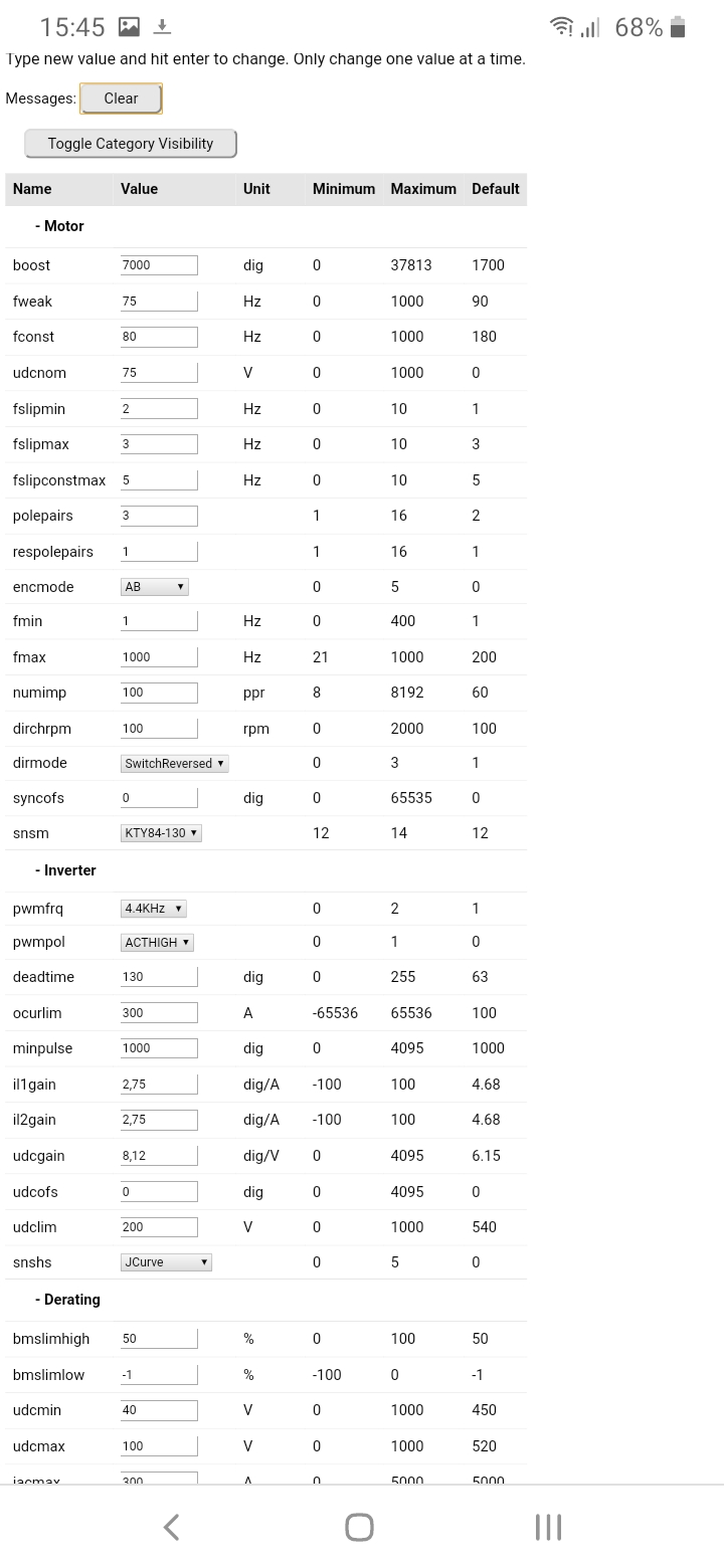

Interesting yet scary thing I've encountered today: if parameter "throtramp" contain a fractional number, there is an issue when vehicle accelerates on its own, but at the time throttle input is at 0% and pot value is lower then potmin parameter. If throtramp is integer, everything is OK.
Posts: 6772
Has thanked: 385 times
Been thanked: 1595 times
Re: Inverter Firmware v4.85.R
Oh that sounds scary indeed. Will check it out
konstantin8818
Posts: 290
Location: Minsk, Belarus
Been thanked: 10 times
Post by konstantin8818 »
johu wrote: Mon Jun 29, 2020 8:08 pm Oh that sounds scary indeed. Will check it out
So I've tried to recreate this bug today, but it didn't showed up. May be this was a combination of parameters, and maybe it's because all my signal and HV wires are not screened and crossing. It might be just radio interference.
Update.
It showed up. It is not depending on fractional digits. This is what parameters look like when it appeared:
So pot value is below potmin. But at same time throttle input is 100 percent.
Only disabling the board resets this bug.
