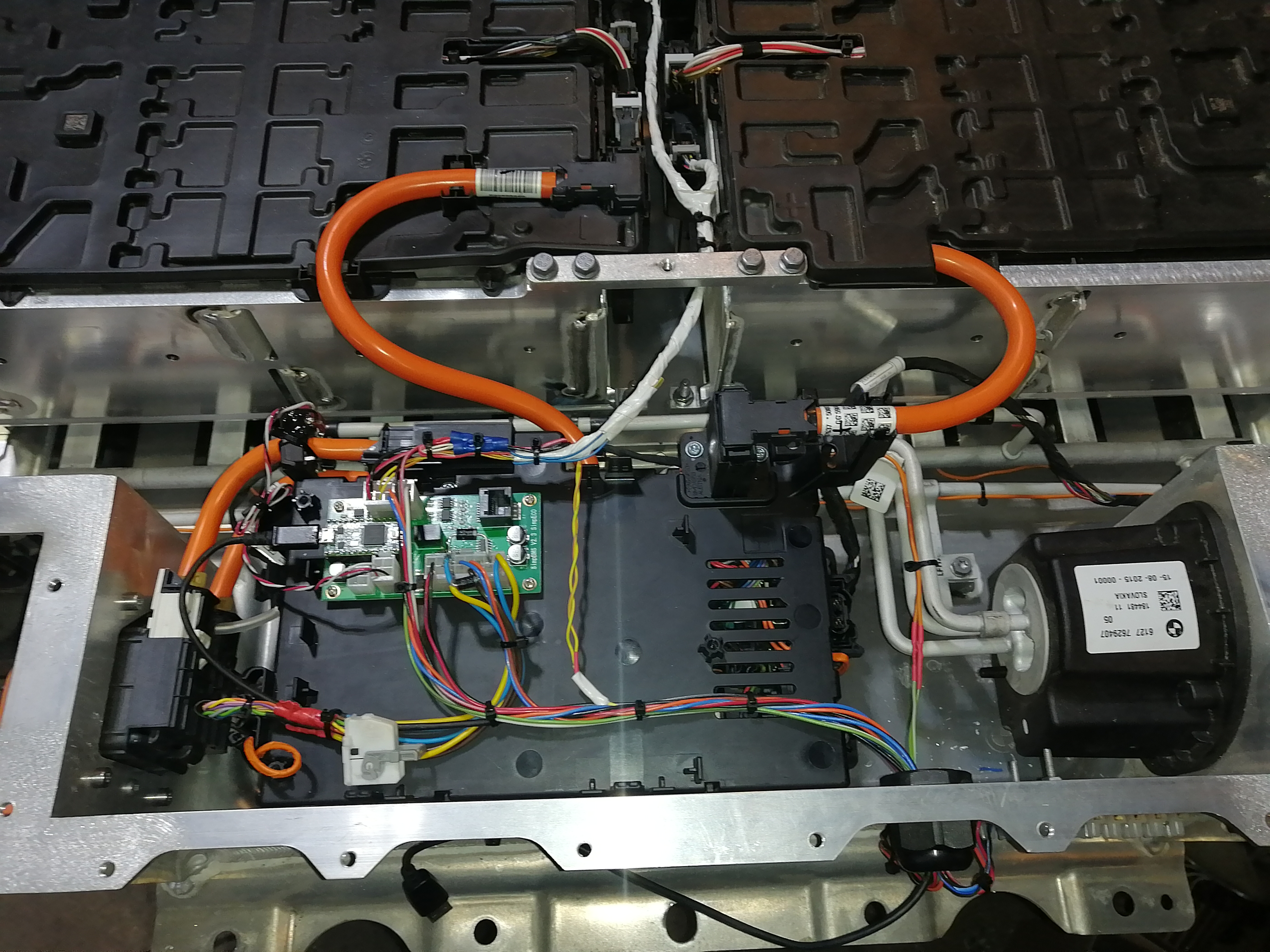

I had a problem... the motor has no regen, as soon as I try to apply brake, It accelerate rather than slowing down, I thought it was related to a bad parameter, so I tried all kind of settings with no luck, the problem was the syncofset... it was perfectly dialed in at example; 16000 but in fact I have found that it can also be tuned at example; 32000, and now I got regen as it is supposed
The BMW battery have been modded with simp bms and seem to work perfectly
Battery, inverter and motor have been tested together, so far so good... still a little problem with the simp bms current sensor reading, I got little false reading sometime, I will probably need to add a little filtering cap to the ADC input. Still need to implement the can message in the inverter to read battery staus
Next step is the charger, I will go with the boost mode at 120Vac, since the 240V is to high for my pack voltage, in fact I would need around 180Vac rectified to 254Vdc... Will see how it goes, I might also build charge station on 240V with a step down transformer or simply an auto transformer... will see

No, sorry and the battery will not be dismantled for now, since I use the complete battery for the project, SIMPbms have been installed on the battery without problem
