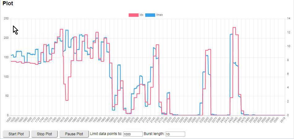

For example this is a plot of ilmax and idc, in a 2145kg (4731lbs) truck with a Siemens ACIM motor and 300V battery.
First values are start on flat ground and the the higher one are slowly drive up a 10cm edge in to my garage.
I get about 200A ilmax and 12A idc.

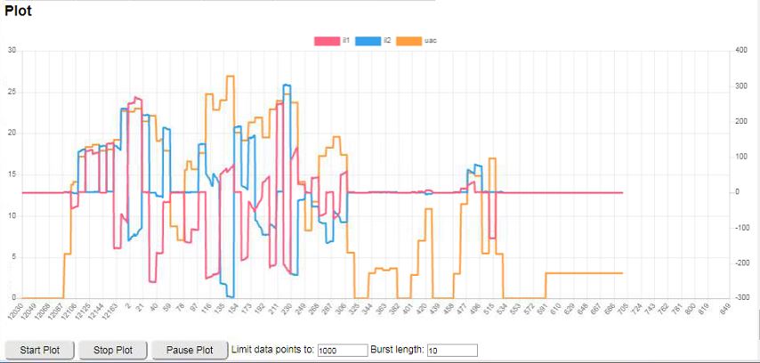

Same truck, same situation:
il1, il2 and uac.

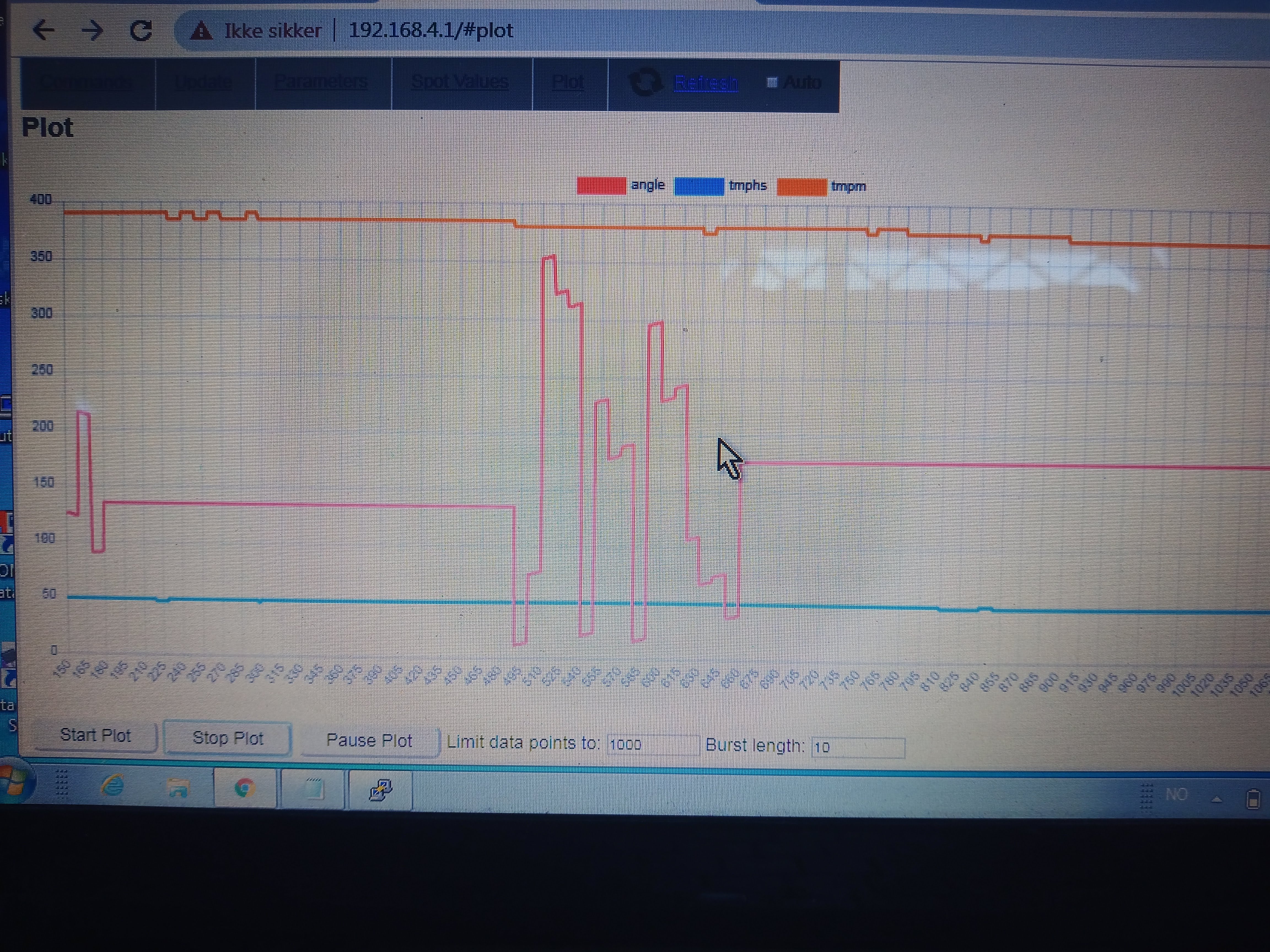

Is this normal?
When I plot angle I get changes from 0 to 360, when truck is completely standstill!
Sorry about the picture quality, was in a hurry, will u/l a better one.....

I'm getting the same changes, haven't yet been able to see if it runs (blew up my inverter again).
Angle just keeps changing. No idea what causes it. Does rotating your wheels also affect angle?
