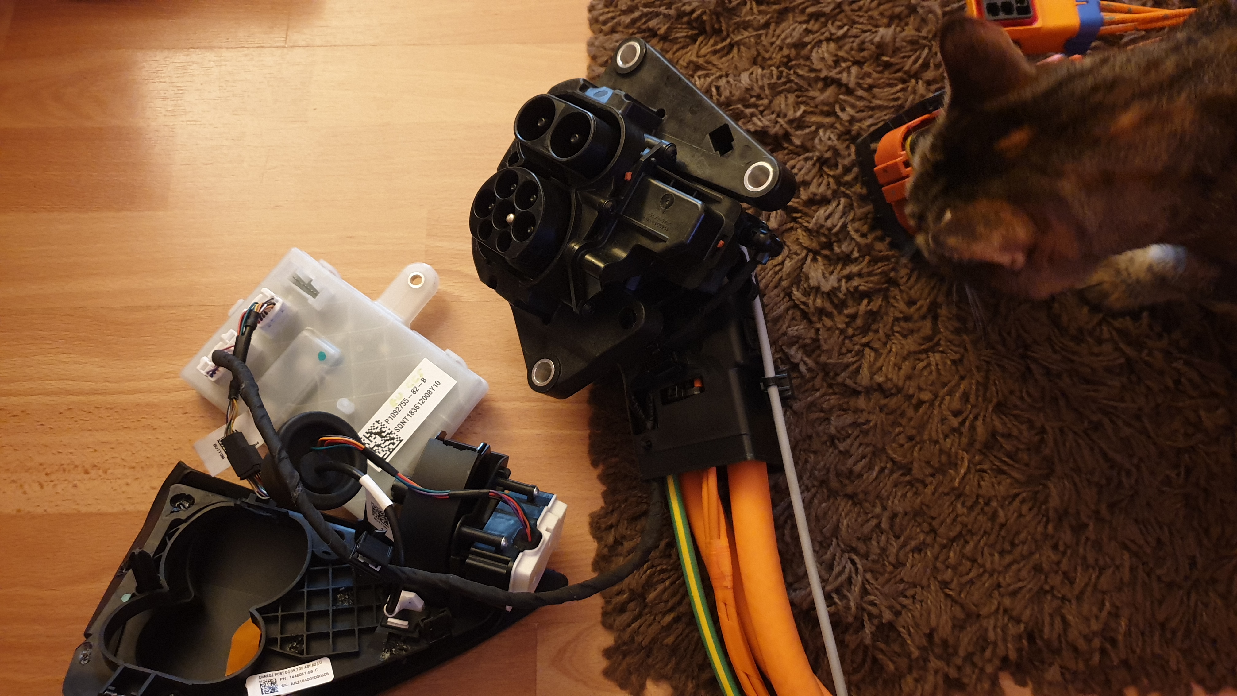

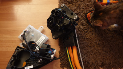

So it turns out that the single bolt holding in the CP ECU is really easy to remove.
So I did, and swapped the existing port / door with the eBay one. Because otherwise it's impossible to contort the assembly to fit in any way other than the correct way.

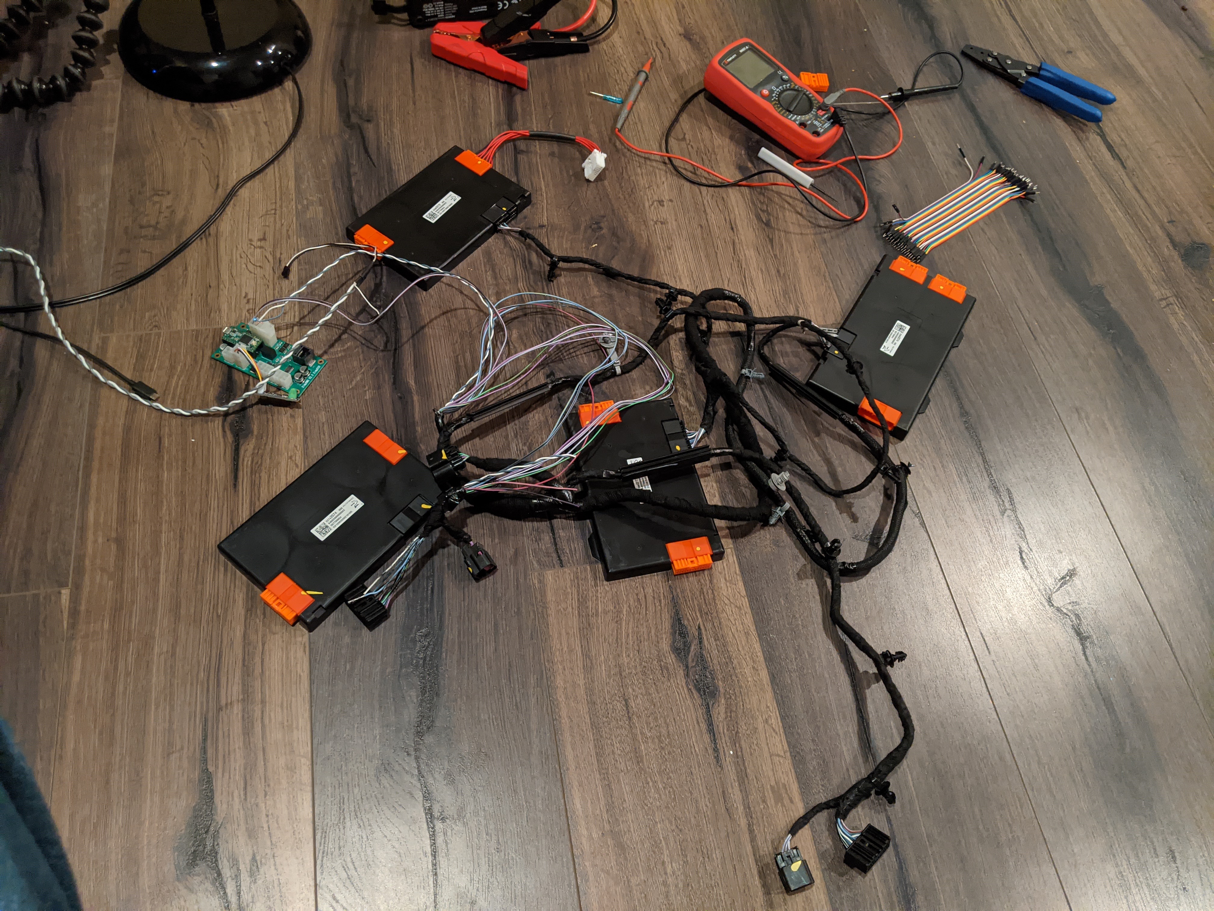

In other news I've started cleaning up the M3 harness from the horrible spaghetti monster it was, trying to do 5-10 pins a day. Should have that done in a week. Just trying to not overwhelm myself.

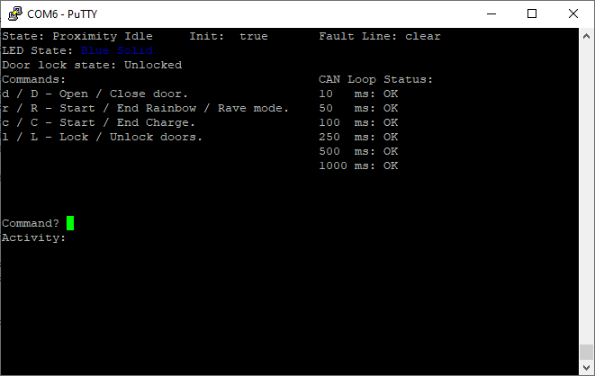

Cleaned up the serial console / command input code greatly. It looks pretty, but doesn't do much more yet

Greatly cleaned up the M3 wiring harness, but that's not done yet.
Also found out that again it was not sending all IDs. I needed to increase the TX buffers from the default of 2 to 8! But I'm sending 26 IDs at this point....that should give you a better idea of how involved this is. I can get a white LED at times depending on timing of when I power on the ebay ecu. I can also get it to turn on the relay if the cable is plugged in when powering it on, sometimes. So it's annoyed (therefore red LED), but there's a small window in which it will listen.

Like so:
Serial.print("Commands: ");
Serial.write(27);
Serial.println("[4;44H CAN Loop Status:");
Serial.println("d / D - Open / Close door.");
Serial.println("r / R - Start / End Rainbow / Rave mode.");
Serial.println("c / C - Start / End Charge.");
Serial.println("l / L - Lock / Unlock doors.");
Serial.write(27);
Serial.print("[15H");
Serial.print("Activity: "); // Response on 11
Serial.write(27);
Serial.print("[14H");
Serial.print("Command? "); // Response on 10[/code}
// Then in the loops themselves:
// Globals
const char COMMAND_POSITION[9] = { 27, '[', '1', '4', ';', '1', '0', 'H', '\0' }; // 14,10
const char ACTIVITY_POSITION[9] = { 27, '[', '1', '5', ';', '1', '1', 'H', '\0' }; // 15,11
const char NO_ATTRIB[5] = { 27, '[', '0', 'm', '\0' };
// CAN status
Serial.write(27);
Serial.print("[5;44H 10 ms: ");
if (loop10msResult == 31) // Returns 1 for success - use bitshifting for multiple IDs - 5 in this case.
Serial.println("OK");
else
Serial.println(loop10msResult);
Serial.print(COMMAND_POSITION);

Just got the new eBay CP ECU from a 2019 Tesla. I got the DC connector yesterday. I'll add pics later, but for now:
So, definitely need to take into account differences in firmware on these CP ECUs. 2019+ seems to be where the change was made that my code was already working for. Now I should be able to put together my trunk again for now.

Is Collin's FlexCAN library the best to use on the Teensy 3.2?

I thought perhaps the millis() value was overflowing, nope.
Turns out there's a piece I missed from the example that I thought wouldn't make a difference... that does make a difference.
Be sure to put static CAN_message_t - something with the allocation of memory on this hardware goes a little haywire. I had removed static from the VIN ID one, as, logically, it doesn't need to be static anymore, as it wasn't crossing function boundaries. Turns out we want static anyway.
It's been running for over two hours this morning without an issue. That was definitely the problem. Of course, as I write this...the LED went red, the CP unit restarted, but it resumed back to where it was supposed to be. Fun times.

Edit: Putting an uptime count back in, and we're at almost 10 hours uptime no issues..I wonder if there's some capacitance thing going on with the laptop trackpad. The Teensy is currently USB powered.

Hope to join you on this soon. Have an eu charge port and both eu and us chargeport ecus:)

I have the charge port and both EU and US cp ecus so could do some hardware investigation on those and also some CAN logs if that helped. I'll start a thread in the fast charge section to avoid cluttering here.

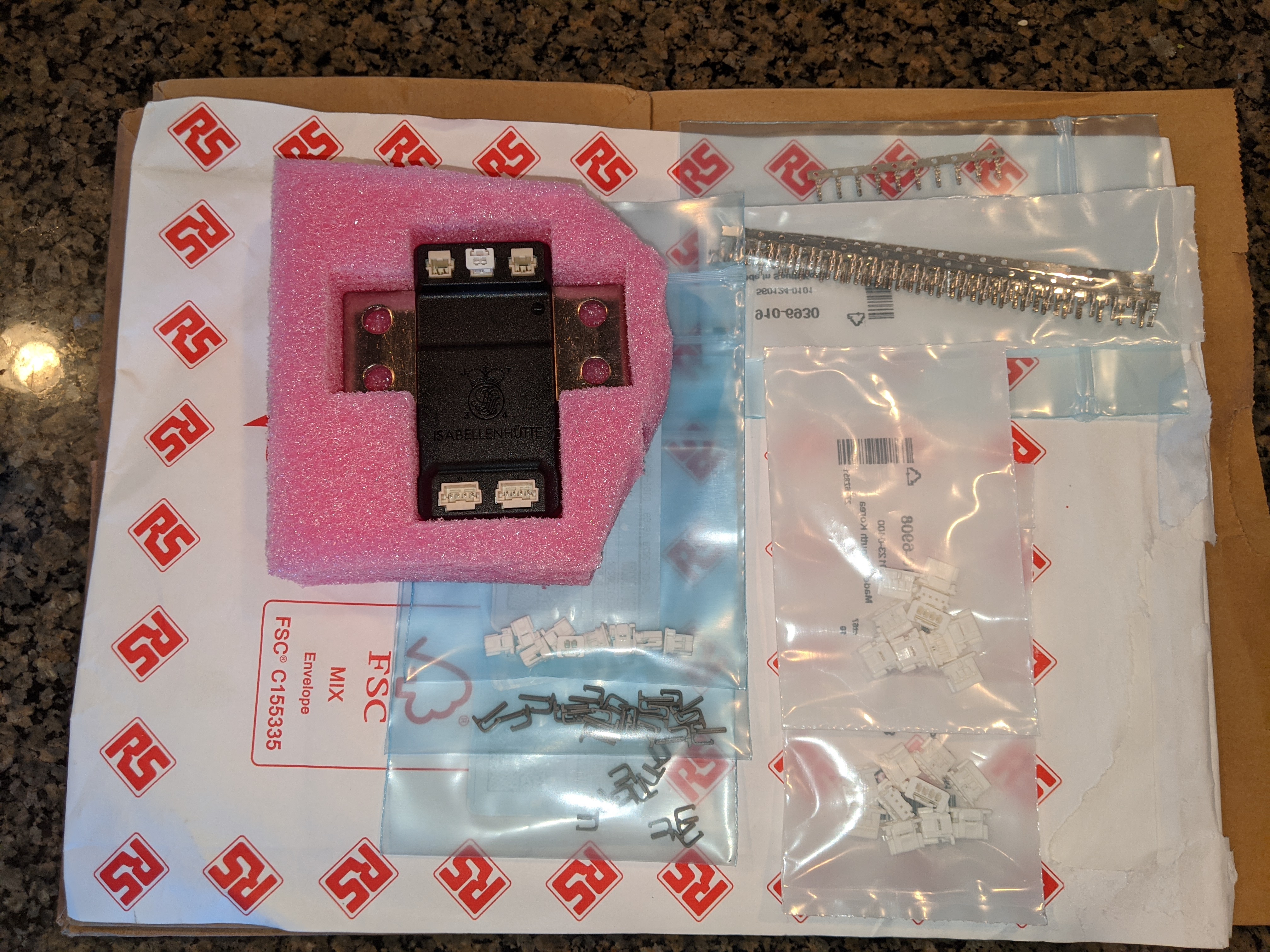

Finally got all of the connectors in for the ISA shunt: I can definitely whip up a kit of connectors for $8 + shipping for those in the US. The place Jon sent me toward not only had the kit listed at $33, there was a "minimum order" of $35, and THEN $10 shipping on top of that. I think I can send via US mail for like $4 so..$12.

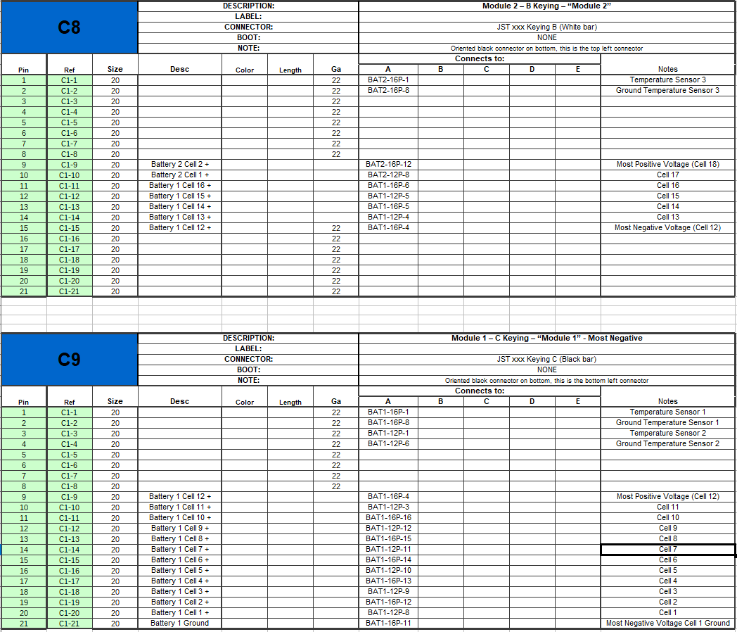

I also started on determining the wiring for the Volt BMS modules, like so: It's not entirely done yet, but it should allow me to wire up module 4 and see how that's going. I'll probably wire that up tomorrow.

I wired up 3, yes, three whole connections today to the first battery module. The pins for the JST ATLPB-21-2CD connectors are a pain! All of these small connectors... :-/ The molex connector used on the LG batteries were pretty easy though, so that's good.
I flashed the SimpBMS board back to SimpBMS, and ran into a few issues, which I've reached out to Tom about. (I have no idea how to change certain settings, and the Coda charger support is in the code but unfortunately not accessible due to an easy oversight.
I did some data analysis, I think I'm missing some data still to make the EU Charge Port stuff happy. Going to do a little more of that really fast, then call it a night.
Tomorrow I will wire up the other 10 cells (only doing the first connector), and see if at least voltage readings look good.

Wired the SimpBMS. Tom fixed the Coda charger issue. Yay.
But, it does not see any of the slave boards.
My floor matches my feelings.
-Matt

Wait buddy, you only 1/3 way there. Power for the HV side is derrived from the HV side.....
- mdrobnak
- Posts: 692
- Been thanked: 5 times
Re: 2004 BMW 330 with SMG/SSG Gearbox
HAHA don't I feel dumb.
What's the 5V on them used for, then? Is there a most-positive pin line a most-negative pin, as well? Or just most-negative + cell 1-6/12?
I'll finish wiring up the first connector and try again.
