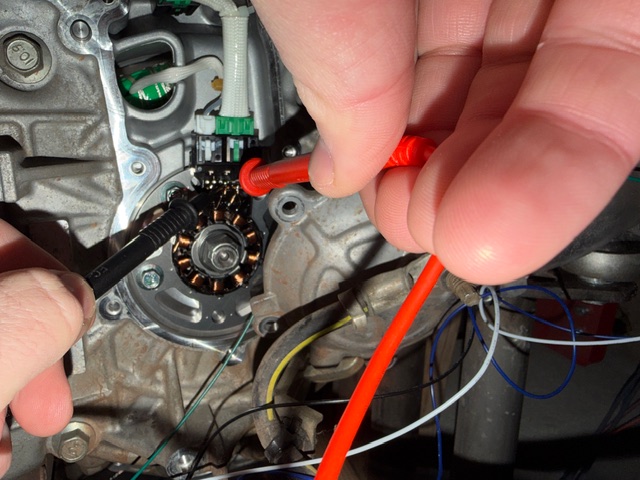

System
Motor: Nissan Leaf EM57
Controller: OpenInverter Johannes Leaf board
Firmware: 5.xx.R-FOC
Resolver is connected directly to the RES_R1/R2/S1–S4 pins on the Johannes board (not routed through the OEM inverter PCB).
Problem
Resolver angle shown in Spot Values remains even when the shaft is rotated by hand.
FOC firmware is running and encmode is set to resolver.
Resolver Connector Pinout
Small 8-pin resolver connector on the motor (not the wiring harness)
				  Top
Away from Motor			1	5	Motor side
				2	6
			clip	3	7
				4	8
				Bottom
Internal pin wiring top top to bottom:
top 1  2  3  4  5  7  8  9 bottom
Using continuity testing between the internal resolver terminal strip and the external connector I mapped the wires as follows:
  • Pin 1 – Green
  • Pin 2 – Blue
  • Pin 3 – Red
  • Pin 4 – Black
  • Pin 5 – Yellow
  • Pin 6 – White
  • Pin 7 – Gray
  • Pin 8 – Pink
Coil Identification
Measured resistances with resolver disconnected:
  • Red ↔ Pink = 10.6 Ω
  • White ↔ Gray = 25 Ω
  • Yellow ↔ Black = 25 Ω
Remaining wires:
  • Green ↔ Blue = temperature sensor
Current Wiring to Johannes Board
RES_R1 → Red
RES_R2 → Pink
RES_S1 → White
RES_S2 → Gray
RES_S3 → Yellow
RES_S4 → Black
Temperature sensor wires (Green / Blue) are not connected to resolver pins.
Firmware Settings
encmode = Resolver
respolepairs = 4
pinswap = None
FOC firmware confirmed running.
Measurements
Resolver connected.
Meter set to AC volts.
Across excitation pair:
Red ↔ Pink ≈ 0V AC
Across signal coils:
White ↔ Gray ≈ 0–0.1V AC
Yellow ↔ Black ≈ 0–0.1V AC
No change when rotating the shaft.
If I reference the meter to another resolver wire I can see some AC voltage, which suggests the excitation signal may be floating.

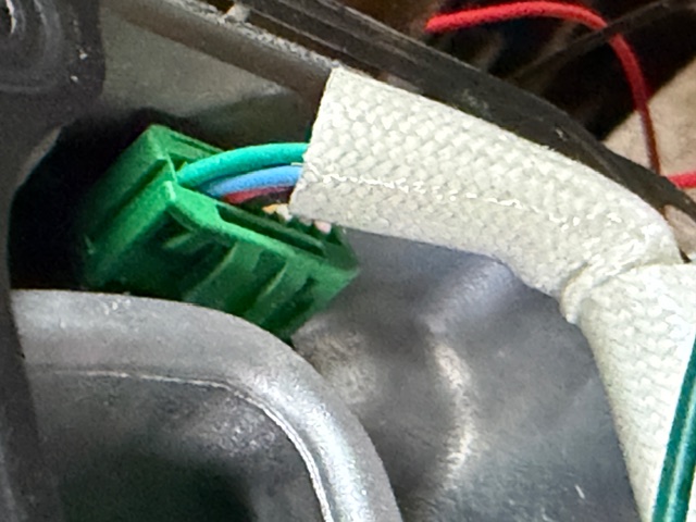

Photos of:
  • Resolver internal wiring
  • Resolver connector pin mapping

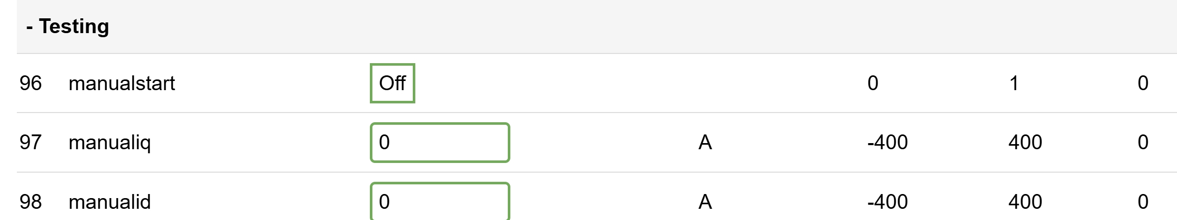

The inverter needs to be in run mode, i. e. set udcsw=0, cruisemode=Off, manualrun=On
Assuming no HV connected
Check for anything on lasterr

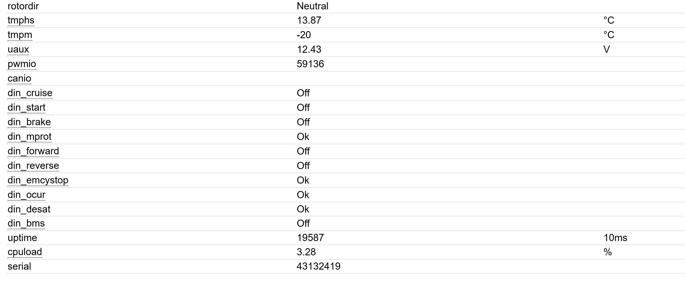

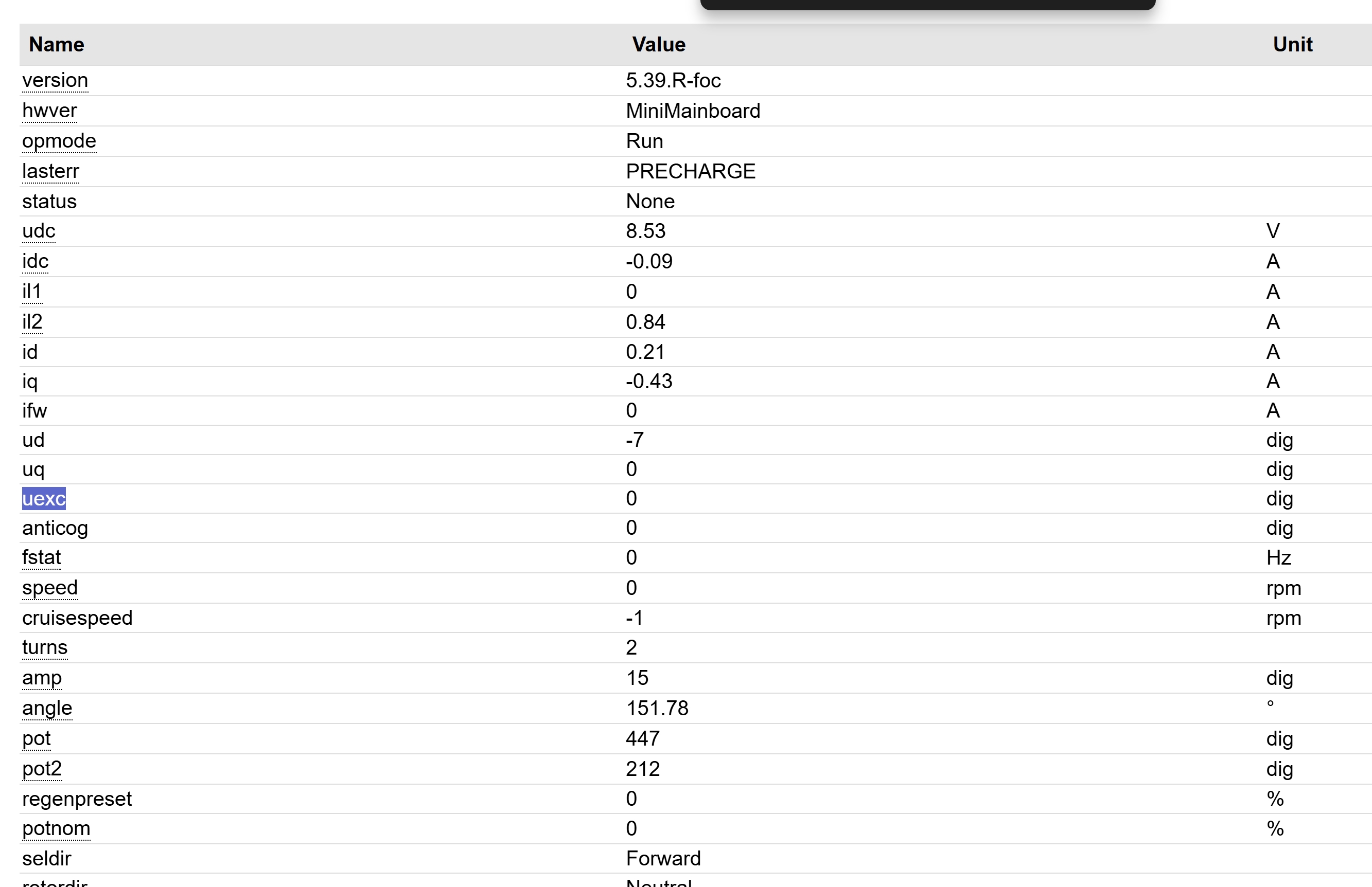

Thanks so much for the quick response.
I don't have manualrun, but I did set manualstart = On after setting udcsw = 0 and cruisemode=off
After this, the angle shows about 150 degrees. But turning the shaft does not update it.
Here are my Spot values:
My friend ChatGPT is telling me that uexc == 0 means the resolver is not being excited.
Been thanked: 1918 times
Re: Leaf EM57 resolver wired to Johannes board — angle stuck at 0 in FOC
Don't trust your friend
uexc is the rotor excitation of non-PM motors (i.e. Zoe motor)
In run state you should definitely see resolver excitation

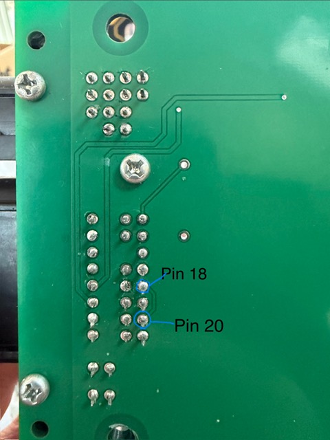

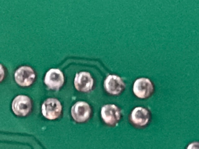

I've found what is likely my problem, RES_S1 and RES_S4 appear to have a short on the board side.
Before I open up my inverter again I just want to verify that this is not the expected behavior. =)
Daajason
Posts: 5
Joined: Tue Sep 23, 2025 9:16 pm
Post by Daajason »
I opened up the inverter to get to the logic board.
There is a trace connecting pin 18 (RES_S4) and pin 20 (RES_S1).
There's a chance I've got the PIN mapping wrong, but I've scrutinized it so many times.
I've been using this layout: https://github.com/jsphuebner/inverter- ... f-gen2.txt
In the upper section where Pin 6 and 10 are, the row that has 2 pins is on the same plane as pin 18 and pin 20.
I must be missing something? Any help is greatly appreciated!
jrbe
Posts: 766
Has thanked: 363 times
Been thanked: 249 times
Post by jrbe »
https://openinverter.org/forum/viewtopi ... 171#p62171
S1/S4 I believe should be connected.
I think you need 5.3v, not 5.0v to get excitation, worth checking your voltage.
