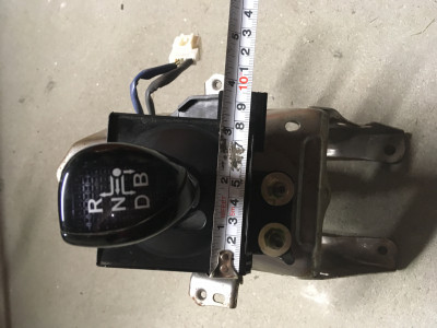

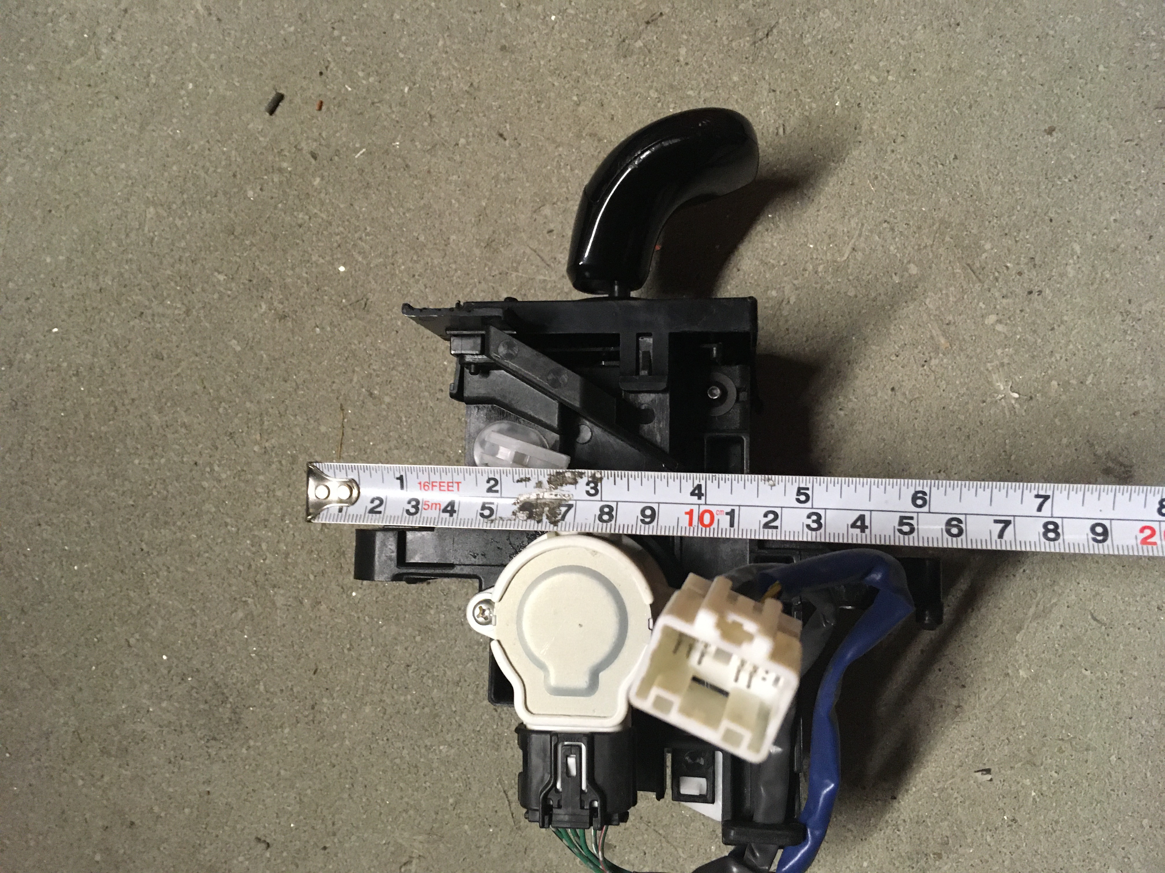

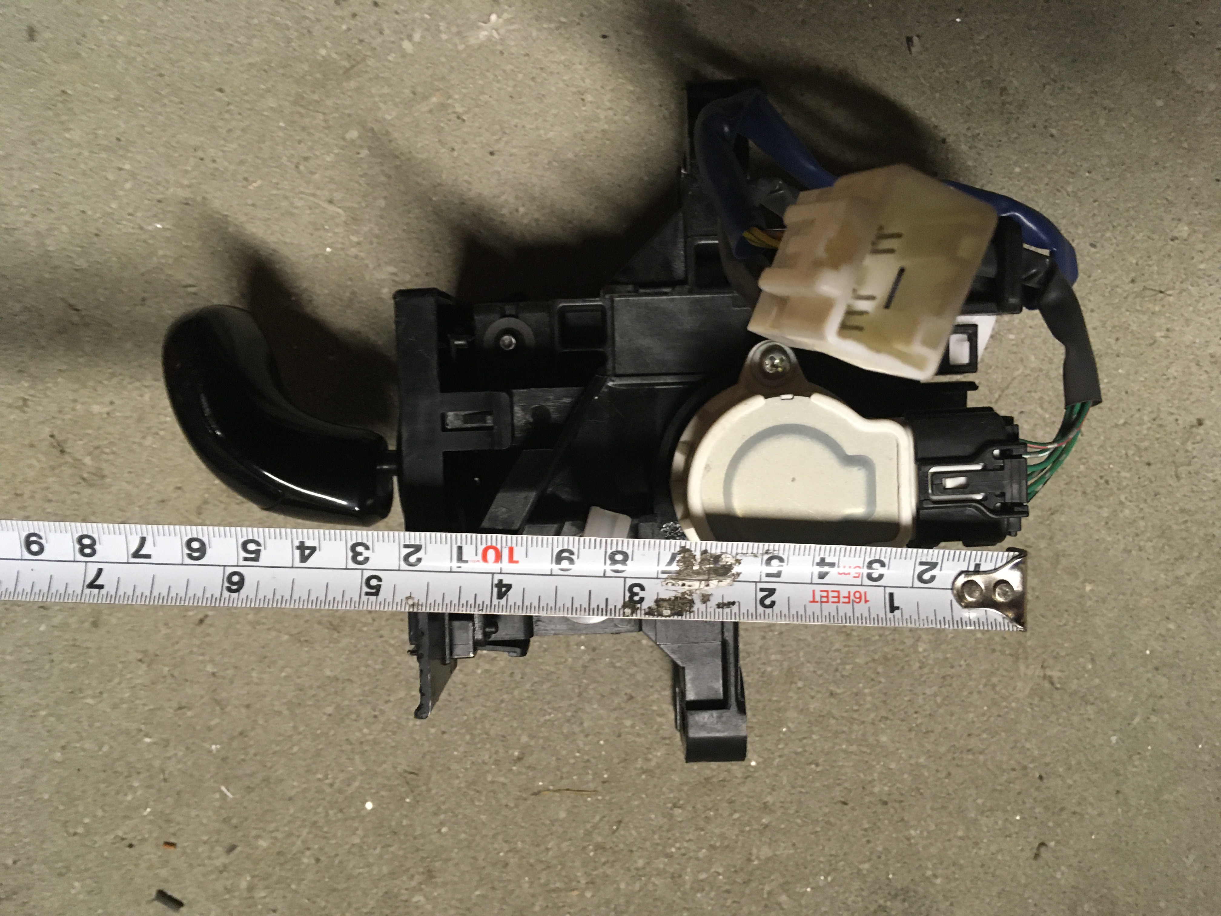

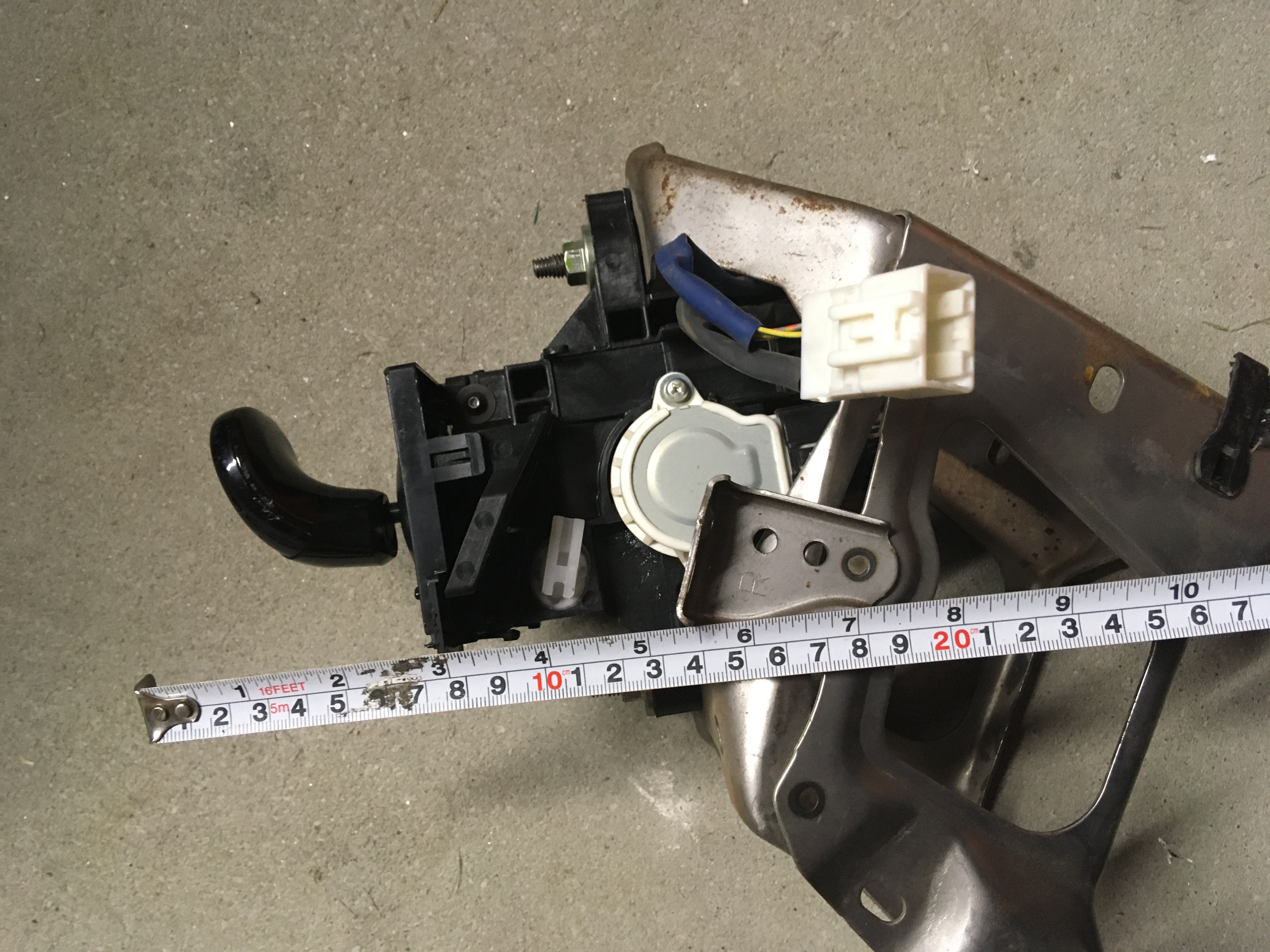

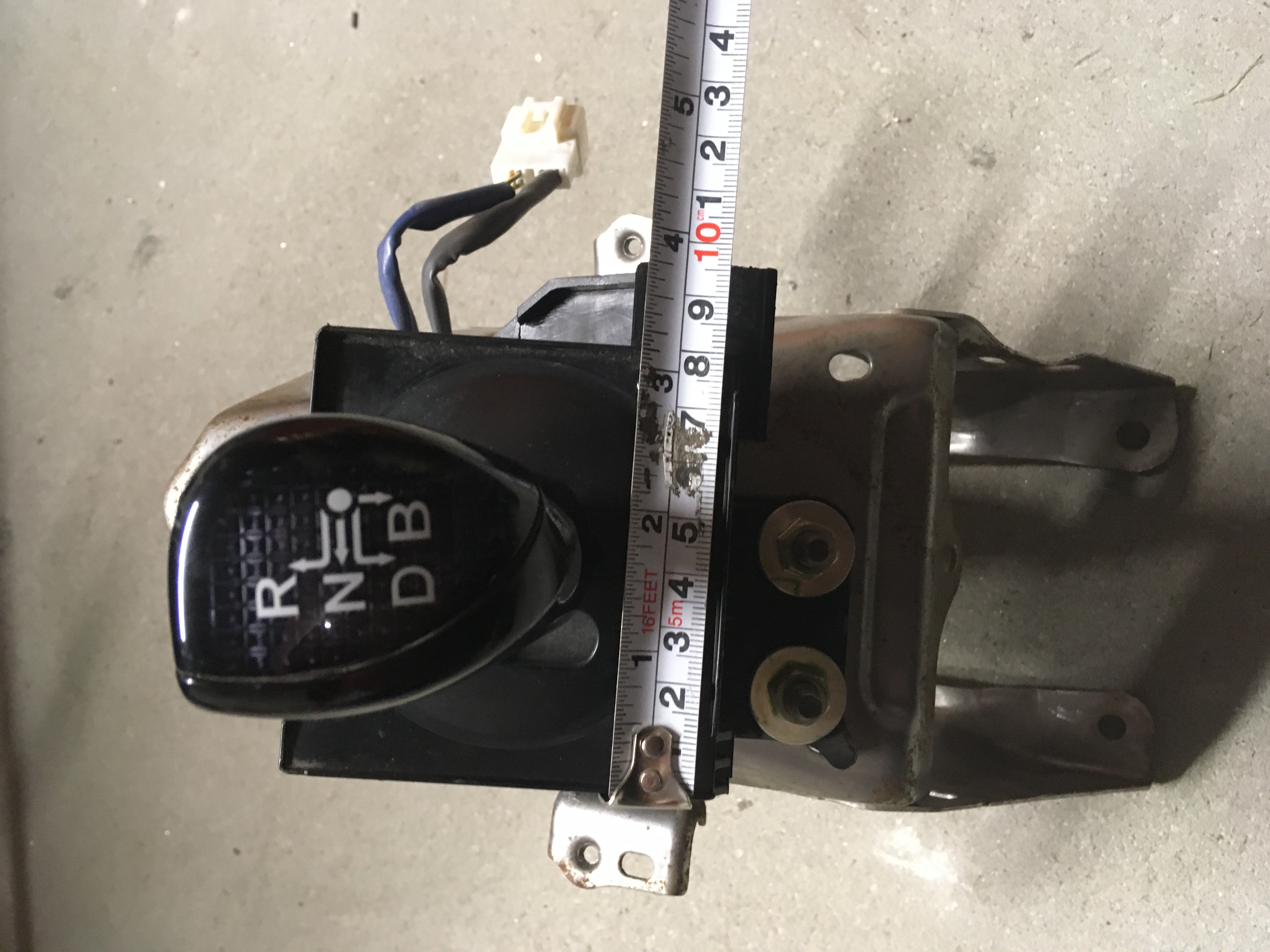

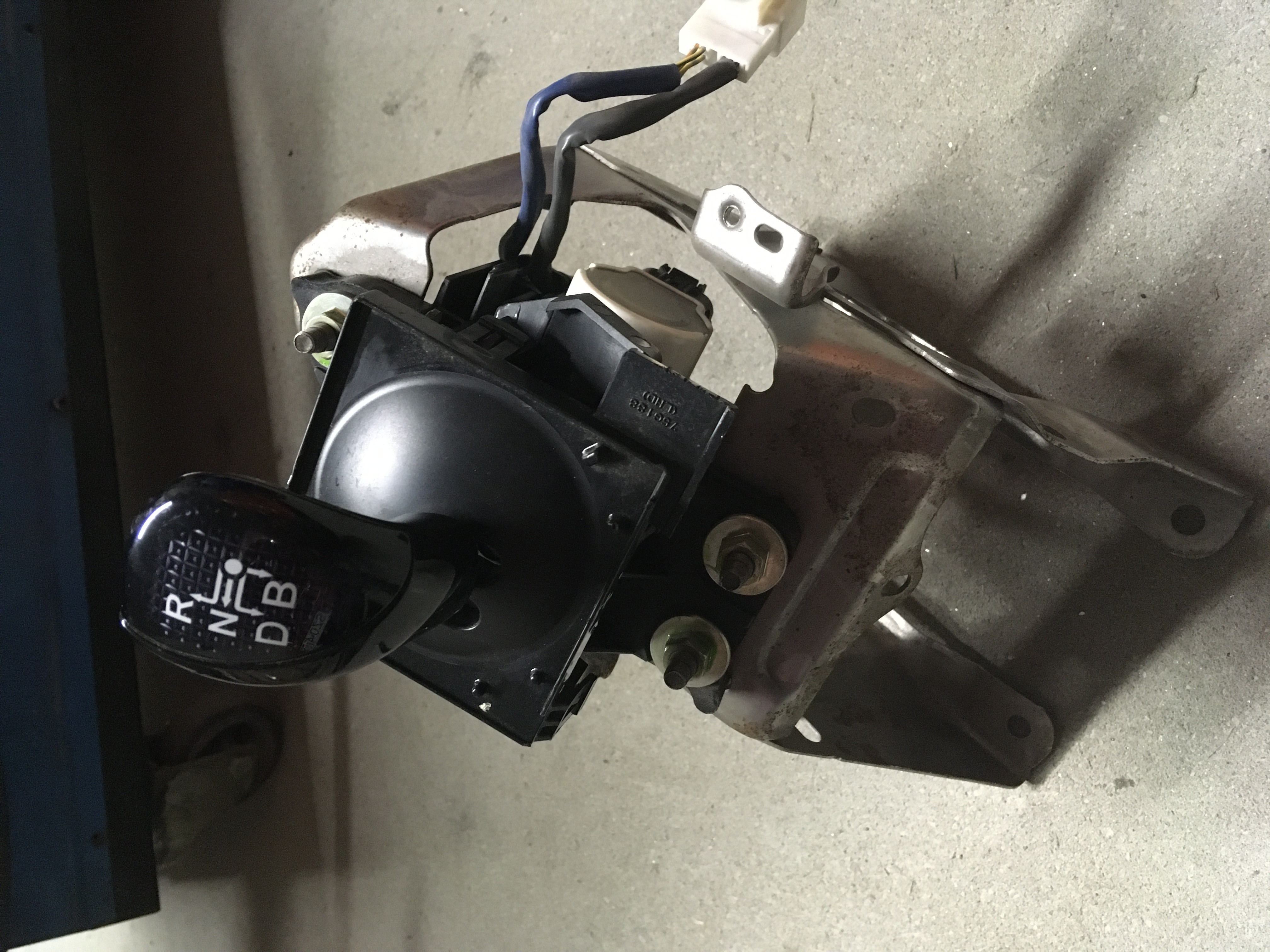

I bought this, because was thinking, that it's multi-stabile-positions like normal car shifter and then I was really surprised, that it's hall+analog. Did You cut everything, what was unnecessary or You leave like it was?
I will put here pictures - maybe will be usefull for someone. Good is, that it's not expensive - mine costs about 5Euro :)

damian.lo wrote: Tue Apr 07, 2020 9:46 am Can You maybe share hardware+software for this?
HI, yes I shared the hardware and software in my first post above.
The only information which I don't have is the type of connector (I just removed mine and fitted my own) and the pinout for the sensors (can be discovered).
I didn't modify the shifter at all. Mine is the same as in your pictures.
