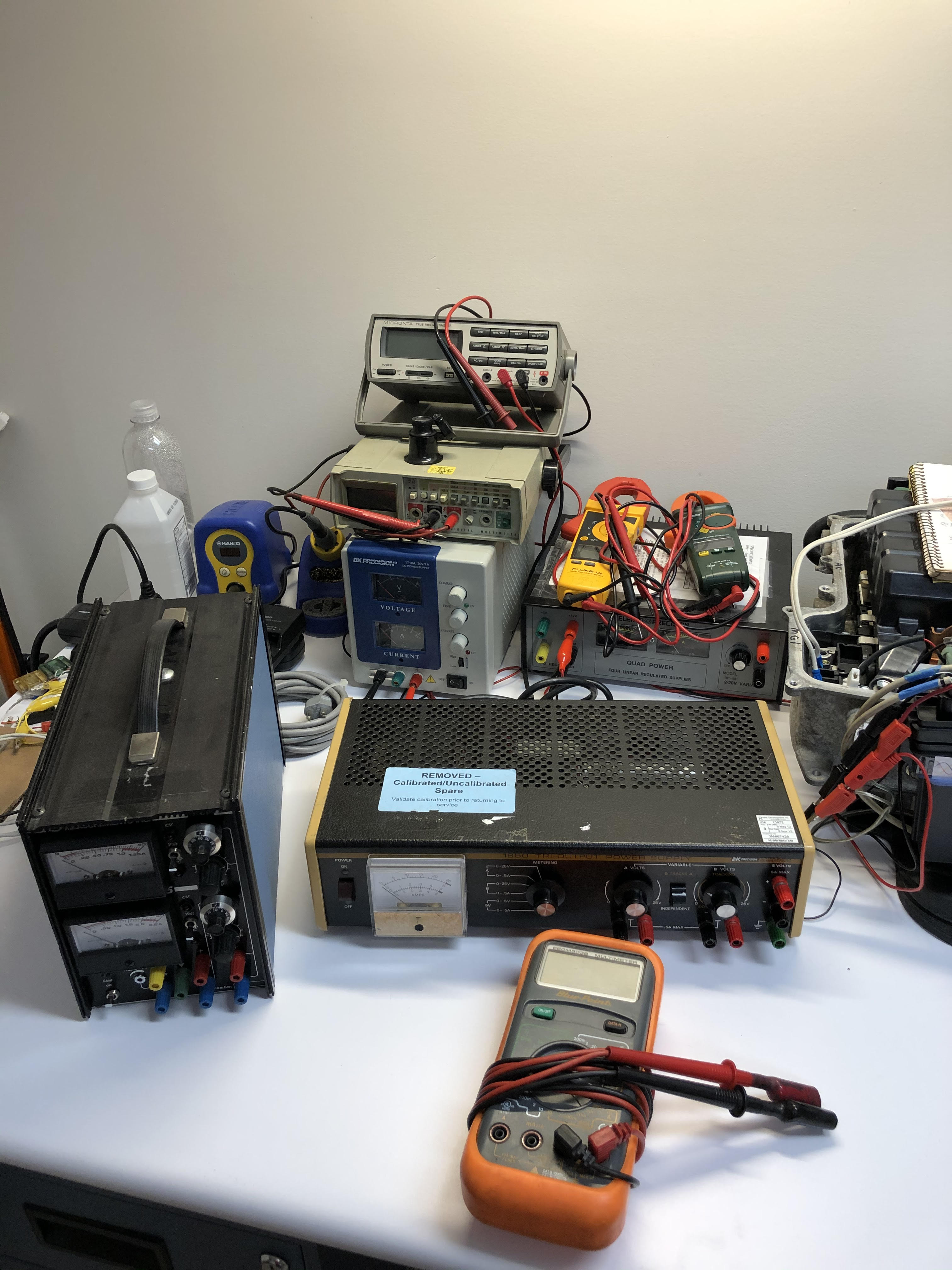

I think I have become a "hoarder" of electronics test gear

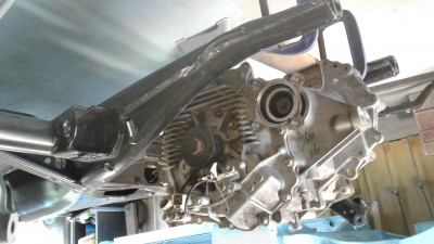

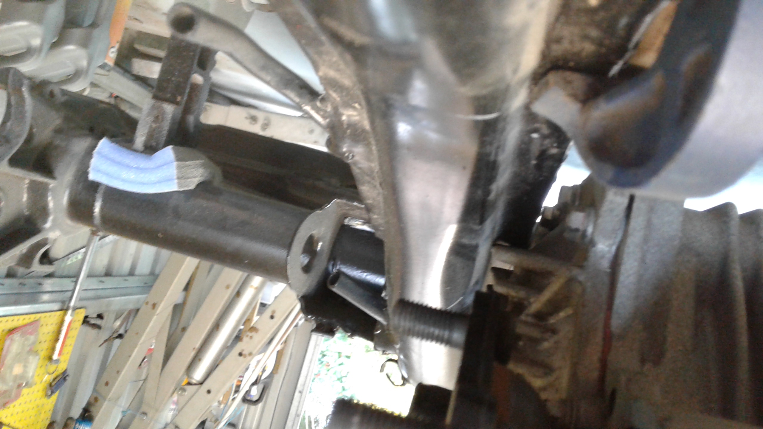

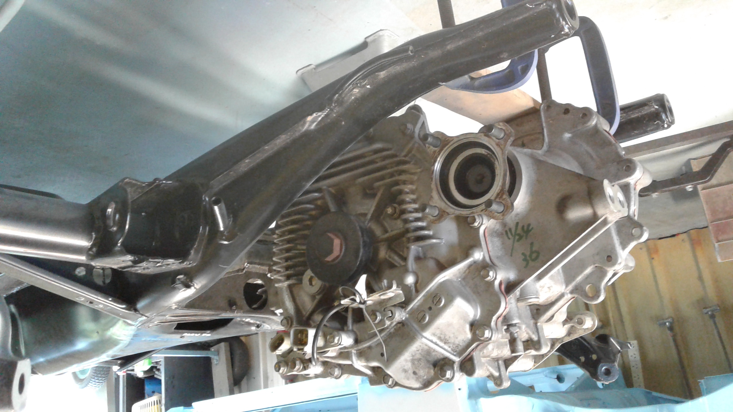

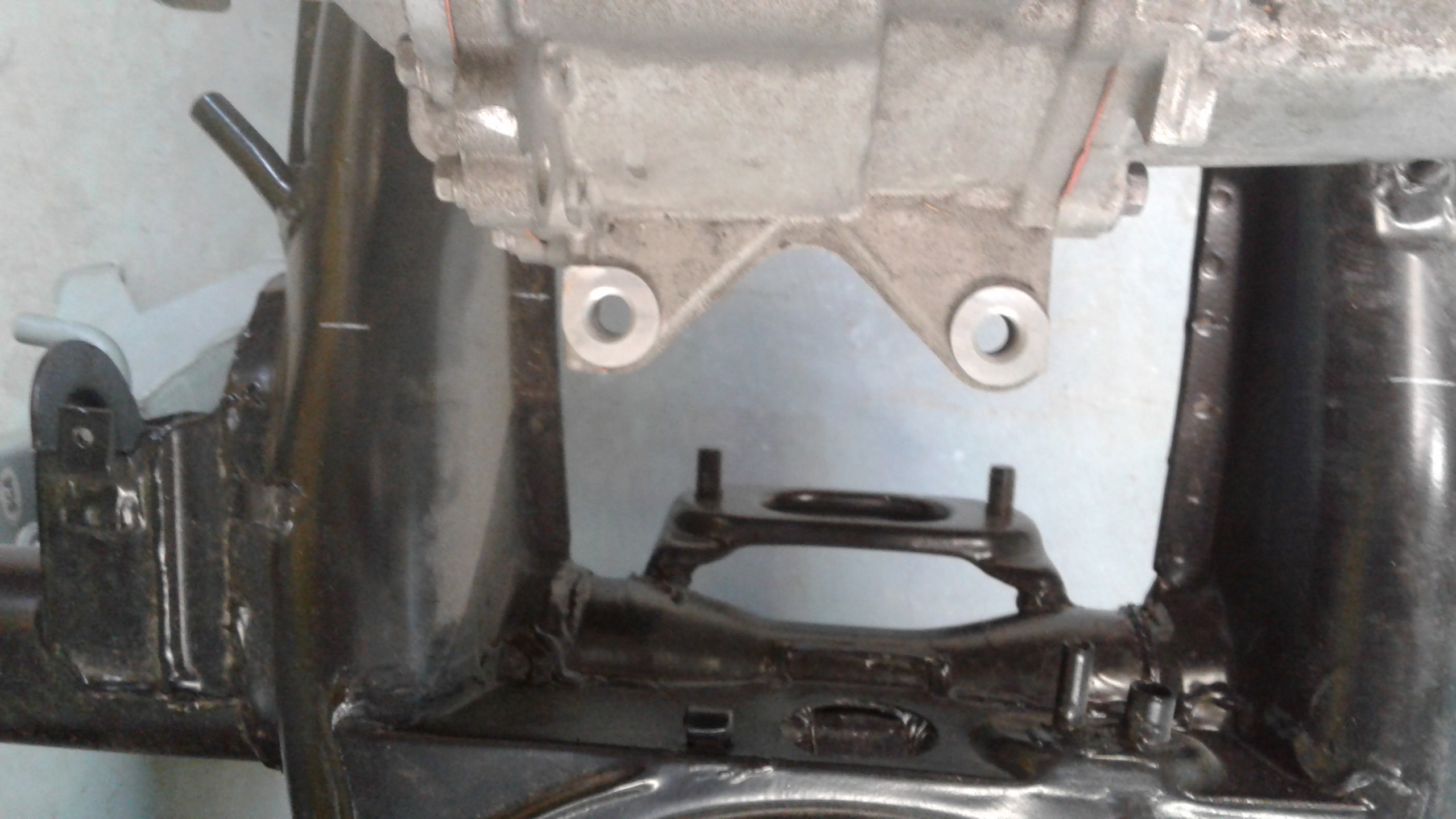

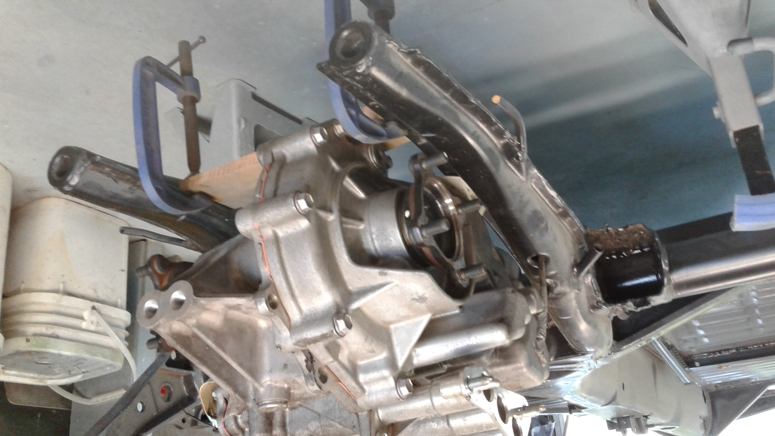

Hi Zookeeper, I though you might like to see these pics of an MGR sitting with its axle centres within a few mm of the original VW transaxle. To get it perfect i would need to lose the bottom cooling fin off the resolver. Fabricating mountings looks pretty straightforward and some firm engine mount rubbers should mean there is little movement to cause problems.
Chris
Chris
Re: VW Squareback DIY EV
That looks very nice! Since the '71 does not have the "horns", I will have a little more wiggle room, but a more complex rear mount.
