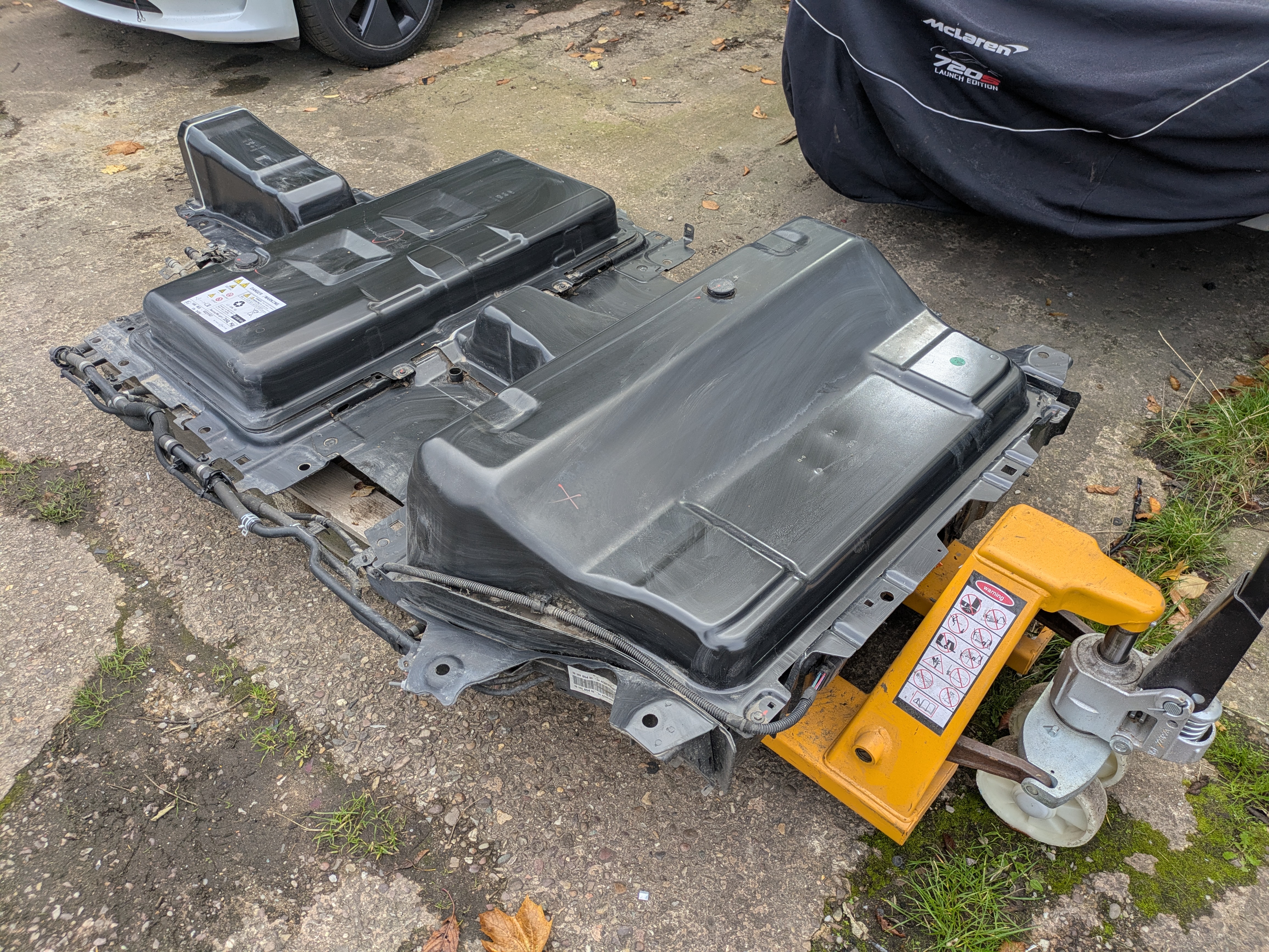

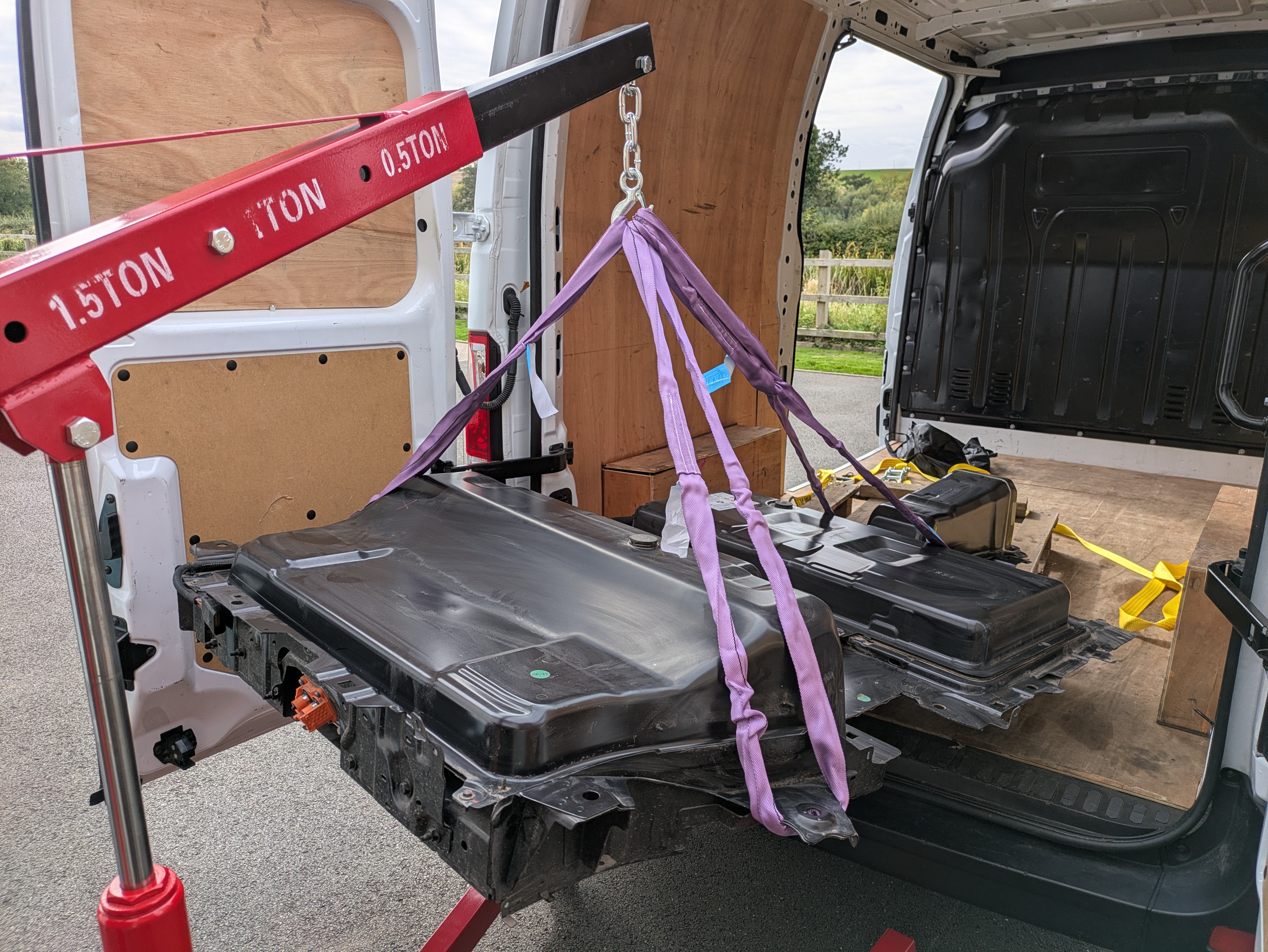

I collected my battery pack over the weekend, and it went remarkably un-sketchy haha.
This is a 50kWh 108S pack found in a variety of Stellantis vehicles, mine is from a 2022 Vauxhall Corsa-e.
All that lovely empty space in my garage is disappearing rather quickly though so I want to get the battery pack taken apart pronto, I made a start but the way it's glued together is proving to be quite a pain.

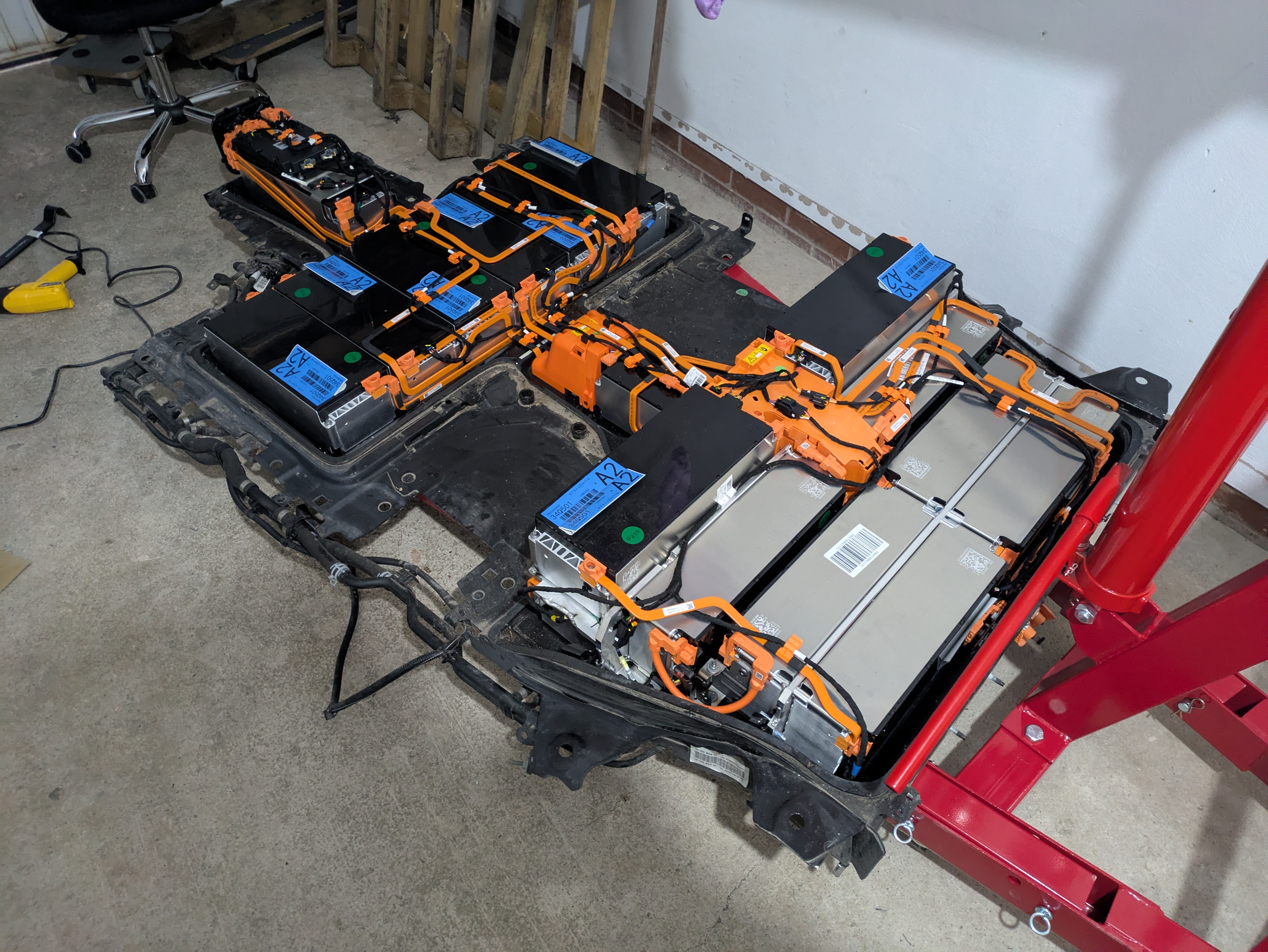

I tried both the knife and chisel approaches but both made very slow progress, in the end what worked best was connecting the engine hoist to the bolt tabs on the top half and lifting so that the weight of the pack provided a constant force pulling the halves apart, then I just heated around where the glue is and the pack slowly peeled itself open with only some slight percussive encouragement.
I've measured the voltage of all the modules I could easily get my multi-meter on and each reads 23.7V which works out to 3.95V per cell so all seems healthy so far.
Next up is to remove the modules. I intend to reuse the cooling plates and bus bars if possible so going to try to remove them still in their current groupings.
