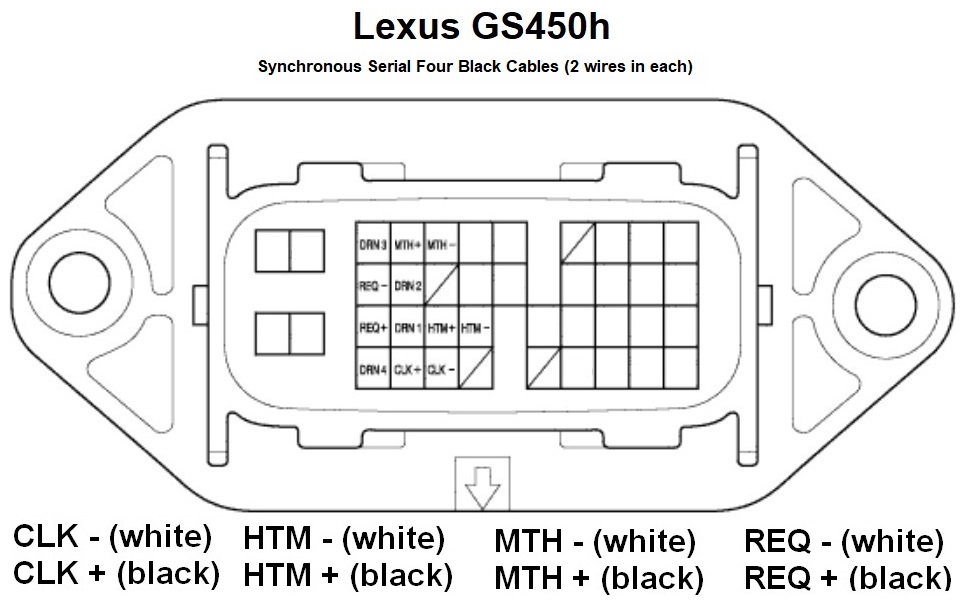

so although the Camry plug fits perfectly into the Lexus inverter the wires are pinned differently, let's start out by comparing just the four Synchronous Serial black cables with two wire pairs each (a black and a white wire)
ToyotaLexus

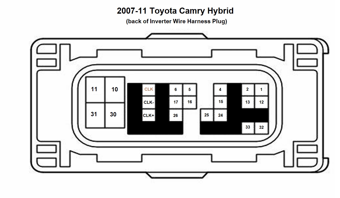

alright let's move them over one pair at a time so the 500KHz Clock line aka CLK wires first
CLK- white wire
CLK+ black wire
CLK this is a ground wire for the cable wire shielding mesh thingie, these wires are erronously cut too short at the junkyards by unknowing personnel
please consult Toyota Inverter Connectors and Pinouts for the proper pinout technique
ToyotaLexus

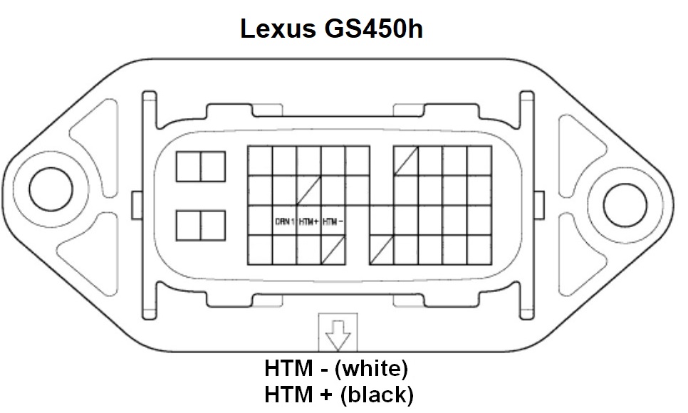

alright let's move them over one pair at a time so the the data frame from the hybrid controller to the inverter HTM wires next
HTM- white wire
HTM+ black wire
HTM this is a ground wire for the cable wire shielding mesh thingie, these wires are erronously cut too short at the junkyards by unknowing personnel
ToyotaLexus

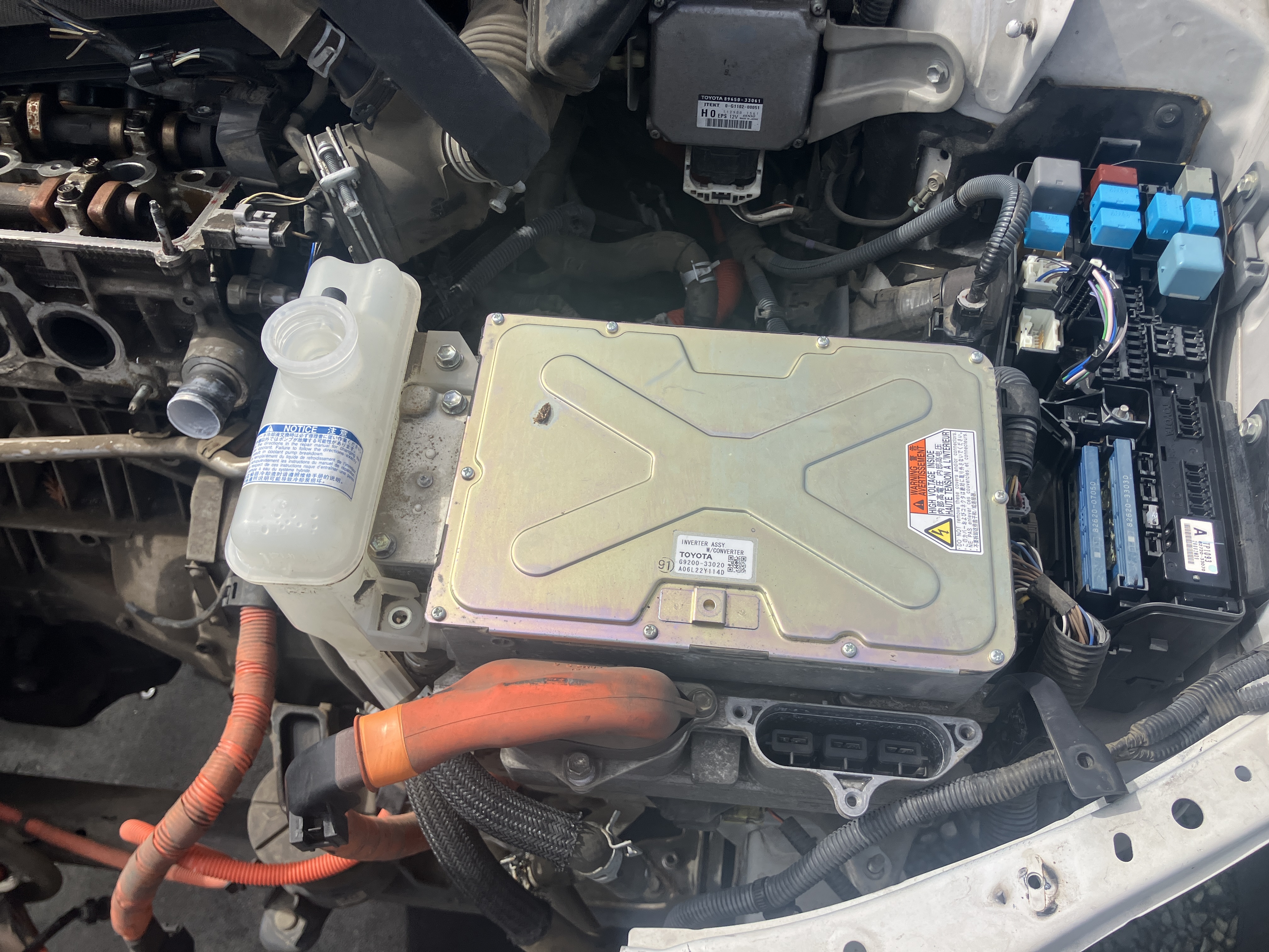

When standing facing the vehicle the inverter lives in the South East quadrant of the engine compartment aka the front corner just behind the headlight on the US driver side.
It is wise to first check if the inverter plug is:
  • Present
  • Uncut
the inverter plug harness traverses behind the bulky black plastic fuse box housing (held to the driver side inner fender with 3 bolts) before re emerging in the corner below the Medusa like master brake cylinder
it then makes it's way all the way across the firewall from the US driver side to the furthest North West corner of the firewall
where it plugs in to the Hybrid Vehicle ECU)
There is no need to keep this large black rectangular plug with that gray lift handle that goes into this Hybrid Vehicle ECU, what you are really after is the four black synchronous cables, comprised of two wires each, a thin black wire and and a thin white wire, so just snip them here, they will later plug right in to the ZombieVerter VCU
