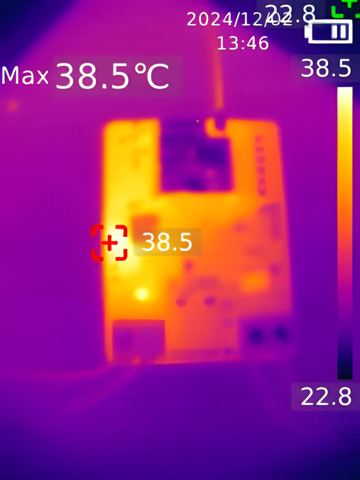

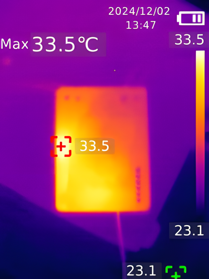

hmm, I think no version of the gerber files had serious issues. The ESP32 module is challenging to solder, especially the heat transfer pad. Are you sure that is making good contact to direct the heat into the PCB and away from the chip?

quite the opposite, only the voltage regulator gets a little warm, otherwise everything is cool
edit: I don't know what the problem is, I haven't changed anything, but it's been running for 15 minutes without interruption, I'll keep an eye on it for the next time
