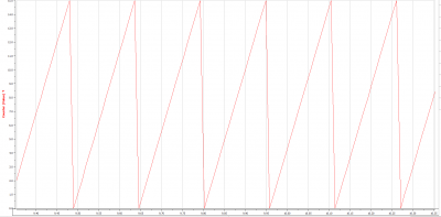

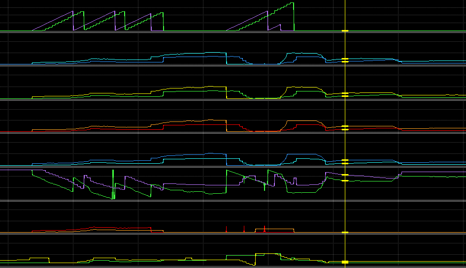

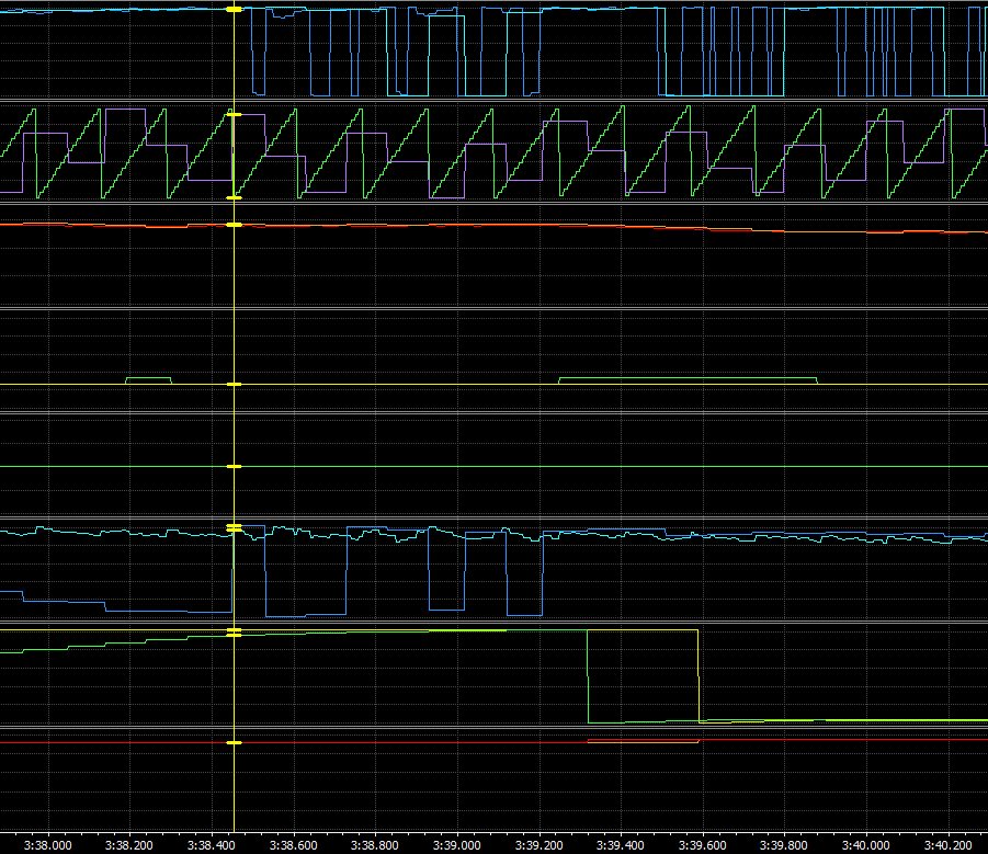

Time for some insight into the complexities here.
I threw my Motec M150 into the M3 and am sniffing the CAN Bus data (as well as having a Manifold Pressure and Temperature sensor hooked up).
There's a lot of data.
And when comparing side by side what the stock ECU is sending vs what I am, it certainly opened my eyes in some places.
Each screenshot is a particular ID generated by the ECU going back to the gearbox. Sorry, not giving out IDs here, I've been working on this for 2.5 years. And I'm one of two people in the world that I know of that's gotten it even close to working.
With that out of the way...

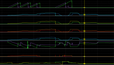

Some data looks reasonably good:
However as you can see between the green and pink data 6 items down, my data (green) is not nearly as smooth. This happens to be wheelspeed data, which is at a odd cadence - 7.5 ms on the BMW platform. Everything in the Motec is on a 1/5/10/20/50/100 ms cadence. So I have it polling at 10 ms. Clearly I need to change that to 1ms and allow it to fall out of there 'Have I received anything' block for a majority of the time. Hopefully that doesn't eat up too much CPU.
The other items look reasonable - there's some discontinuity on the first two due to scaling, but that's expected and OK. The counter is right, and looks good.

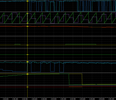

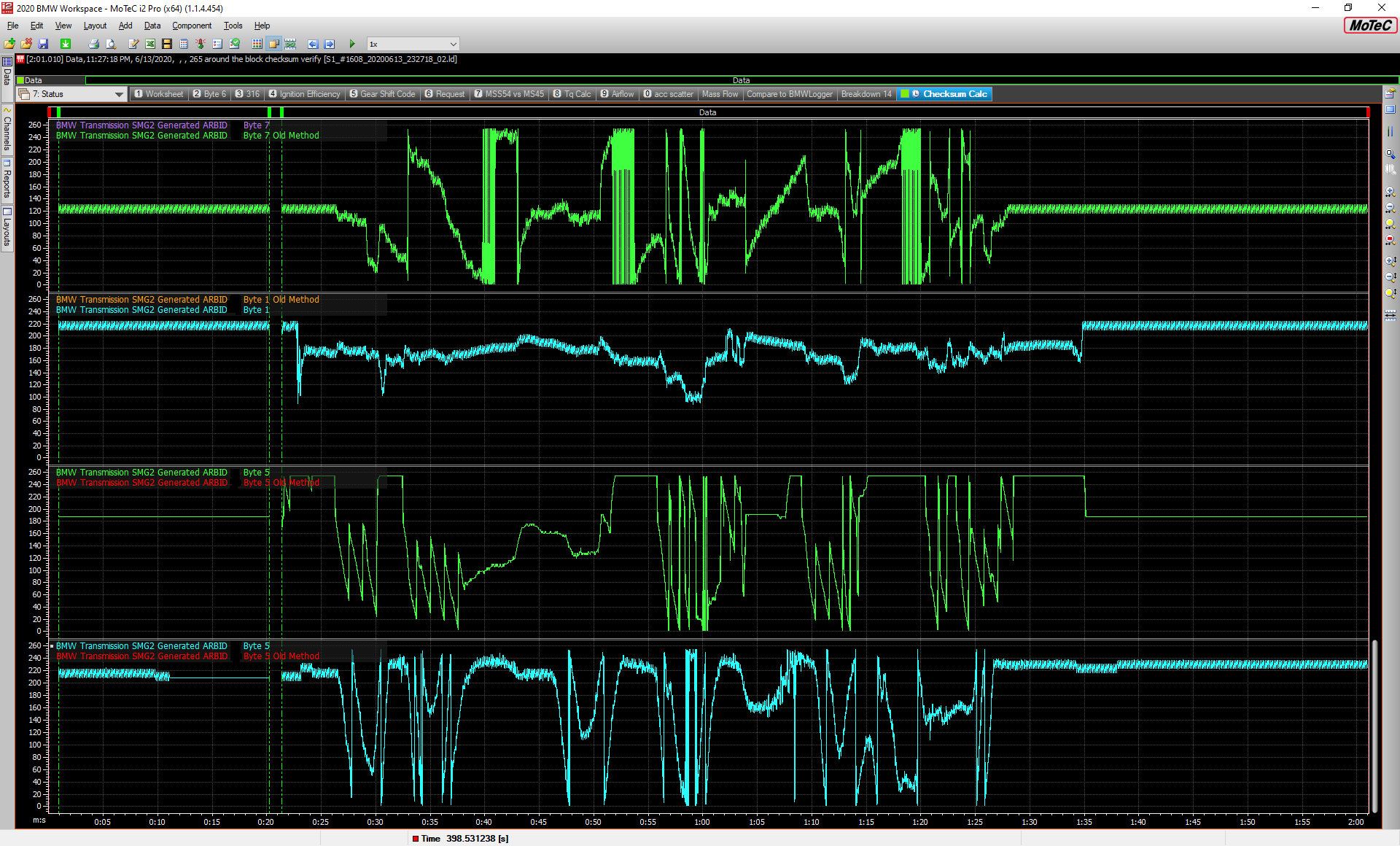

Moving onward to the next ID:
This is pretty bang-on except for the third graph, the yellow line should look more like the red. Part of that is...vacuum based load measurement on the M3 is awful. Because of the individual throttle bodies, you lose vacuum really fast. So not a lot of resolution there.
There's also some (hopefully) smaller items in there, but the major pieces look reasonable.

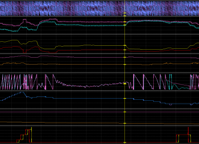

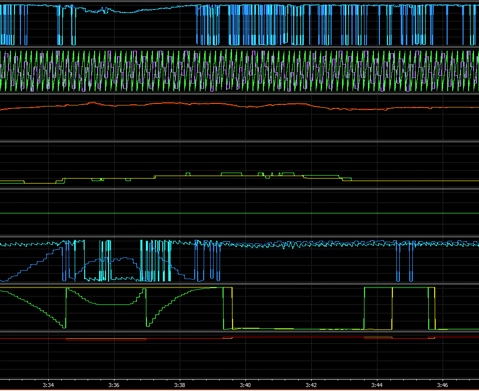

The next ID:
More smoothness issues on the first graph.
Various differences in the next few graphs.
With the next purple/green one, there's some discontinuities on the green line that are unexpected, and I'm unsure why.
The red / orange, I seem to be doing some extra stuff (in red).
The bottom line is a checksum type thing, so the differences are what are causing that to be different as well.

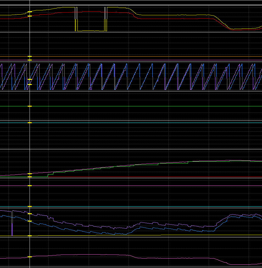

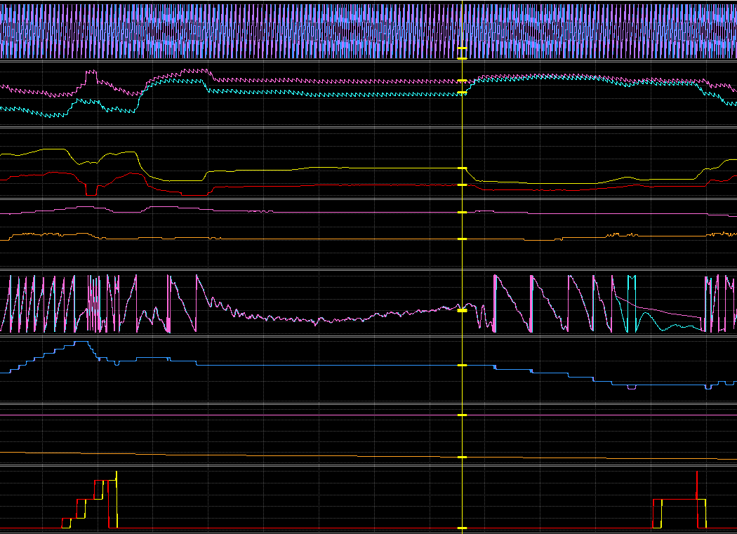

The fourth ID:

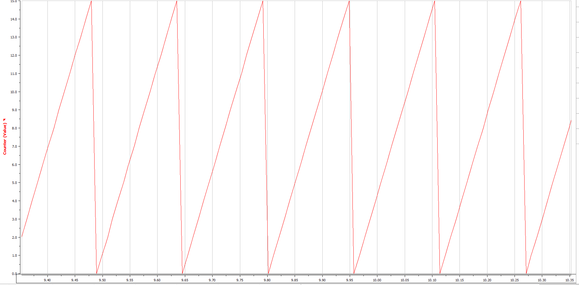

Here's where things go off the rails a little. Eagle-eyed viewers will note the counter doesn't look quite right.
Yep, messed that one up a bit.

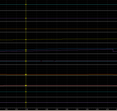

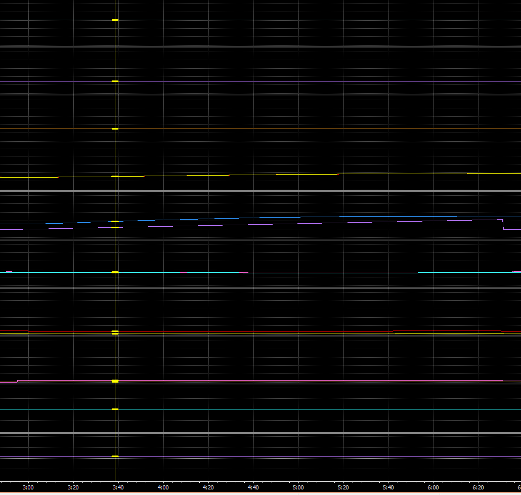

Finally, the fifth ID:
This is mostly temperatures, and that's all mostly right (except the coolant temp because..it's not hooked up - most of the rest you can get off CAN).

Nothing worse than a wild goose chase.
It's smooth 0-15, just like my generated counter is.
Ugh. I see what the problem is. I tried to cheat and put 3 IDs in the same script. That does not work. Decidedly not. Try again, Matt.

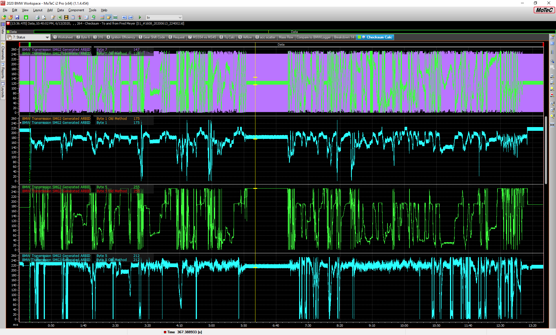

Problem: Current checksum calculation is based upon what I know the input to be.
Example: byte 0 may be Thing A, but byte 1 may be 2 bits of Thing A, 4 bits of Thing B, and a counter. But the checksum might only be on Thing A, and not Thing B.
So I need to calculate it based upon masking and shifting things around when necesary.
First attempt at code modification:
Hmm. 3/4 ain't bad for the first try.
Let's try that again:
There we go. Now I can clear any error codes, modify some wiring (this is all via a pass-through connector, not touching stock stuff), turn on message forwarding from the stock DME(ECU) to the transmission via the Motec, make sure all is good.
Then go ID by ID, and byte by byte, changing things, until the transmission complains "CAN Bus Data Error". Yes, that's all it gives you.
Hopefully I can at least narrow it down to the ID, and also figure out if it's a running vehicle vs startup issue. (There's lots of "Engine Running" conditionals in the stock code that I may have missed one or two).
