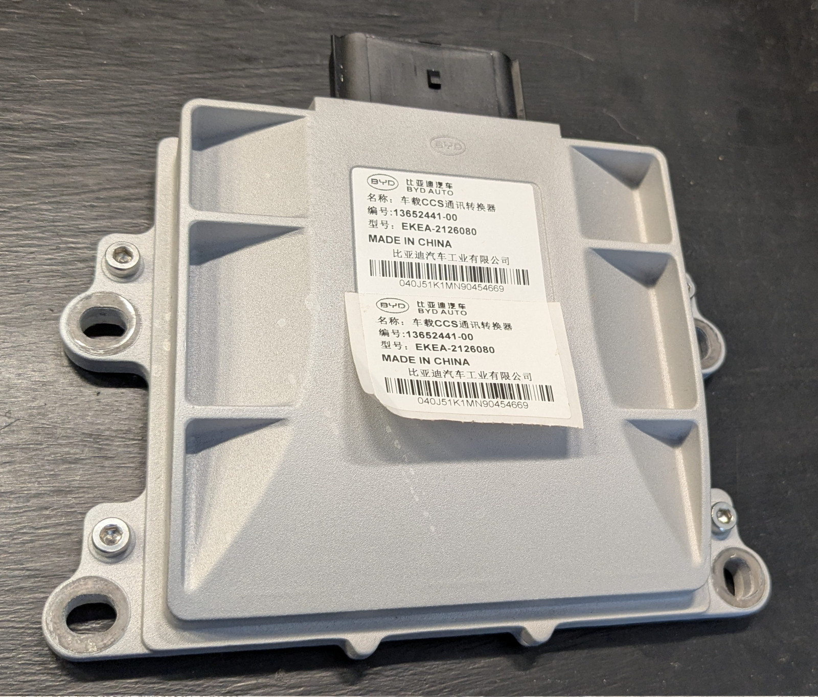

I had the chance to examine the CCS DC fast charging controller module from a BYD Atto 3 today, and thought I'd share some findings. This module is similar to the Hyundai one, as in it talks CAN messages on one side and negotiates the CCS2 PLC data link on the other side.
This module only has six pins connected in the Atto 3: 12V power, two grounds, CAN H/L and the charge port CP connection. It's on a dedicated "Charging sub-network" CAN bus with only two CAN nodes: this CCS module, and a port on the Integrated Intelligent Controller (basically VCU+OBC super-unit, inside the motor stack).
External label is mostly in Chinese (“车载CCS通讯转换器” is "Vehicle mounted CCS communication converter device"). There's also a serial number and a model number EKEA-2126080.

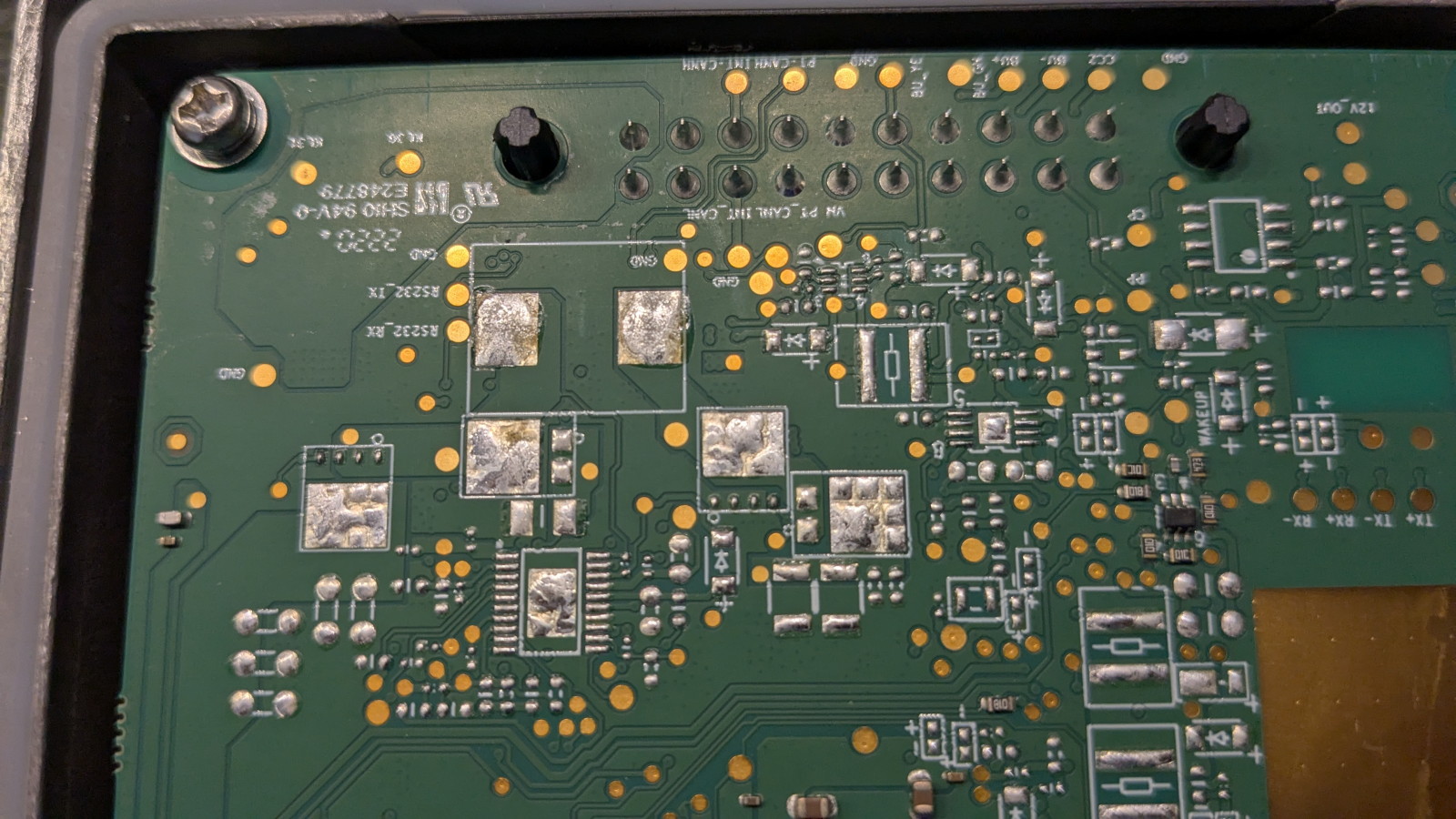

Inside, the PCB is very well labelled with a lot of test points:
(The photos look better zoomed in, but unfortunately still slightly blurry.)

I tried connecting to these pin headers on the board (as labelled on the bottom test points):
Both UARTs are 115200bps with 3.3V levels. First one:

The 10 pin header appears to be a standard 2.0mm pitch ARM Cortex-M debug header. This allowed SWD debugging immediately(!), like most automotive OEM stuff debugging seems to be left enabled.
Using pyocd I was able to dump the flash without any trouble, seems like this part has 1.5MB flash. Strings in the binary suggest it's based on FreeRTOS, and is a special firmware build for BYD. (Amusingly, even though I couldn't find this chip variant on the NXP website it's listed in the CMSIS support pack so pyocd pack install S32K148HRxxxLQx worked and then:
