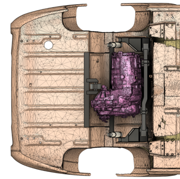

Some CAD work updates that might be inspirational to others, again on the iMiEV forum
https://myimiev.com/threads/mg-midget-c ... post-53034
Just a teaser below.
When trying fitment, a scan can be really helpful.
We used RealityScan with great success on an ordinary smartphone.
