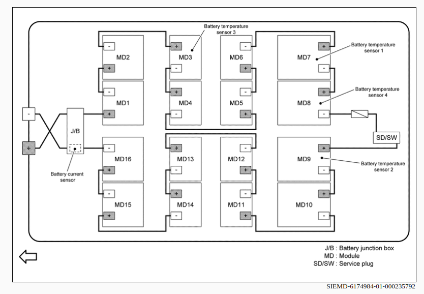

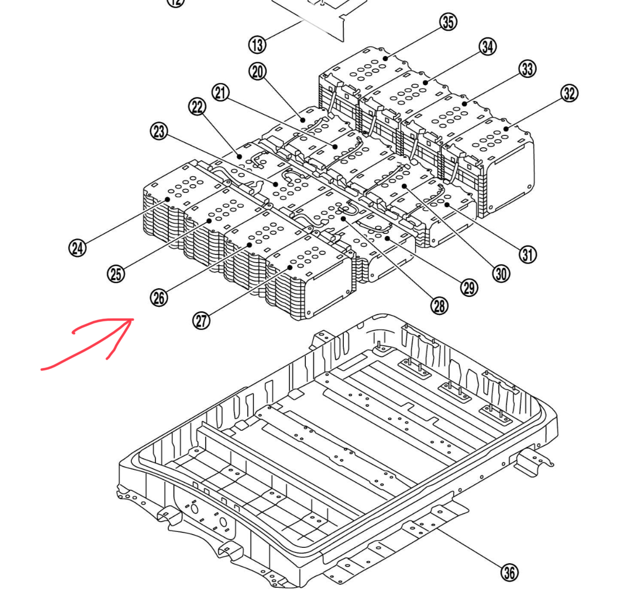

Is anyone familiar with the 62kWh battery and how power flows through from + to - ?
In particular, at which point the service disconnect comes?
My guess is that there’s a left / right split. So from the diagram,
26 - 33 (right)
25 - 21, 35,34 (left)
Is the disconnect between 33 and 34? Or maybe 33 and 25?
I’m considering buying one, but I’ve had no luck with previous tear downs that cover this. I’m trying to work out whether the different modules can work as they are built by Nissan.
Thanks.

Re: Leaf 62kWh module power path
Post by ginetto »
I remember 33 and 34, btw I'll check for it in the documentation if any

Here you have
62kWh Nissan Leaf topology
Post by ianlighting »
ginetto wrote: Thu Nov 07, 2024 8:43 pm Here you have
Thank you! That’s great.
