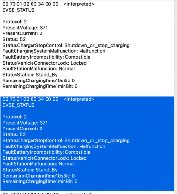

Ok I did a full multi-station test today, still failed at all. Logs are attached. EVGO stations are Delta, Nissan is ABB, EA is Electrify America.
I have an idea what may be wrong. A few stations have said "Make sure your car is in park". The code still includes a variable/definition for not parked. But the V3 board does not include any input from the drive system to know that the car IS parked. Can we just cut this from the code?

Imanaged to find the raw .csv file from Delta i made when on EVSE with my friends Leaf 2018.P.S.Mangelsdorf wrote: ↑Sun Mar 19, 2023 11:56 pm Ok I did a full multi-station test today, still failed at all. Logs are attached. EVGO stations are Delta, Nissan is ABB, EA is Electrify America.
I noticed timing is 49ms

I don't think it's the not parked variable as it's set to false, i.e. parked = true.
I noticed that for one of the logs the charger was specifying protocol V1.0, but the code is sending protocol V0.9.1.
I have modifed the code to send KWh if V1.0 as is done in the SAM3 version, and added KWh to the parameter list.
Stlll need to get it charging, which will require some more reading or someone who knows more than me to take a look at it.

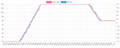

Had a quick look at your log, your requested current never raises above 0.
Plotting the voltage the EVSE is reporting looks a little strange, it raises to 500v and falls again as normal, but then it does so again, then we see your battery voltage as reported, the requested current never raises above 0 and after a short time the station sets the malfunction flag

I think its clear that my issue is the car not asking for amps. Clearly it gets all the way to that point in the process, so communication is occuring and the car and station are in agreement up to that point.

I think I've fixed most of the problems in the STM32 version code. The main one was the pin allocations for chadamo 2, 10 were reversed. In the code they are called charger_in_1 and charger_in_2 on the schematic IN2 and IN1. The only reason it got as far as closing the contactors was because the logic of charger_in_2 was inverted ( should be active low, was set to active high ).
I've tested it with test EVSE data sent by SavvyCAN and get the correct requested current.
The only safe way to stop charging is to set the current to 0A on web interface, otherwise it will stop at the voltage set. There is no SOC calculation in the code so this either has to be added, or sent from BMS using CAN mapping for termination at set SOC to work.
I have also added ISA initialisation, which I will test when mine arrives in the next few days.

Not sure if obvious but in CHAdeMO spec, if the vehicle doesn’t ask for non-zero current within 6 seconds of charge start, the charger will stop (and at least some will show EVSE malfunction flag).
Maxchargevoltage is a sort of “never exceed during charging” parameter and is usually set higher than target voltage.

Alright we're not there yet but back to having communication.
Attached are logs from two tests (EVGO and Electrify America) and below is a screen record of an attempt at an EVGO charger.
I couldn't screen record at the EA station because it had complimentary charges and started attempting as soon as I plugged in, so I couldn't connect to the webinterface in time.
