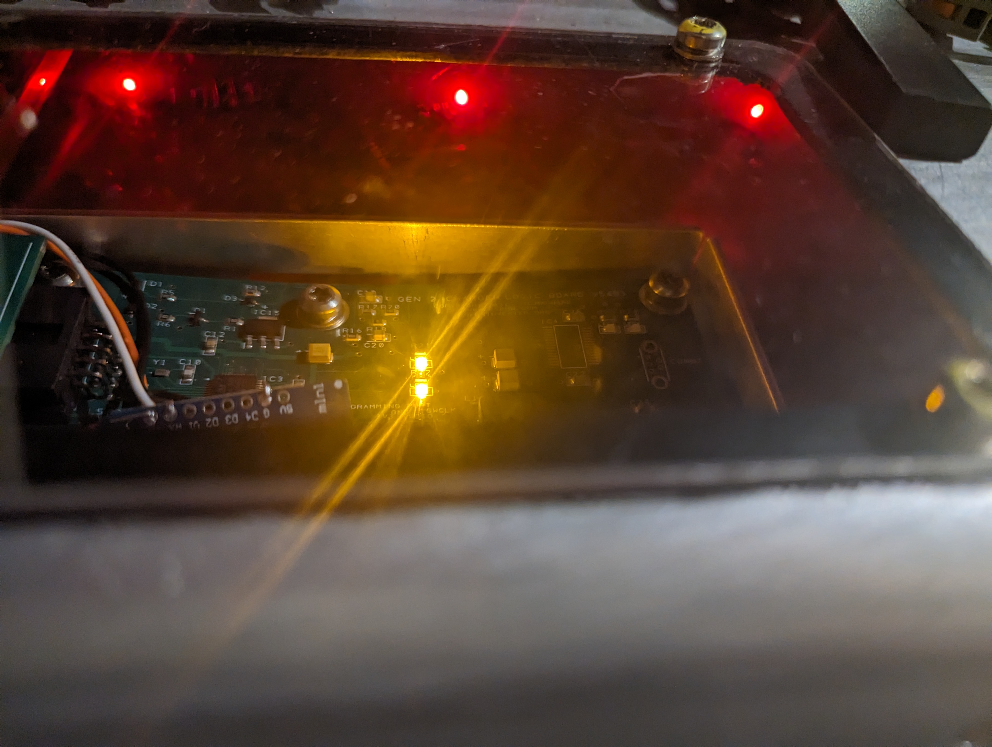

Hi Tom. Thanks for the reply.
When plugged in, all three modules light up and are a solid RED.'
With the new software, I am not sure where I go to enable only module 3. I recall there is a hidden folder maybe that has these settings.
Apologies, but can you let me know and I will try this next.
As to the choice T2-3phase, I think I recall going through all of the choices to see which one resulted in the highest amp output and this one got me there or at least was no worse than any other one. I probably just left it there the last time I troubleshot it. I am happy to try any of the other options, but none of them, as I recall, led to module 3 giving a reading.

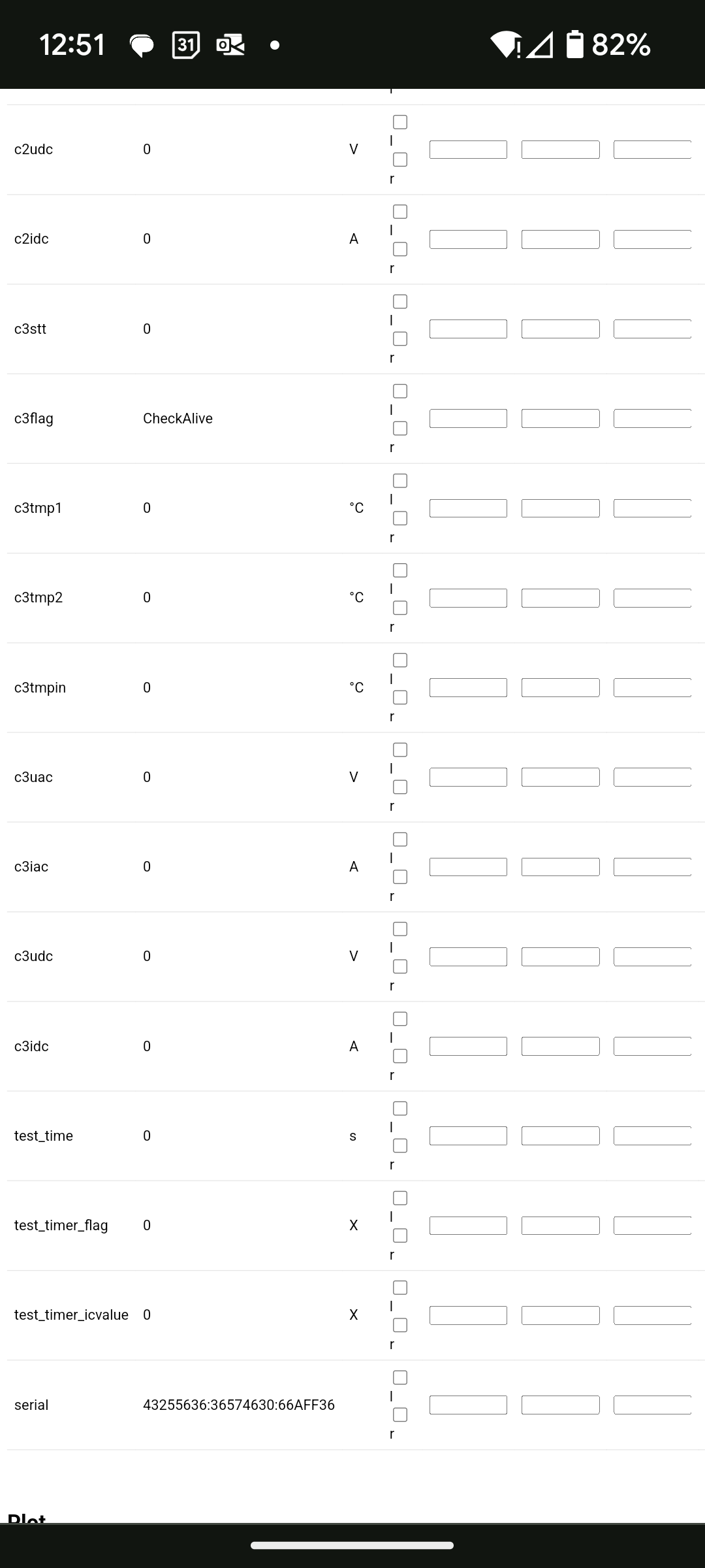

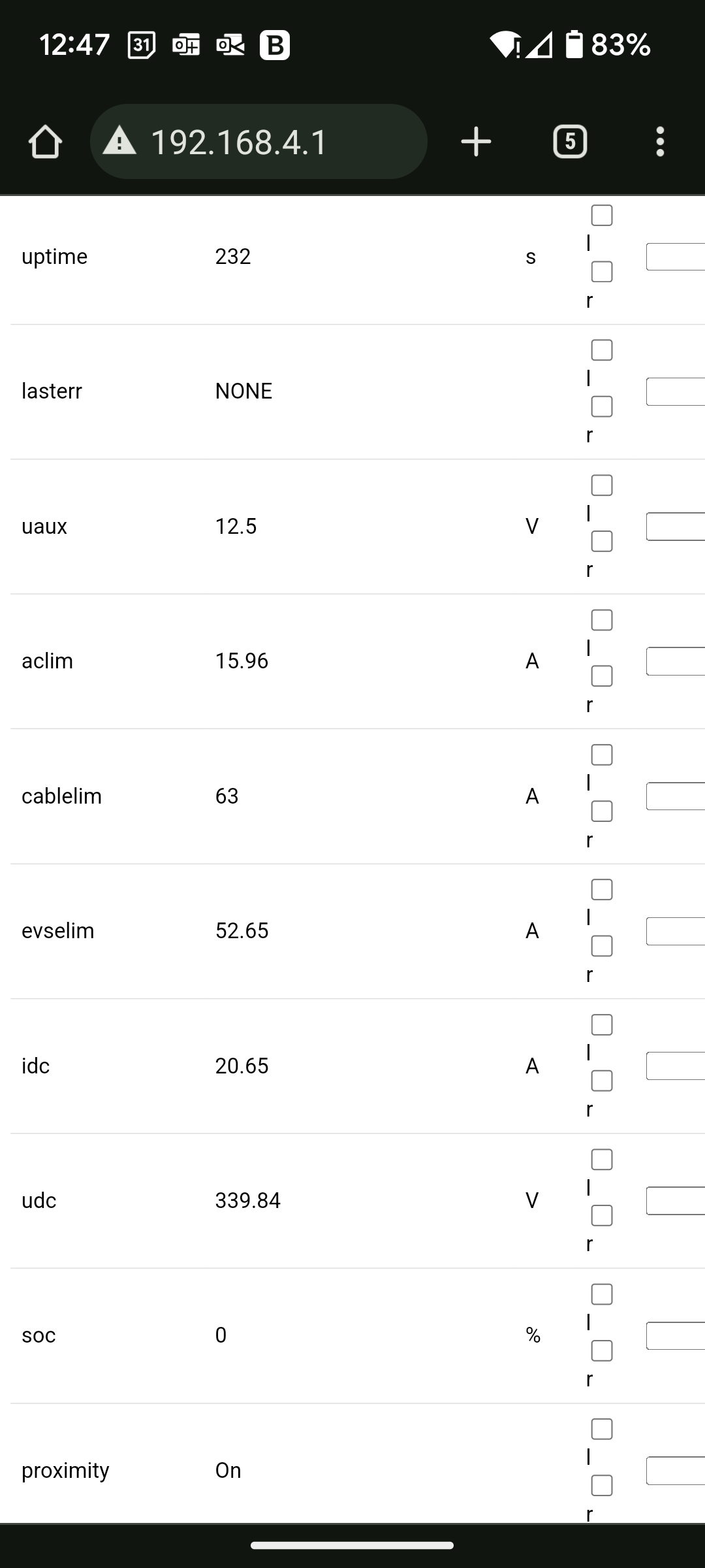

Apologies on the missing spot values. Here you go:
I changed the settings to just module 3 and it light up solid red, but still nothing on the spot values and "check alive":
Hope this additional info is helpful.
Re: Tesla GEN2 Charger output
Posted: Thu Jul 11, 2024 6:07 pm
by tom91
So module 3 is not working correctly for some reason. can you check it is wired properly for AC and HV?
The fact spot value aclim is 15.96A, which is dictated by the modules as the limit itself, it means the modules are limited to max allowed power in from the AC connection.
So this means your issue is you only have two out of three modules working.
