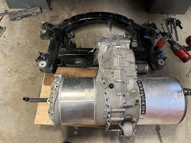

Hi all, I am in the early stages of trying to convert a Mazda RX8 to use the Telsa LDU.
I have managed to get the LDU running on open inverter and am now staring long and hard at the rear subframe and strategizing how to squeeze the LDU into such a small space.
Unfortunately the LDU is about 1" too long, and it will interfere with the upper control arm mounts on the rear subframe.
My conclusion is that the path of least resistance is to shorten the LDU by removing and relocating the inverter.
This will mean the center point of the LDU differential will be offset from the RX-8's center by about an inch or two, which could cause some degree of torque steer,. but I think it should be small, and is ultimately the lesser of evils.

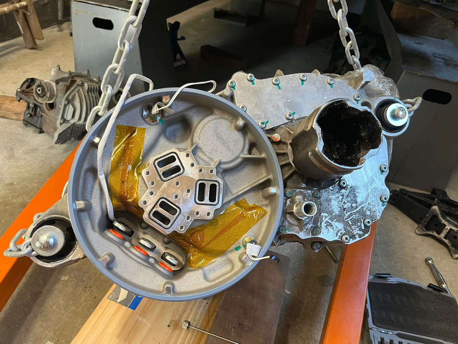

The inverter came out pretty easily though tonight actually. That video showed everything.
But there was actually 3 wires I had to disconnect and not just one.

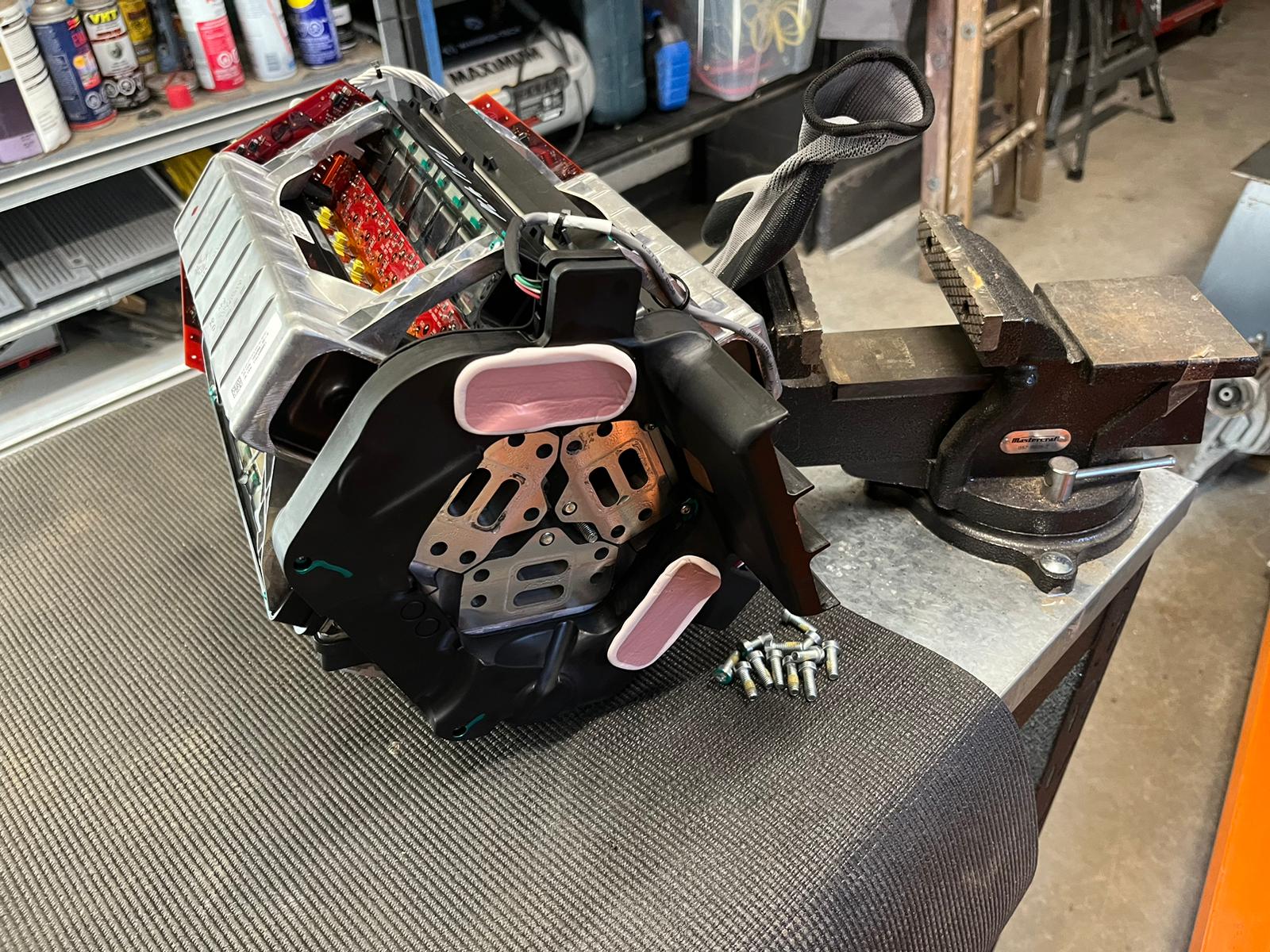

One other interesting thing I noticed immediately after removing it.
I cant set it down! (Well not easily).
Since its designed to be bolted via the coolant plate, there are no safe flat surfaces to set it down.
So first order of business is going to be to 3d print an inverter stand that will let me store it safely somewhere with the cover attached.
I will post the file and pictures in case anyone else wants to make their own.
From there, I have decided I am going to try 3d print my own coolant adapters, and then make them on my milling machine.
(I bought it years ago planning to convert it to a CNC but never converted it or even used it at all actually, so I will have to do some learning on that front first I suppose).
