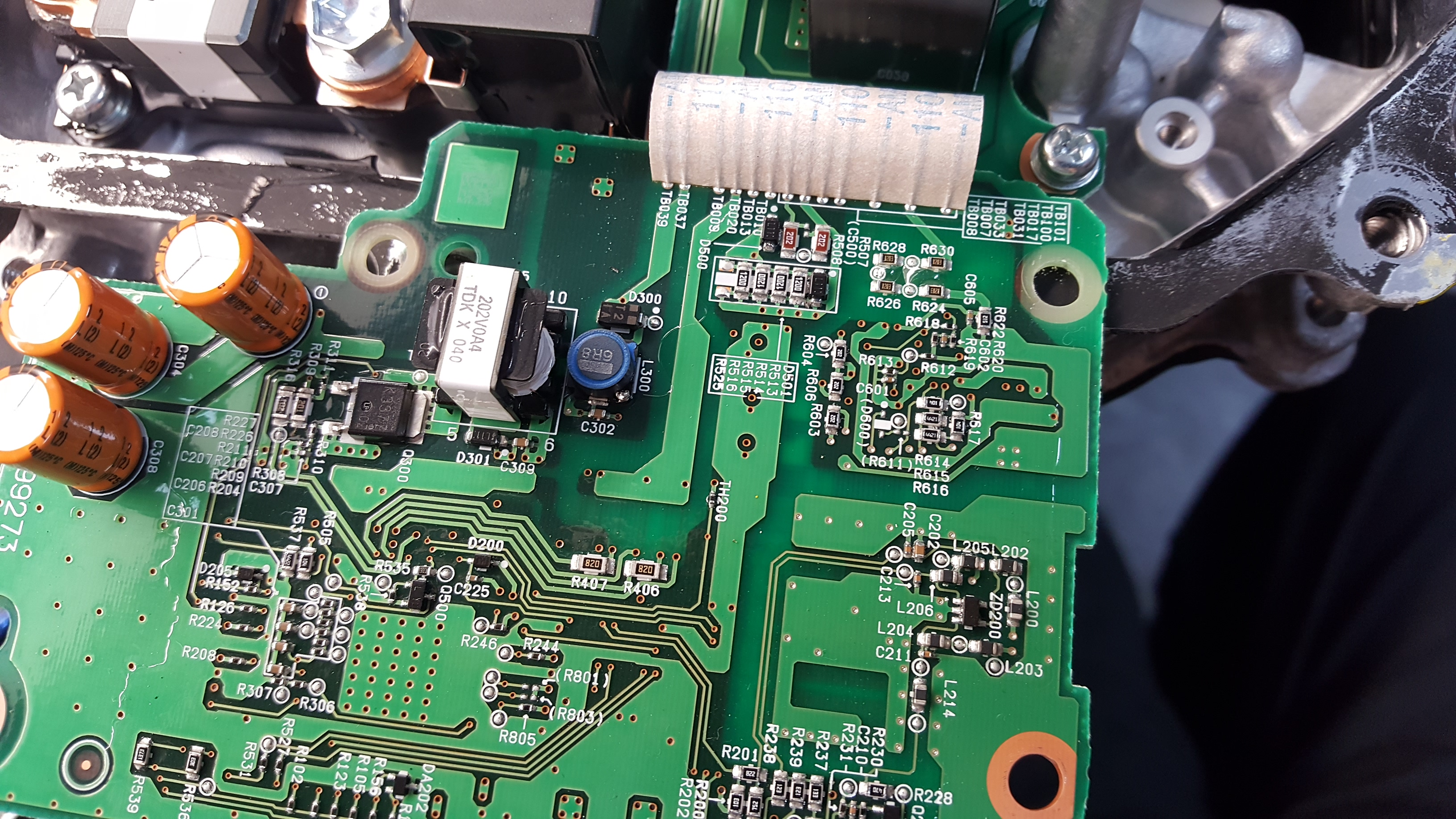

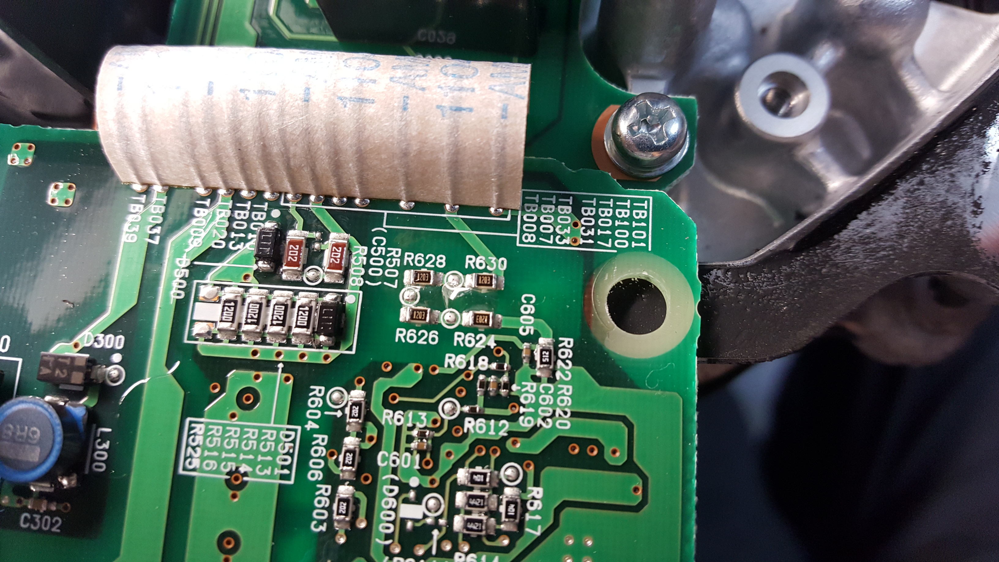

Taking a look at the Gen 3 prius dcdc today. Based on the work By Mouse it seems to share the same hv voltage detection circuit as the Yaris albeit the logic board is mounted on a ribbon cable to the power board instead of all on one. Anyway , found the two networks of 4x 120k in series with a 5k1. Based on Mouse's calcs that would put a voltage of 2.47v on the 5k1 at 235vdc input. Changing these to 210k would give 2.44v on the 5k1 at 405vdc on the input.
Also seems the prius uses 1uF 400v poly caps for smoothing so decided to order some 450v replacements. Will do the mods and report back once the parts arrive.

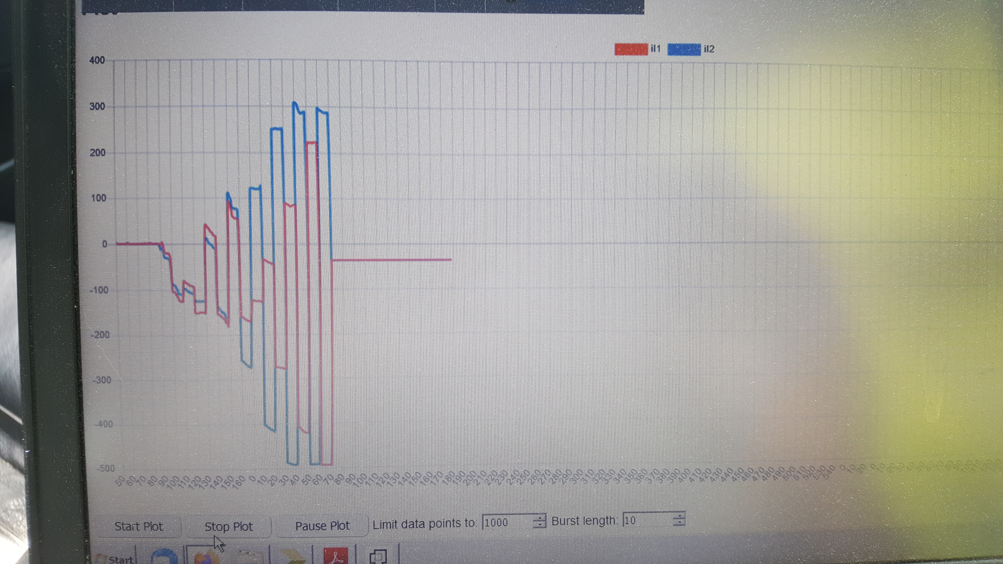

Well folks the numbers are in and the internet was wrong!!
Prius Gen 3 MG2 power stage shuts down at 500amps. Yes 500amps.

Jack Bauer wrote: Mon Jun 01, 2020 3:30 pm Prius Gen 3 MG2 power stage shuts down at 500amps. Yes 500amps.
Fabulous :D

Yeah. Had a guy on instagram yesterday tell me its only good for 100amps. He just knew this for fact of course. No need to test.

Jack Bauer wrote: Mon Jun 01, 2020 3:30 pmPrius Gen 3 MG2 power stage shuts down at 500amps. Yes 500amps.
Good lord.
Gen2 MG2 shut down at 350A.
Whelp, there's a big feather in the cap of the Gen 3.
400hp. Out of half of a Prius inverter.
Wiki updated.
