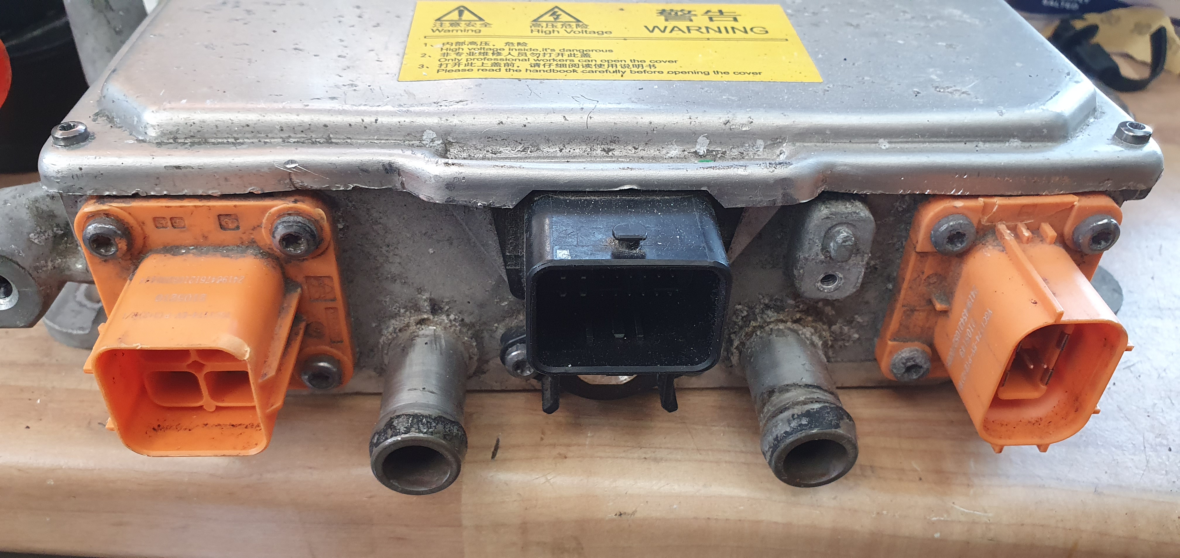

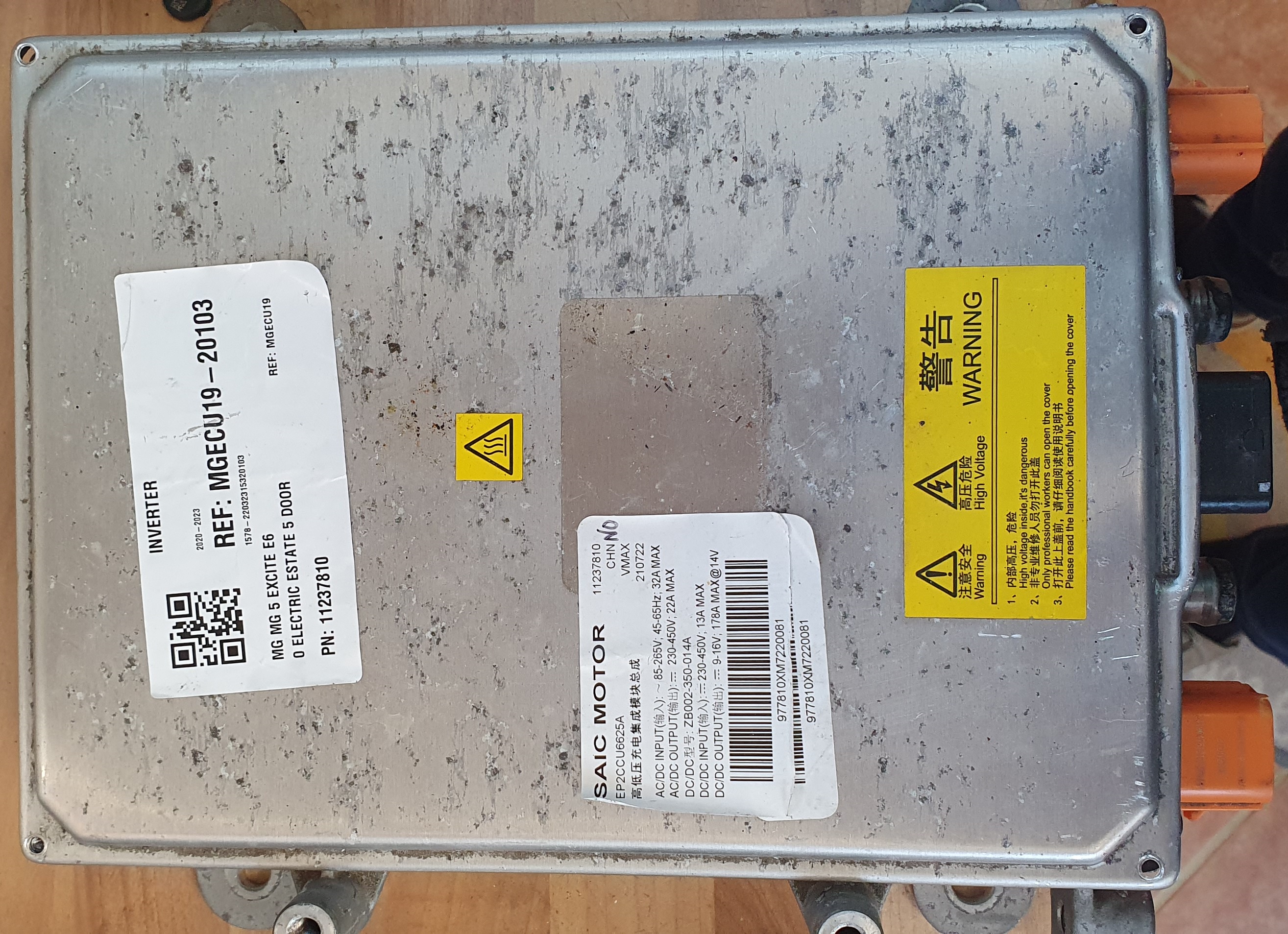

Hi All. I got my hand on "faulty" MG5 on board charger (EP2CCU6625A).
I did not have a way to tedt, so I decided to look inside 😉

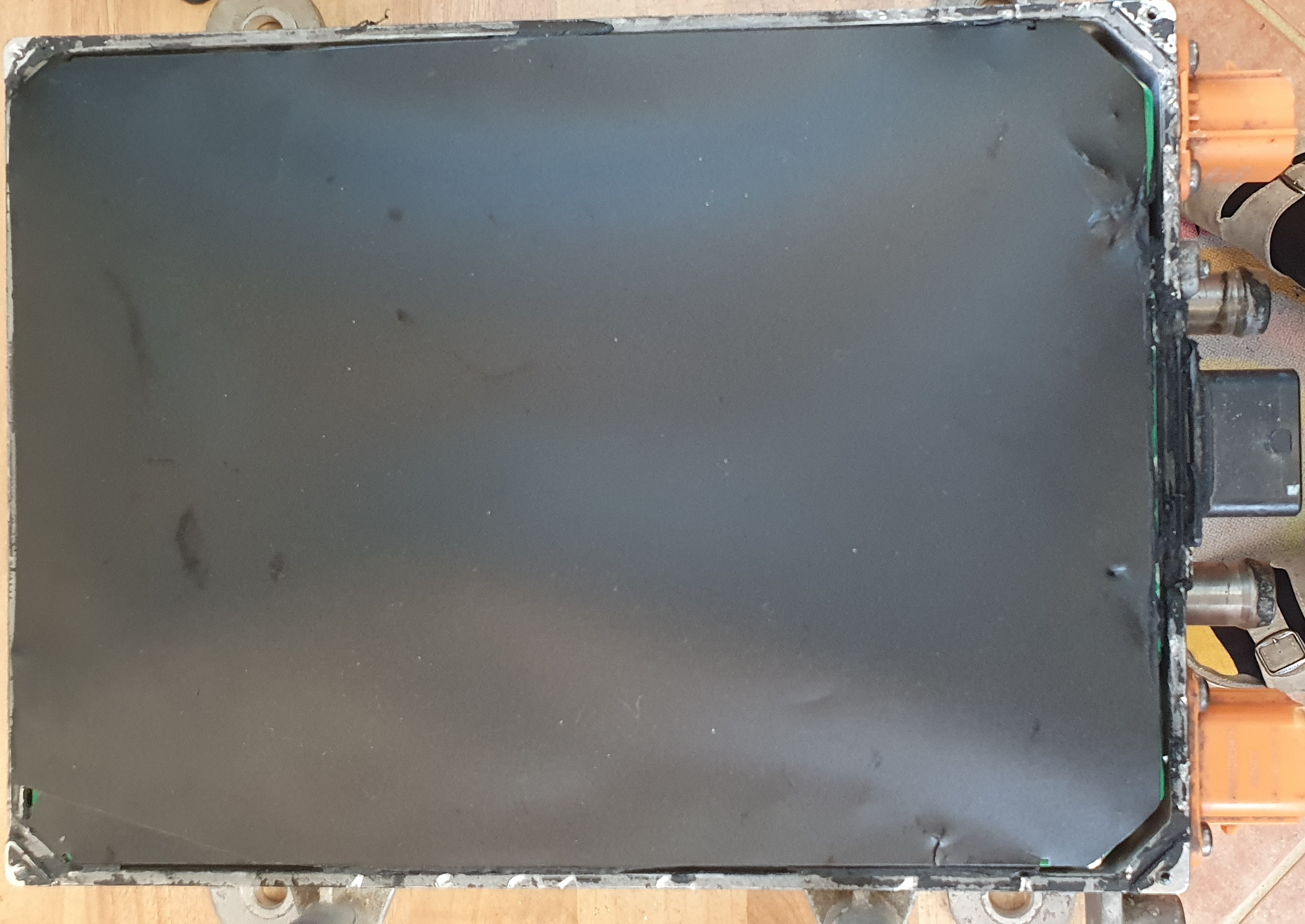

Not the best idea ever, as due to the cover being glued on, it was hard work and i have damaged the unit a bit.
So I'm sharing info/pics, so you don't have to repeat my mistake;-)
Just need to upload the pictures...

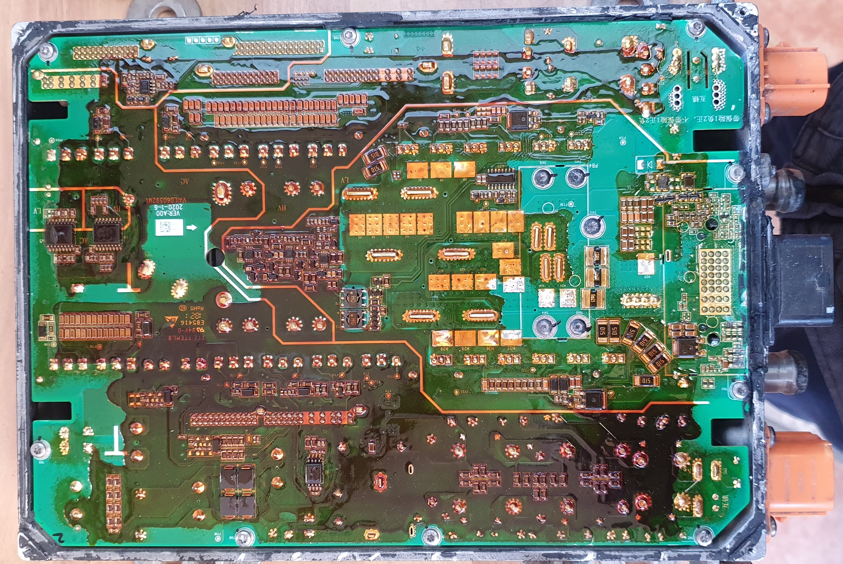

Bit later I will try to test if any of the functions (charging/DC-DC/V2L) are still working.
Top with cover:
Top-less ;-)
Bottom with cover:
Bottom without cover:
Connector side:

Did Damien have the same type on the bench? He did not open it, but was successfully control it by replaying CAN messages. He published a video about this in the last weeks.
[Edit] Link to video:

I think it is the same unit, but Damian will have to confirm is unit is also EP2CCU6625A.
Once I test what is still working, I will probably try to get the PCB off to dig deeper (especialy if nothing is working).
