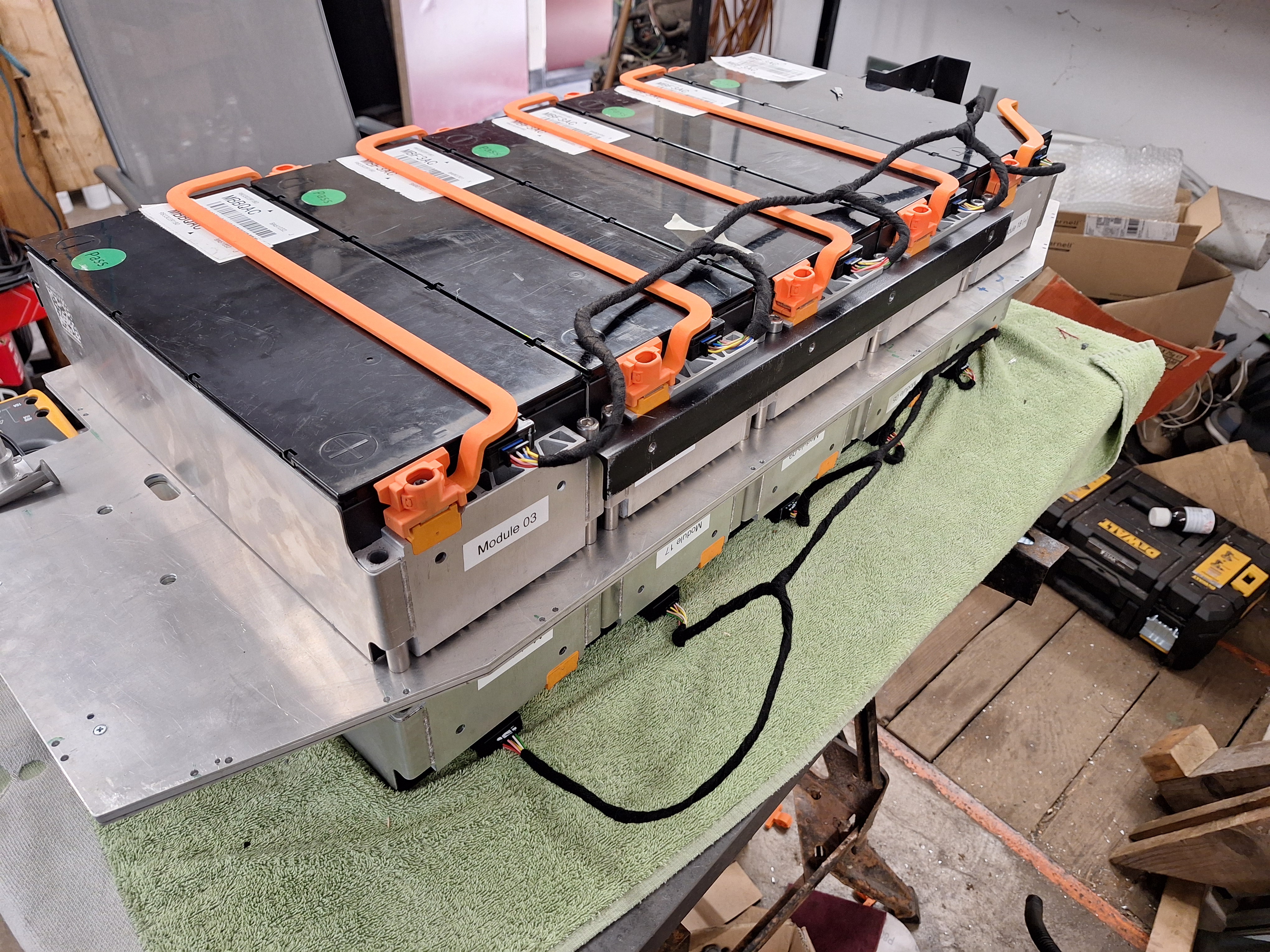

Over the last year I have bought all parts listed, connectors, pins and wire. At this moment I have the first version of the BMS pcb working on the E208 battery, the first version of the pcb with Openinverter running the XC90 controller and spinning the motor. Have a ZombieVerter VCU to control this mismatch of parts.

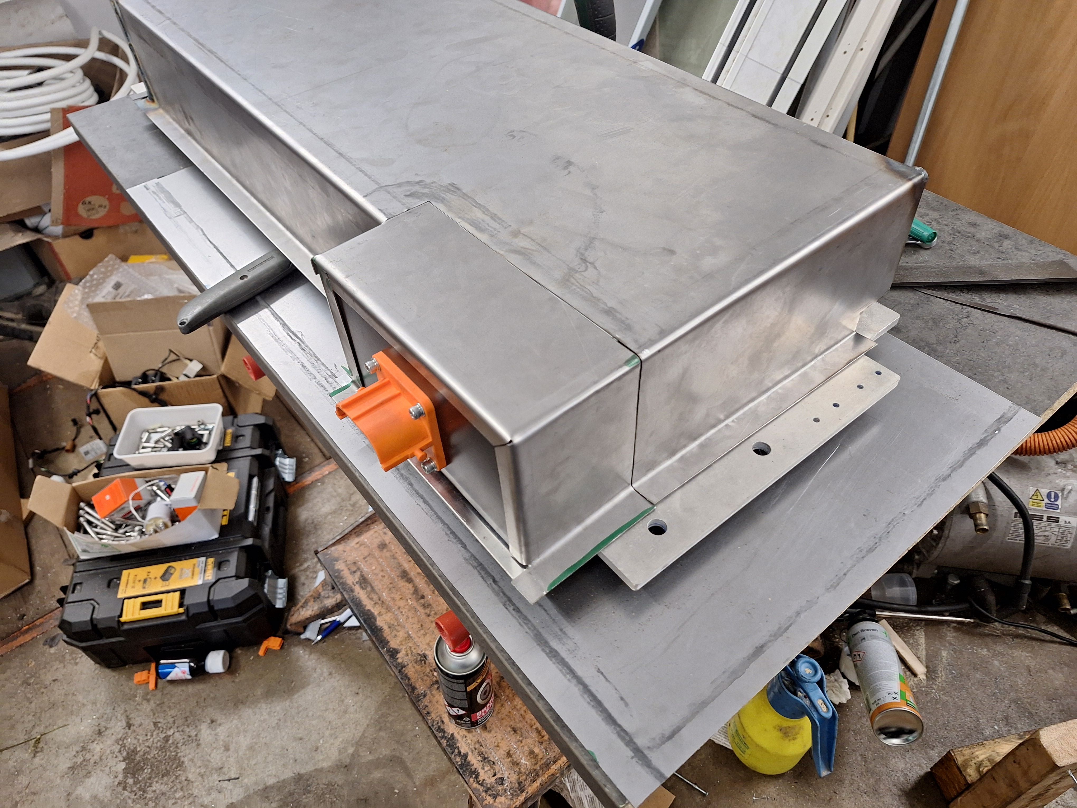

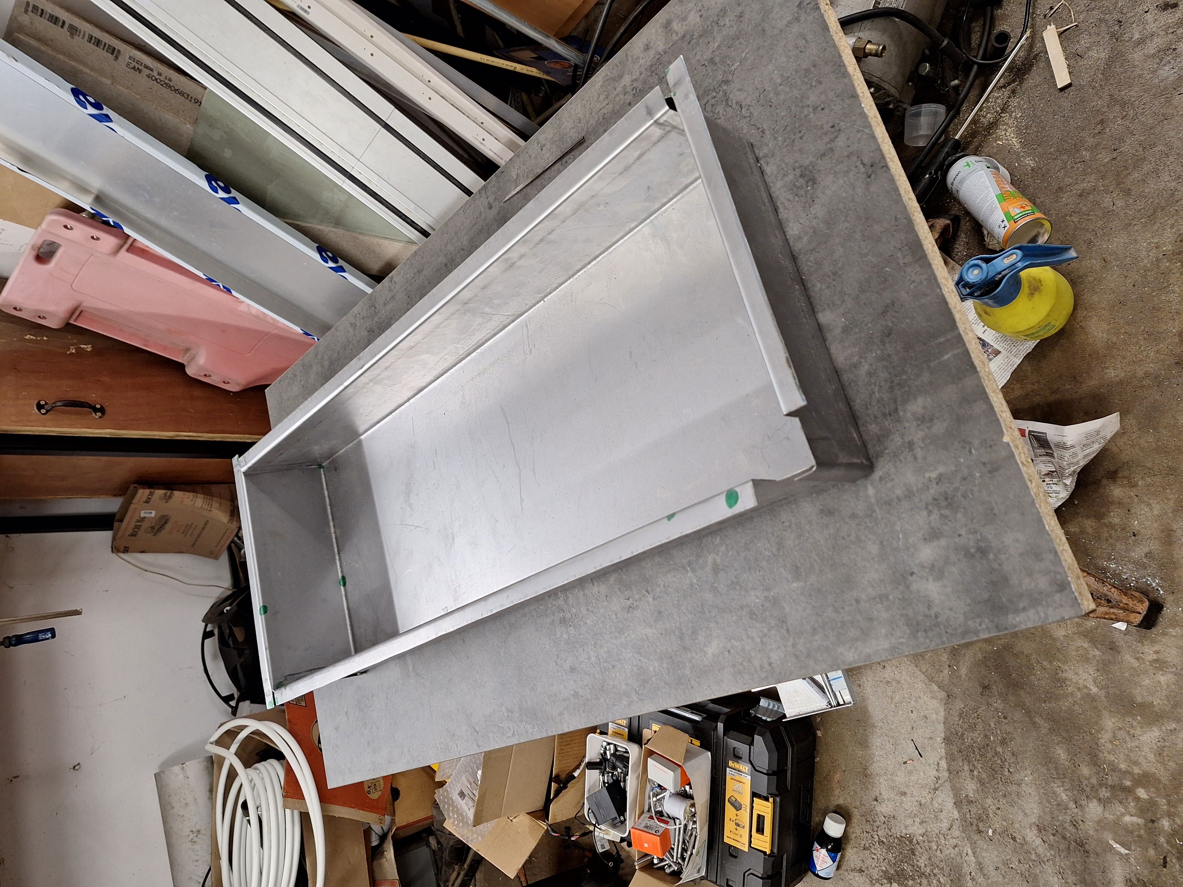

Currently designing the battery boxes. One in the back unter the car with 10 modules. It is a tight fit but I think it will fit. And one in the front with 8 modules.

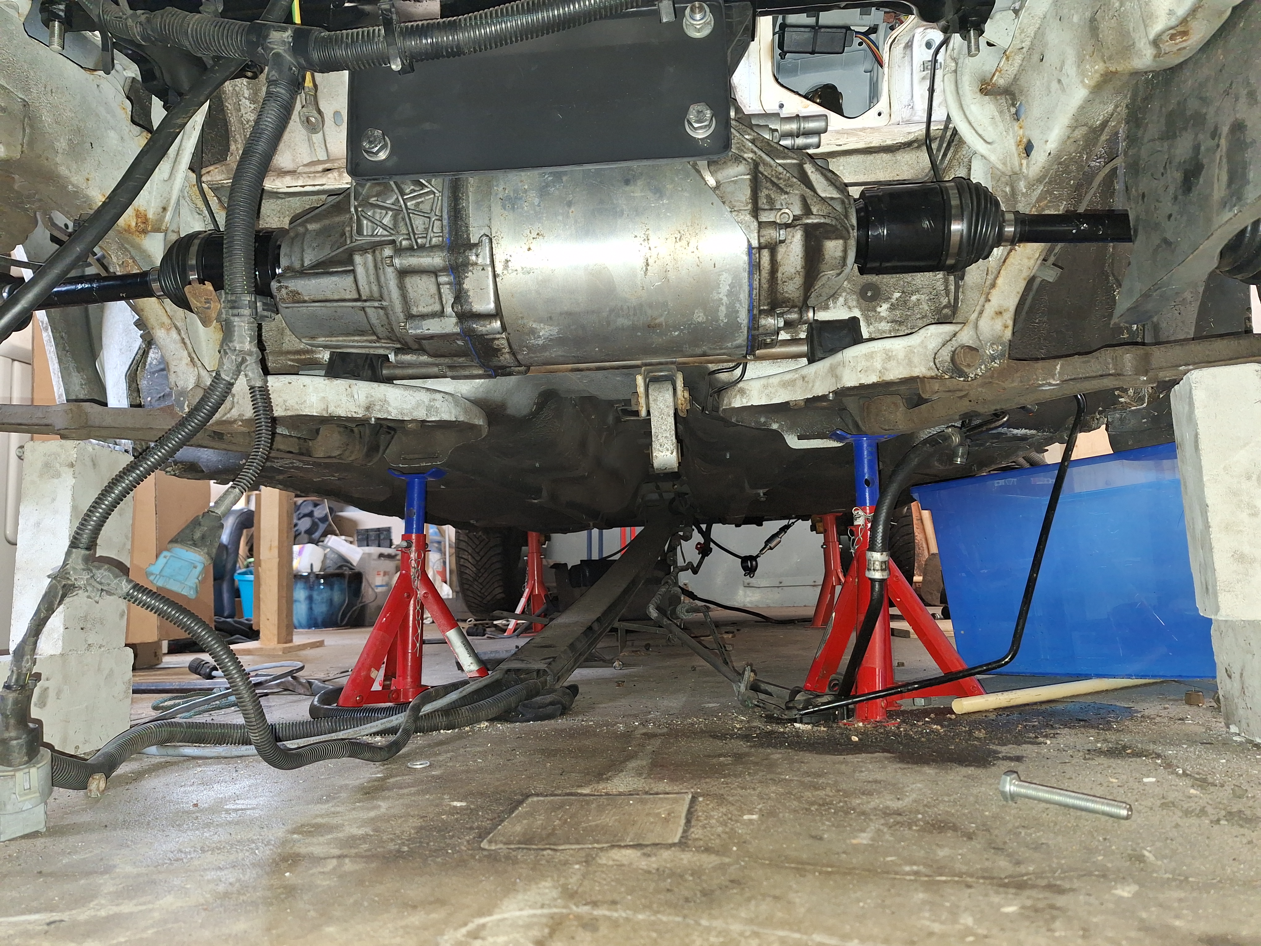

Got two weeks off work. So i could make some progress.
First removed the motor, inerter, vacuumpomp, driveshafts, battery boxes, electronics box, 12V battery and the heater.
Next, see if the Volvo motor will fit. Happy to report that it does. I have flipped the motor around so that the mounting holes line up better.
At the rear of the motor I mounted two rubber mounts normally used for the lower control arm. used a length of 20mm round bar turned down the ends to fit in the rubbers and a M12 thread on the end. Cut a piece of steel box section to bolt to the motor and welded to the round bar.
rear mount
rear mount
On the front of the motor another two lower control arm rubbers are mounted to the cross brace. Made a plate to mount the motor to the rubbers. The lower control arm rubbers have a 17mm bore that is not a standard bolt size so a made a set of bolts on the lathe with a M12 on the end.

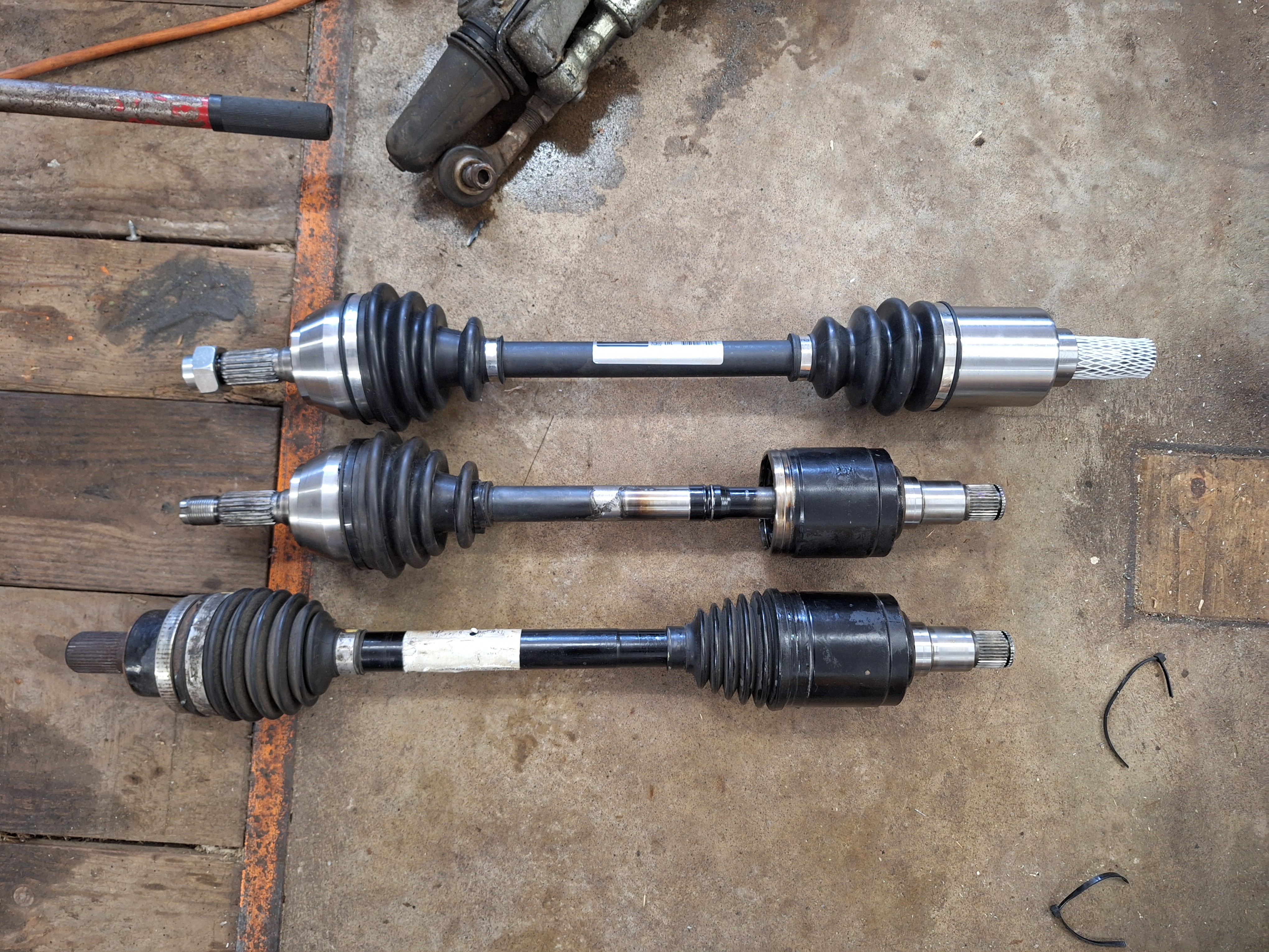

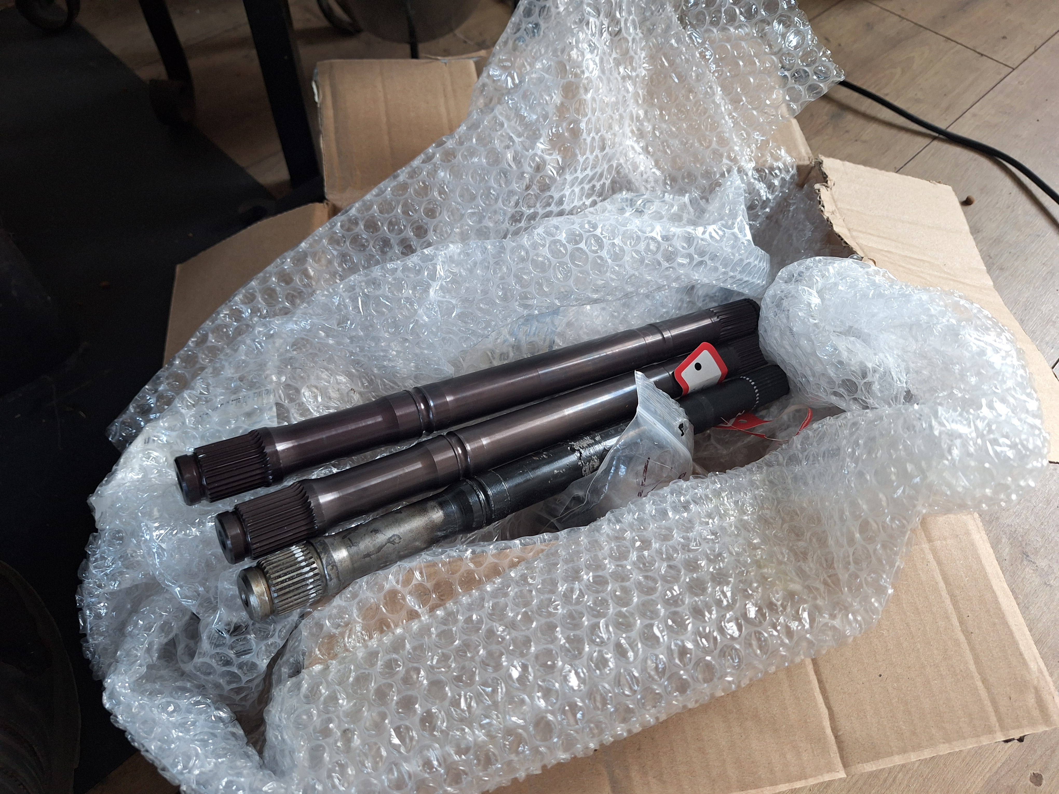

Of course the drive shaft do not fit. Got a set of drive shafts with the V60 motor. Ordered a pair of new SKF drive shafts for the Saxo. Cut them and welded them together. I am not sure if I run with the welded drive shafts or get a set made. The previous set up had welded drive shafts that lasted 50.000 km.
drive shafts
drive shafts
From top to bottom: Saxo drive shaft, my hack job, Volvo drive shaft.
It is a tight fit but it's in. I am very happy that it fits and I have enough space for the battery box.

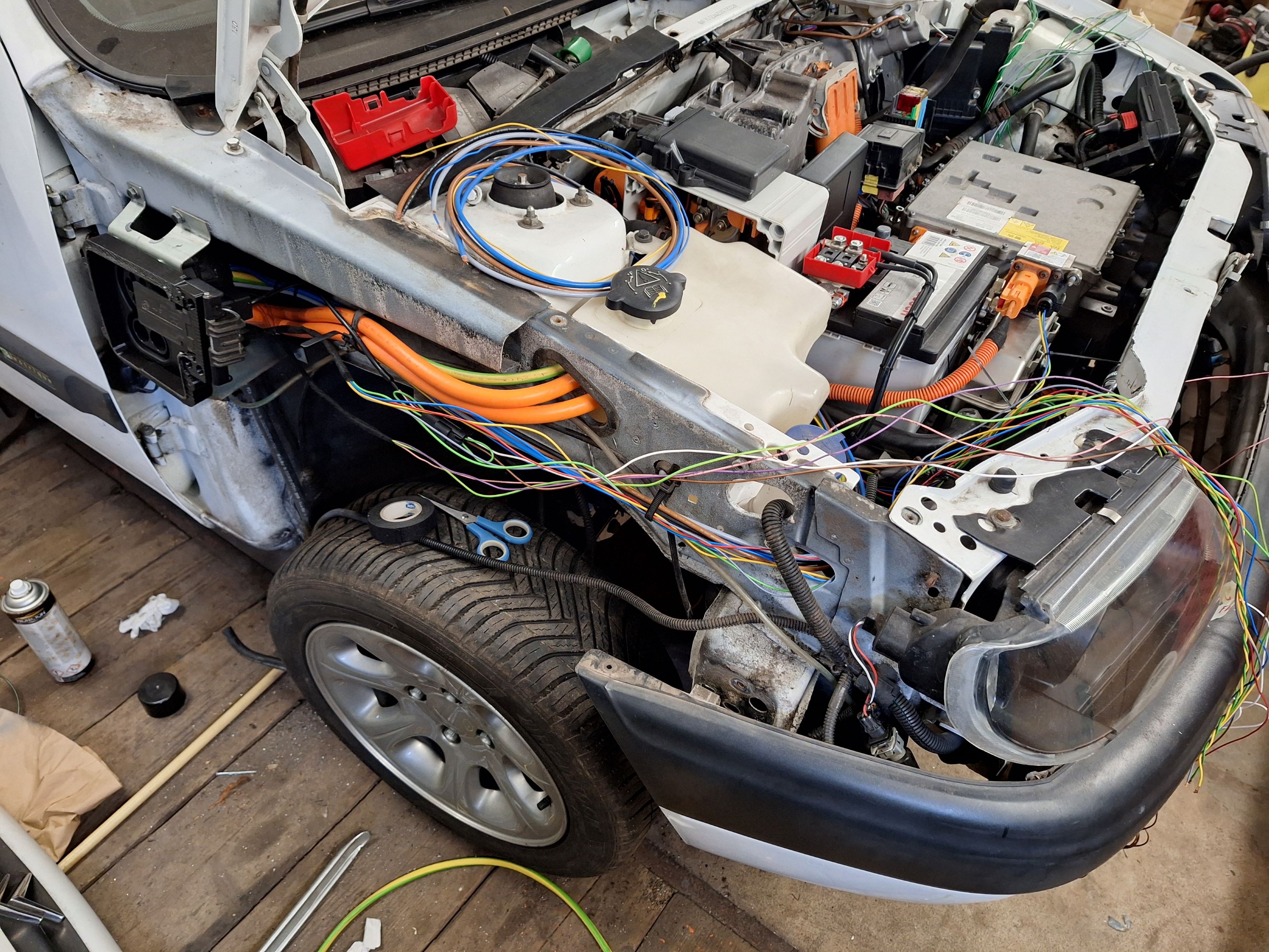

Have made some good progres.

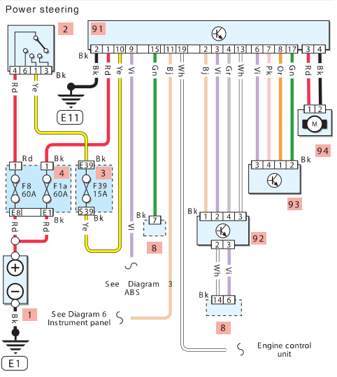

EPAS:
Originale I bought a Corsa power steering column. This is way to big, the column is to long and the motor is to big to fit under the dash. After some searching online I ordered a steering column out of a Renault Clio II which is much closer in size to the Saxo column.
Cut and welded the two steering columns to make one that will fit under the dash. Did loos the steering lock, but I think that it will be fine without. I did not get a universal joint with the steering column, ordered a random steering shaft that looked good. The two outer joins where to big, but the inner joint to change the length of the shaft fitted perfect. Hammered the joints apart, and mixed the old and the new. Luckily the bearing size and spacing are the same.
To resist the torque from the column, made a bracket to bolt the column to steering wheel supports.
Brakes:
I fitted the Ebooster a while ago. Had to order brake line and fittings to connect all the lines. The original master cylinder had 4 ports. The new cylinder has just 2 ports because all modern cars have ABS. The Saxo does not have ABS, to make the lines work I bought 2 T-pieces. The original brake lines are 5mm and have M10 nuts. The new cylinder has M12 thread for 8mm pipe. Found some M12 nuts for 5mm pipe.
Mounted the inverter to the firewall and cross brace.
Next batteries 8-)
