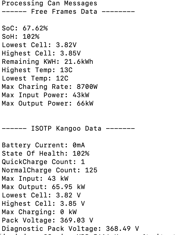

Anyone got any info on using ISO TP to request data from a Kangoo BMS, source code would be even better.

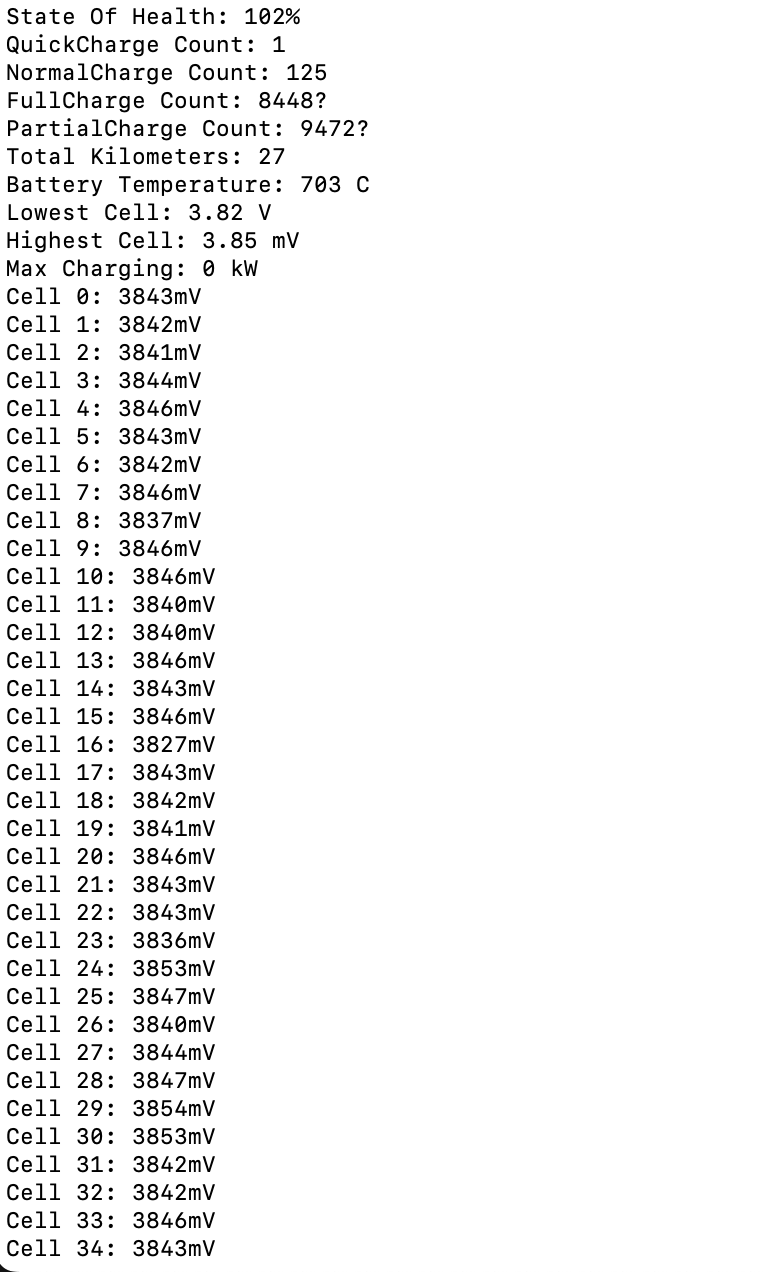

Ive figured it out, and now working on some code, will add the github when it's done.
Some values still need some work, but I'm able to query all the cell voltages and some other values.VW Beetle 2003
