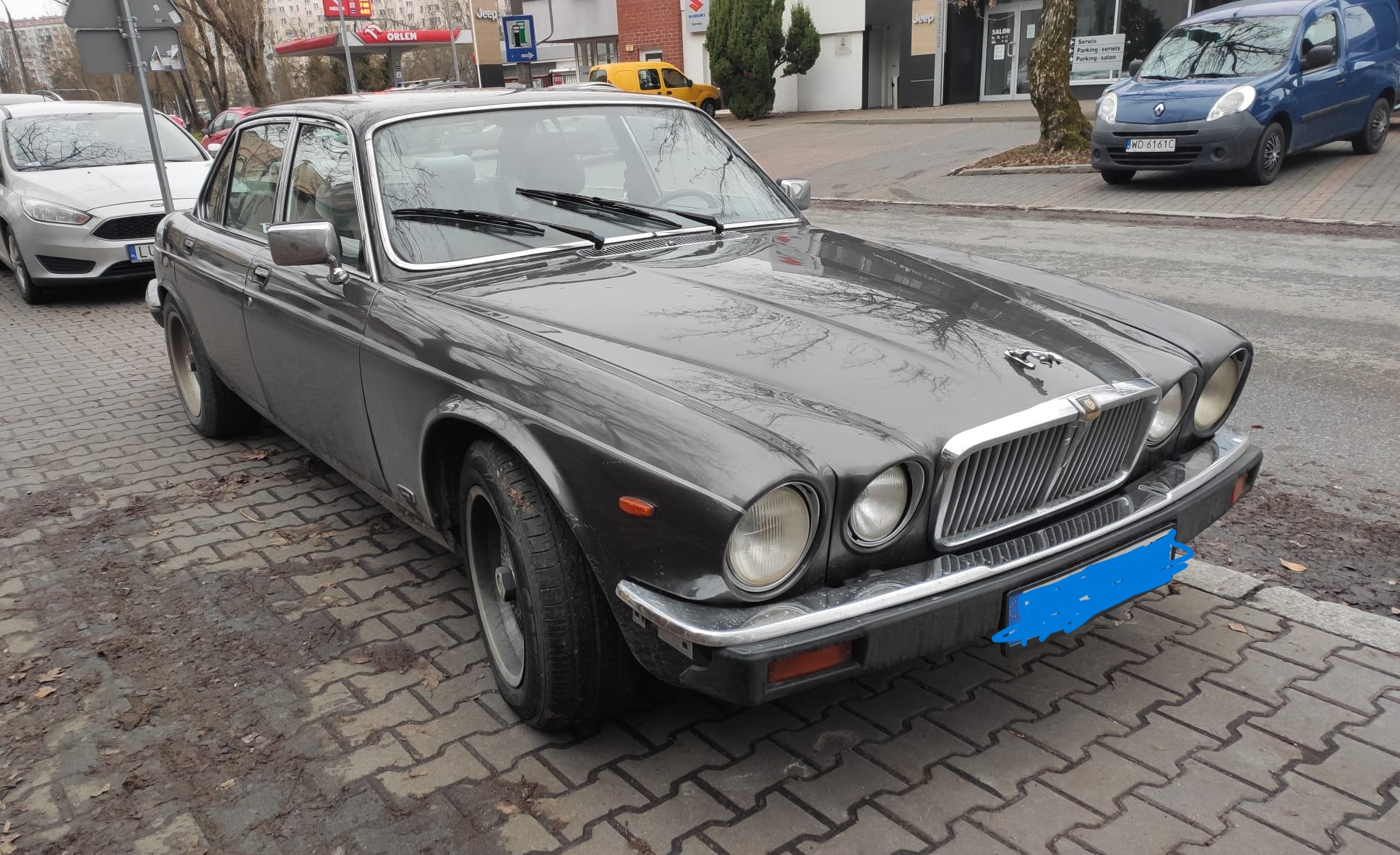

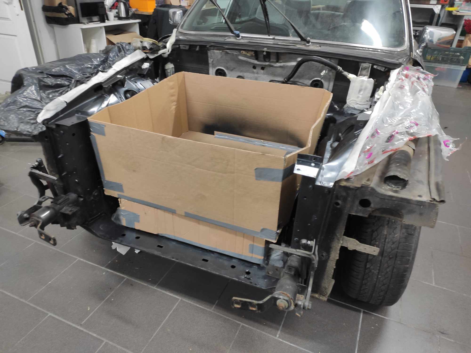

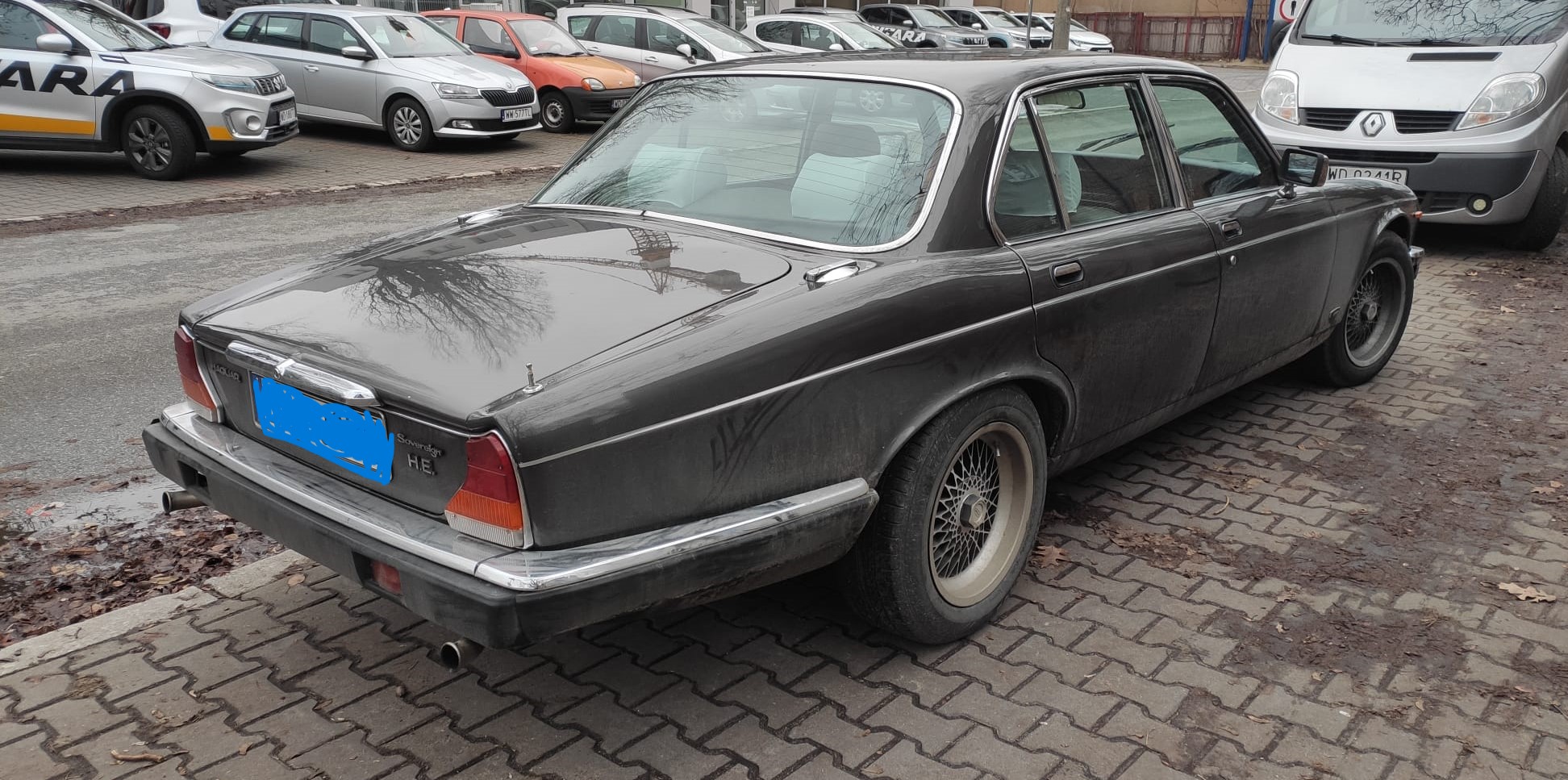

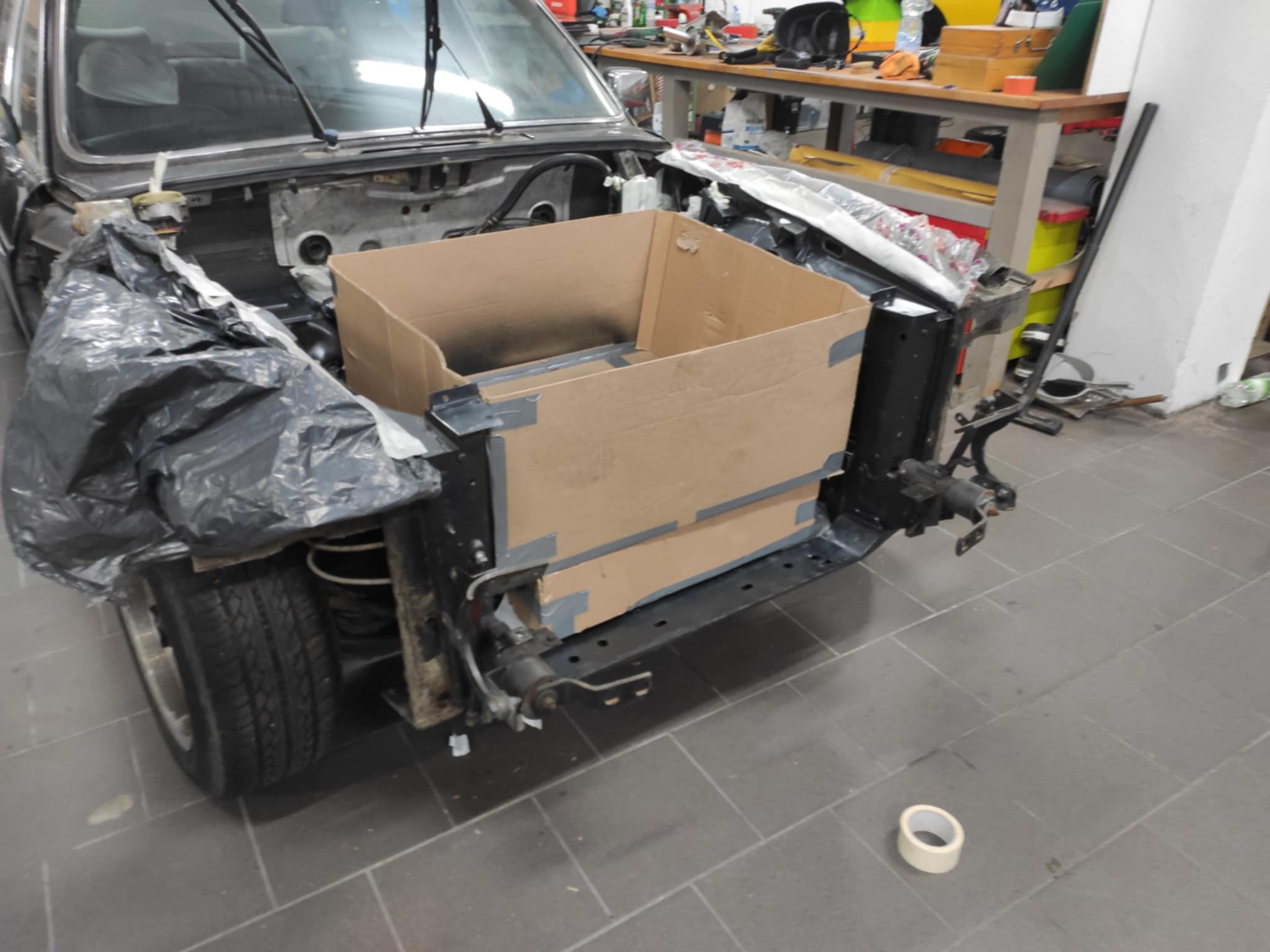

I finally have the legendary 1984 Jaguar XJ6 in the garage. Some may say it's crazy to convert this vehicle (and its incredible engine) to electric. And I won't argue, the engine is marvelous, but consuming almost 30 liters per 100 km makes it financially unviable. In any case, my idea is to use an electric transmission/motor/gearbox to convert it. Initially, the two options would be the gs450h or ls300h, although, and here comes the first doubt, I would like to have at least the same original conditions. We are talking about a vehicle with a 5.3-liter engine with 432 Nm, a monster of a vehicle, weighing 1930 kg. I understand that the 450 should be sufficient and do this job well. On the other hand, due to the RWD, a Tesla doesn't fit well. Here are the specifications of the donor vehicle:
https://www.ultimatespecs.com/car-specs ... gn-HE.html
So, the first question I need to resolve is 450 vs 300. As for the VCU, there's no doubt, Damian and his Zombiverter will do the job very well. Regarding the battery pack, and taking advantage of the lowered prices (Poland, Europe), I'll go for the maximum allowed by the weight, as I have no space issues. With the monster of an engine and the two gasoline tanks it has, I can probably reach 60 kWh or more. The rest of the components, and to stick to a low budget, will come from different sources, keeping an eye on previous conversions done here, especially Artur Kustusch's. This won't be my first conversion; I already converted a Mini R50 in 2020, but it was somewhat easier with a Nissan Leaf and the help of a mechanic. So, I look forward to your opinions... constructive ones and I'll be posting updates as I progress.

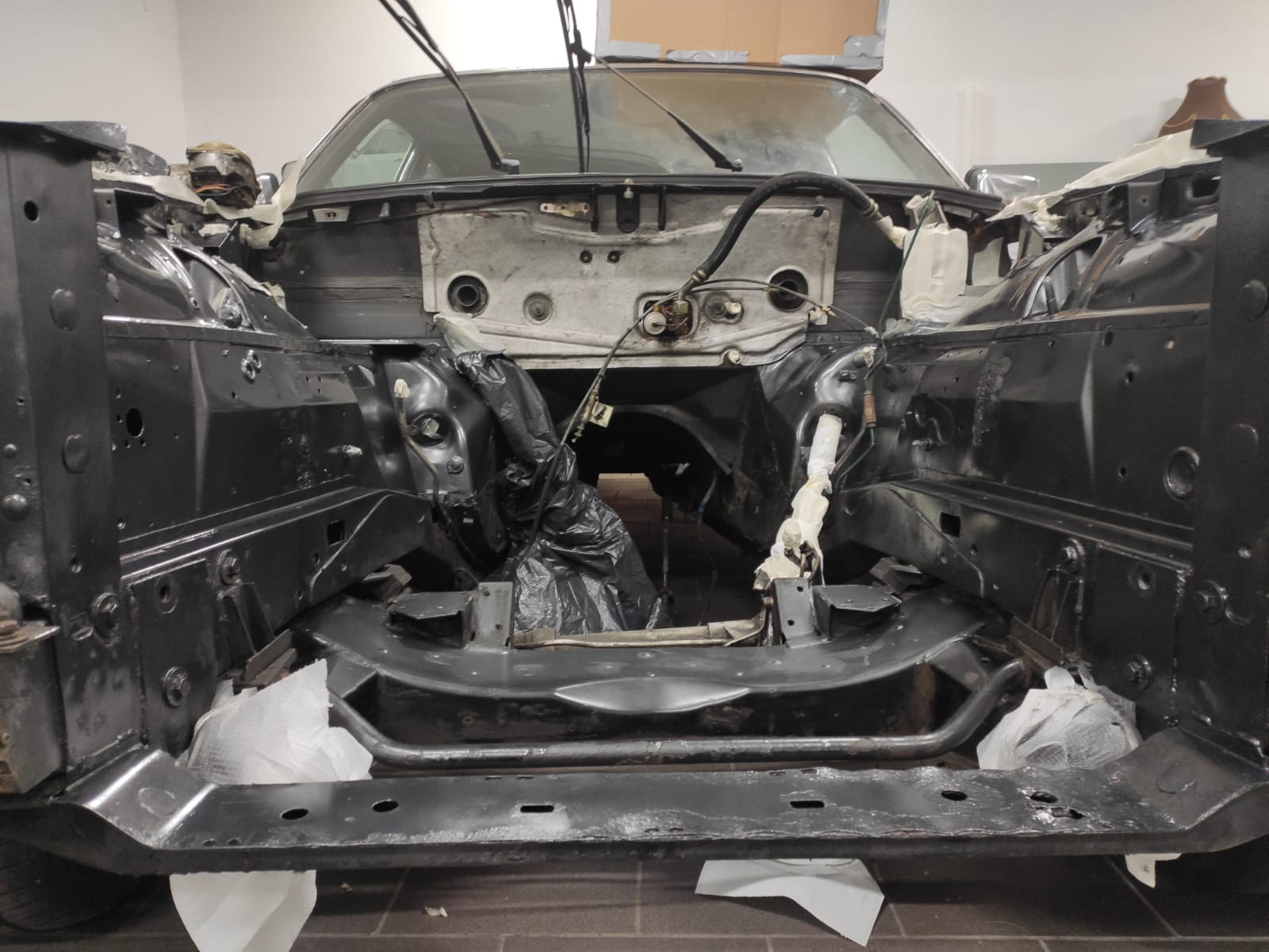

Yeah, one of the ideas is avoid modifications on the chassis so in case one day some crazy one want to comeback the V12.
About performance, the LDU or even SDU is more than enough for this car but will have to modify it. So then Gs450h will be, I was just doubting about the torque/power, but should be enough. Other point is the inverter, I will try to avoid the one from gs450h (G9201-30010) as per expensive one, and will use Camry inted.

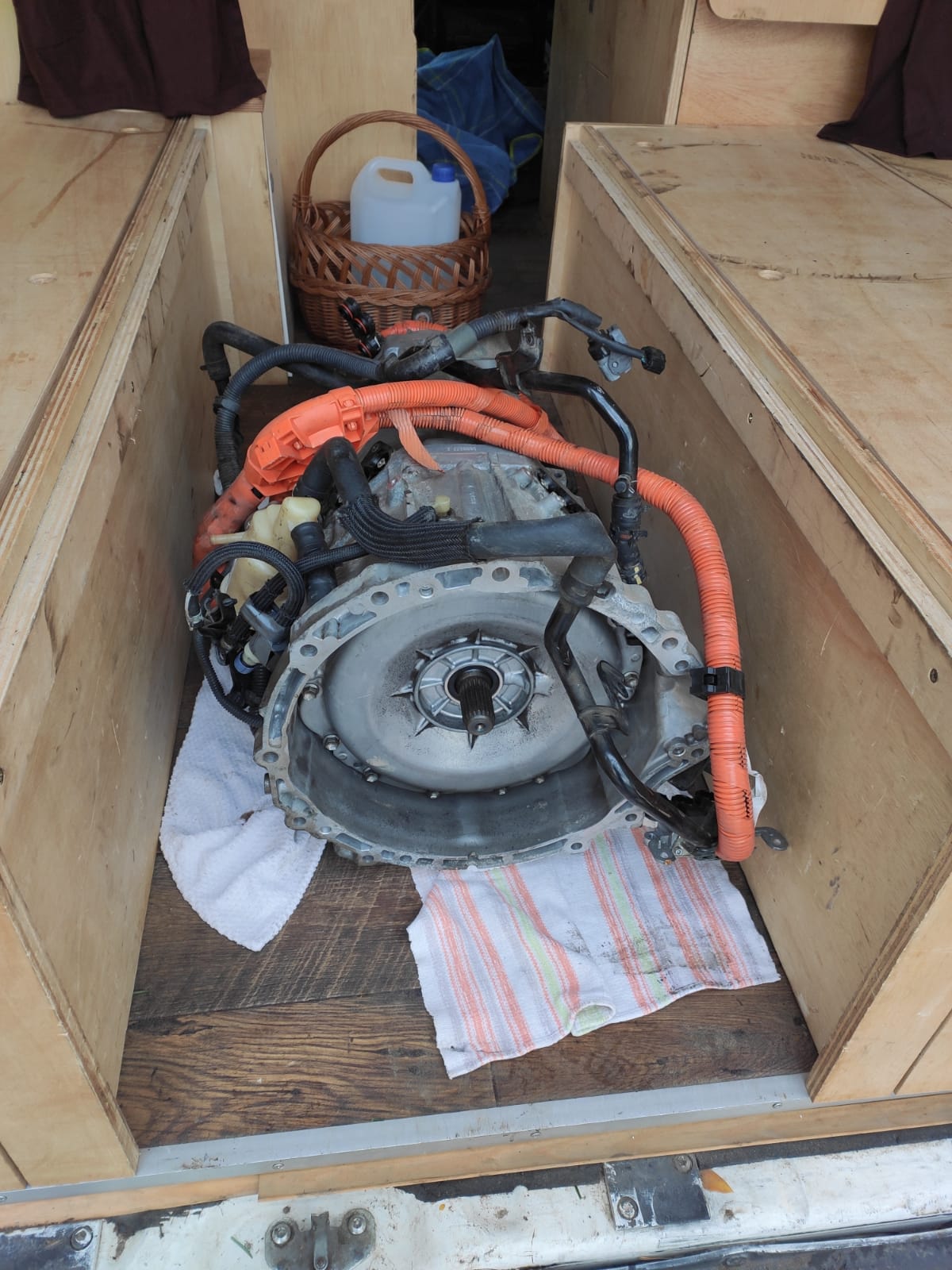

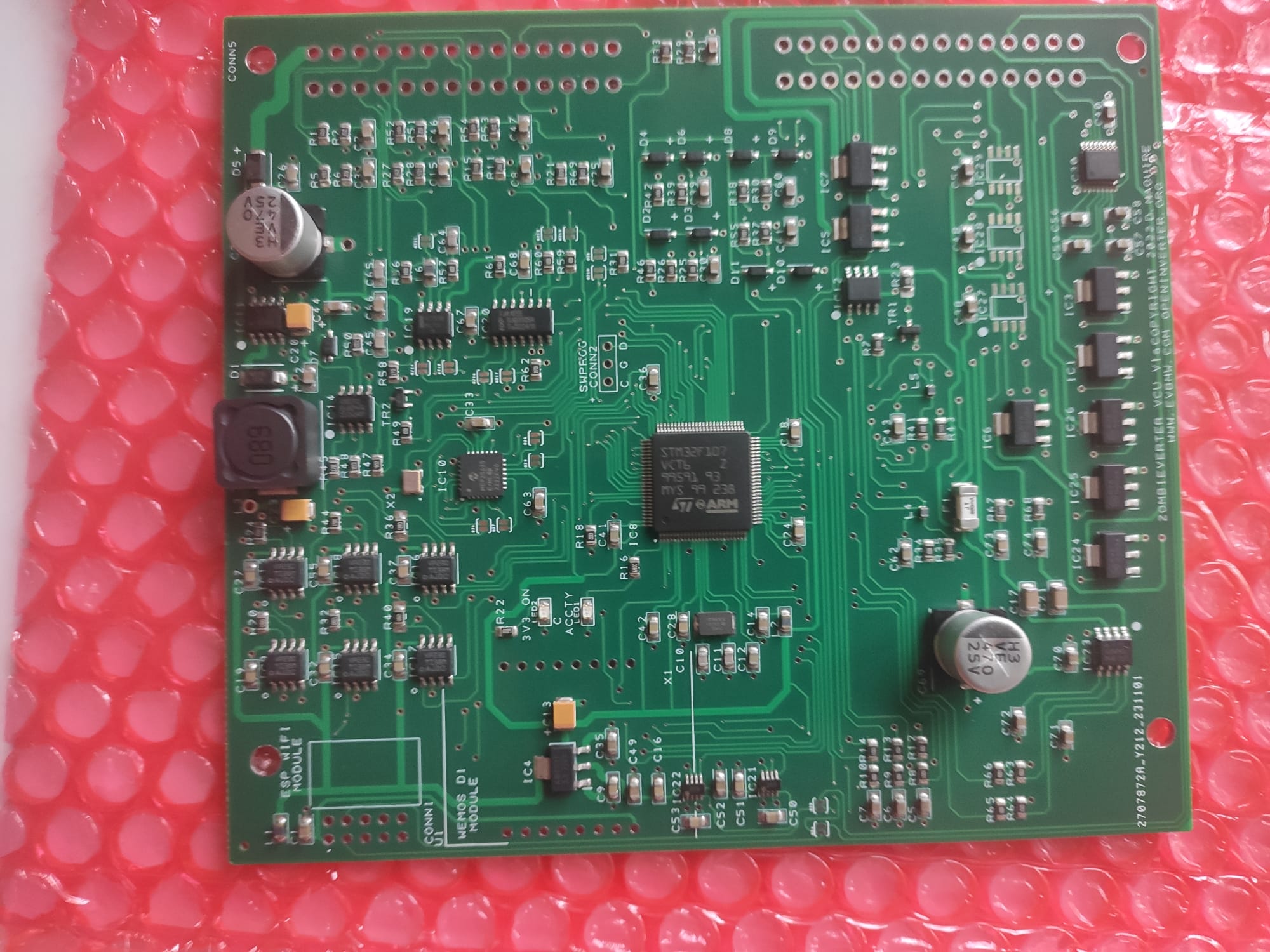

Getting ready, I have bought the gearbox/motor, now will focus on inverter and there I have soooo many doubts. Will see if anyone will reply about which kind of inverter are under Zombiverter code for this engine. Happy Christmas !!!

Re: Jaguar XJ6 V12 will be electric!!!
That's a gs450h transmission right? You'll want a GS450h inverter to do with it. Pretty standard setup for RWD cars and Zombie will have no problems.
Hi Bigpie, Yes it's a gs450h, I'm base in Poland. There are a lot of versions of inverters here but among all of them, the one for gs450h (G9200-30030) is the most expensive. I saw the videos of Artur, totally inspiring, I will follow his build. Just need to confirm if Camry or other inverters like gs450h version from 2014 or 15, will work.

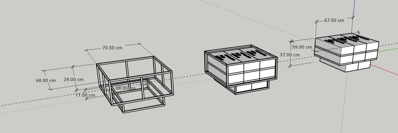

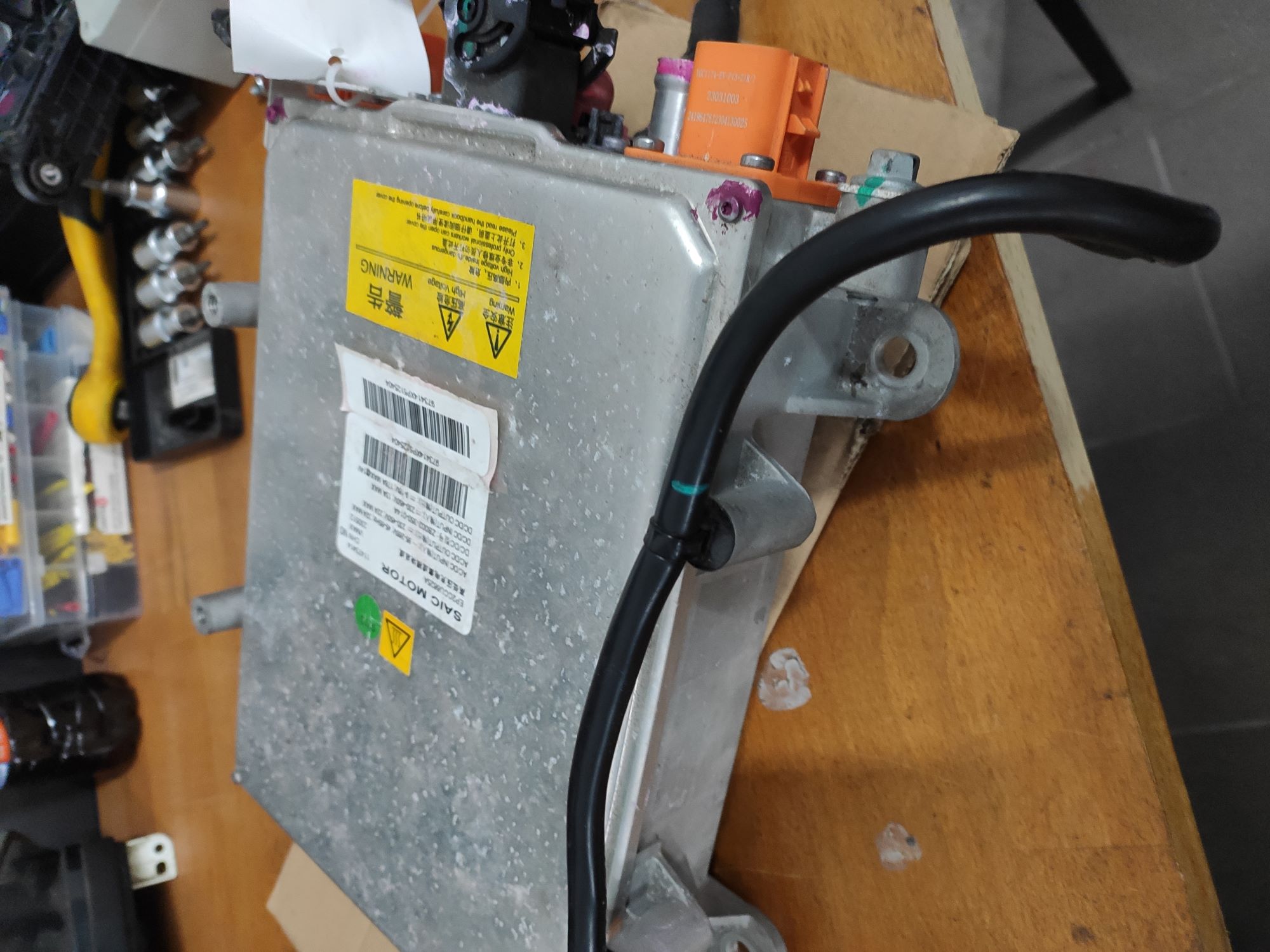

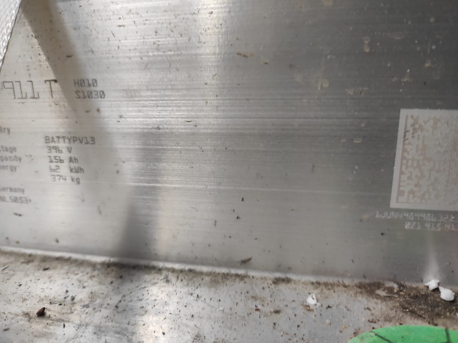

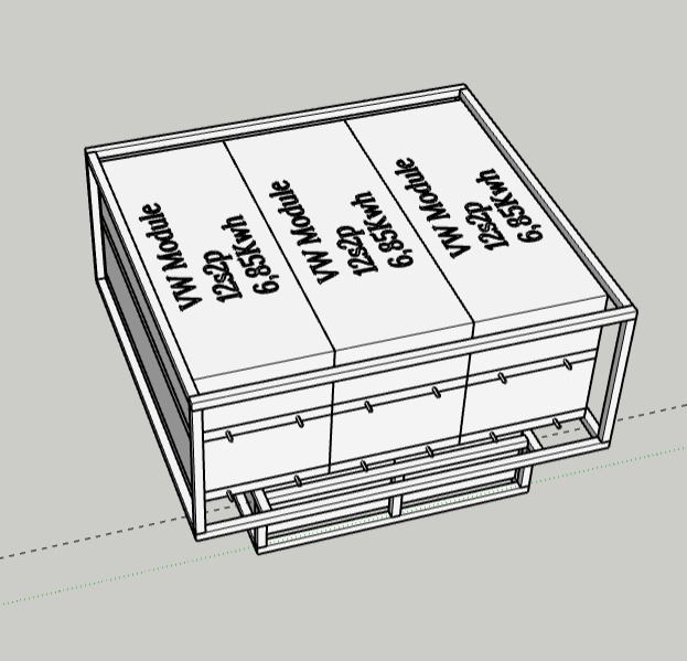

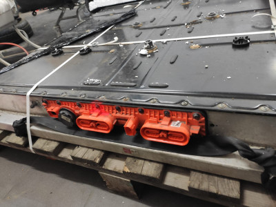

The inverter has arrived, now waiting for the Zombiverter and getting ready to start tinkering. I need to find the batteries; I was thinking about 40-50kWh, but it raises a question. I know the Gs450h can operate from 288V; initially, I was planning to go with 400V to make all components more compatible. However, here's the question: would increasing it to 600V allow me to develop more power? Is there a difference that justifies going from 400V to 600V, for example?
The increase in voltage does increase the power. But only by increasing the rpm at which the torque starts to drop off. So you wouldn't neccesarily see any increase in power low down. But you would notice it higher up the rev range.Tachopis wrote: ↑Sun Jan 07, 2024 8:59 pm The inverter has arrived, now waiting for the Zombiverter and getting ready to start tinkering. I need to find the batteries; I was thinking about 40-50kWh, but it raises a question. I know the Gs450h can operate from 288V; initially, I was planning to go with 400V to make all components more compatible. However, here's the question: would increasing it to 600V allow me to develop more power? Is there a difference that justifies going from 400V to 600V, for example?
Great for the response LRBen, therefore, it is the increase in RPM between 400v and 600v that I would notice. I have to assess whether this increase is worth the extra configuration and components.
Some real-world impression on 650V. You'll be fine with 400V as others have proven and can stick to more OEM parts like the on board charger etc.Tachopis wrote: ↑Sun Jan 07, 2024 8:59 pm The inverter has arrived, now waiting for the Zombiverter and getting ready to start tinkering. I need to find the batteries; I was thinking about 40-50kWh, but it raises a question. I know the Gs450h can operate from 288V; initially, I was planning to go with 400V to make all components more compatible. However, here's the question: would increasing it to 600V allow me to develop more power? Is there a difference that justifies going from 400V to 600V, for example?

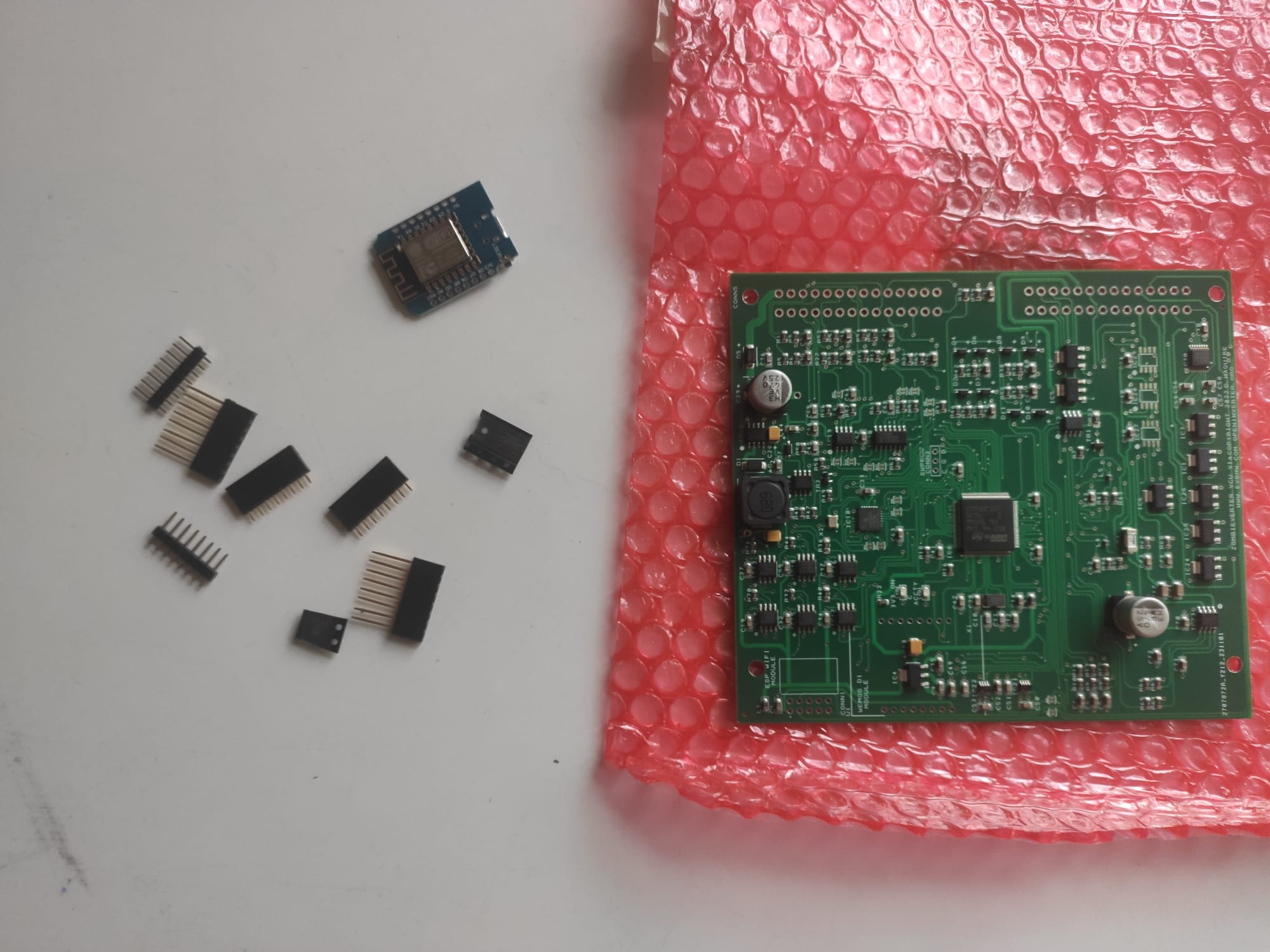

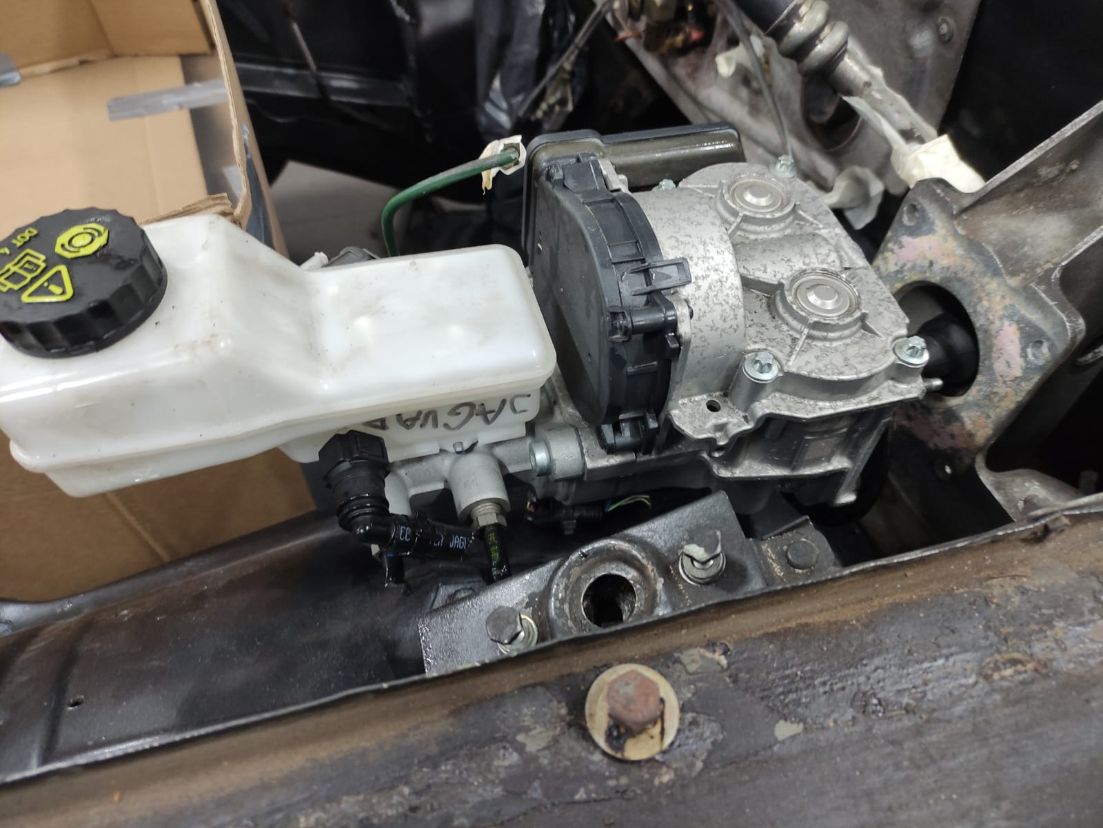

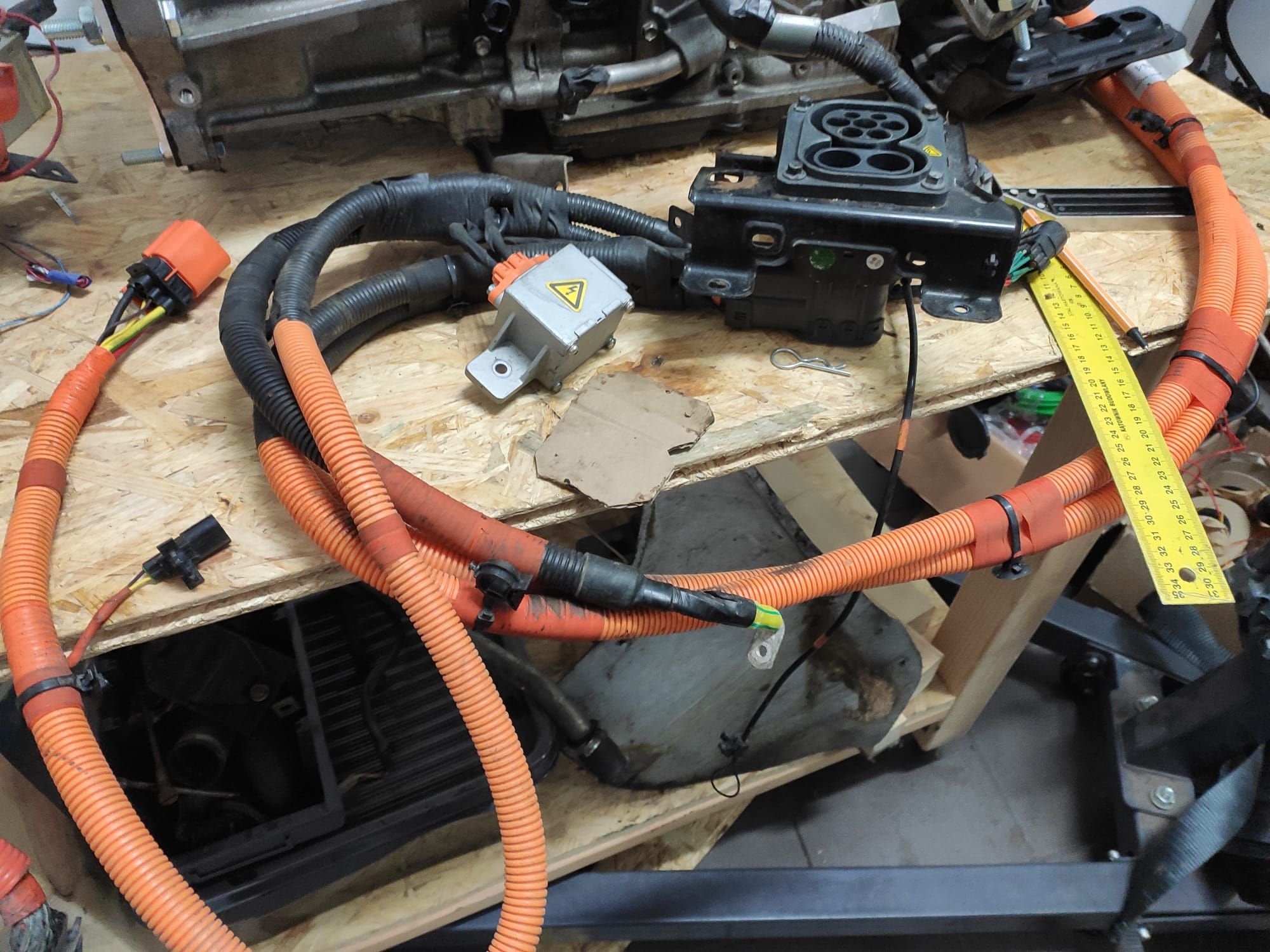

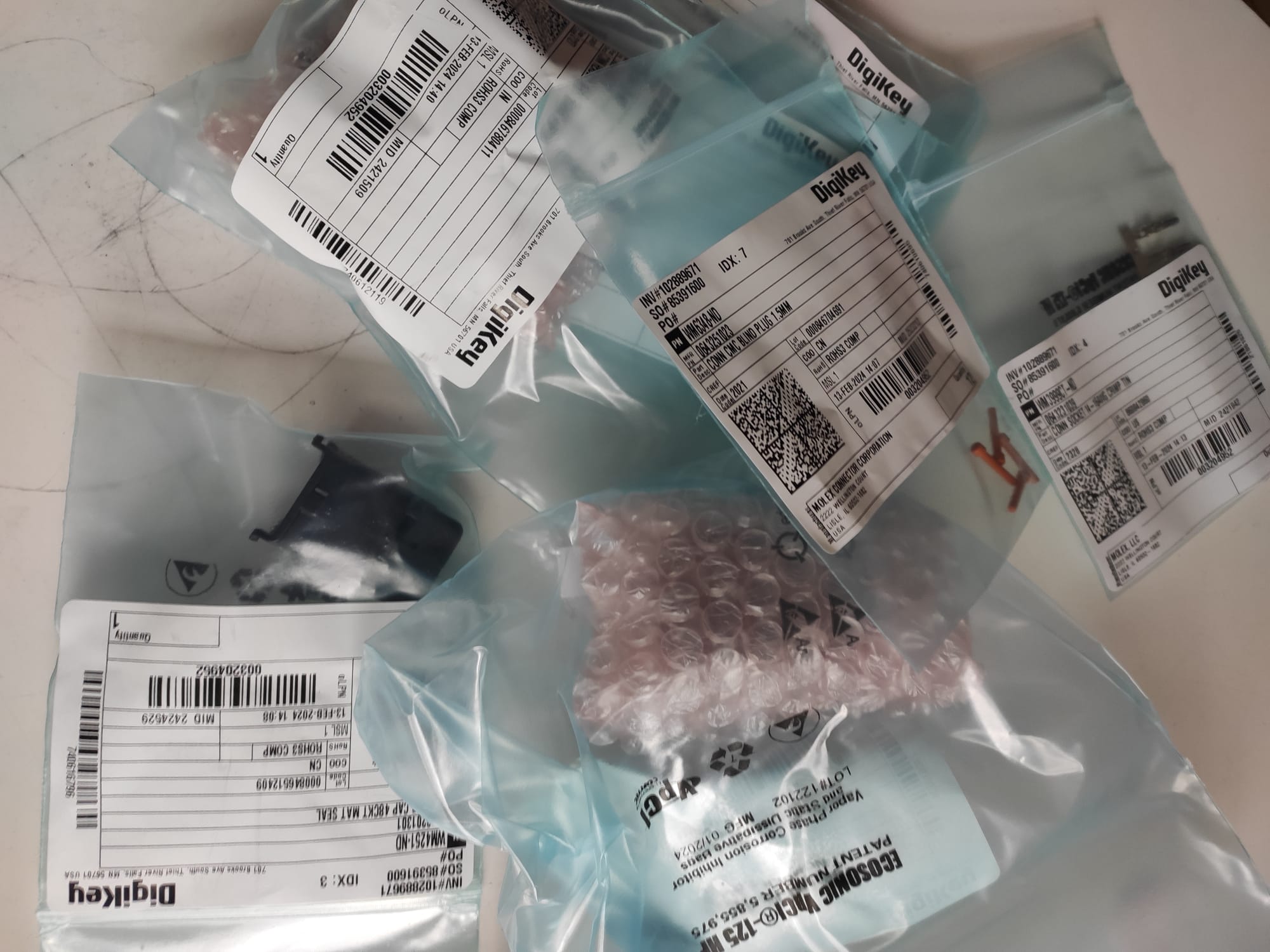

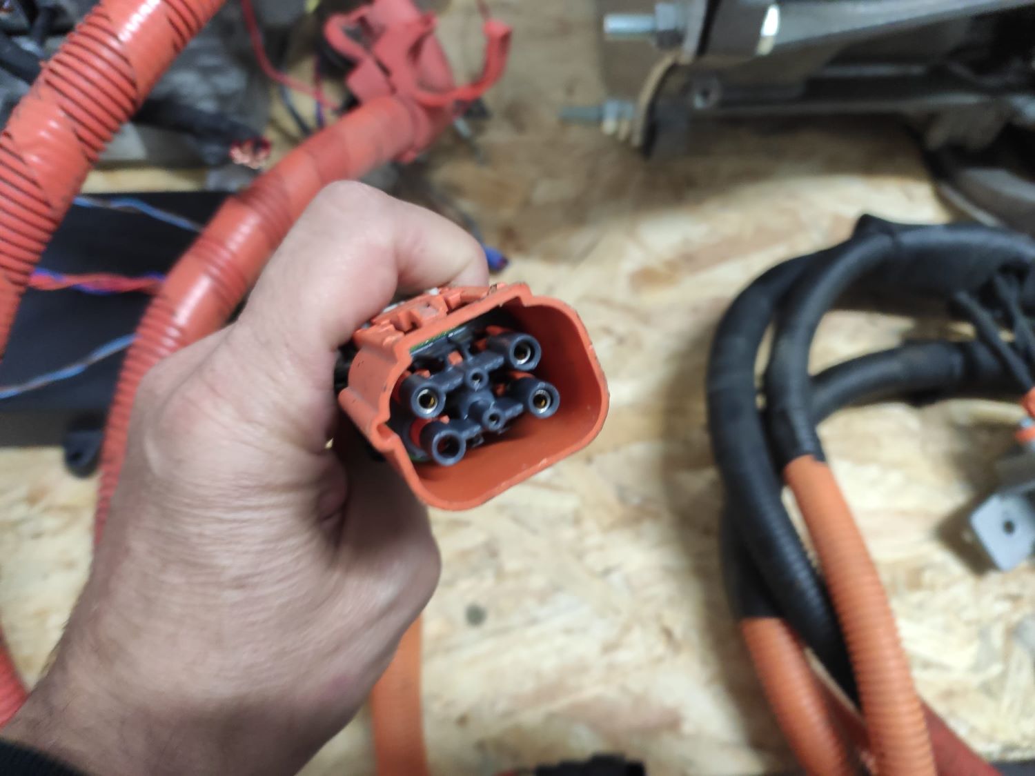

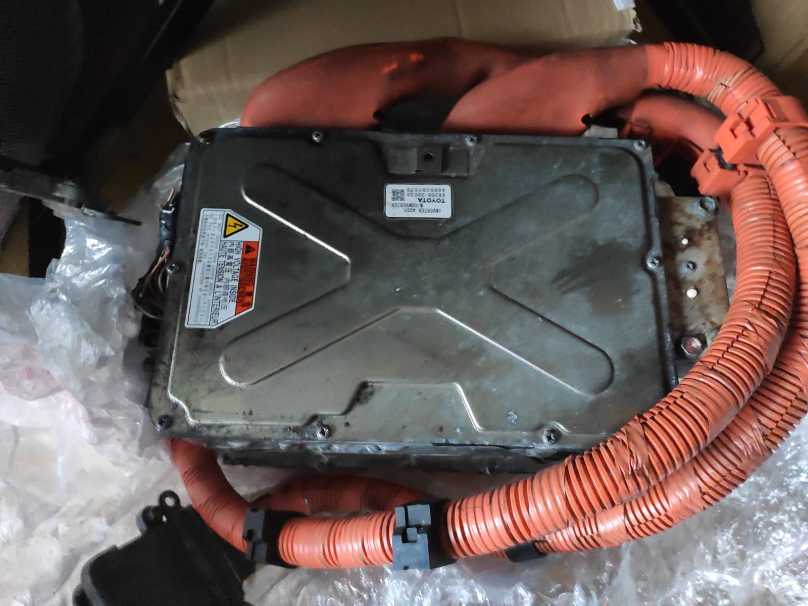

Well well well, look what came yesterday. Now I'm waiting for the connectors to start the wiring. One question I have is if there is a possibility to use the DCDC converter that comes with the Lexus gs45h inverter. If not, I will have to look for an external OEM one. Thanks a million Damian!!! will keep you posted.
There's no built in DCDC for 12v within the GS450h inverter
