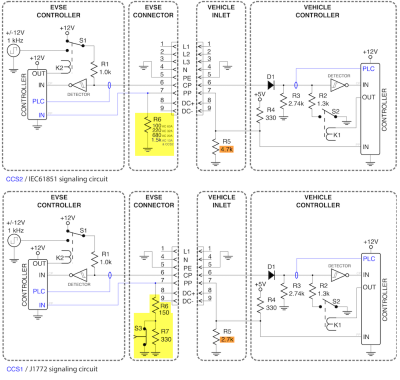

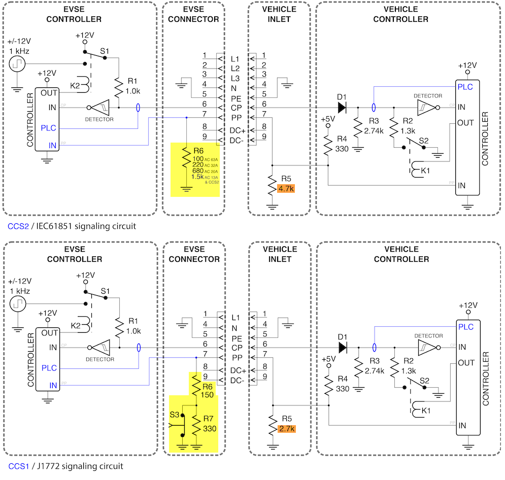

My plan is to use the PP with an analogue in on zombie to automate charging. Though this isn't coded yet
Should be simple code and a couple of resistorsVW Beetle 2003

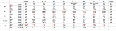

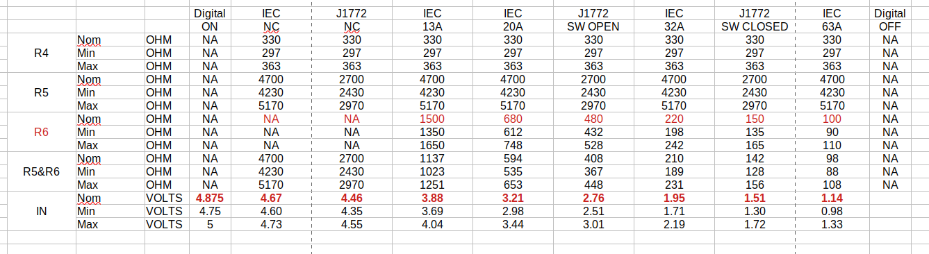

here an excel sheet that's got the actual voltages that the pin will see
for the lazy here a pic

https://github.com/damienmaguire/Stm32-vcu/pull/69 I've added the ability to map one of the analogue input pins to be used with the Pilot Prox to enable charge mode. Needs the external resistors from the diagram above and the threshold setting if anyone wants to test it.
