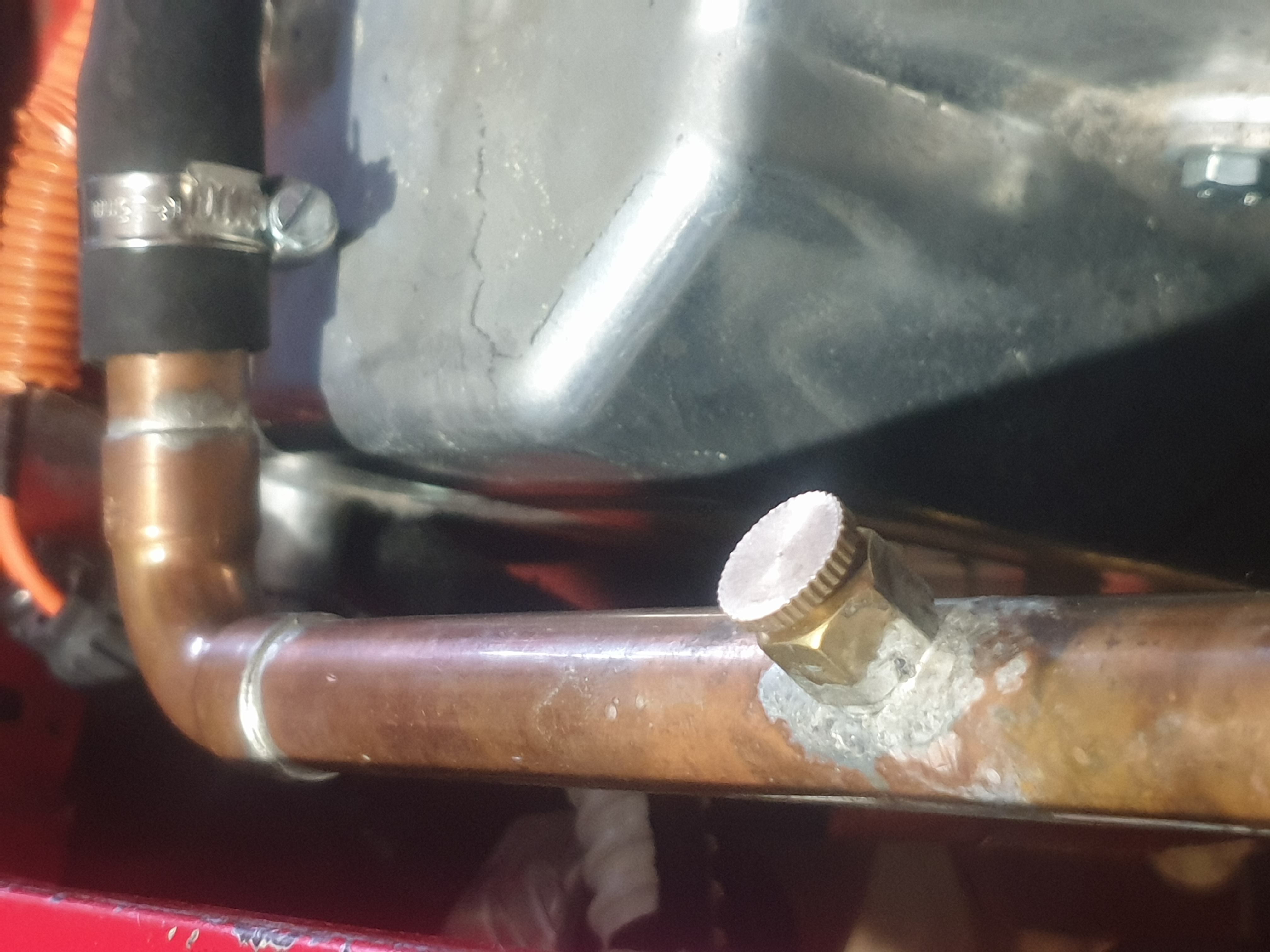

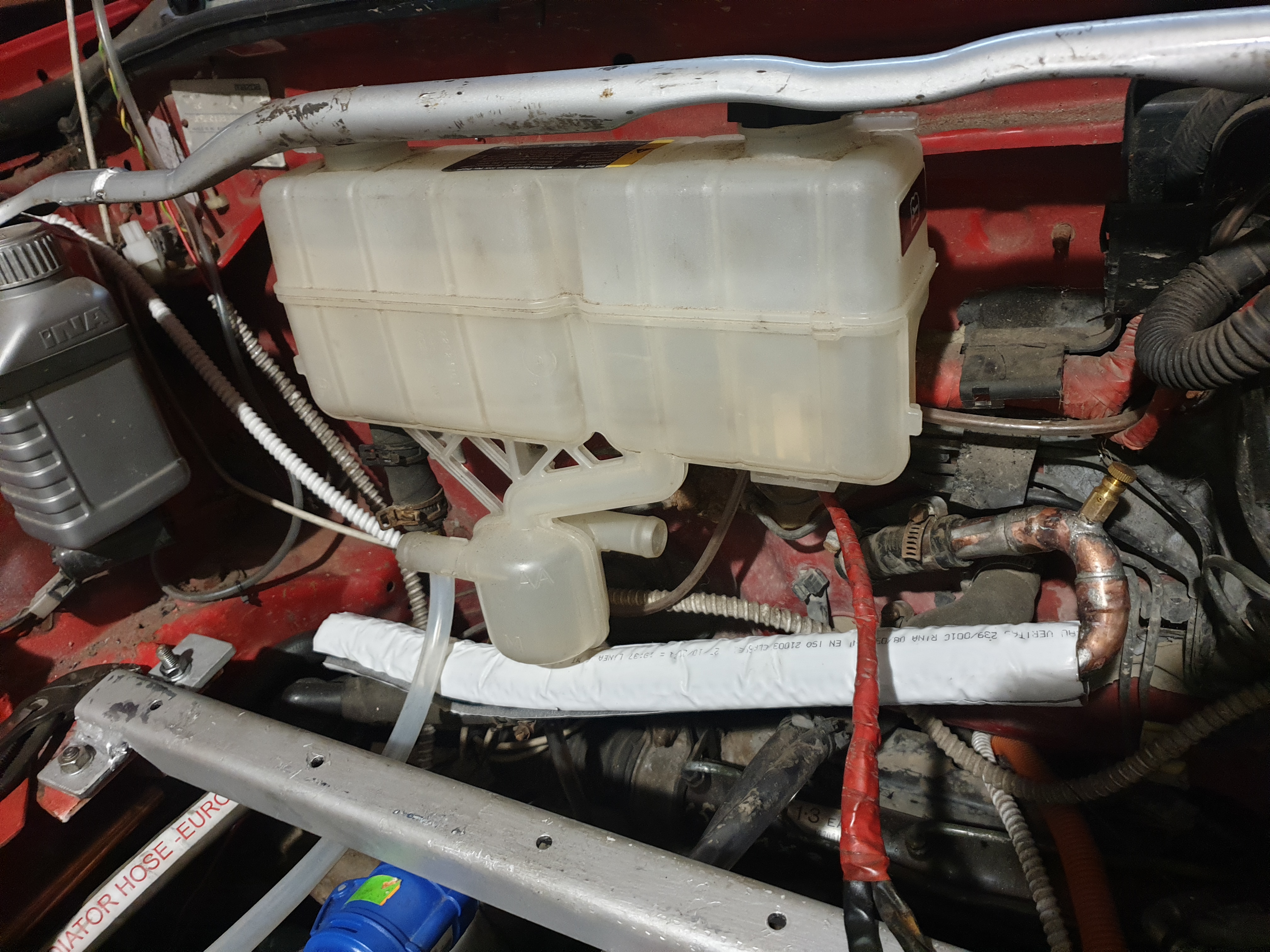

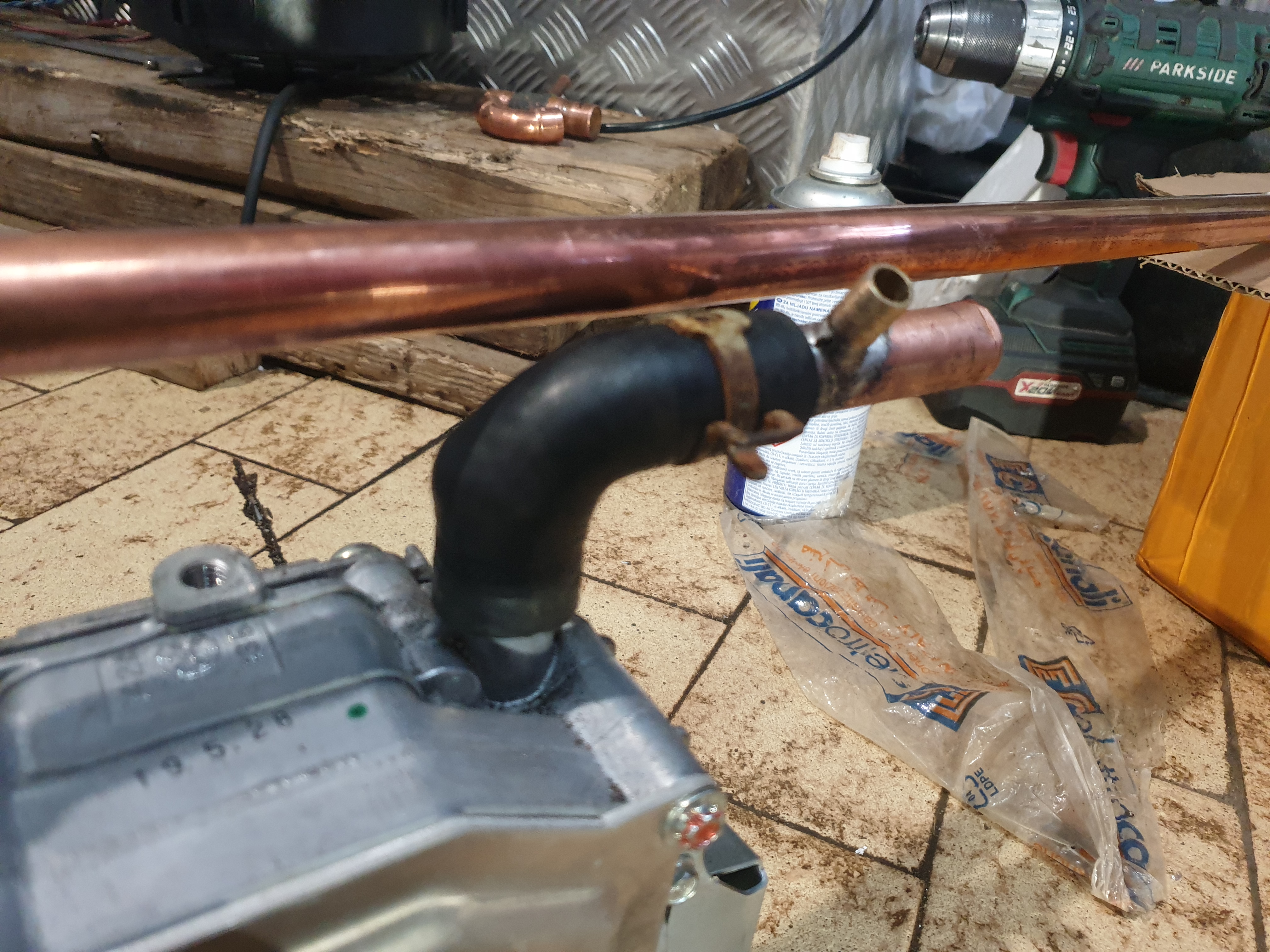

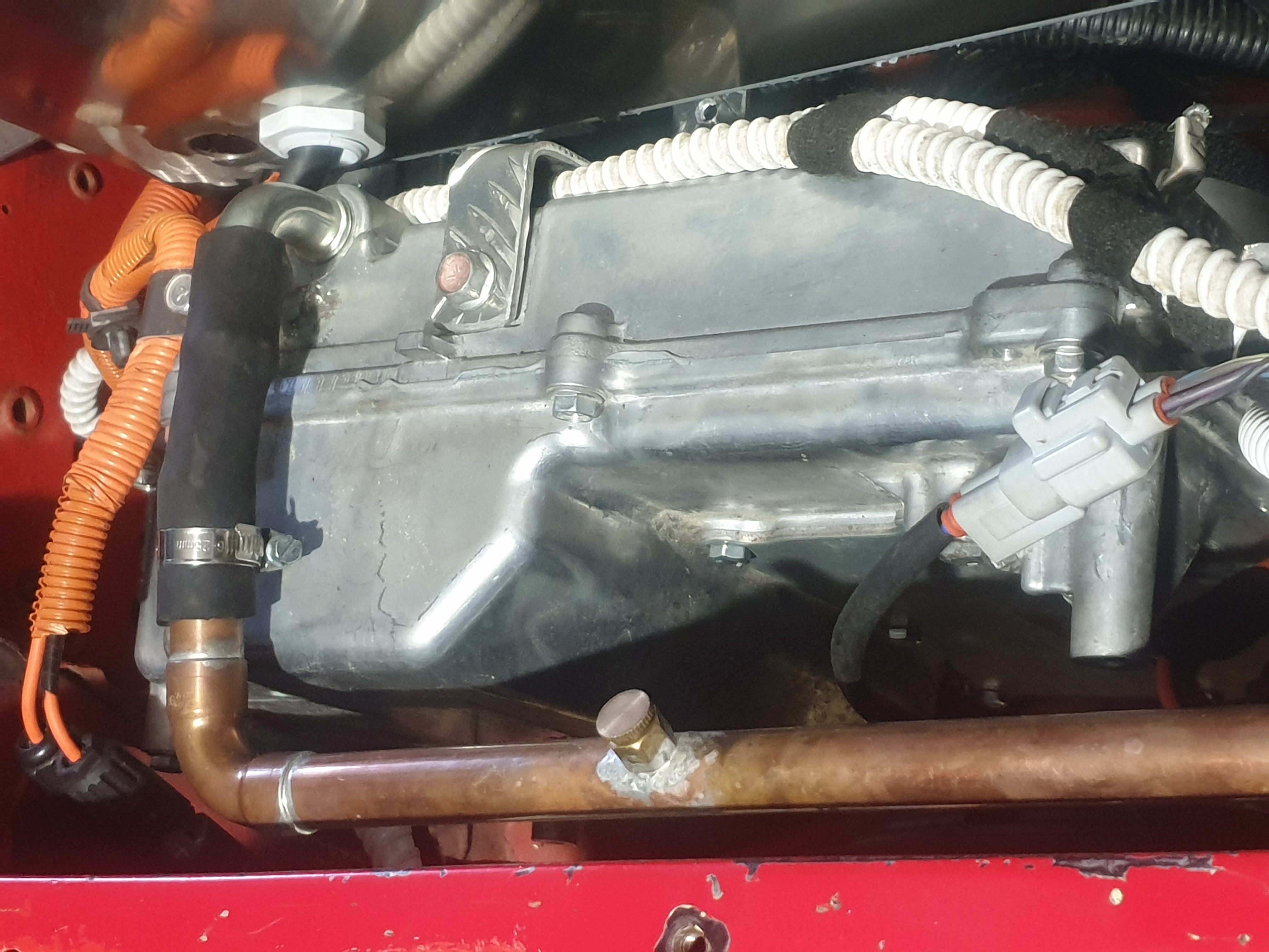

- Posts: 3265
- Has thanked: 80 times
- Been thanked: 234 times
Re: Radiator Core Size...cooling capacity?
See here the deair system i use .P.S.Mangelsdorf wrote: ↑Tue Nov 28, 2023 1:20 pm On my LDU powered car, I have had many, many issues with cooling the drive unit on the street.
Here's what I've learned:
- having somewhere for the air that comes through the radiator to go is important. Like others mentioned, its easy for it to get stuck in an engine bay. I'm still working on getting the air out from underhood.
I use a piece of central heating copper tube dia 18mm make a 8mm hole and solder a brass screw valve to it perpendicular. I use plummers paste to guarantee good joint with solder. Zinc i use is thick pure zinc wire no other additives. You can get everything in a hardware store.
The idea is that valve to be on the highest point of the tubing. Your header tank must be higher though to supply liquid consistently.
On the lowest point is the pump and a supply intake. I simply solder 10mm copper tube on 18mm copper tubing so my header tank will supply liquid to the lowest (practical) part and liquid will push air out through the top vent.
There is no problem in using the same header for cooling and heating system as long as it is closed on both sides.

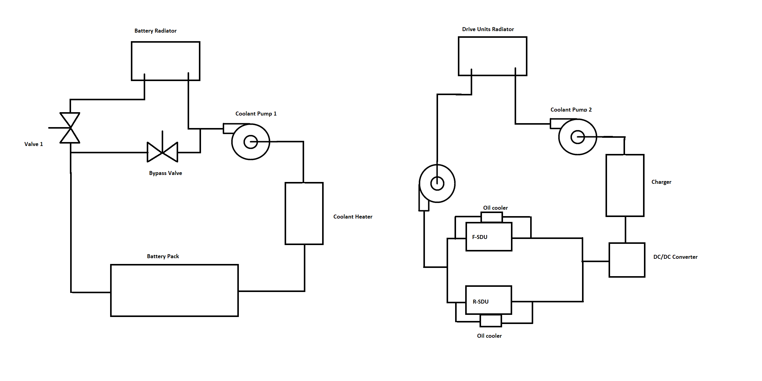

guys just want to share my design
The battery circuit will use 3/4" (19mm) tubing that matches the Yamaha Raptor 700 2019 radiator Inlet & Outlet ports
The SDU's circuit will have 1" (25mm) tubing. Parallel Tubing to the SDU's will be same length as much as possible. [img
If you're using 2 pumps in your design consider splitting the system between the 2 drive units. Meaning one pump for each drive unit.ardillolambo wrote: ↑Tue Nov 28, 2023 3:42 pm guys just want to share my design
I do not see a coolant reservoir in the diagrams. That can help get the air out. Also having a reservoir right next to the suction of a pump means you have a visual of coolant level at the pump inlet and are getting bubble free coolant to the pump if it's designed well.
One important thing that doesn't show up on a diagram is giving some effort to not create air traps in the system. These are spots where say a 90° hose starts at a 45° angle from vertical then turns back down 90° leaving a bubble collector. If you have to leave these spots for some reason a bleed line tap could be added with a T fitting that goes back to the reservoir. You want the reservoir to be the air trap and want one at the reservoir so the bubbles make their way out. Add a T and bleed line in any spot like this. Search "coolant bleed tee" and similar will find you a ton of options.
Pressure differences matter here, you'll know if the bleed line is working properly if you see some coolant flowing back into the reservoir through the small bleed line(s). Most reservoirs have a spot to view this well. Some old and crusty reservoirs are so cloudy you can't see it.
Split systems are especially difficult to get the air out. 2 reservoirs might be worth the extra fitment hassle (one front, one rear) to stay air free.
If you're doing different size lines try to make the return a larger diameter than the feed. It's easy to push fluid fast through a small line. It's not easy to suck fluid through a small line.
