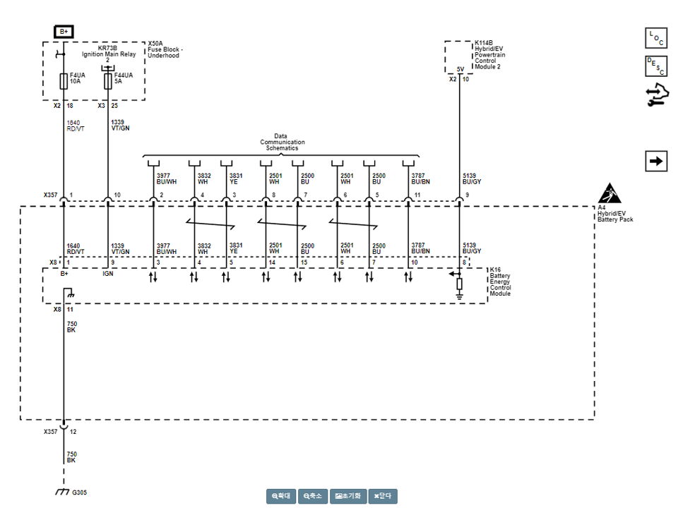

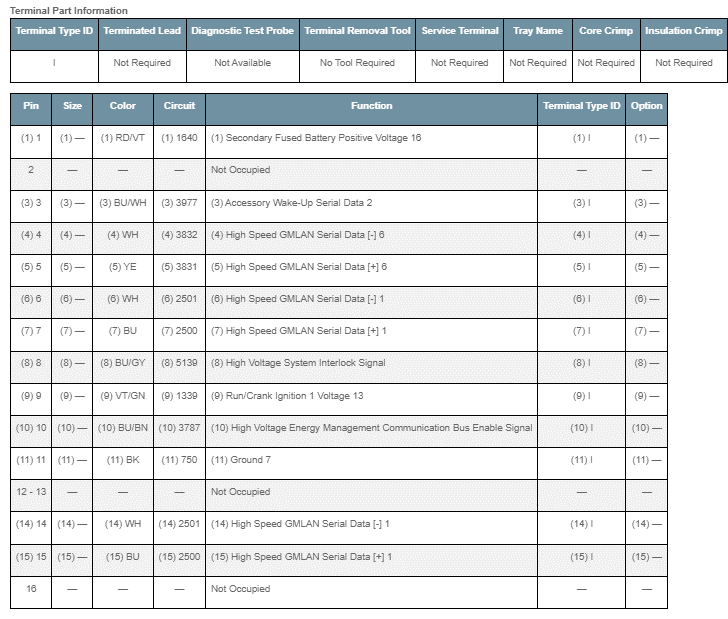

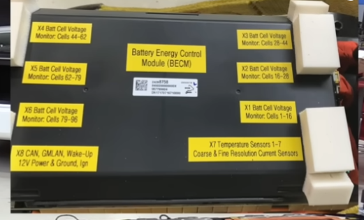

Chevrolet Bolt EV Batter Pack internal VITM[BECM] Controller (K16/BECM) CAN communication method
bupark007
Posts: 1
Joined: Fri Nov 24, 2023 5:43 am
Post by bupark007 »
I would like to connect to CAN Communications and obtain information on 96 cells. Is it possible to obtain information by simply connecting CAN_H and CAN_L to K16-X8 connectors 4/5 or 14/15?
I wonder if I need to put in a different power source. If I need to put it in, what pin number and how many volts should I put in?
