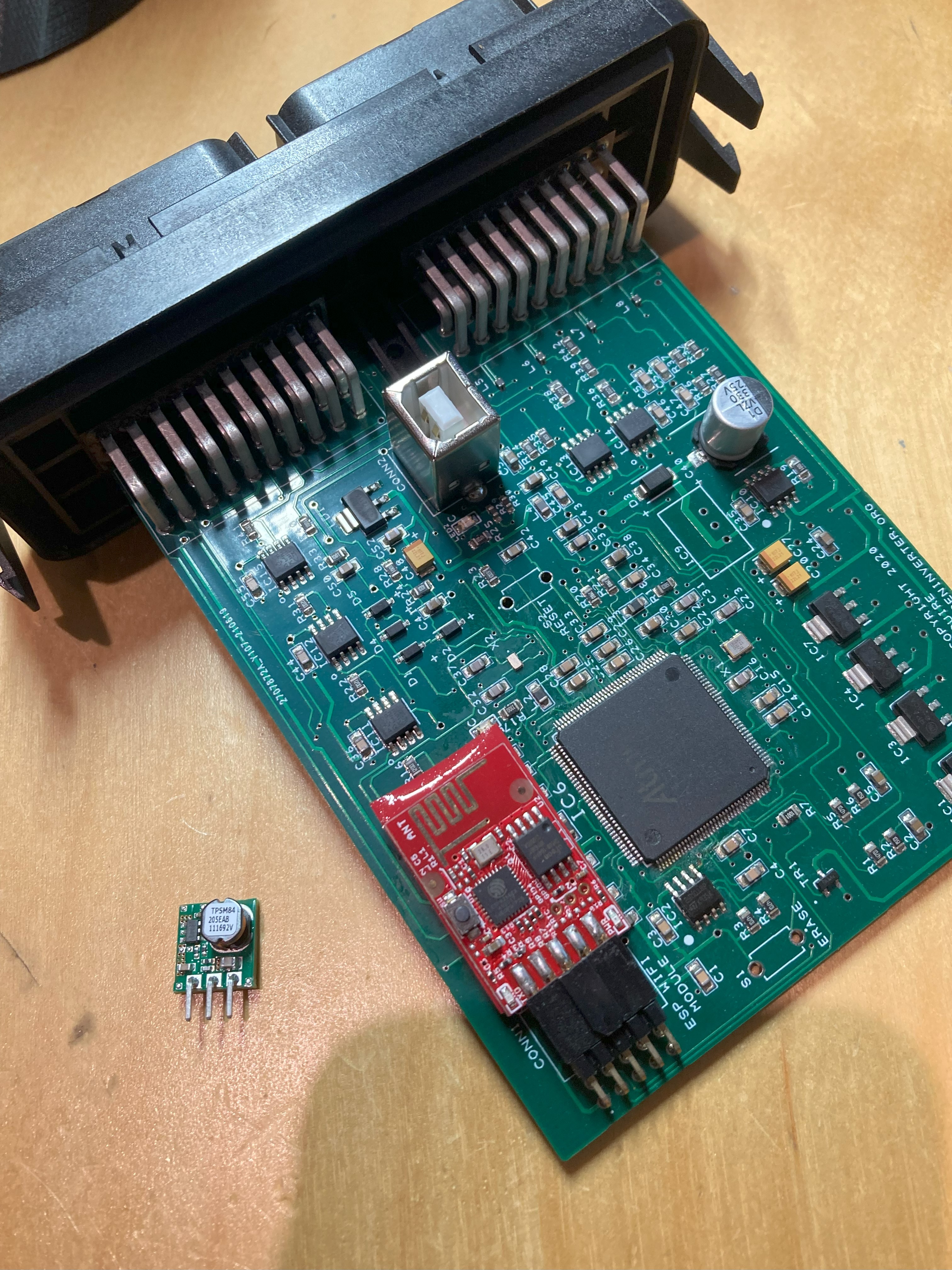

Lexus GS450h VCU IC9 position
Post by LeeB »

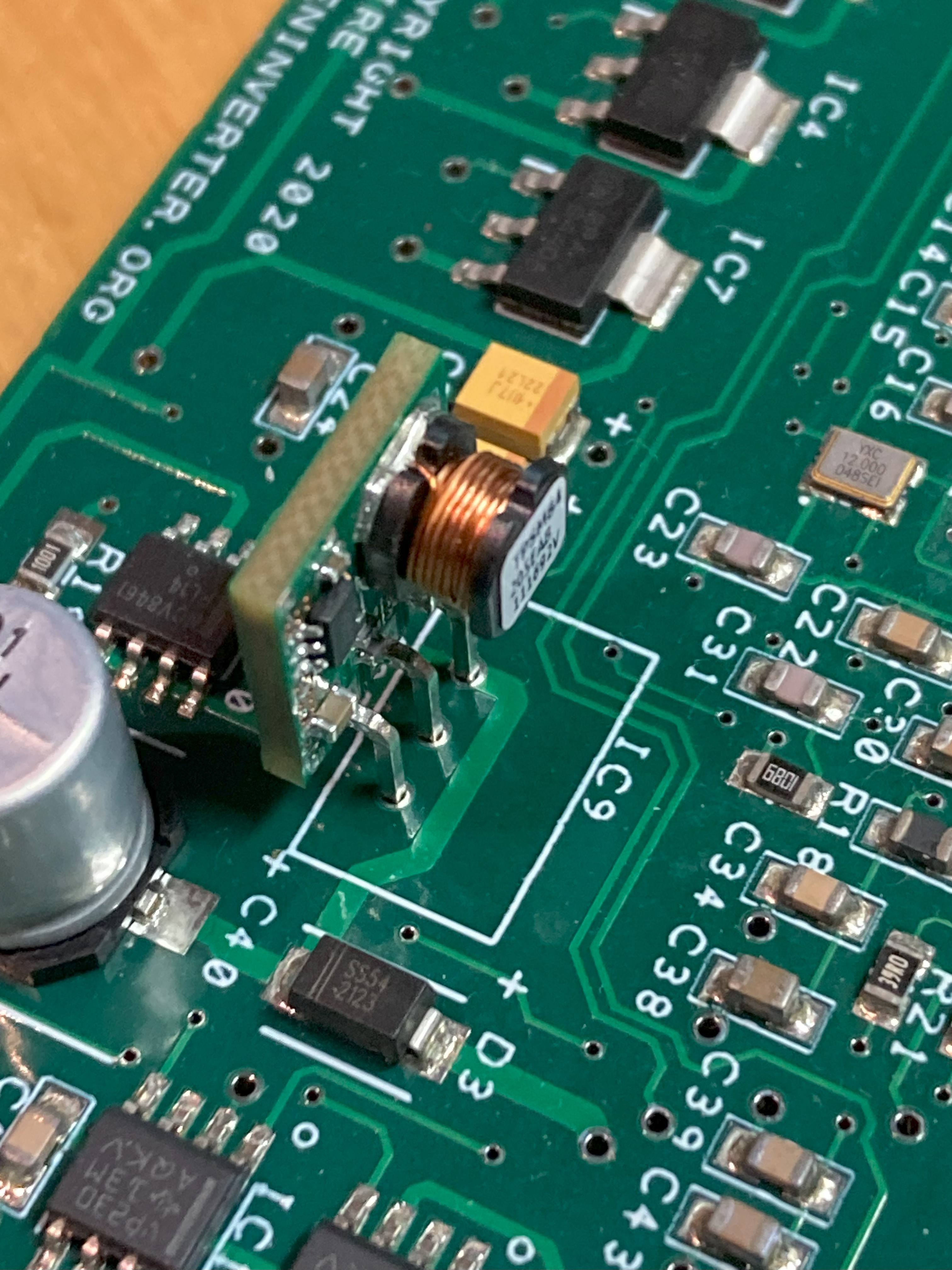

I have one of Damien Maguire's Lexus GS450VCU boards. In the videos the IC9 is always a potted up component which you align with the pronting on the PCB so that it get soldered in the correct way around.
On my kit, IC9 is a bare board with a choke, an IC and other components. Which way round does this go?
Thanks for any help!
royhen99
Posts: 265
Location: N. Wiltshire. UK
Has thanked: 22 times
Been thanked: 134 times
Re: Lexus GS450h VCU IC9 position
Post by royhen99 »
Part number is TPSM84205EAB. According to the data sheet the orientation in the first picture is incorrect.
