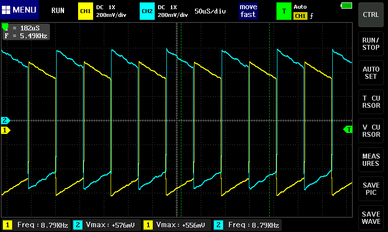

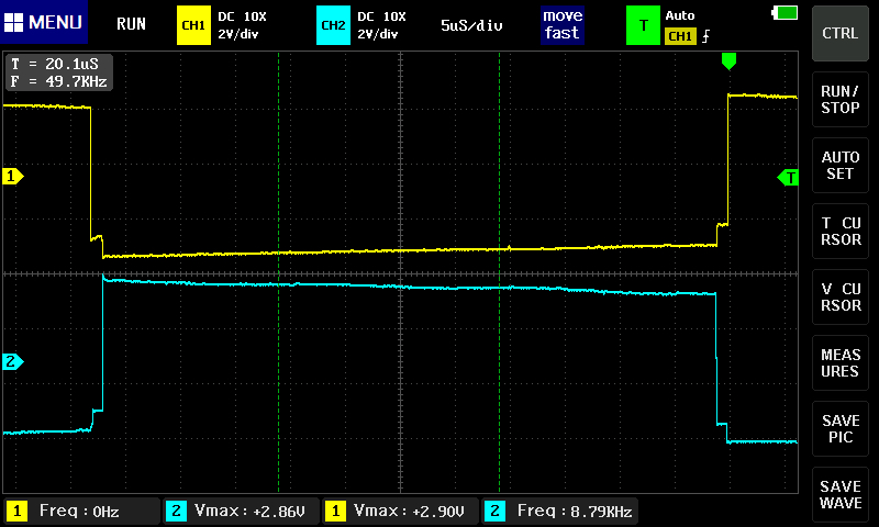

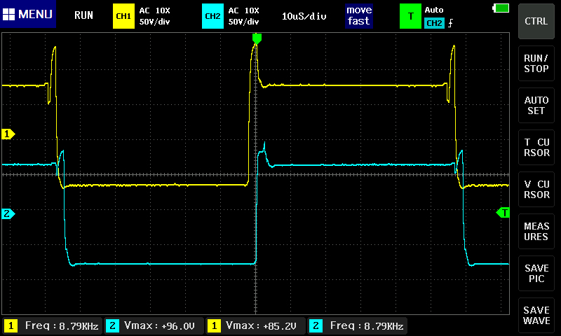

Gate inputs showed 50/50 waves but they have slopes on crests. Gate outputs 50/50 square waves and I also seem to have sq waves on phase outputs - no sine waves. Any ideas please? I'm struggling to know what to look for now.

Ok I think I've found the answer. Stripped down inverter and checked everything again - One IGBT was faulty... Now replaced
