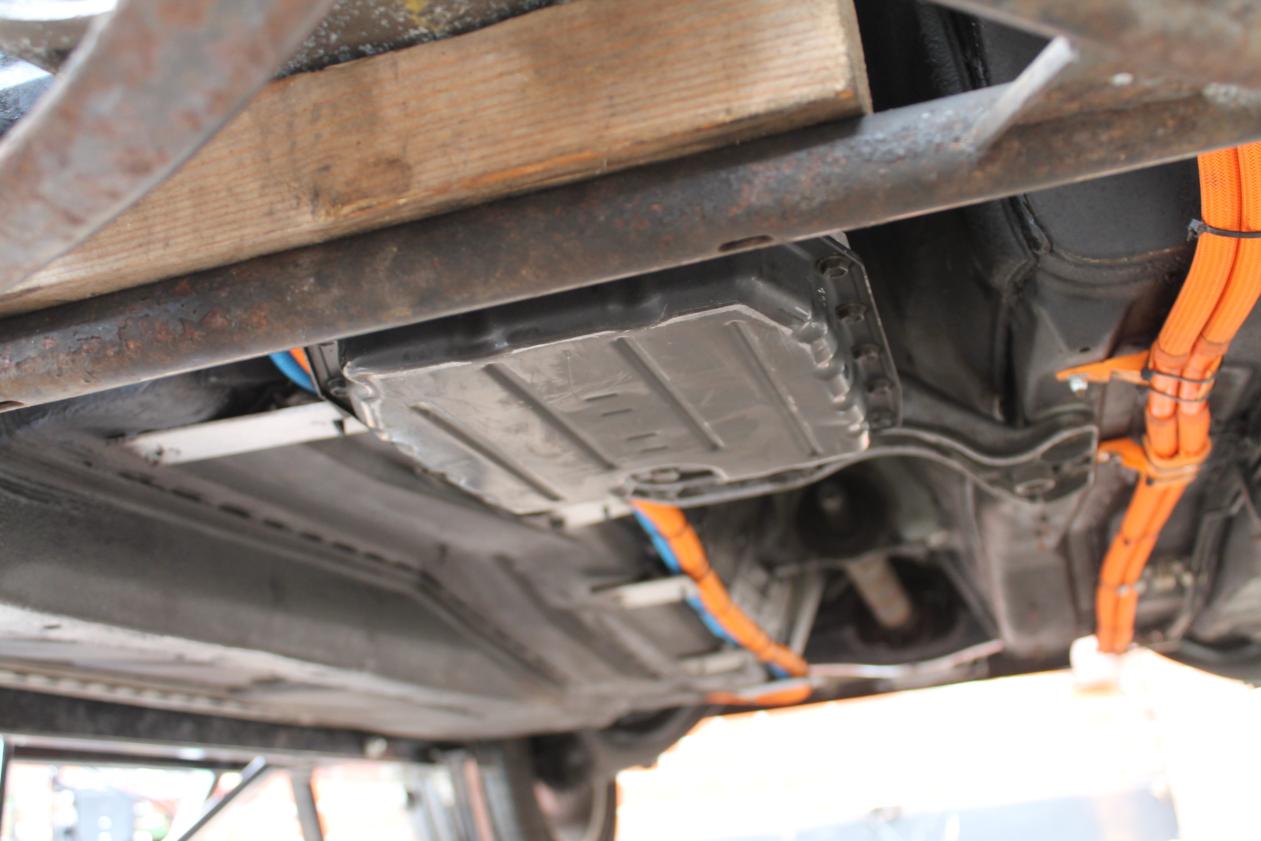

The motor mounts were made from steel box section with reinforcing tube welded in where the mounting bolts go through

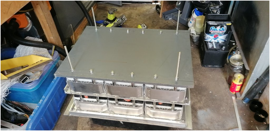

The front battery box sides are made from welded 3mm aluminium
And if I remember correctly the bottom and the middle cooling plate are 8mm ally all held together with studding and a top plastic plate that the contactors are mounted to the top cover I made from fibreglass
And here it is going into the car
It’s been through some evolution since this picture was taken it now has 2 BMW oem connectors one of which goes to the inverter the other goes to the rear battery pack that and I now have ten BMW 8s modules instead of the six 16s

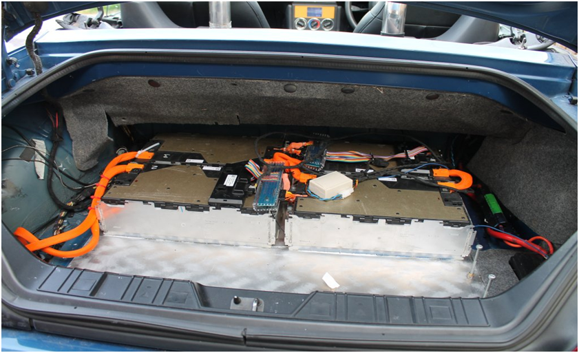

I made the rear pack cover from fibreglass the same as the front

I've now re trimmed the boot

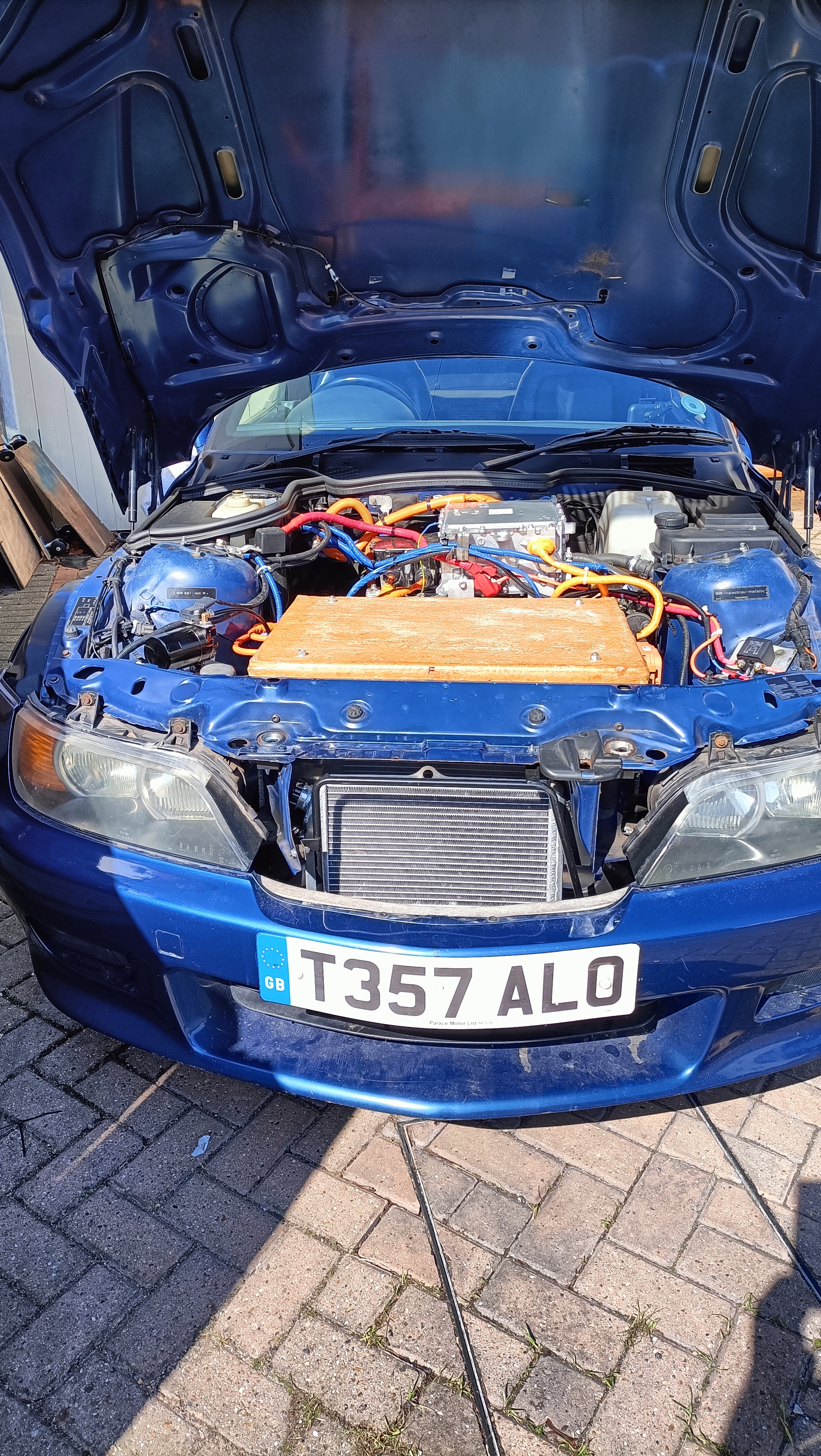

As per previous post I've also finished up the engine bay

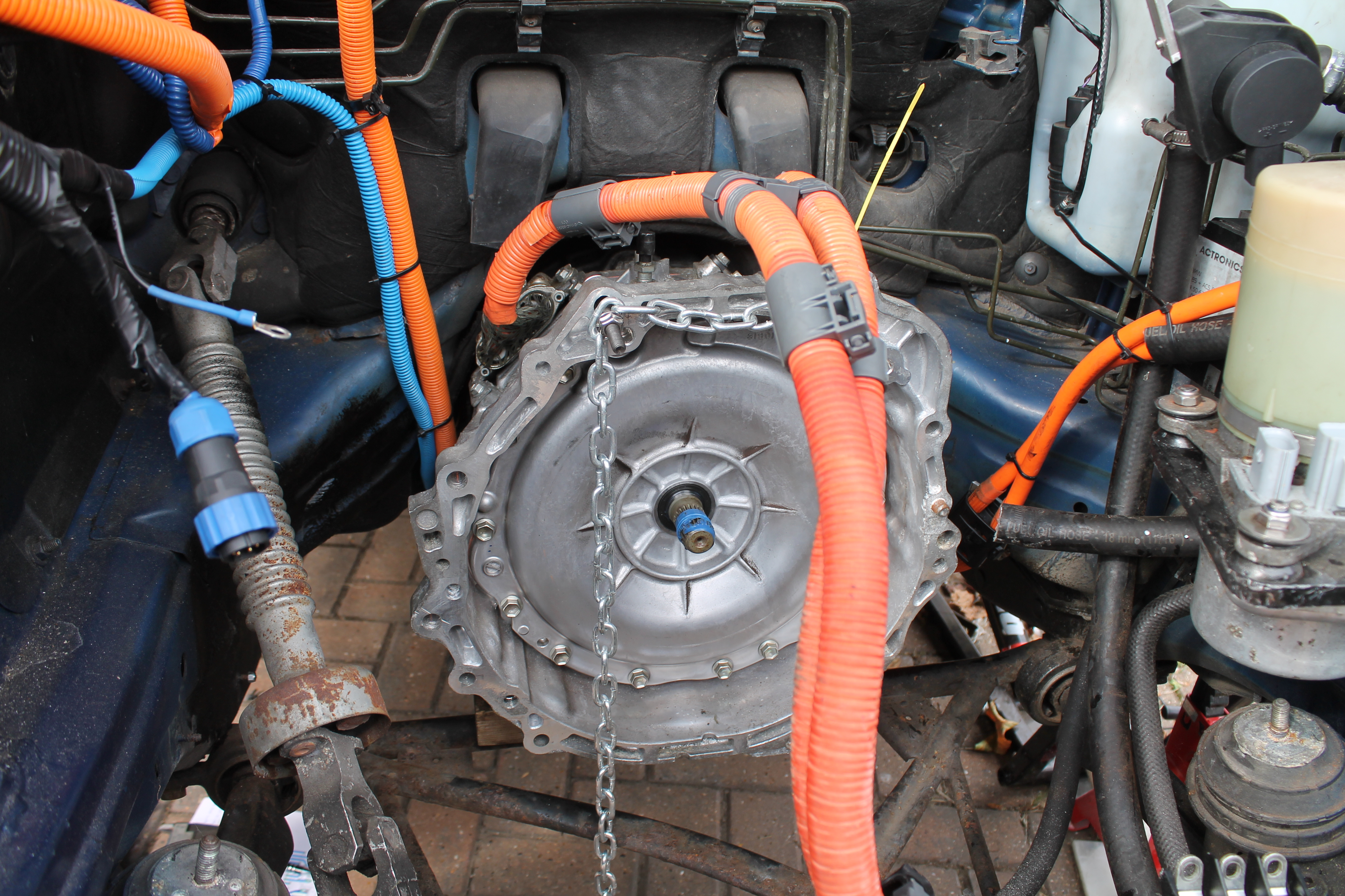

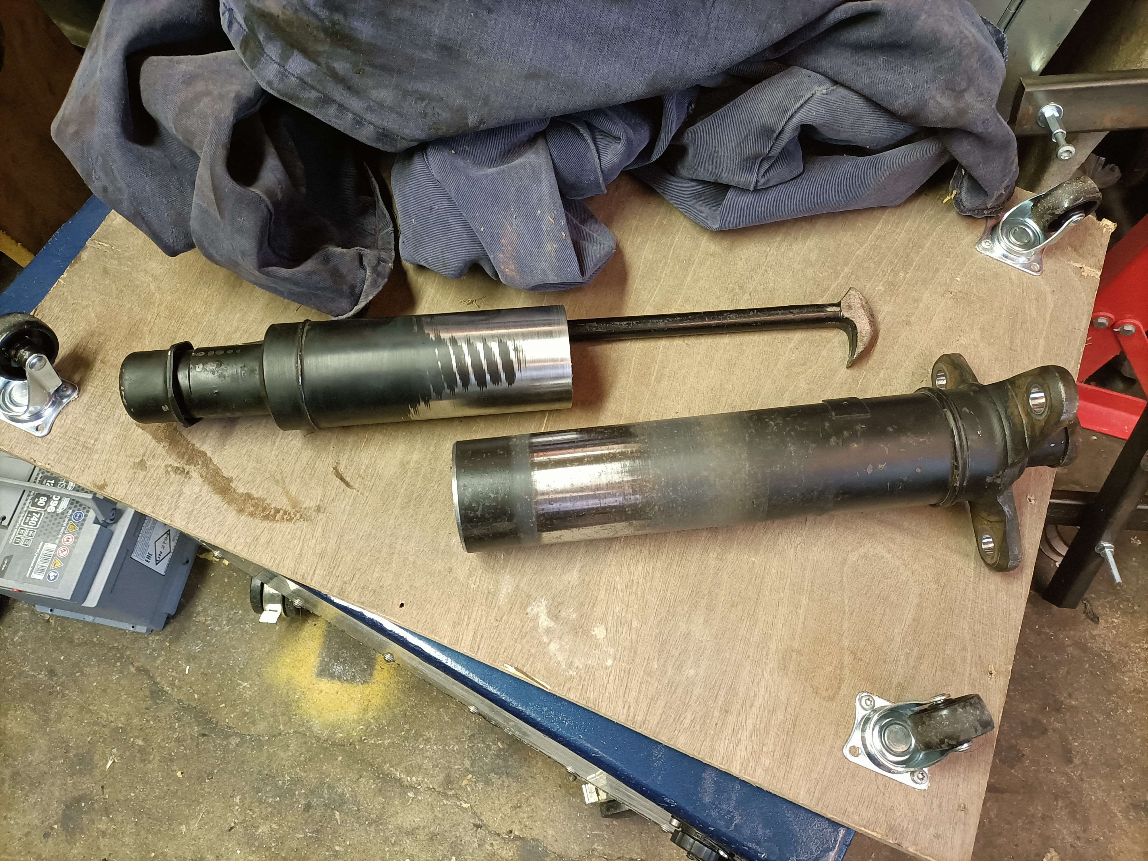

Things are moving along nicely the lexus propshaft arrived and it has been cut along with the Z3 one but not to exact length yet as I don't know what that is
I've made up an adapter plate to mount the lexus transmission to the Z3 gearbox mounting, I've made it in 6mm aluminium for now I might end up making it in steel though
I took the old gearbox out by hand it weighed about 40Kg the new one weighs about 90Kg so is not going back in the same way
and here it is like magic, it was nothing like magic to be honest it was a pain in the arse would have been quite straightforward if I wasn't doing it on my own
With the rear gearbox mounting bolted up I've got a calibrated lump of wood at the front and the gearbox output shaft and propshaft are lined up perfectly only took about 2 hours of sodding about
I've actually measured for the hybrid propshaft but I'm missing the flexible front coupling so can't do anything until I get one or at least get measurments for one
Re: [DRIVING] BMW Z3
Posted: Thu Sep 28, 2023 4:39 pm
by andybpowell
Got the hybrid Lexus/BMW prop welded up today and before anyone asks it was clamped in a jig I made to tack it together
And here it is fitted
I'm going to have to move some of the cables as there's not much clearance
not sure if this is just going to be for testing depends on vibration as it's not been balanced

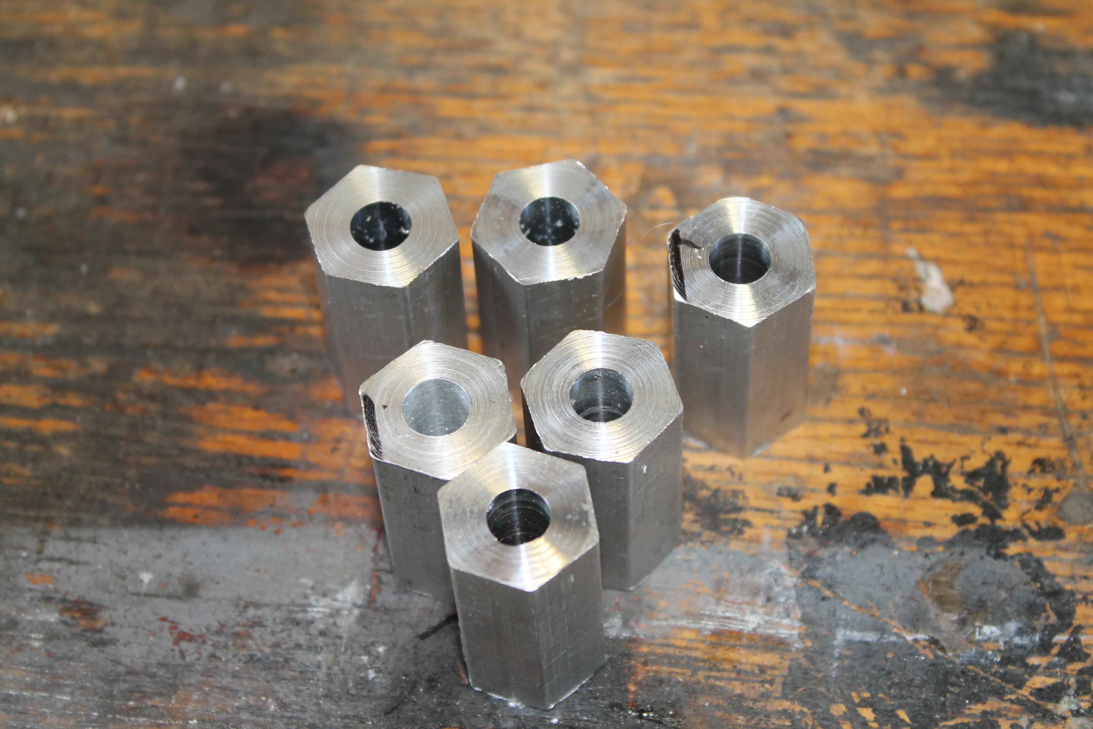

Made up spacers to hold the motor coupling to the front plate
most people seem to take it apart but I'm going to leave it intact and use the standard m8 fixing holes
