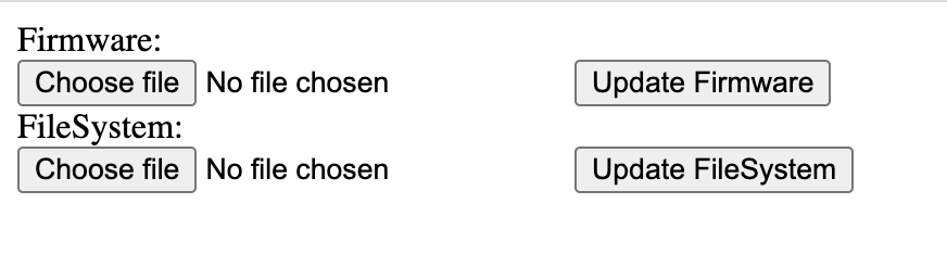

Hi all,
I have used Zero EV/Fellten SDUs in the past, and they suggested that I could use an open inverter board with their software.
Unfortunately, I tried and instead, corrupted the software on the Open Inverter board. Now, when I connect to the board's wifi, I get the two lines asking to upload software or firmware.
How do I get back to accessing all the parameters like i had when the board was delivered? Does anyone have a file and a method please?

Is it possible to do any of this over wifi? When IU log onto the IP address i see this...

Re: Broken Software! Is there a master file?
This means the file system is not flashed.
I think it is easiest to use a software called curl
See here: viewtopic.php?p=3893#p3893
Necessary files are here: https://github.com/jsphuebner/esp8266-w ... aster/data
And yes you can do it over wifi.
Do you have the version with soldered ESP32 module?
If so you can upload the attached file with the second Browse button (FileSystem)
I tried uploading that file and got the following error:
Update error: Bad Size Given
Does that give you any clues? Can I try something else?
Note to myself: only suggest what you've tried yourself
So no, some bug prevents uploading that bin file.
Maybe have someone do it for you? https://openinverter.org/wiki/Application_Support
I succeeded with platformio, so you'd need to install that on your Mac, then download this: https://github.com/Pete9008/esp32-web-i ... /tree/johu (Code -> Download Zip),
- extract zip
- open platformio..ini in an editor
- Remove line "upload_flags" and the 2 lines after and replace it by line "upload_port = 192.168.4.1"
- open a console in the directory where platformio.ini resides
- type "pio run --target uploadfs"
Well, to be honest this was harder than I thought.
Did a session with Kit and it took me one hour to get going at all. I ended up downloading python for windows. That only installed if you uncheck the "Admin" option"
Then I installed platformio via pip
Then I had to modify the line endings of platformio.ini to be windowsy and also changed the port to 192.168.4.1 like said above
And then ran
Then disabled the windows firewall and ran it again
Needless to say that every step took ages But in the end all was working
python -m pip install -U platformio
And then ran
