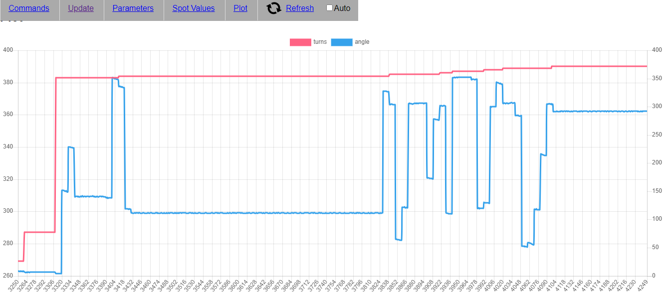

I raised the rear of the car and spun the wheels by hand in first gear. See image "manual turn". Feedback is rather choppy as expected but angle changes when the wheel is turned.

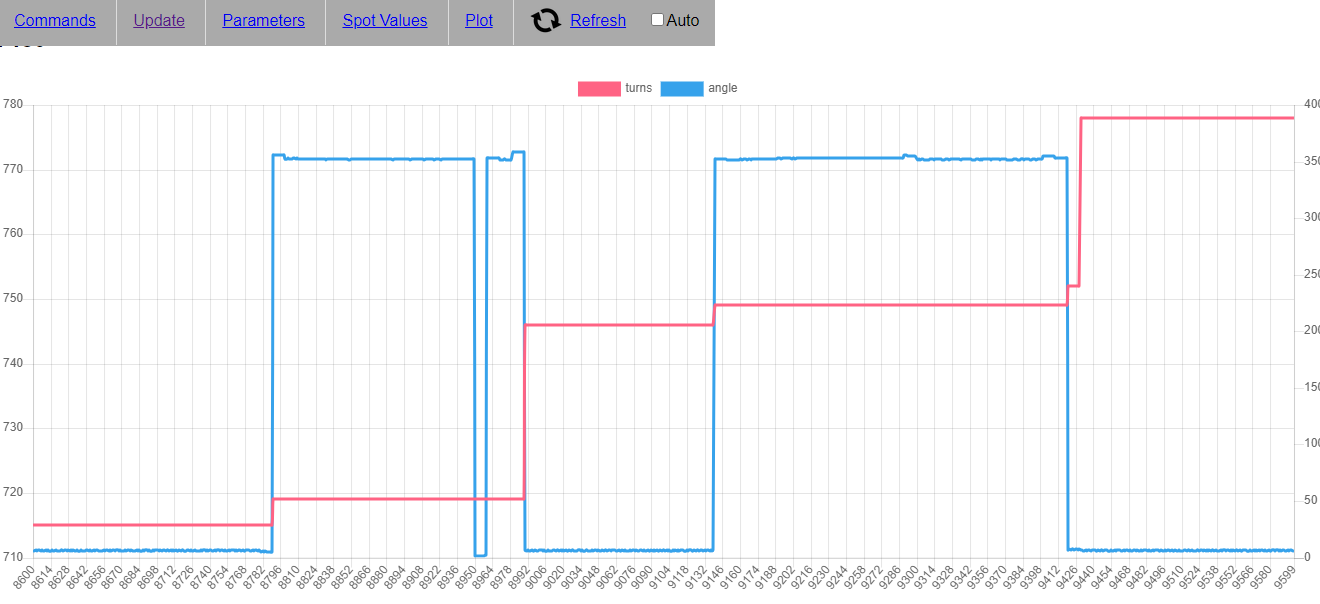

I tried giving some throttle in neutral. Just the slightest nudge in angle with every throttle input, then the output shaft bounces back again to the original angle. See image "acc press"

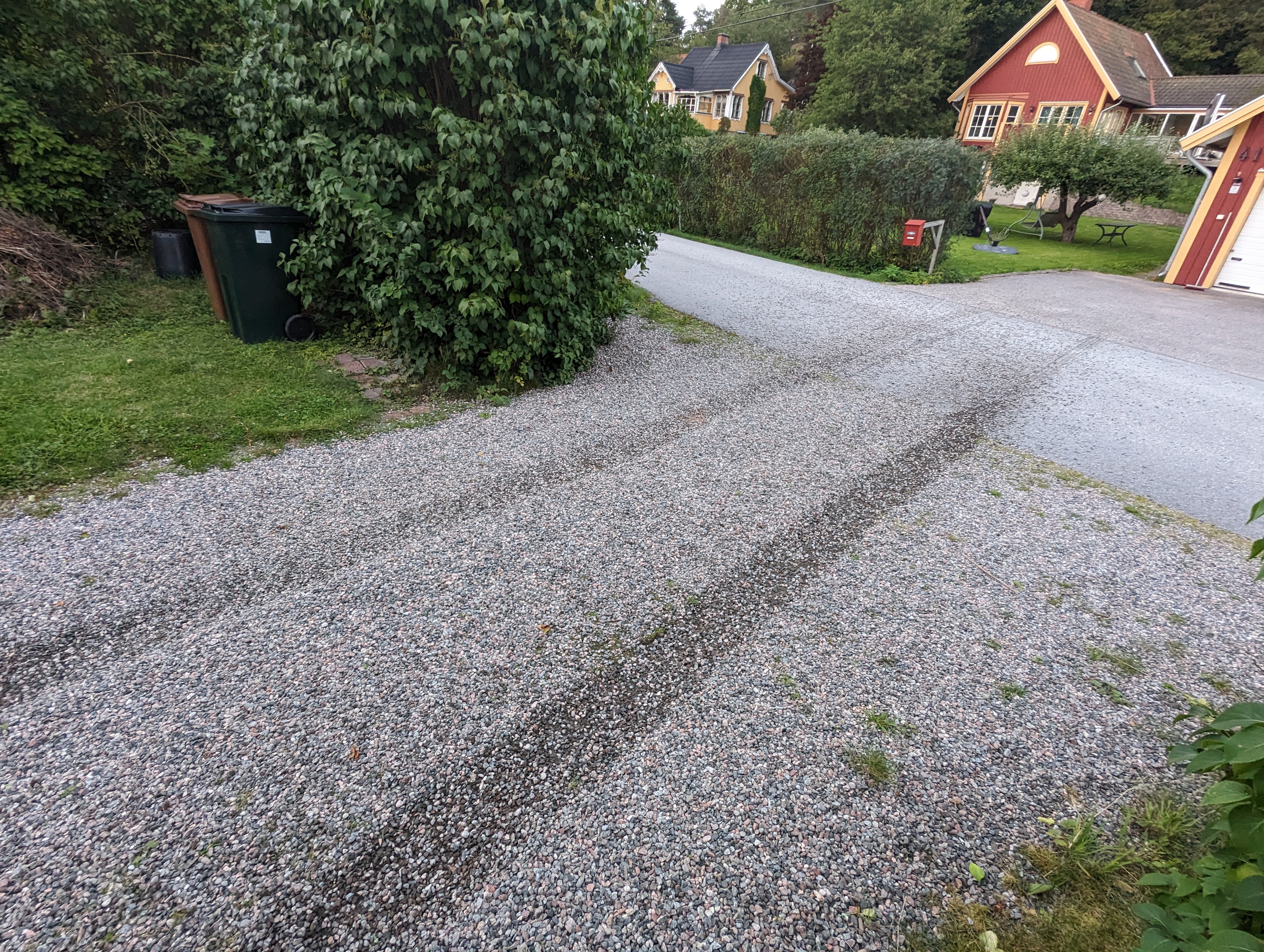

Pinswap solved it, see attached test burnout picture...
Thank you Johannes!
Thank you Johannes!
