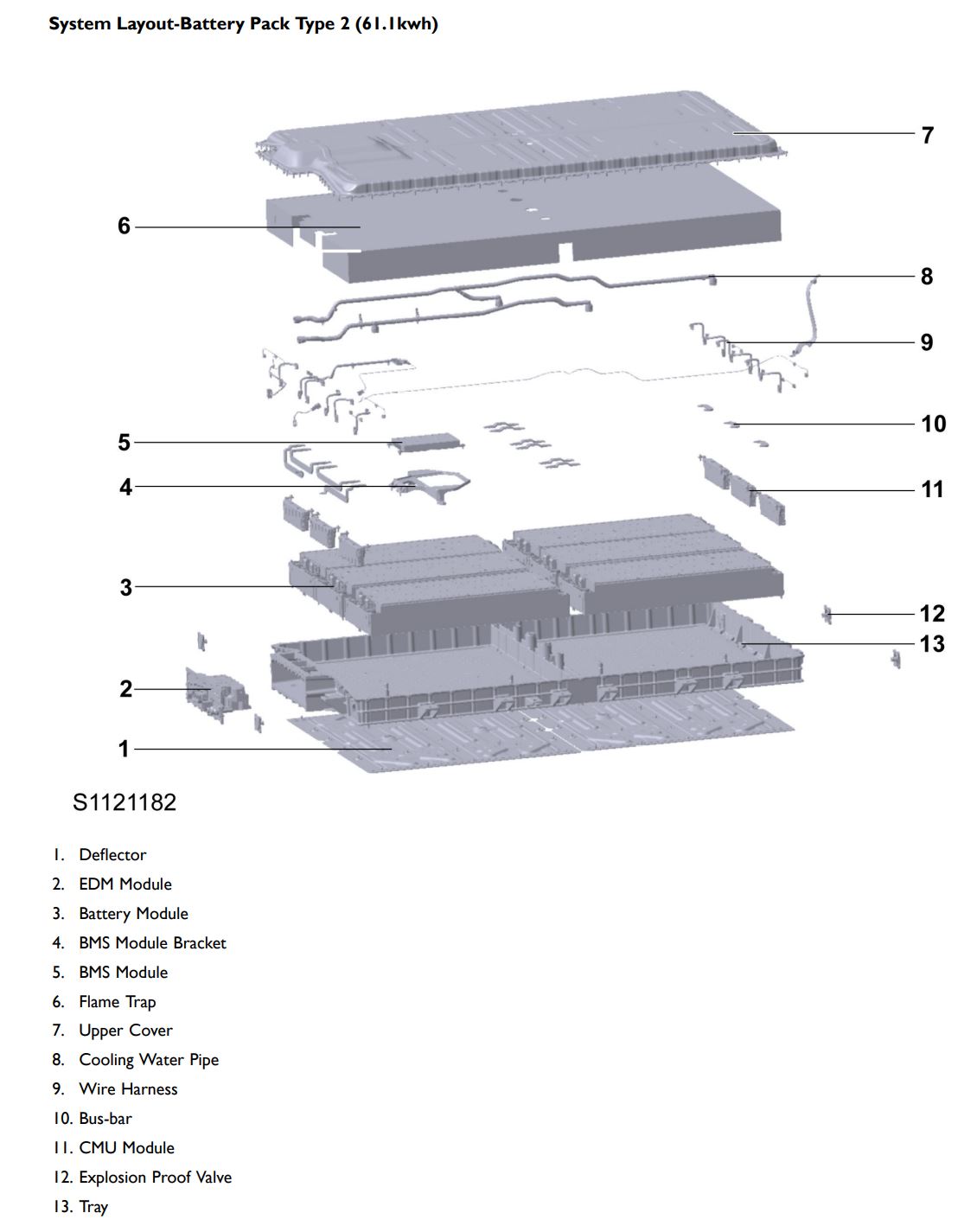

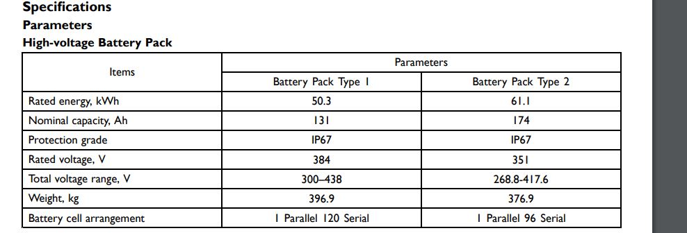

Hi, what do we know about the internals of these packs?Specs and configuration? Anybody has any details? 😊
Battery module (battery pack—61.1kWh): consists of 6
modules, and each module contains 16 battery cells;

tom91 wrote: Tue Aug 01, 2023 11:56 am Battery module (battery pack—61.1kWh): consists of 6
Thanks! Perhaps you have data for the other MG packs also?
