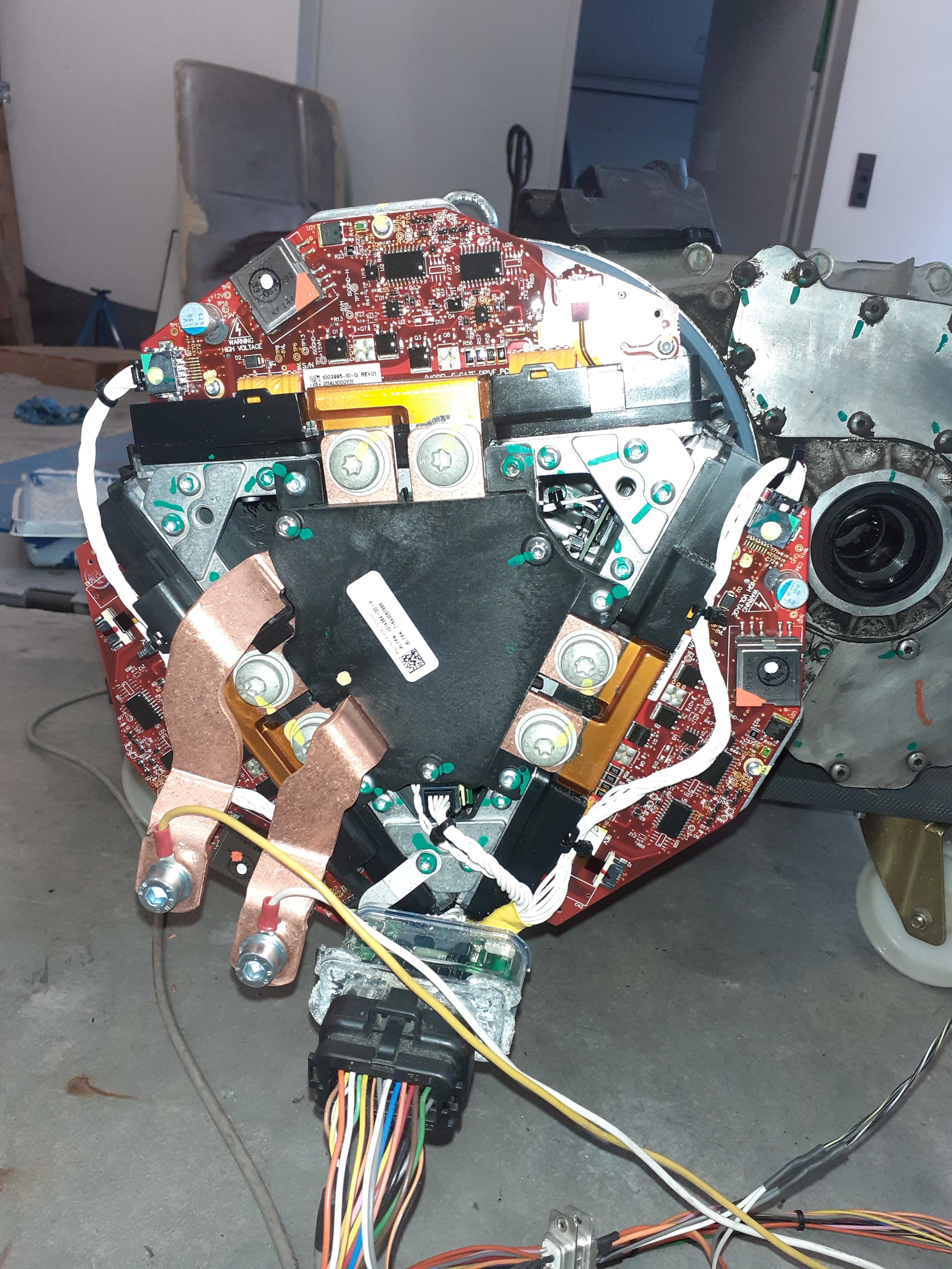

Yeah, I have new motor on a way. But as I have LSD swapped to the broken one, I was thinking if it would be easiest to just swap the inverter side completely? Anyone done that? I've been searching that from youtube for hours, but only video I saw was some youtuber loosening the bolts inside and then just mashing the inverter out as it didn't release and cutting the wires. I think what he missed was that the orange cover needs to be opened and undo the bolts there to free the phase bars.

Post by muehlpower »
Replacing the entire inverter is not a problem. There are two temperature sensors, the three lines to the stator and the temperature lines to the stator. Everything plugged or screwed. To access the screws for the heatsink you have to remove the busbars. You can reach the three screws for the stator cables after removing the small cover. You probably know about the LSD installation. You can see the location and number of heatsink screws in the third picture. You need an extension for the ratchet.

Post by mane2 »
Awesome! Thanks! Looks like straight-forward job and way easier than pulling the LSD out and putting it into another.

Post by mane2 »
Inverter/powerstage swapped and all good again. Thanks for help.
