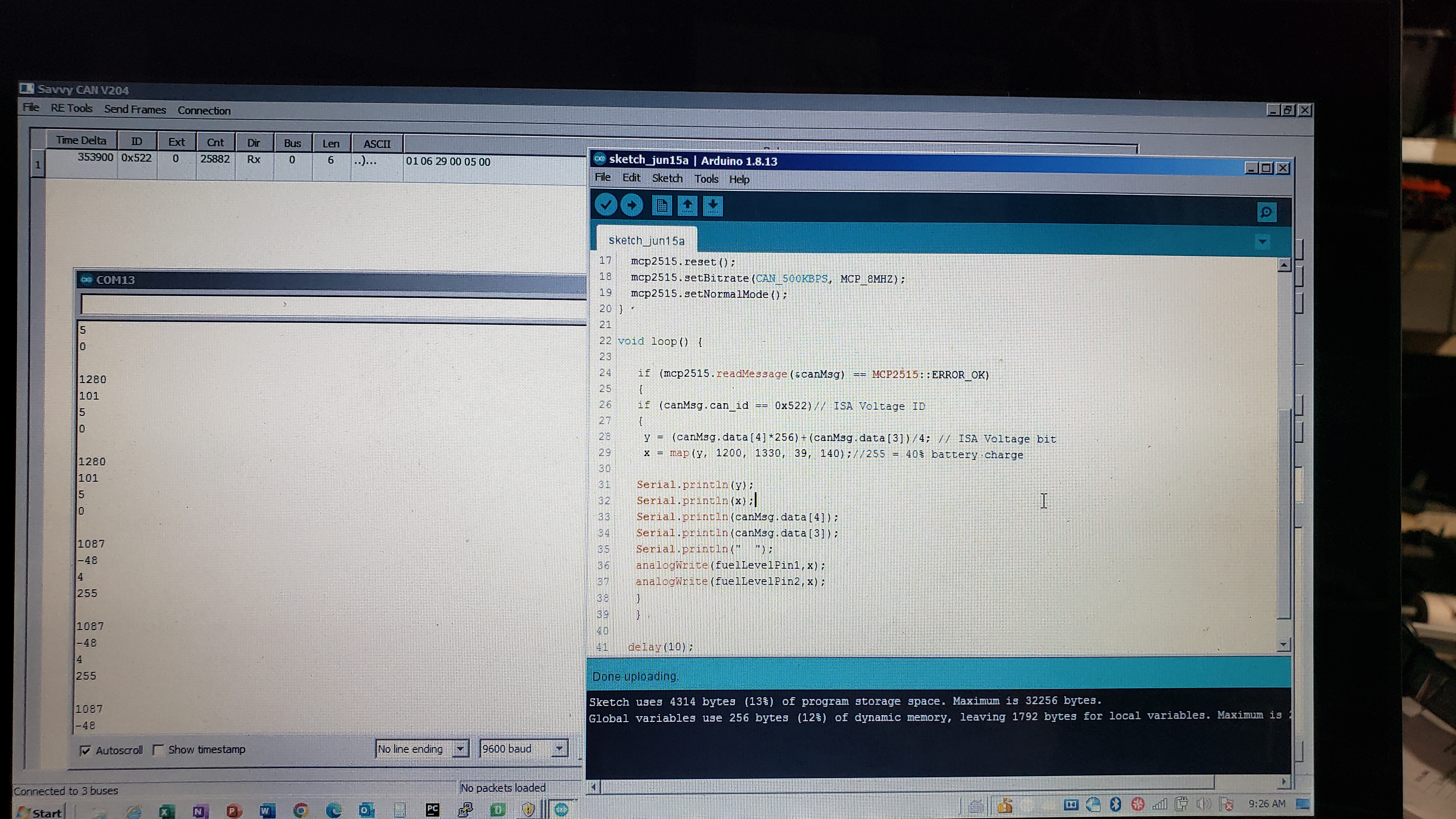

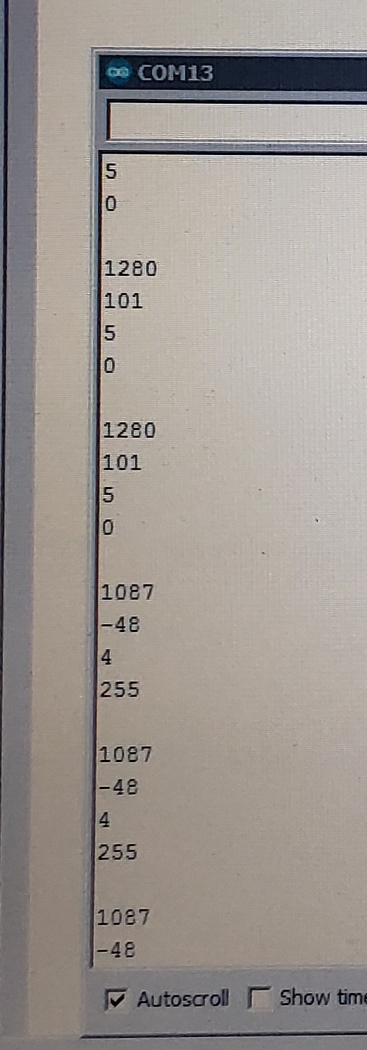

ok,
I tried y = (canMsg.data[4]*256)+(canMsg.data[3])/4; (5th byte isn't necessary) but I'm still have the same issue.
When Discharging, byte 3 rolls over from 00 (0) to FF (255) it changes the math equation results dramatically which then messes with analogWrite.
I did a quick video to illustrate what I'm trying say
Picture is the result in the Arduino Serial Monitor.
I'm i missing something?

Re: Arduino CanBus message question
It looks like the data is little endian so it's just going from 0x500 to 0x4FF, 1280 to 1279 dec, not sure where 1087 ( 0x43F ) came from. If you want 1200 to be the minmum you need if (x < 1200) x = 1200; as map will just produce a negative number. Without the /4 in your calculation 1200 is about 307V and 1330 340.5V, is this the range you are looking for? The voltage reading from the IVT-S is bytes 2 - 5, if you included byte 2 in the calculation the range to map would be the voltage in mV.
Pete9008
- Posts: 1801
- Has thanked: 102 times
- Been thanked: 351 times
Should it be this?
y = ((canMsg.data[4]*256) + canMsg.data[3])/4;
If canMsg.data is an unsigned char you may need the following cast too (the 256 should be an int anyway so probably not needed but good practise in any case) :
y = ((((unsigned int)canMsg.data[4])*256) + canMsg.data[3])/4;
As mentioned above you can lose the /4 and change the map input range to suit instead.
you must of course put the sum in parentheses so that everything together is divided by 4, and not just the one byte
