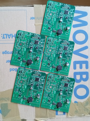

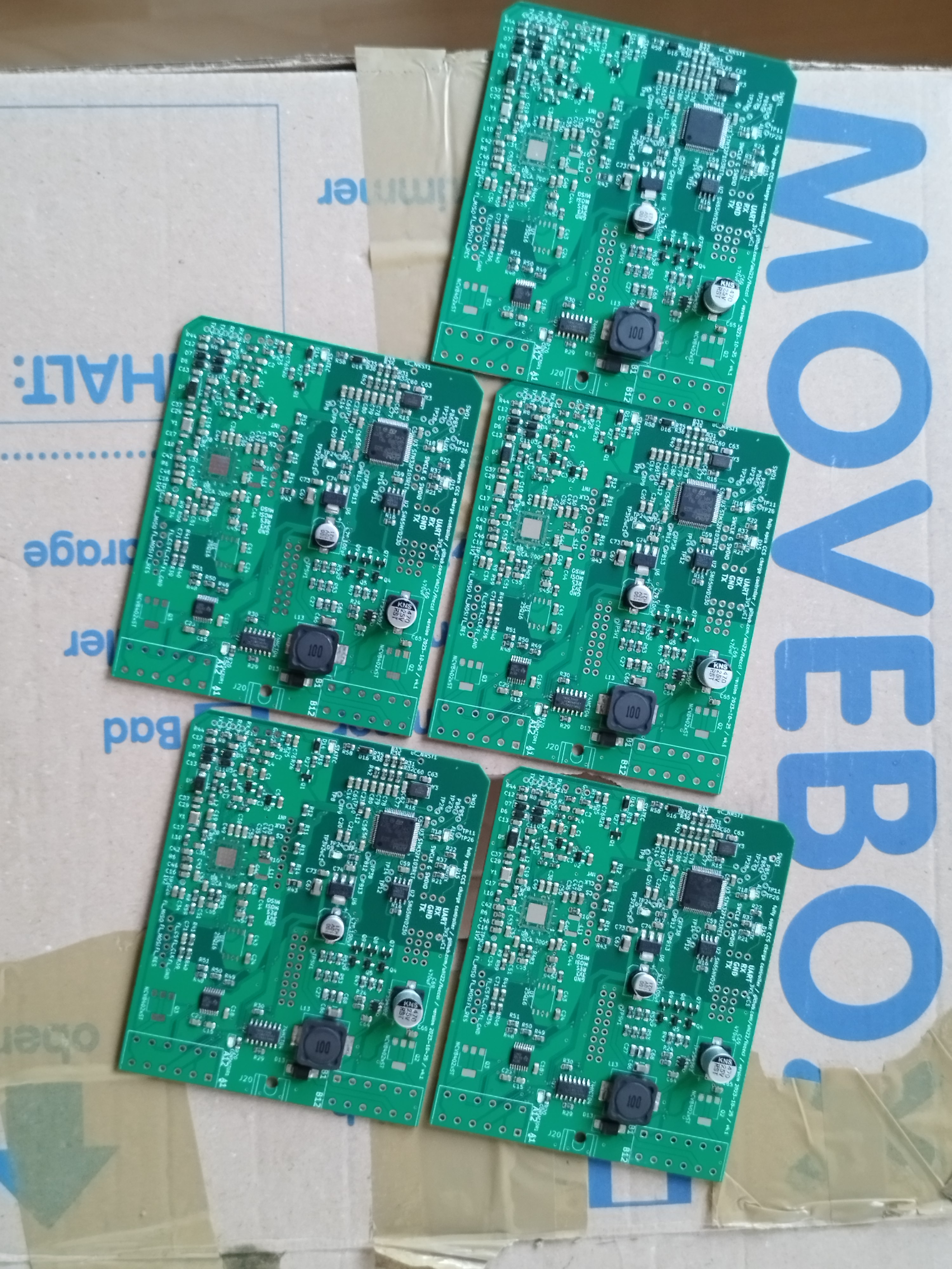

Just ordered five units from JLCPCB. The NCV8402 (contactor driver) is out of stock, so I need so see if I find some of them and populate it later.

Thanks, good to know for the next time. Got feedback, that for U1 and L11 the footprint does not match. Beginners fault. They will not populate, I will add by hand.

The populated boards arrived, but will need some time until all the equipment comes out of the moveboxes...

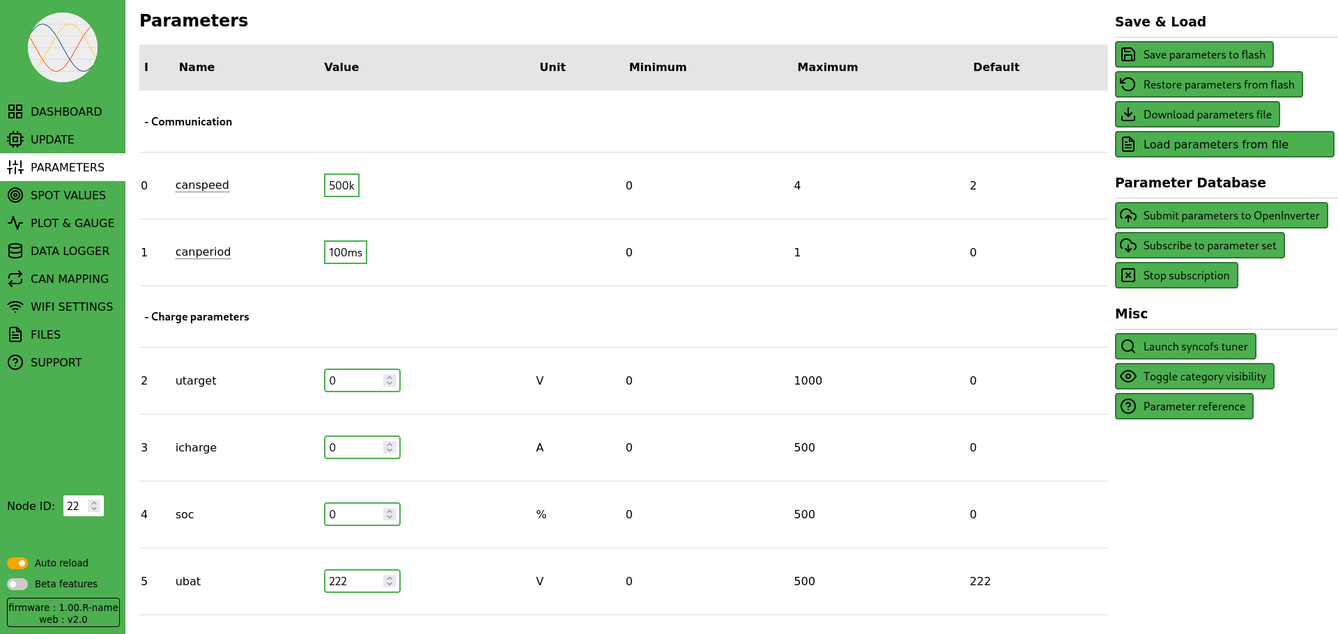

I have started to port your code over to libopeninv so that we have parameters, boot loader and so on
https://github.com/jsphuebner/ccs32clar ... liboi-port
(not yet linking)
(not yet linking)

I think it makes sense to use this version for further development. Do we have a beginners manual for this constellation? My questions would be:
- How do I setup the project, consisting of multiple git projects?
- Which build environment is used? Is the STM32 CubeIDE still compatible with this project? Or what are the other possibilities?
- Which options are possible to flash a new firmware? One is the SWDEBUG with STLINK, but how to flash via CAN?
- What tool is required to change parametrization?

- The project is generated from stm32-template which links in libopencm3 and libopeninv as submodules. Then I copied your files over
- It's a simple Makefile project. I think CubeIDE is essentially Eclipse. Haven't used it for a while but I think Eclipse can just call Makefiles as well. I use Code::Blocks
- You can flash and debug via SWD as before. Flashing via CAN currently works via python script that can be found here https://github.com/jsphuebner/stm32-CANBootloader/ or via an ESP32 module that talks CAN. You could also hook up an ESP8266 module to the serial port of foccci or a USB serial adapter and the uart-updater.py also found in the boot loader repo
- Parameters, CAN mapping etc. can be changed with Daves tool or also with the ESP32 gadget that will be for sale soon
EDIT: no hooking up to the serial port won't work as long as the debug trace is on there
