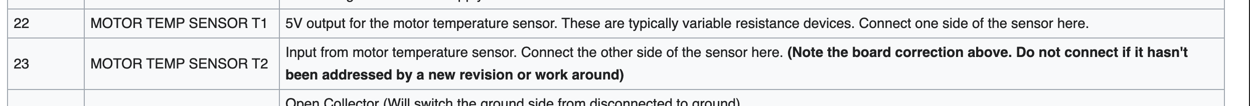

In this instance connecting the temp sensors from the phev rear motor to the inverter.
The motor has two sensors, the pairs of wires read 13.45 ohms and 13.28 ohms, so near enough to each other to be plausible.
I've wired pins 22 & 23 of the ampseal to my junction box to make them accessible. Under advice i wired a sensor groudn to ground and the other side of the sensor to one of the input. Tried both with and without a 1k pull-down from input to ground as advised. On the ampseal pin 29, 21,11 & 17 are all wired to a common ground.
My values reported via can agree with the web interface (so i don't think it's a can or decode issue), one is constant -40, the other fluctuates a little around 88.
Given i think the temp inputs to the ampseal are adc inputs, and i think the motor sensors are thermistors i expected a pullup somewhere but this is based on a limited understanding of how this should work.
Have i gone wrong here somewhere ?

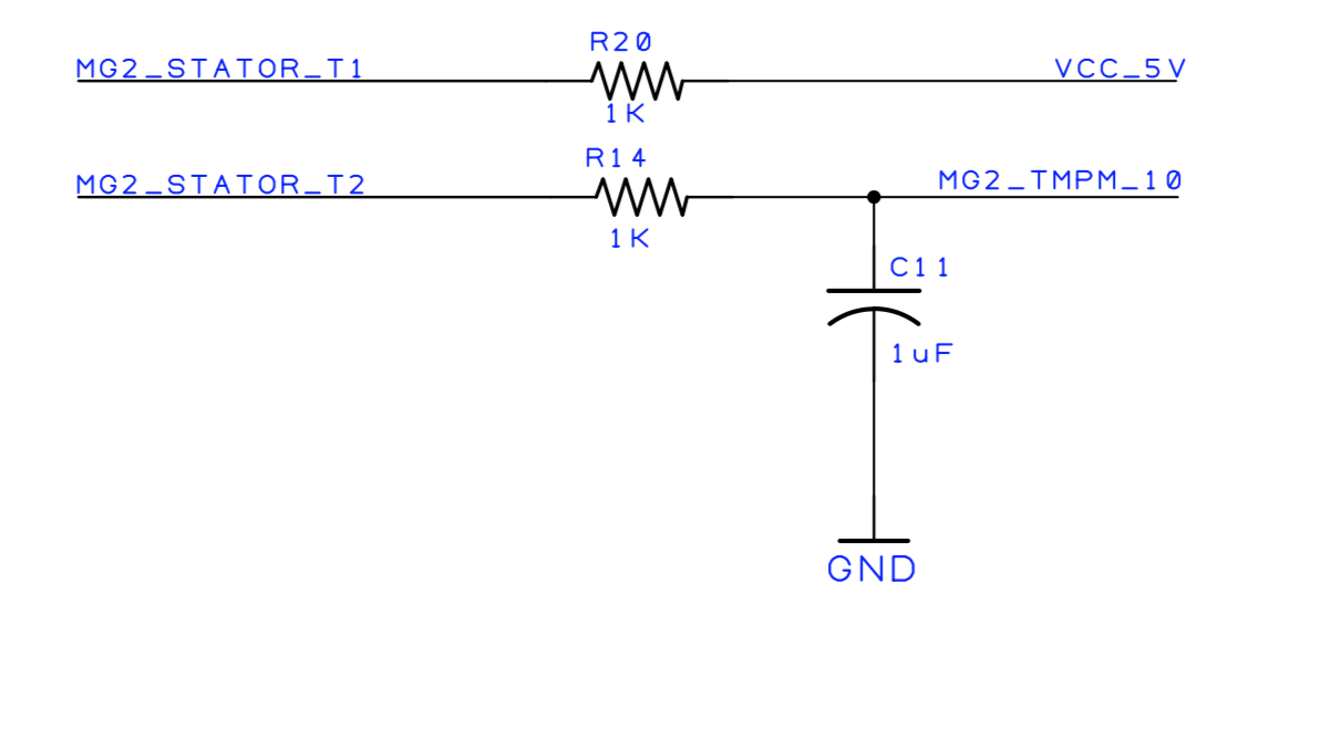

There's only one input, it's missing part of the resistor divider that gets the voltage right for the stm32. One side connects to the 5v output, the other to the input, with the resistor divider.
Give me a call if you need to.
So T1 to one side and T2 to the other, and T2 to gnd via the new resistor to form a voltage divider.
and is that pin 22 or pin 23 on the ampseal connector do you know. Is the other one NC ?
T1 to 5v out (ampseal 14), T2 to one of pin 22 or 23, and 1k resistor to ground.

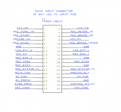

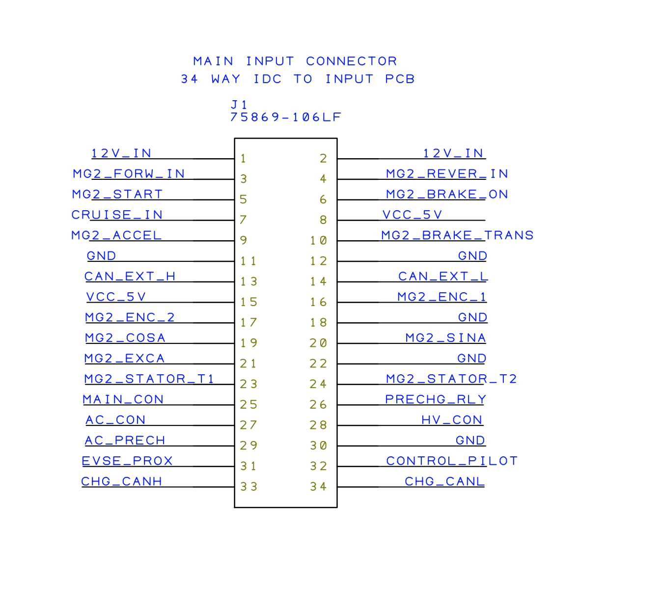

These are the ampseal pins

thank you - for some reason i had assumed there were two inputs. i think in my documentation i summarised the labelling and mis-lead myself.
this makes perfect sense thank you
