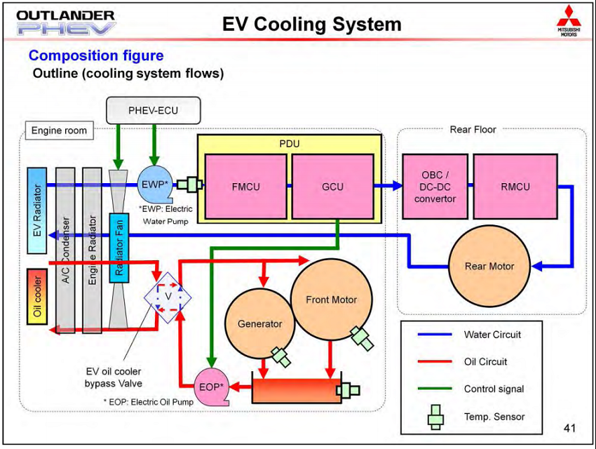

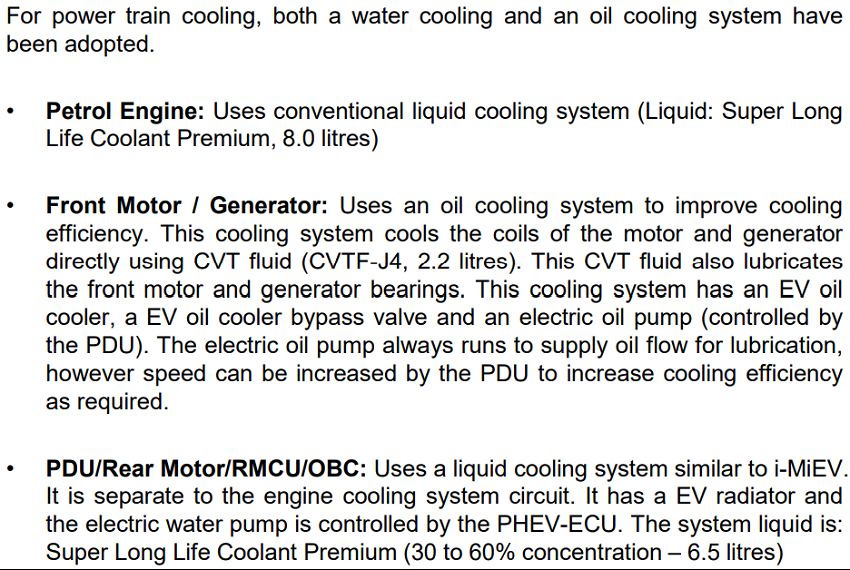

To my knowledge, the rear motor came from factory with water cooling, check the below pictures (although I'm unsure where did I get them from, someone can confirm..)
Edit: okay I found the information from this link, maybe you can find related other information:
https://www.myoutlanderphev.com/forum/v ... php?t=4255
Prius gen3 inverter
Outlander rear motor

that's a great help thanks.
So i can use water as i have a rear motor, but those using front motor should be running CVT fluid.
