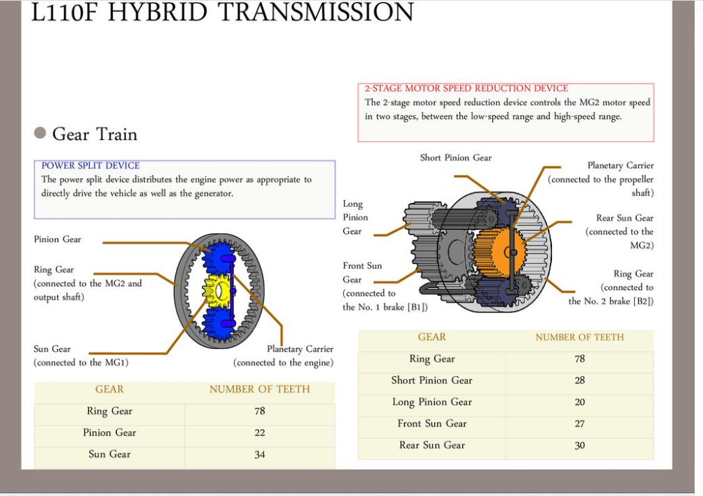

I just got a (running) GS450h. It is a very, very fast car. The book states 349hp, with the engine providing around 300. It is my understanding that all the engine power goes into MG1 -> 650V then MG2 takes some additional current from the battery to top up to around 250kW. So in theory the GS450h MG2 is good for 250kW and MG1 should be good for 200kW so running both together could make 450kW ? However having driven the car around, anything above 100kW is more than enough for a public road. I would expect with MG1 and MG2 running together at max current at 350v to generate around 225kW, so allowing for driveline losses the rear wheels would see around 190kW or 255BHP. So pretty close on the Dyno.
- rstevens81
- Posts: 353
- Location: Bristol, UK
- Has thanked: 23 times
- Been thanked: 92 times
Re: Damien takes Zombie GS450h on dyno
It's actually the 600h gearbox ornl did the test on but it's the same except the transfer box...here it is anyway
https://www.google.com/url?sa=t&source= ... p_aA1ec3sC
Not quite.hazelnut wrote: ↑Fri Mar 03, 2023 9:04 am I just got a (running) GS450h. It is a very, very fast car. The book states 349hp, with the engine providing around 300. It is my understanding that all the engine power goes into MG1 -> 650V then MG2 takes some additional current from the battery to top up to around 250kW. So in theory the GS450h MG2 is good for 250kW and MG1 should be good for 200kW so running both together could make 450kW ? However having driven the car around, anything above 100kW is more than enough for a public road. I would expect with MG1 and MG2 running together at max current at 350v to generate around 225kW, so allowing for driveline losses the rear wheels would see around 190kW or 255BHP. So pretty close on the Dyno.
In normal operation, engine power comes into MG1/Power split device. MG1 applies a braking force to the PSD by acting like a generator. In this situation, some of the power is transferred mechanically by the PSD, and some is absorbed via MG1 thru the inverter and fed back to MG2.
I dont know the proportions.

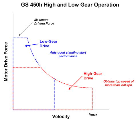

I guess its one of those tests that for me actually opens up more questions...
The current limit on Damiens car is 500A from memory. 500A and 350v is thereabouts 175kw or 235hp.
So that matches up fairly well with what he measures.
The time it takes to get to peak power would be a concern for me. A factory LEAF for instance is at full power by about 30mph, a Tesla is at full power by about 40mph. The plot suggests its not hitting the ~200hp figure here until about 70mph.
It would appear to be sitting against a torque limit from the start of the pull to when it hits the peak. We can see it makes 220hp at 123kph and 110hp at 62kph, exactly half, suggesting exactly the same torque value. Can we request more torque from it?
I guess my question is, what exactly is the limiting factor here? Can we turn up the current limit? Can we request more torque earlier in the RPM range and hit that current limit earlier? Are we limited by the actual motors? Or the Lexus inverter firmware? or the batteries?
If you have one of these boxes and want say 250kw from it, what exactly needs to be done to achieve that?

The 500a is limited by the Toyota inverter firmware, it's true Damian could get full power at lower mph, however he has a diesel diff back from when he had a big DC motor, diff swaps are not easy as different fittings are are different diffs on BMws (Damian learnt that the hard way) with the torque that the motor produces it more than most would ever need and first gear produced so much torque it spun wheels on the Dyno!

Yeah I'm sure it's plenty power for a passenger car. Anyone know the diff ratio used so we can correlate the recorded speed with motor rpm?
Ive been contemplating one for a more utility application. Pickup or SUV used for towing etc. Current vehicle has a 220hp v8 and it really struggles when pulling a trailer. Ofcourse some of that is down to the fact that the engine isn't making 220hp at normal driving rpms, but that's why it's also a concern that this isn't making the power until high speeds either.
The gear switching is a fair point though. Being able to drop into low range would help significantly.

This is pretty much what you can expect from any electric drivetrain. They produce constant torque from a standstill up until they run out of voltage (in this case at 123kph). I'm sure Damien was running his at 100% torque during the test.
My subjective experience is that when it comes down to it, nobody has felt it necessary to use the low ratio of the GS450H. Most people are running light passenger cars and actually want a higher ratio because they have mountains of torque but quickly exceed the RPM limit. Of course your case with a truck will be a bit different.
I personally find horsepower to be a really useless measure. The fact that a GS450H is making zero horsepower when it launches the car doesn't seem to impact its ability to do so rather rapidly. In my experience, the best way to compare an electric motor to a petrol engine is this:
1) Work out which gear is roughly equivalent, ie which gear redlines the engine at around 75mph
2) Feel the *peak* acceleration you can achieve in that gear (ie near the redline)
That is that your acceleration will be like at all times with the electric motor.

In a production EV, say a LEAF, by ~30mph your sitting at the power limit and its producing 110hp continuously, which is great. It makes the car much quicker than a 110hp ICE would be, because its producing 110hp non-stop, rather than the ICE which is only producing 110hp at the top of each gear, and dropping away from that with every shift.
However looking at the curve here, we're not producing 220hp continuously. Its much more like an ICE would be, because it takes until 70mph to actually reach 220hp. Basically it entire normal/legal operating window its making less than 220hp. The missing piece of course is gearing and motor RPM. If we can gear it down and get to peak power earlier that would ofcourse help things significantly. Or, i guess, run more voltage, as if the limiting factor is the inverter current limiting to 500A, then more voltage should raise the whole curve. That creates its own issues though, as many of the anciliary components arent that happy running over the typical 96s range.

I'd agree with catphish here. Power is best for bragging rights but torque is what makes a car feel responsive/quick. The trouble is that on ICE engines it is always engine torque quoted while it's wheel torque that matters. It's difficult to compare engine torque because of gears so power is always used despite it being less useful in many ways.
For a road car my ideal would be for the transition into the constant power region to occur at the max legal speed to keep the car feeling as responsive as possible in normal use, i.e. always run in the constant/max torque region. My concern is that when you enter constant power it's going to start to feel like an ICE engine that has revved past peak torque and you will constantly feel the need to change gear but can't.
If you want to have more power available at lower speed put the L110 in low gear, it will make more torque at the wheels then too

The speed at which you reach max power can be changed by your gearing/tyres.
Electric motors indeed have a torque limit usually imposed by the current rating of the inverter.
