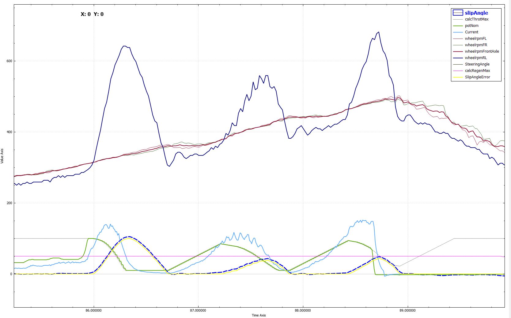

I have designed a traction control module that is able to take my wheel speeds & calculate a slip angle. I'm planning to pull back motor current proportionally on increasing slip via CANbus(and maybe with a PID loop in future)
Had a quick search, but couldn't see a huge amount. Has anyone thought about the best parameter to limit?
Thoughts:
  • Must be capable of pulling back (and re-adding) current instantly without being subject to any ramps
  • Sampling frequency is 100Hz, can a parameter be updated this quickly?
  • Ideally parameter to vary won't affect any other 'live' tune
  • Setting an incorrect value should not do anything worse than if the module was not present (ie: full power)
  • Should not override BMS limits
The parameter that seems most suited is throtmax, I can just set a value less than 100% all the way back to 0. However it's not clear how a changing value would interact with the throtramp smoothing?
Alternatively I guess iacmax, boost, bmslimhigh are options
Anyone else have any thoughts - or even tried an implementation of this?

Struggling to get the throtmin parameter to map... for throtmax I have:
  • can rx throtmax 1794 48 8 32 (which works fine)
For throtmin (negative numbers)
  • I have tried all sorts but think it should be: can rx throtmin 1794 56 8 32
  • I can get it to set 0 on 0x00, but no other values work (ie: 0xCE (-50) nor 0x32 (+50)
  • I've tried scaling as 1, running it across two bytes, including clearing throtmax so only one param is mapped can rx throtmin 1794 48 16 32 but no dice.
  • If I set it to transmit instead - the values come out of the inverter exactly as I'm playing them in when in RX mode
I'm missing something stupid, any ideas?

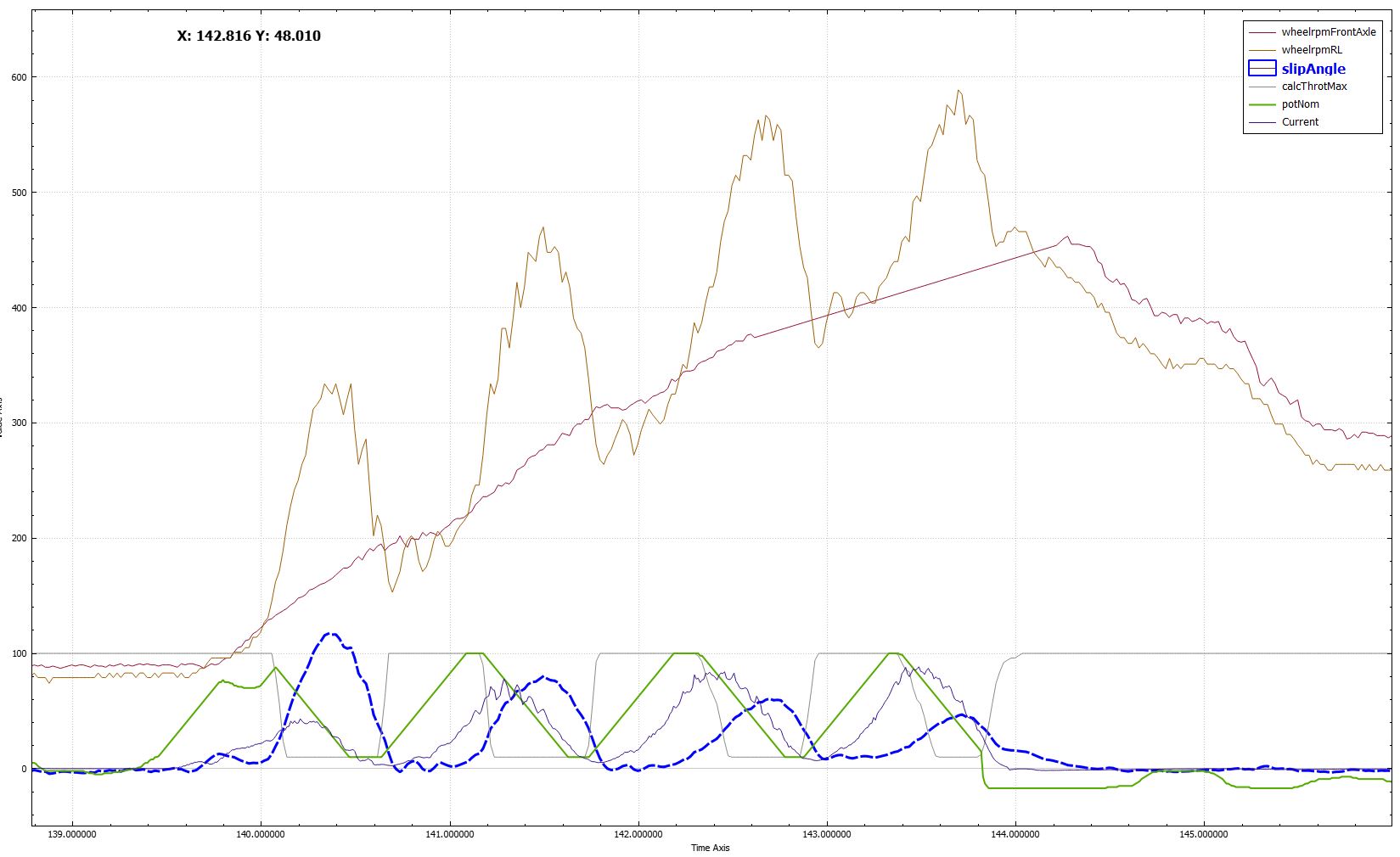

Ran a few tests today with 2%/10ms throtramp. It's "working" but unable to keep up and ends up oscillating. Seems throtramp also applies for coming off throttle, I had assumed it was only for application, but clearly see its falling at 2%/10ms also. I'm going to have to raise that value a lot to be able to catch the slip which will make the throttle pretty jerky...

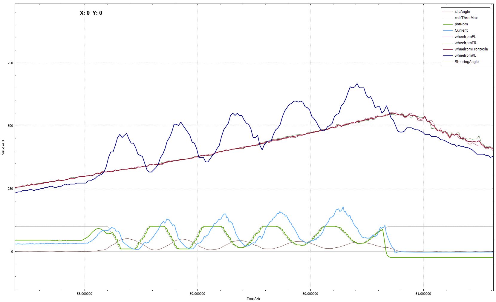

2%/10ms is IMO a very slow throttle ramp. I run mine at 50%/10ms so you can definitely go a decent way up. The throttle is only as jerky as your foot :)
Personally I prefer the "instant" throttle response.

40%/10ms - fair bit better but still not fast enough. Throttle/potnom is cut within about 40-50ms of the slip starting, but motor current takes a further 50ms to decay - can reduce the ramp up to 100%/10ms but then I'm dealing with some internal openinverter ramping I guess...

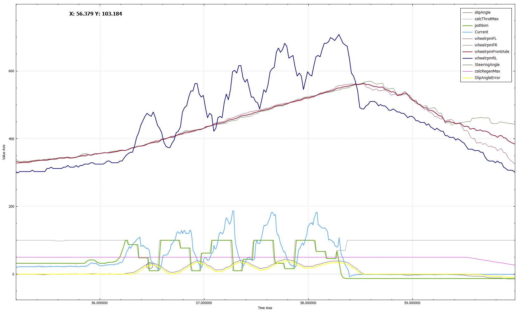

Another slight improvement. 50%/10ms and throtfilter 3. I reckon I can shave off even more time by either dropping the target slip (so it drops throtmax quicker) and increasing the proportional response (or moving to a basic PID controller that can see the trend of increasing slip earlier) and reducing the slip angle averaging a little.
Assuming a 20% slip target, it would appear I have around 100ms from the start of slip being apparent in the sensors and slip exceeding 20%. This is a very light car with very low rotating mass in the driven axle, so maybe a harder challenge than most.

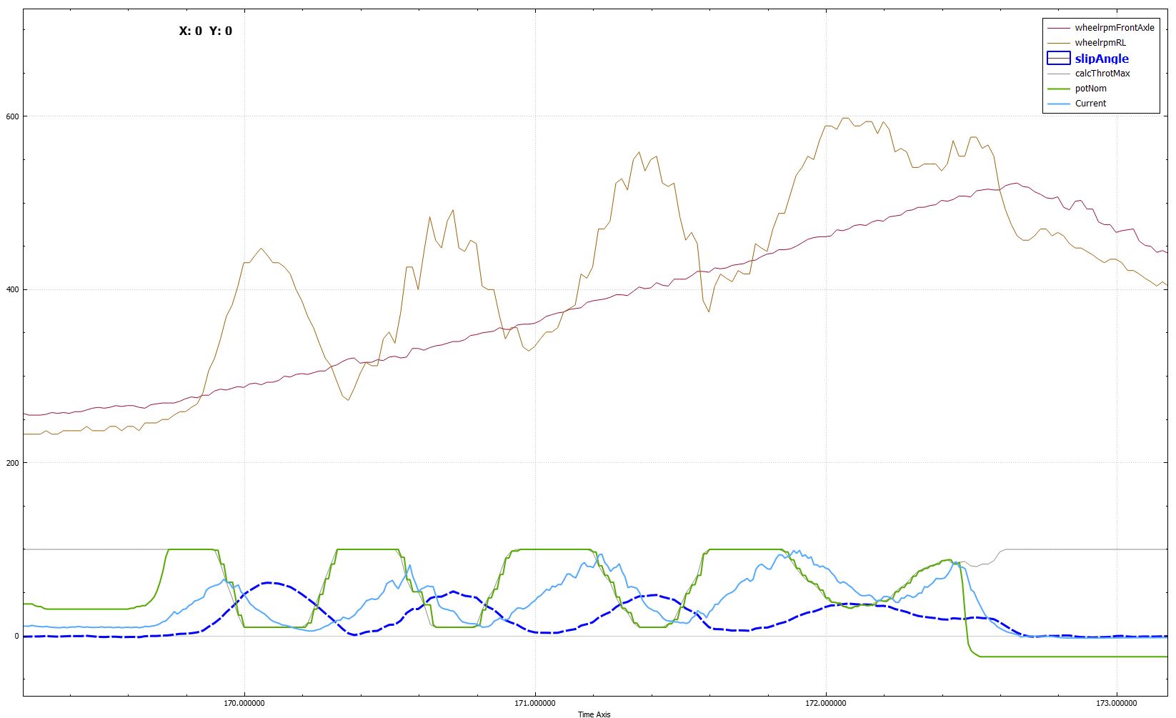

If I might make a suggestion: assuming you're doing a simple proportional feedback ie:
throtmax = 100 - slip;
Try an integral-only approach, like this:
if(slip > 20) throtmax--;
else throtmax++;
The benefit of this is that while it will respond slower, it will reach an equilibrium. The reason for the oscillation is likely because throtmax is reduced too much, slopping the slip entirely, but as soon as the slip is gone, throamax is returned to 100%, and the slip returns. By using an integral, the reduction in throtmax will be maintained at the correct value to keep the slip at 20%. This is how I do current control anyway.

Exactly, currently it's 3* slipError (deviation from desired slip)
I was just focused on the first slip ie: getting a control loop fast enough to catch the initial slip - but was certainly expecting getting my approach to reach steady state would need lots of tuning. Will give integral-only approach a go. Would love to see a graph if you've done any data logging...
A few questions come to mind:
  • Do you correct at a flat rate per cycle, linearly against error size or even apply some exponent?
  • Do you pull / return throttle at the same rate?
  • Do you have hysteresis or just set a target well outside of "straight and steady" slipAngle noise?
EDIT: Put together a new approach based on your suggestion. Removes throttle % at a rate of (slipError * scaler) every cycle and re-adds it at a constant rate. Trying slipError*0.2 for cut and 4%/10ms for recover. If that was used in the latest log, that should have removed about 30% throttle by the time slip is highest and motor current is responding. Hopefully a good starting ballpark....
