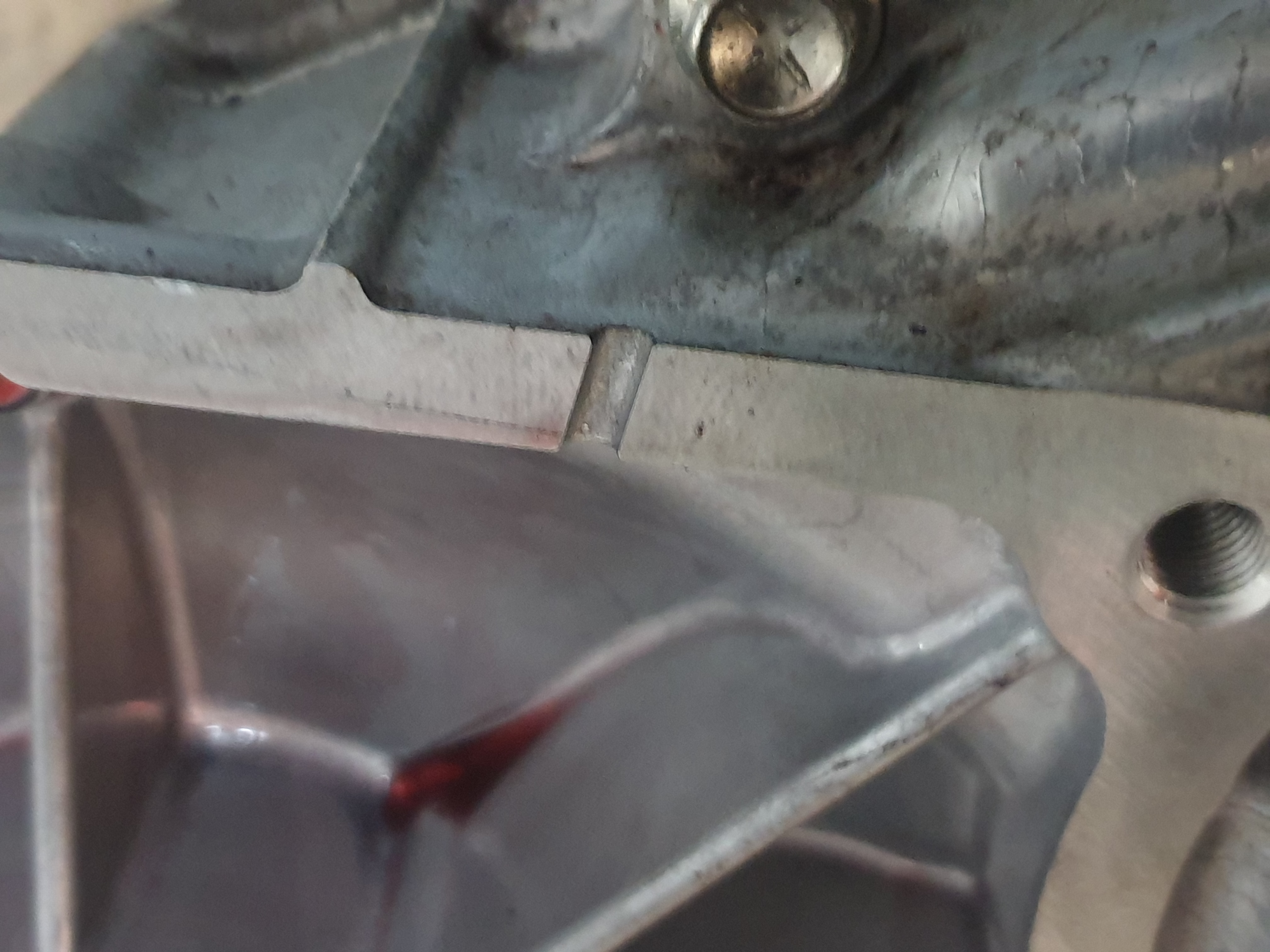

Can you guys that already installed Outlander rear motor help me with something?
There is a problem i noticed with motor and gearbox leaking oil. There is a small breech in motor-gearbox seal in position downward when motor is in its OEM position. It seems this was done intentionaly. It could be this port is a simple breather. I could be tumbling the motor in incorrect orientation when handling and some oil went into space between motor and gearbox. Is anyone out there can confirm for me that using the motor in original position doesnt cause an oil leak?
Original motor orientation:
Some photos of the breather???

Correct, this is gearbox venting.

tom91 wrote: Sat Sep 30, 2023 8:54 pm Correct, this is gearbox venting.
Yes but that thing is facing downwards. I would imagine venting would be oriented to the side or upwards.
Does anyone finds any oil leaking out from the gearbox in the orientation that is in OEM? Or is this just because i had the motor upside down for a long time :)?

It is up and down, on the gearbox inner its up and the outside case is down. so moving the motor about can cause oil get in the cavity and then move it again and it can then leak out.

tom91 wrote: Sat Sep 30, 2023 10:22 pm It is up and down, on the gearbox inner its up and the outside case is down. so moving the motor about can cause oil get in the cavity and then move it again and it can then leak out.
So it is not a true leak? I wil try to get the motor in position tomorrow and see how i will install it. I will report more...

I have the motor mounted in the OEM position ( all be it running reversed ) and have had no leaks in just shy of 2000 miles.
