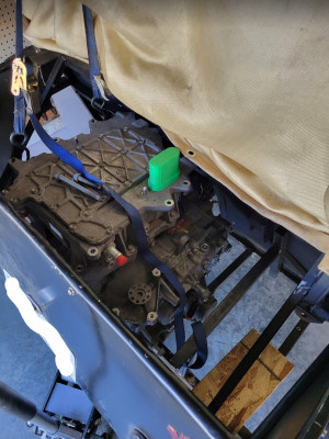

Okay, frame welding finished and motor is in! I don't have all the spacers ready but I did toss part of the suspension together on one side just as a test. So far so good.
Uh, this is the correct orientation, right? Seemed like it from the diagram, but the fact that JP1 on the mainboard goes to J2 on the adapter and vice versa gave me pause.

Re: [WIP] Homebuilt Locost 7 - from Motorcycle engine to Leaf power!
It's correct. Silly naming, will change it on the next run

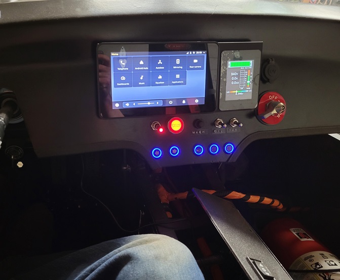

And I figured what the hell, adding a rasyberry pi to the dash with Android Auto and a browser for OI. Still working on that.

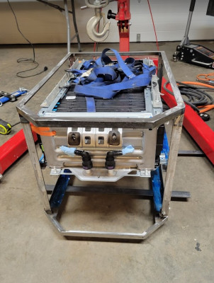

Finally got the new battery enclosure finished. Funny enough my current job involves a fair bit of sheet metal design, so I was able to model something up and have it laser cut and CNC bent at Send Cut Send. They also installed PEM nuts which I wanted to use rather than rivnuts so as to avoid leaving a raised surface on the mating side of the sheet. Now since I was farming this work out I tried to be as cost effective as possible, making some parts identical for quantity discounts and then modifying them later. Very impressed with the quality of what came back, even the zero clearance holes I drew lined up perfectly, even around corners. I also made some of the brackets and the top plate myself, to save a bit of money. In some cases I did use rivnuts, but I counterbored the holes on my mill to get them to sit flush.
This was the basic design. Contactor box with 3d printed parts. (And once it was installed, but only partially wired). First group of cells in place. The liner is Nomex 410 paper and Kapton tape. A requirement in the SCCA rulebook. Mid tray (same part as the base tray but I cut the front off and bent it downward for rigidity). Top group of cells in place and most of the wiring done. And done! I'll have to pull the lid off again later to check for leaks once I refill the coolant, though. I also decided to change up my accelerator pedal situation, so I removed the single channel hall sensor and modified a Prius pedal. Basically I cut the pedal part off, then mounted it upside down behind the Wilwood pedal box and connected it with a linkage. I also ran a nicer shielded wire, just in case. And then I forgot to take a picture. oops. Oh, and I discovered a small problem with myself while testing the feel of the pedal. I was checking to see how it felt to roll on and off (linearity, overall resistance, etc) and caught myself making engine noises as I did it.
Lastly, I have been working on the computer. The one on the left is a Raspberry Pi running Open Auto Pro, powered by a CarPiHat. It can communicate with the inverter over wifi, and the BMS/MCU via USB. Eventually I want to get it onto the CAN network for datalogging too. Possibly add a camera feed and run it with TrackAddict. The screen on the right is the Dilithium display for power usage, SOC, cell balance etc. The shroud I printed for the back was a tad too tall so the dash is sitting a bit high in this picture. Will have to print a new one asap. There's also a speedometer that will be mounted below the blue buttons but I can't mount that until I reinstall the cover for the transmission tunnel.
