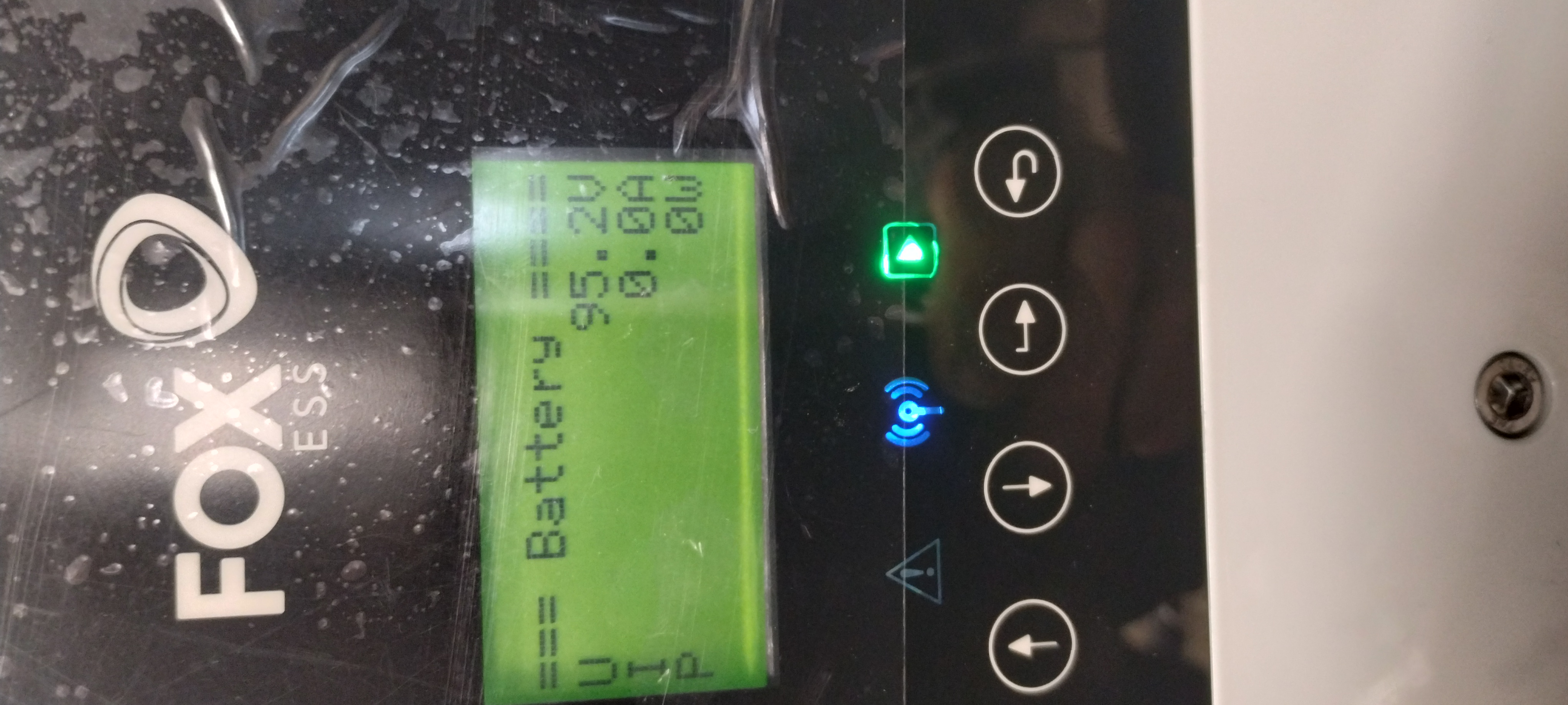

I seem to have a problem the inverter never feed omre than 37w to the load even thou it is reading 700w, I thought it would try and match the load from the batteries so the grid current is roughly 0? Here is the BMS data And the results from your excellent spreadsheet And what the inverter is reporting the battery as The inverter is set to feed in first, out max power, 0 export to grid but also tried upping this and made no change
And suggestions please

What is your grid load like? Are you drawing from the grid? Where is your CT clamp?
Re: Fox ESS H1-5.0-E ~33KW Peugeot E208
My grid load is the garage that the inverter is installed, so has about 400w of florescent tube lighting, a computer and a few other chargers etc, about 700w, the CT clamp is on the incoming mains to the garage, with as per instructions the arrow on the CT clamp pointing towards the grid, so it's simulating the garage is the house , just while I get it all set up
Drop your remaining_kWh, * 0.1 should suffice. I assume you don't have 95.7kWh installed.
Set pack_volts_min to 860 (86.0V) and see what happens. I think the minimum spec is 85V (?)
Other than that I would double check your CT setup. If that reading is wrong the inverter won't do anything. It should be on CT1 and it should rapidly monitor the actual load on that circuit.

hi Woleg,
Thankyou for your suggestions, in trying to get the BMS working, I did a factory reset the other day and forgot to re-enable the CT clamp, doh.
As far as I can tell it is working, supplying the garage from the batteries so 0w from the grid are now being consumed.

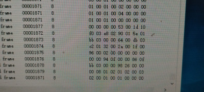

hi,
I have left inverter running for 24hrs now, just on batteries alone and all is working well including charging at different current rates depending on cell volts. Here is a snippet of what the BMS has received and sent.
Inverter send 13:07:48:053 Data frame Extended frame 00001871 8 02 00 01 00 01 00 00 00 assuming Slave BMS request
Inverter send 13:07:48:563 Data frame Extended frame 00001871 8 03 06 17 04 05 0d 07 2f time stamp
Inverter send 13:07:49:074 Data frame Extended frame 00001871 8 01 00 01 00 02 00 00 00 ?
Inverter send 13:07:49:087 Data frame Extended frame 00001871 8 01 00 01 00 04 00 00 00 ?
Inverter send 13:07:49:583 Data frame Extended frame 00001871 8 01 00 01 00 00 00 00 00 message BMS replying to
BMS reply 13:07:49:844 Data frame Extended frame 00001877 8 00 00 00 00 53 00 1d 20 Bms ASCII data
BMS reply 13:07:49:866 Data frame Extended frame 00001872 8 f0 03 e8 02 32 00 fa 00
BMS reply 13:07:49:876 Data frame Extended frame 00001873 8 6a 03 ec ff 28 00 28 00
BMS reply 13:07:49:893 Data frame Extended frame 00001874 8 c2 01 32 00 2a 00 1f 00
BMS reply 13:07:49:906 Data frame Extended frame 00001875 8 60 00 02 00 01 00 00 00
BMS reply 13:07:49:917 Data frame Extended frame 00001876 8 01 00 3d 0e 00 00 36 0e
BMS reply 13:07:49:927 Data frame Extended frame 00001878 8 6a 03 00 00 98 26 00 00
BMS reply 13:07:49:937 Data frame Extended frame 00001879 8 00 08 01 02 01 02 00 03
Does anybody know what the are? could it possibly be individual/group battery cell voltage info?

I think the other 0x1871 frames are for can slaves, I noticed differences on the BMS version screen when responding to them. Can’t be sure though.
