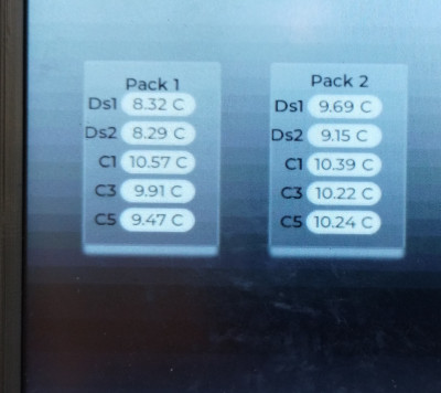

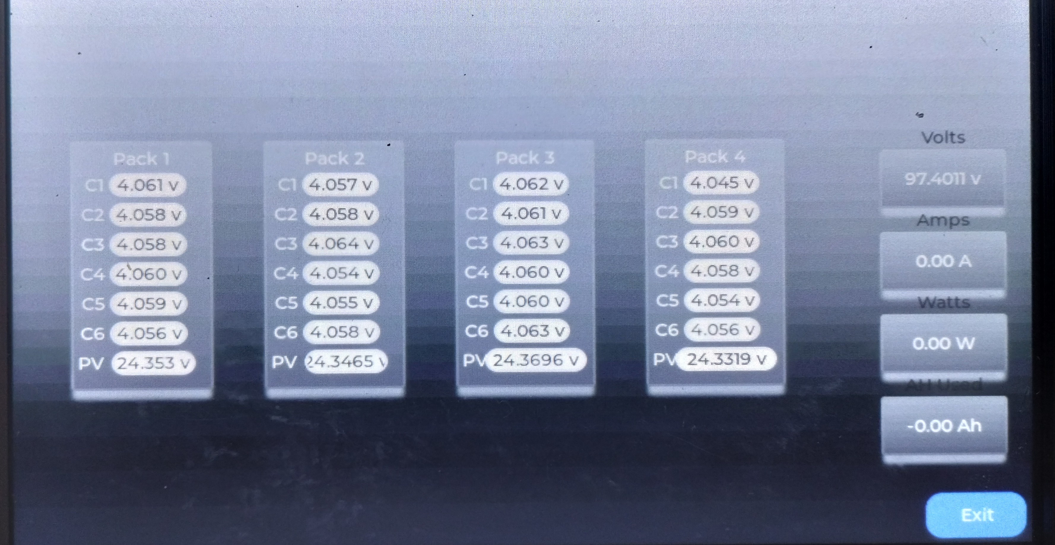

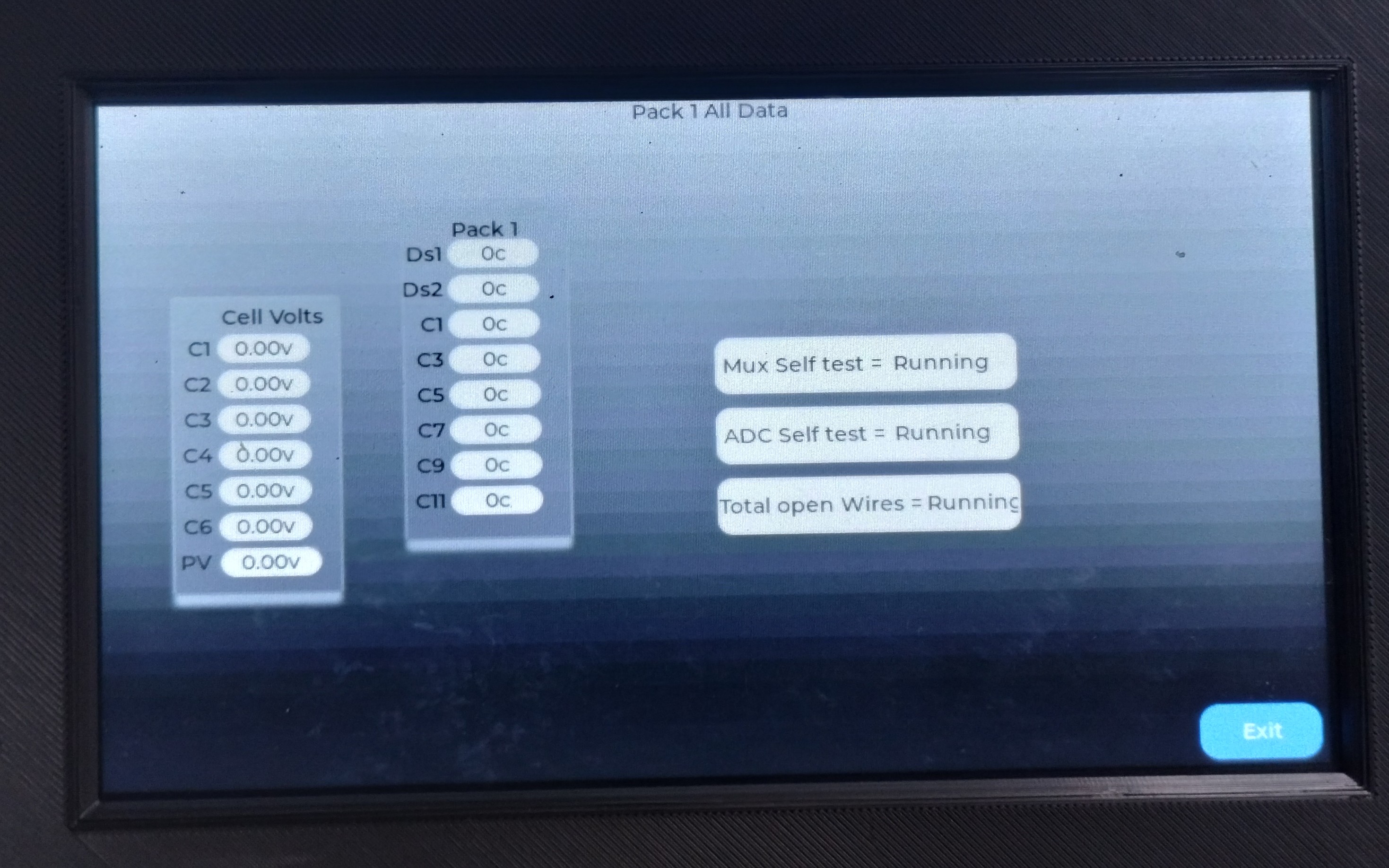

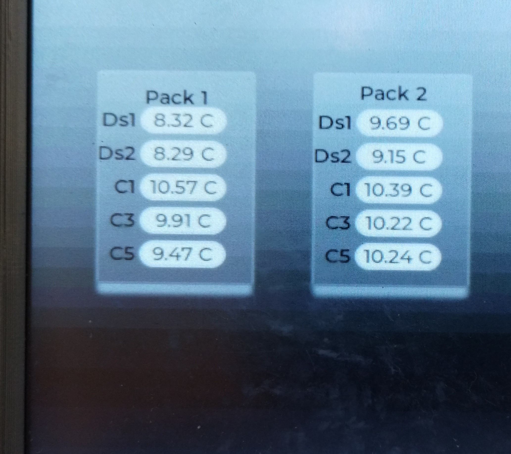

Thanks for this info, I'm sure it will be useful, I hope to include on the software I have written so far in platform io. Here are some pictures of my BMS unit so far, still a working progress.
The cell voltages Cell temperatures And the self test of each BMS And the result The graphics needs more aligning etc , but it gives u an idea of what I'm building

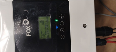

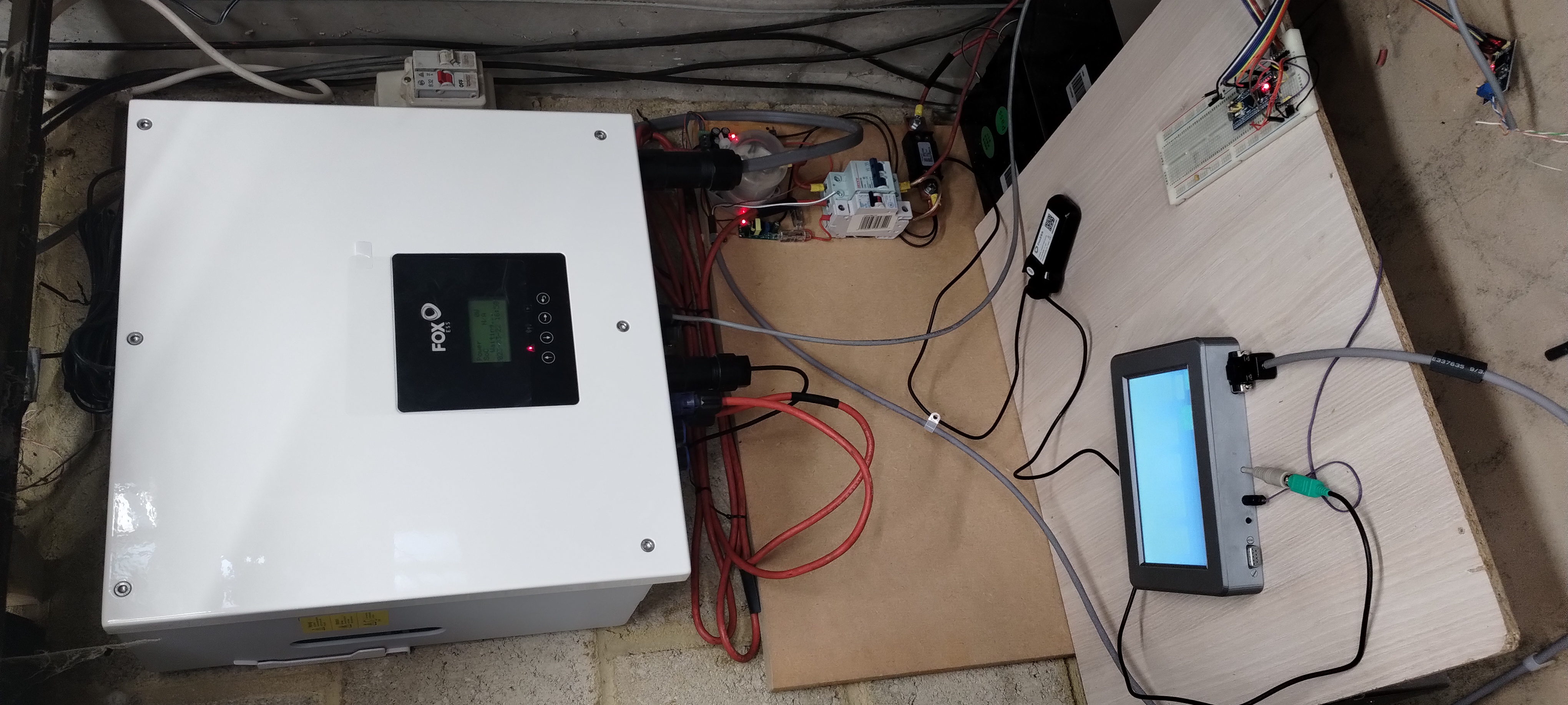

hi,
I bit the bullet and have purchased the fox H1 6kw inverter, I have it wired in my garage with the mains and batteries and my BMS controller, also with the current probe on the incoming mains so this thinks the garage is the load just for test purposes only. I have 4 mg zs modules wired to the inverter and is all powered, If I trip the AC to the inverter quite happily runs off the batteries and reports grid fault as you would expect.
I have written the Can bus code to follow the response frames as on the rand12345/ solax_can_bus data. The inverter powers up and the warning light is no longer flashing, reports SOC of batt at 100% but the green indicator is flashing and inverter reports just Waiting and never gets any further here is a sample of the data on the can bus

Oh some pictures
And what the inverter is showing, the green light is flashing Re: Fox ESS H1-5.0-E ~33KW Peugeot E208
Congrats! It’s best to test with EPS enabled, much less fuss. Have you ensured that the FoxESS start/stop option is set to start?
Ok, there's a few scaling errors in your can bus data and a few other things.
https://i.imgur.com/ytaXUM1.png
0x1873 "Voltage" is scaled wrong. It's decoding at 10x your actual voltage so correct that with * 0.1
Don't send 0x1881 and 0x1882, those are to do with initialisation.
